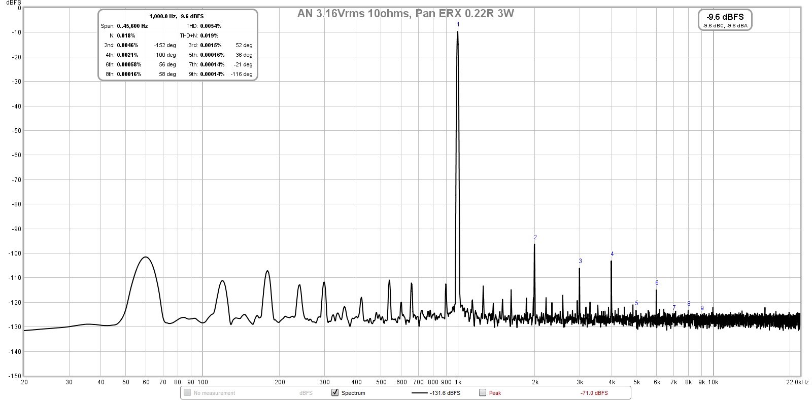

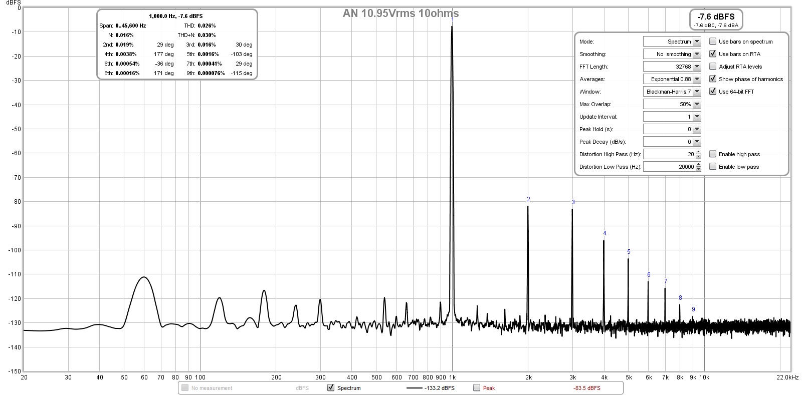

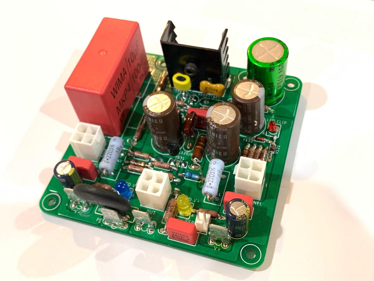

The fact that the board is completely connectorized (9 total) allowed me to pull it out of the chassis in 2 minutes, swap the KOA 0.22R J BPR soure resistors for Panasonic ERX 0.22R 3W, and reinstall in 2 minutes, and then take another measurment at 3.16Vrms (1W) and 10ohms to compare, is very handy. It sure is nice to have remotely mounted MOSFETs!
I am very surprised that the venerable Panasonic ERX has now been declared no longer the King! The KOA BPR is superior! KOA BPR measured 0.0048%THD and Panasonic ERX measures 0.0054% THD. Profile is a tiny bit higher in even orders, especially 4th order with the ERX I think, but not enought to justify the increase in THD. I guess we will be spec'ing KOA BPR's from here on out. They are more readily availble, take up less real estate, and are rated 5W vs 3W which is a great bonus.
Here is the board with the ERX's installed:
Here is the FFT from the KOA BPR's for reference:
Here is the FFT from the Panasonic ERX:
I guess this lays this question to rest - the one's specified in the BOM are good to go.

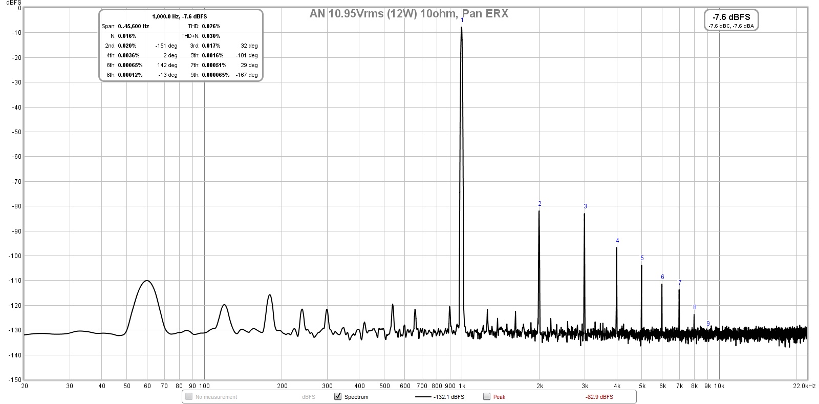

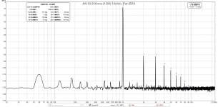

What is interesting is that at higher power of 12W, the THD and FFT profile is about the same. So it seems to affect the 1st watt more.
Here is 12W witj KOA BPR for reference:
Here is with the Panasonic ERX:

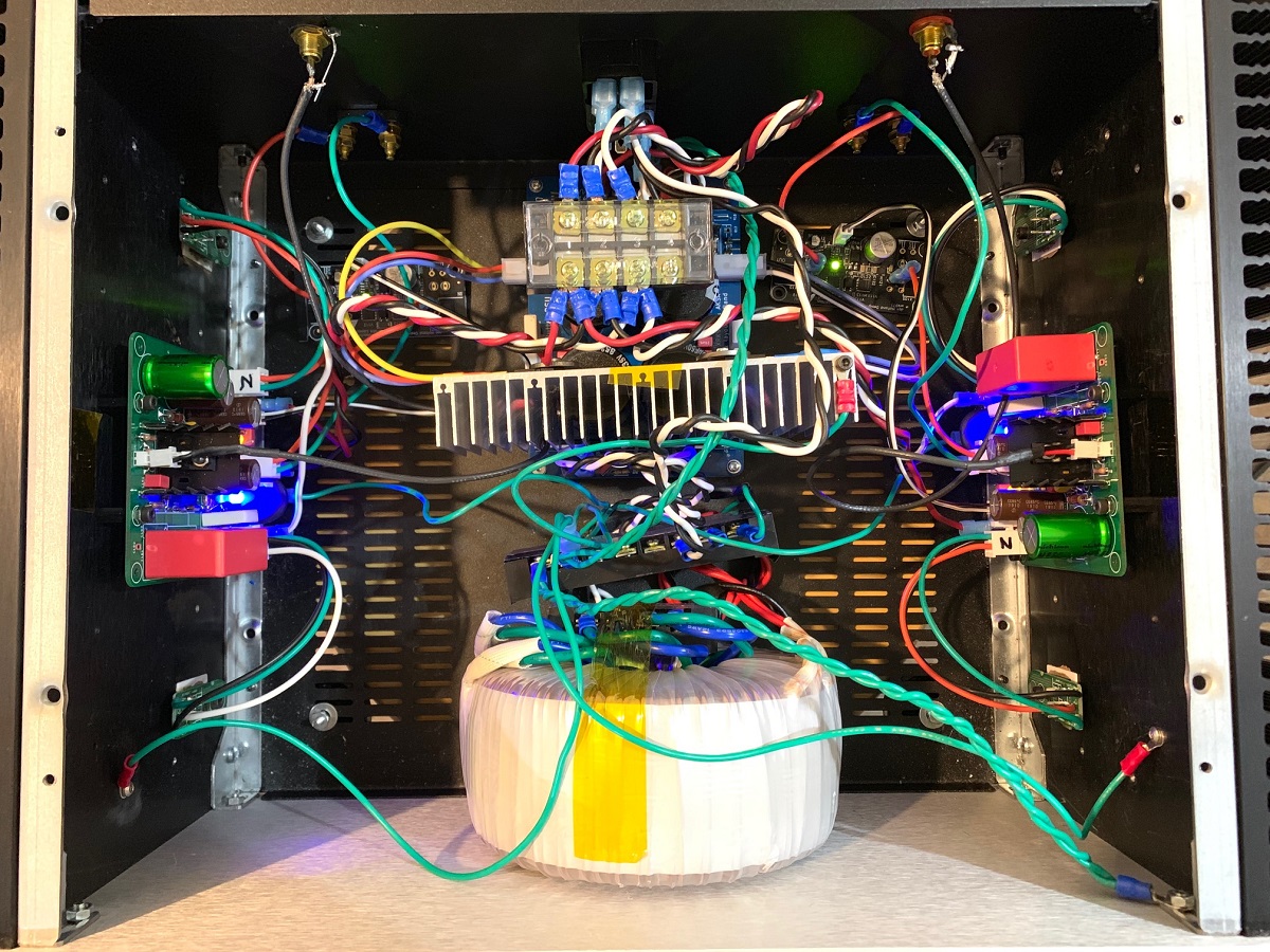

Looking at your build photos in post-1, it seems to me that the grounding and wire twisting is not done correctly, otherwise the 50Hz in the output noise spectrum would be absent. I have not looked at the whole thread; is there a schematic of your power supply? There should be local filtering on each PA card.
The signal ground should not star with the AC ground; rather, the AC ground being noisy and for protection should be on its own lug. The signal ground should tie to chassis on its own lugs through a ground-link-isolator circuit (anti-parallel diodes in parallel with C and parallel with R).
Othewrwise, your boards, chassis and work space look really nice 🙂

Hi Nauta,
The SMT on the main board are optional as there are through hole alternate pads on other side. Except the output Thiele network, that is an SMT but an easy one. As far as the snubber boards go, the ideal spot is next to legs. You are welcome to deadbug a TH part there.
As far as grounding goes, here is the diagram as built:
Each board has its own ground loop breaker (GLB) consisting of a CL60 NTC (or 8D-20) and 22nF film cap to earth/chassis GND. The analog signal input ground is not Star topology but each is lifted by 10R relative to power 0v GND which is Star hub topology. The hub is at the SLB PSU, also has its own GLB to earth/chassis. (but on an M2X, it has been shown that star hub on analog audio input makes the hum go away - but that amp has different grounding scheme and no GLBs or ground lift).

If you can do better than -110dB on the mains 50/60Hz peak on a Class A amp drawing 3.4A - I would like to see your setup and FFT. I have achieved absolute noise free baselines before but generally on SMPS or DC-DC step up PSU - not linear toroidal trafo mounted in same cabinet. Just the EMI emitted from that trafo will fly through the air and be picked up by the amp. No amount of ground loop prevention stops that. Only mu-metal or steel shielding boxes or a separate chassis for the PSU.
As for heat from MOSFETs - the snubber boards are 2mm thick FRP covered with 2oz copper and via stitched to form an excellent thermal conductor. If PCBs can take soldering or hot air ovens at 150C without fear, the 70C temps on the PCBs from the MOSFETs are not going to be an issue. They work very well to actually increase surface area of the epoxy case and serve as a small radiator. When we use these with a clamp bar on a CPU cooler, their job is to conduct heat through and via stitched copper pours are well known to be effective heatsinks.

Just a comment - the earth from the mains should really go to a separate lug to meet safety standards.

There is a whole terminal block with nothing but earth ground connections. See large double twisted green wire from IEC to block next to trafo? That then fans out to chassis and the PE connection on each board. Each board has 7A NTC connecting it’s 0v GND to mains earth/chassis.
I think JPS64’s layout using the stitched vias is more for decreasing electrical impedance for the large current carrying paths than anything. The RFI shielding is probably no more than the usual ground plane where possible. Mostly it is the RFI filter on the input (220pF and 2k2) and the Thiele network on the output 100nF series 10R will block ingress of RFI from front and back ends.
