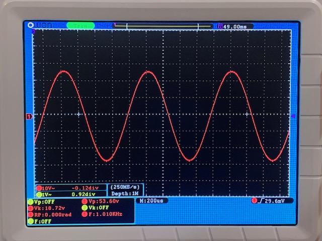

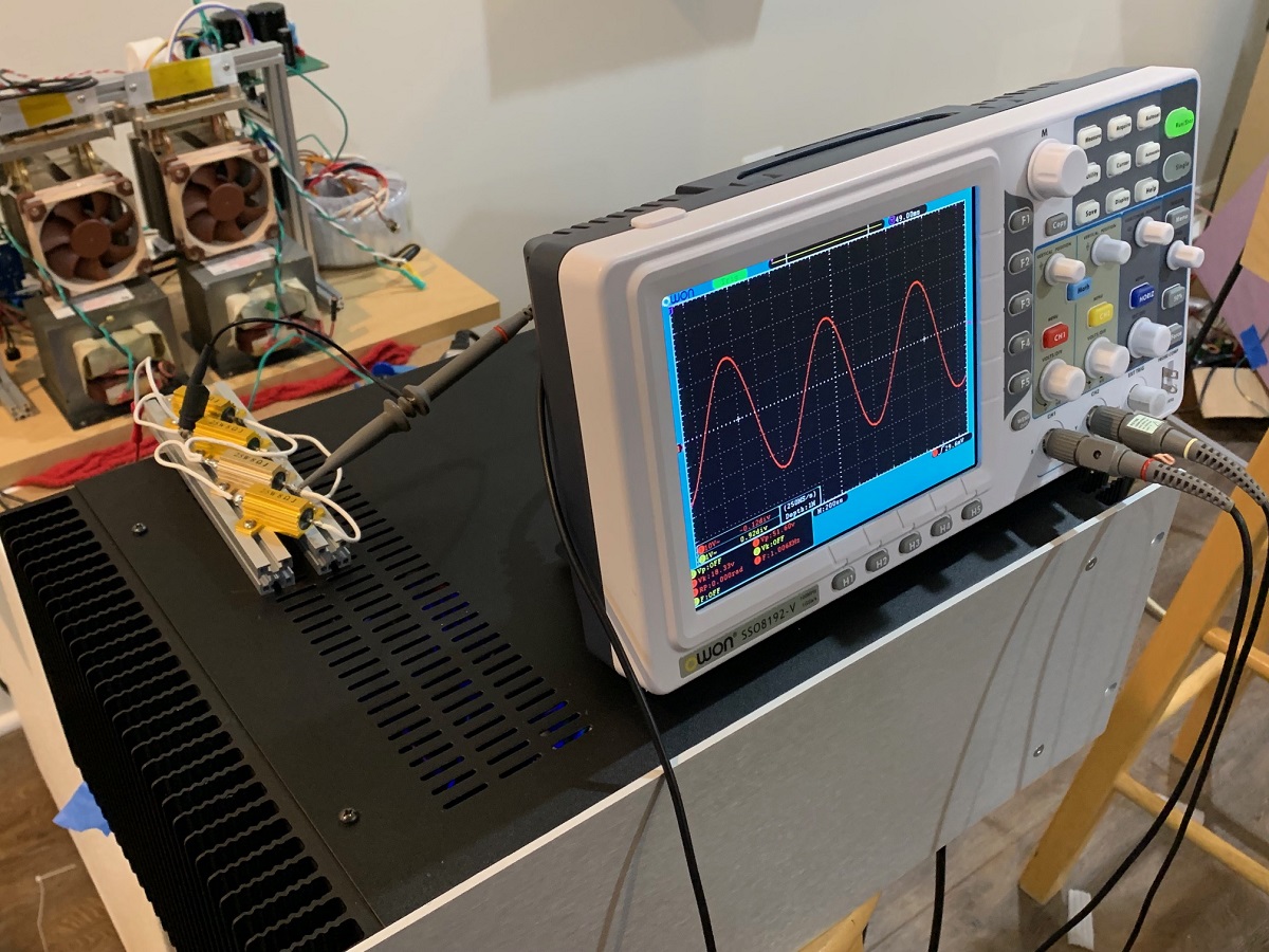

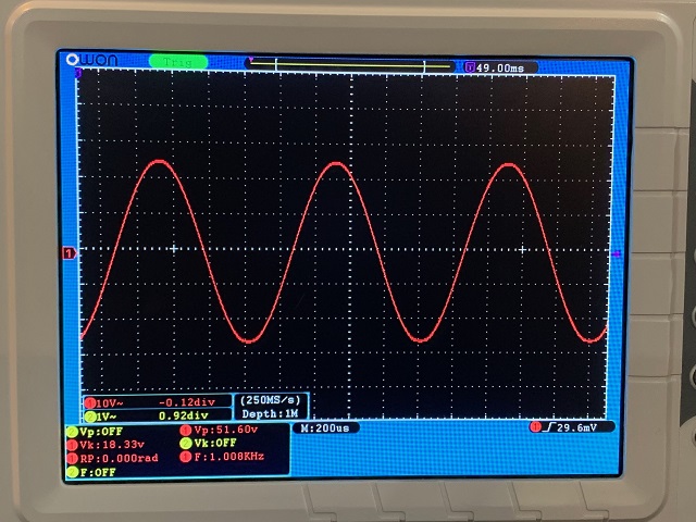

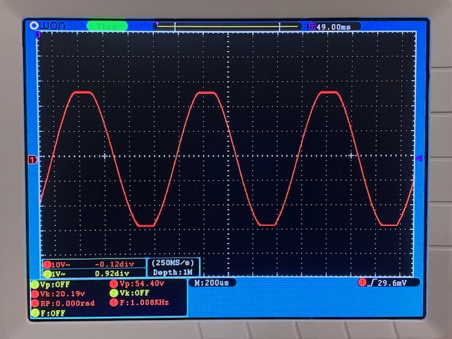

Sorry I was not clear here - it was very late wee hours of the morning. I made the measurement at 10ohms, but here is the data for 8ohms. This is not a nice ultra-low inductance dummy load, but a conventional wire wound and potted in aluminum body dummy load 25w each wired series-parallel for 100w, but probably less since not mounted on a real heatsink.
At a bonafide 8ohm load, I was able to get 51.6vpp before clipping for 41.6wrms or 44% efficiency based on 94w thermal input. This matches nicely against the 43% predicted efficiency from LTSpice sims that you ran as mentioned on Post #1. I don't want to lead anyone on a technical fairytale. 😉

I just checked the clip indicator LED to see if it corresponds to what I see on the O-scope. It is pretty neat but the clip indicator LED matches precisely what I picked for onset of clipping. The Alpha Nirvana clip indicator comes on at 18.11vrms for the left channel and 18.05vrms for the right channel. This corresponds to 41.0w on the left and 40.7w on the right channel. Totally forgot to look at it before (as it is on the PCB). Anyhow, just thought that I report that it works as designed.

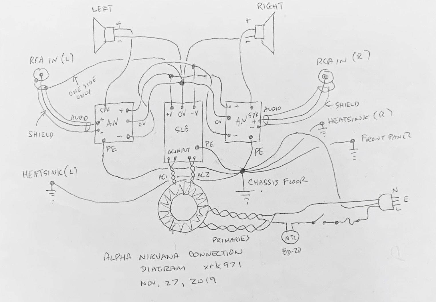

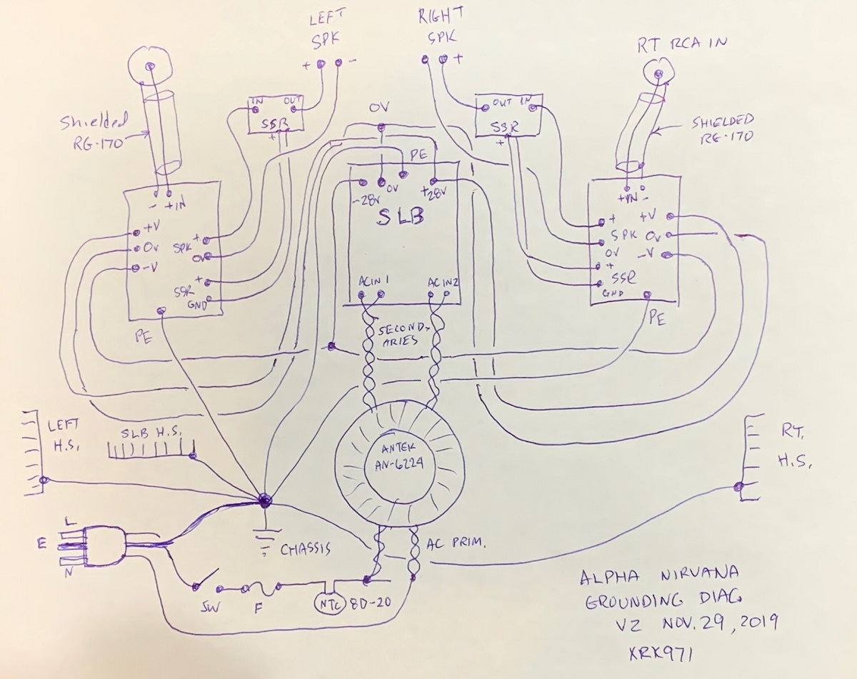

Here is how I connected the Alpha Nirvana with the SLB and my chassis. The one wire from RCA (L) ground to the star GND hub is optional. It reduced the amount of hum ever so slightly. The RCA ground is electrically isolated from the chassis panel via the shoulder washers that come with it.

Here is clipping performance of this amp with a 300w 10ohm ultra-low inductance resistor. A nice symmetric and clean clip at 54.6vpp:
797953d1574849474-alpha-nirvana-39w-8ohm-class-amp-img_3035-jpg
Here is the output just before the onset of clipping (53.4vpp) which would be about 46.5w into an 8ohm load:
797958d1574849863-alpha-nirvana-39w-8ohm-class-amp-img_3037-jpg
46w from 94w thermal dissipation is 49% efficiency - very good for a SEPP amp.

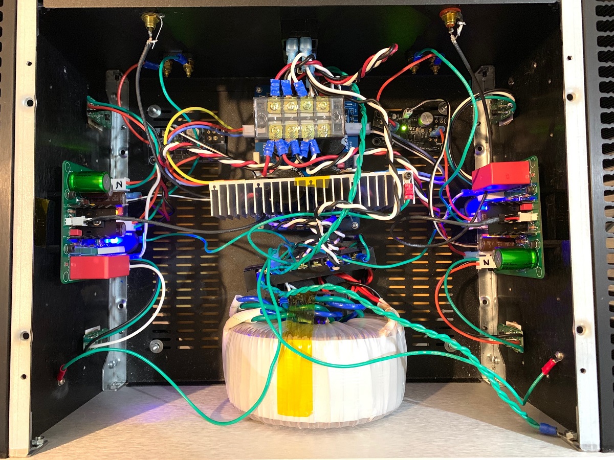

Can I suggest one small mod to the chassis wiring?
Having designed and built a few class A amps I found that connecting the loudspeaker ground return directly at the amp module it self, in your case it would be amp module Power GND connection rather than directly connecting it to the power supply GND. if you try this I suspect your left channel input shield connection to PSU GND can be removed.
What this earthing topology will do is to provide a single GND return from the amp module back to PSU GND, rather than the two point return you have currently. 🙂
I hope this helps?
The one ground connection from the RCA to the PSU star hub probably should probably be removed. I will check it again - it was installed as a result of trial and error. In my experience, having the speaker return go straight back to the PSU Star GND hub makes for a quieter amp. It is an option on this board to return to the board as there is provision on the mini Quickfit connector for a speaker return. The user may try it either way and stick with whichever is quieter.
Thank you Anthony, good advice, particularly as grounding is an art form on audio amps. In efficient speakers, you can easily pick up just under 5mV hum and it drives builders crazy.
X, I always take speaker ground back to the center point earth between power connections and a 10R float for the input ground, fb shunt and input device bias resistor. It normally works but I have been disappointed more than a few times over the years. Still, it is the best option I've seen, so I invite any good ideas here!

Yes I have used the 10R float on the Signal and feedback GNDs since the 1980s as well and for years use to connect the LS GND to the centre point of the power supply and for Class AB it worked just fine. But about a year a go I purchased a more expensive Audio analyers (AVERLAB) and discovered doing FFT tests that I could see a 50hz hump albeit down by -100db, I discovered that by moving the LS GND return as close as possible to the point where the 10R float resistor terminated at power GND on the amplifier module the 50hz hump dissappeared, with Class A amps where very high currents as high as 4 amps bias running around this became even more pronounced and the need to make this connection in this way was mandatory.
Any way just wanted to help and I hope this info can be of use. 🙂
Well X, with HD and Anthony chipping in advice on power supply grounding techniques, in the end, this should be one of the quietest amps around. Look forward to your comments after trialling what has been suggested by both experts.

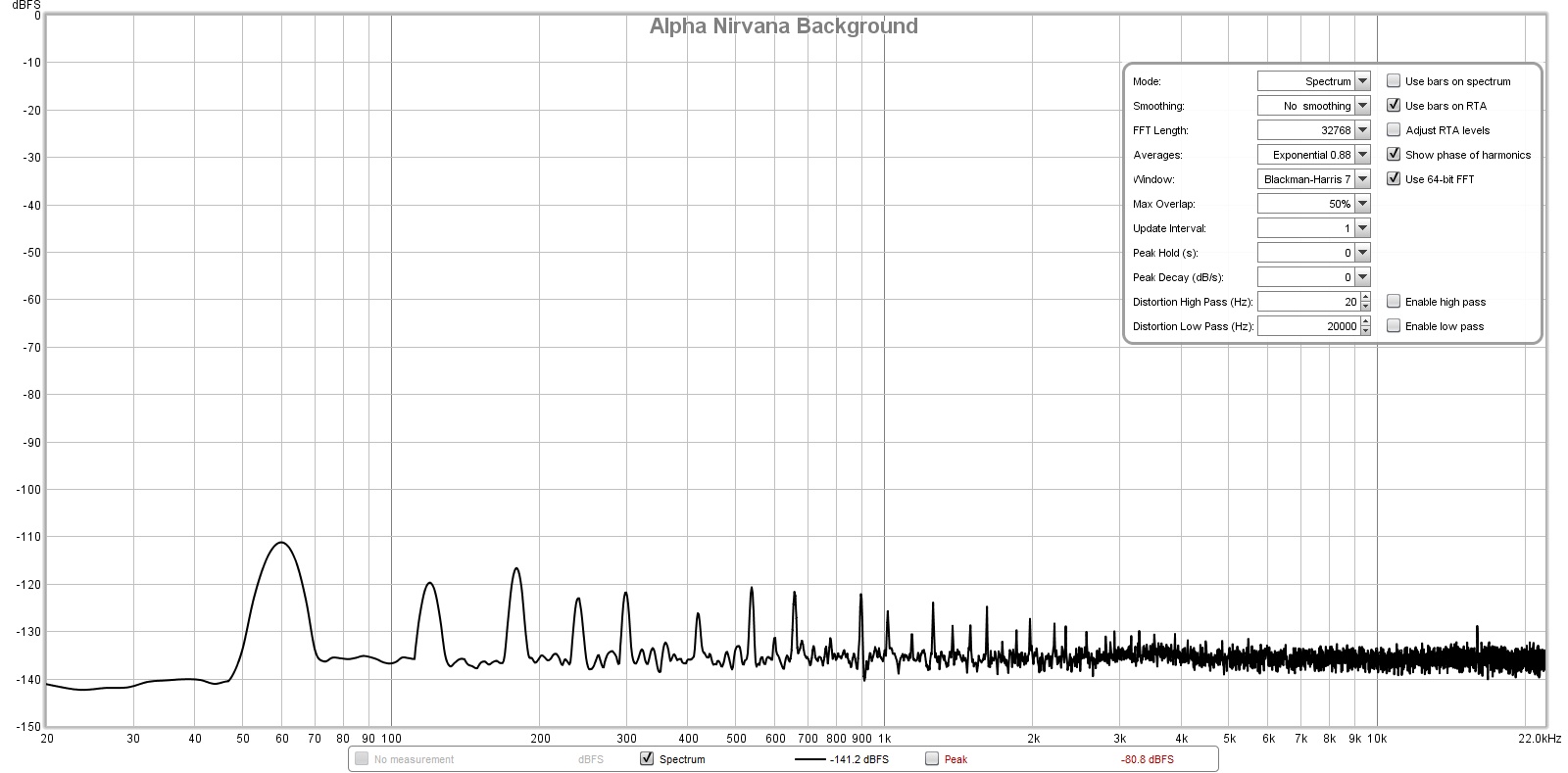

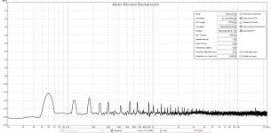

Thank you for your advice. I hooked up my 10R 300w ultralow inductance dummy test load and then connected my Focusrite 2i4 to it with 10:1 balanced voltage divider (AC coupled via a pair of 1uF Wima MKS caps). Turned on REW in RTA mode and looked at the noise background FFT like a stethescope to do real-time grounding checks.
So I found that it helped to connect the return for the speaker back to the amp PCB as you suggested. This dropped the 60Hz mains peak by about 20dB - significant. But it is not zero. I also disconnected the funky gnd from the RCA -ve to the 0v hub. That helped by about another 5dB. The biggest difference was just moving the AC wire bundles around to tiy them up and keep them tightly coiled near the trafo. In fact, I stuffed the excess AC wires into the donut hole of the trafo and taped them shut with a piece of Kapton tape. That reduced a lot of the HF mains hash that I was seeing. I also added a ground wire from the SLB heatsink to the chassis ground. I added dediccated ground wires from each heatsink to the chassis gorund point. I think the remaining 60Hz peak and higher order mains harmonics are probably from EMI radiated from the trafo itself being in close proximity of the boards.
The amp now looks like this:

Here is the new grounding diagram v2:

And here is the resulting background noise FFT for the Alpha Nirvana as connected above. With my ears pressed to the speaker cone, there is no noise. It is a very quiet amp now. The Fluke 101 measures 0.1mV rms noise with the sound source turned to zero volume.

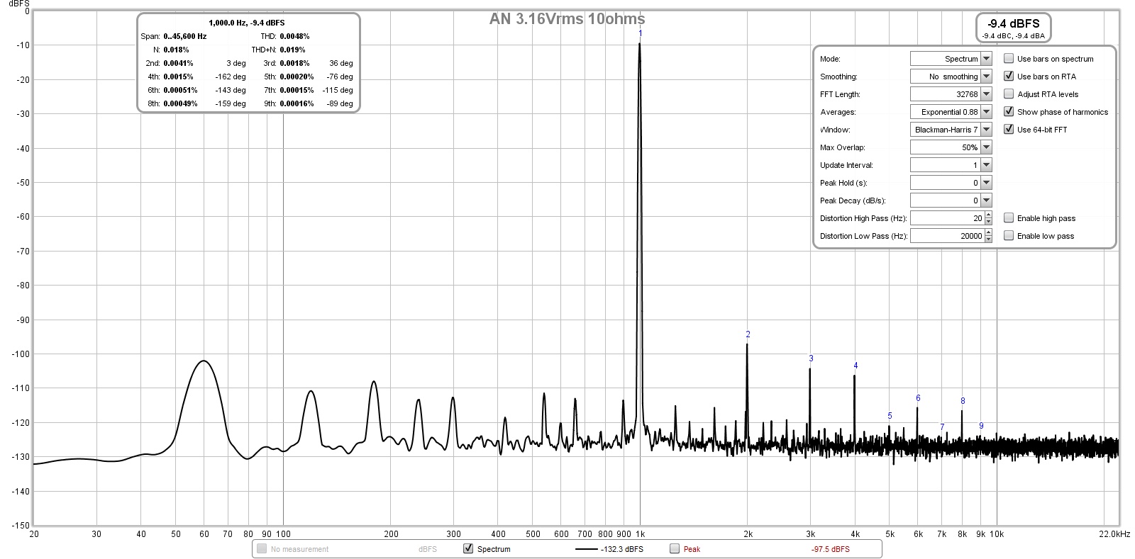

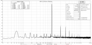

With the above setup connected and producing a fairly clean background, I proceeded to measured the distortion using the 10ohm ultra low inductance dummy load.

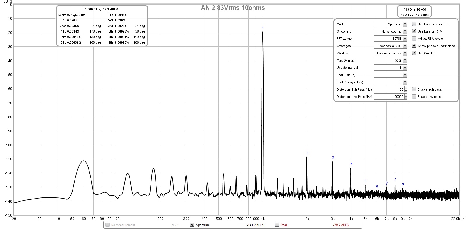

Here is the FFT for 2.83vrms into 10ohms (800mW) for 0.0045% THD:
attachment.php
This is for 3.16vrms into 10ohms (1w) for 0.0048% THD:
attachment.php

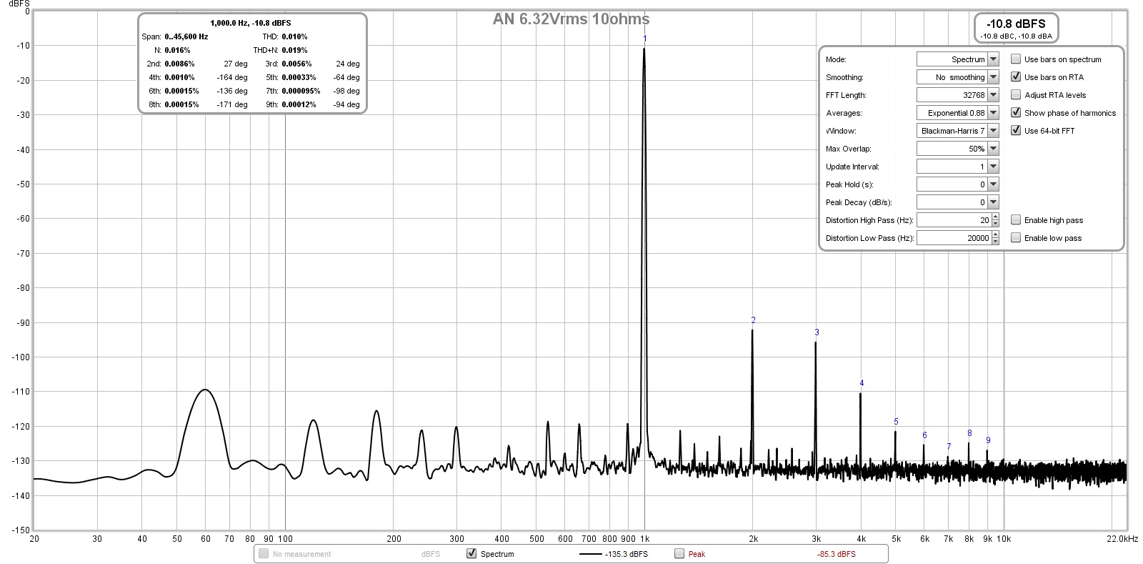

This is for 6.32vrms into 10ohms (4w) for 0.01% THD:
attachment.php

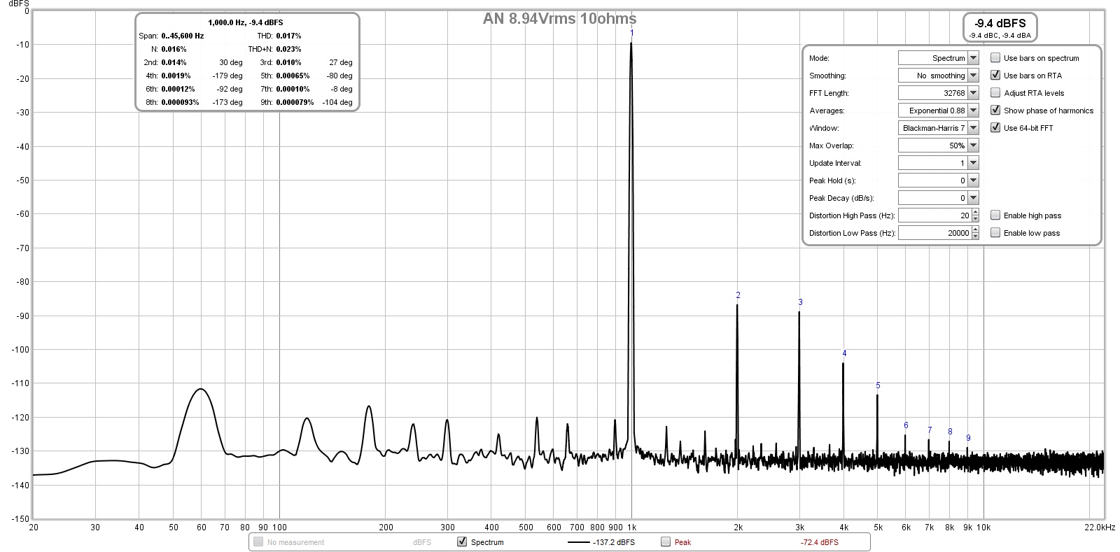

This is for 8.94vrms (10w) for 0.017% THD:
attachment.php

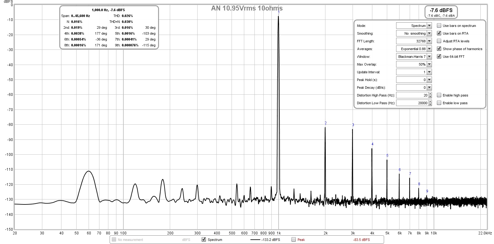

This is for 10.95vrms (12w) for 0.026% THD:
attachment.php

Thank you X,
It doesn't get much better than that, although I'd love to knock down H3 by another 10dB. It's a very good profile, and with hum at -110dB I think this is an extremely quiet amp.
