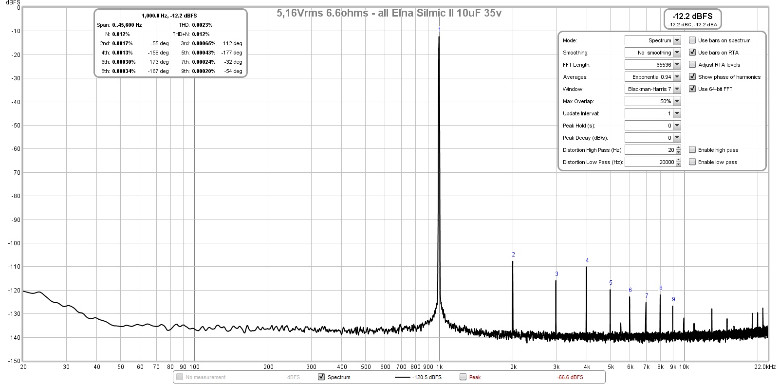

Measurements are excellent, THD is certainly beyond the hearing capabilities of any "golden" ears. I had expected they would outperorm my lateral MOSFET amp driven in class AB (100mA bias) - but this is not the case. So personnally I do not see the point in excessive heat dissipating class-A designs.
For comparison I append a THD FFT measurement with 10Vrms into 5Ohms at 1kHz.
btw hum seems to be in the same region
Measurements are excellent, THD is certainly beyond the hearing capabilities of any "golden" ears...

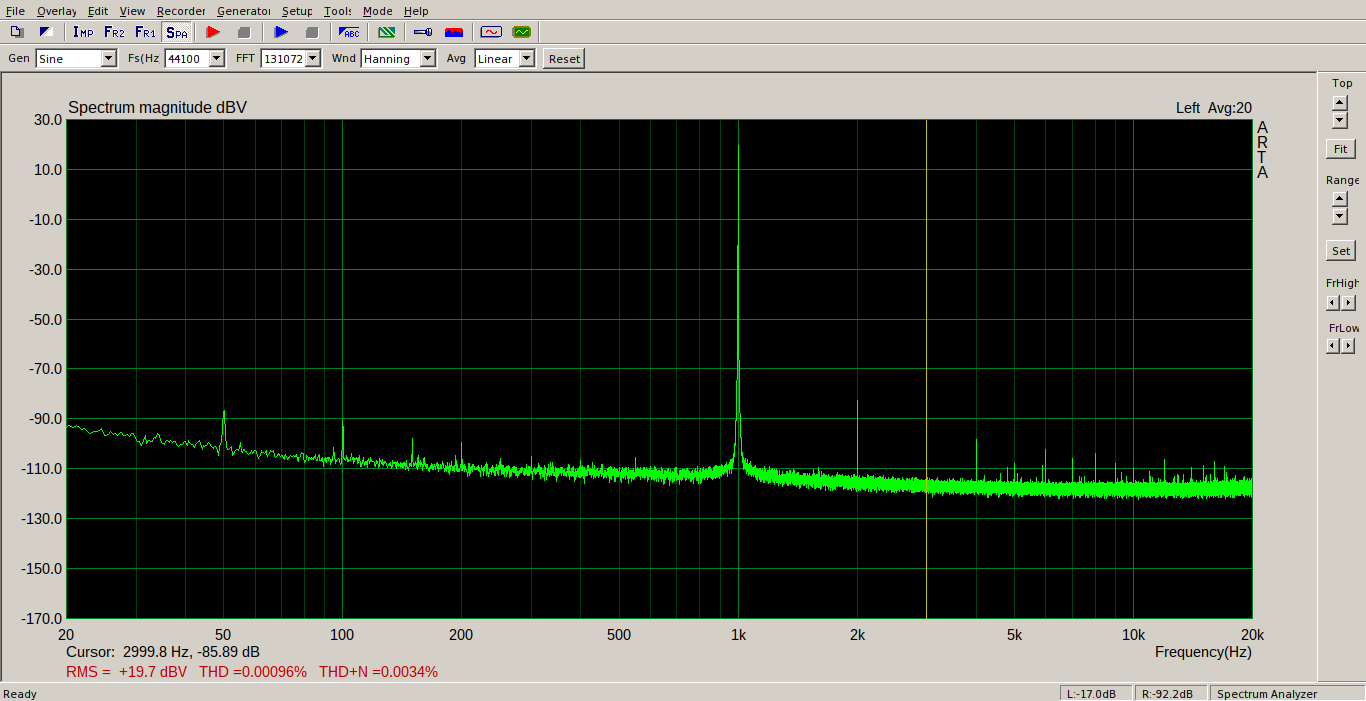

Thank you for your advice. I hooked up my 10R 300w ultralow inductance dummy test load and then connected my Focusrite 2i4 to it with 10:1 balanced voltage divider (AC coupled via a pair of 1uF Wima MKS caps). Turned on REW in RTA mode and looked at the noise background FFT like a stethescope to do real-time grounding checks.
So I found that it helped to connect the return for the speaker back to the amp PCB as you suggested. This dropped the 60Hz mains peak by about 20dB - significant. But it is not zero. I also disconnected the funky gnd from the RCA -ve to the 0v hub. That helped by about another 5dB. The biggest difference was just moving the AC wire bundles around to tiy them up and keep them tightly coiled near the trafo. In fact, I stuffed the excess AC wires into the donut hole of the trafo and taped them shut with a piece of Kapton tape. That reduced a lot of the HF mains hash that I was seeing. I also added a ground wire from the SLB heatsink to the chassis ground. I added dediccated ground wires from each heatsink to the chassis gorund point. I think the remaining 60Hz peak and higher order mains harmonics are probably from EMI radiated from the trafo itself being in close proximity of the boards.
The amp now looks like this:
Here is the new grounding diagram v2:
And here is the resulting background noise FFT for the Alpha Nirvana as connected above. With my ears pressed to the speaker cone, there is no noise. It is a very quiet amp now. The Fluke 101 measures 0.1mV rms noise with the sound source turned to zero volume.
