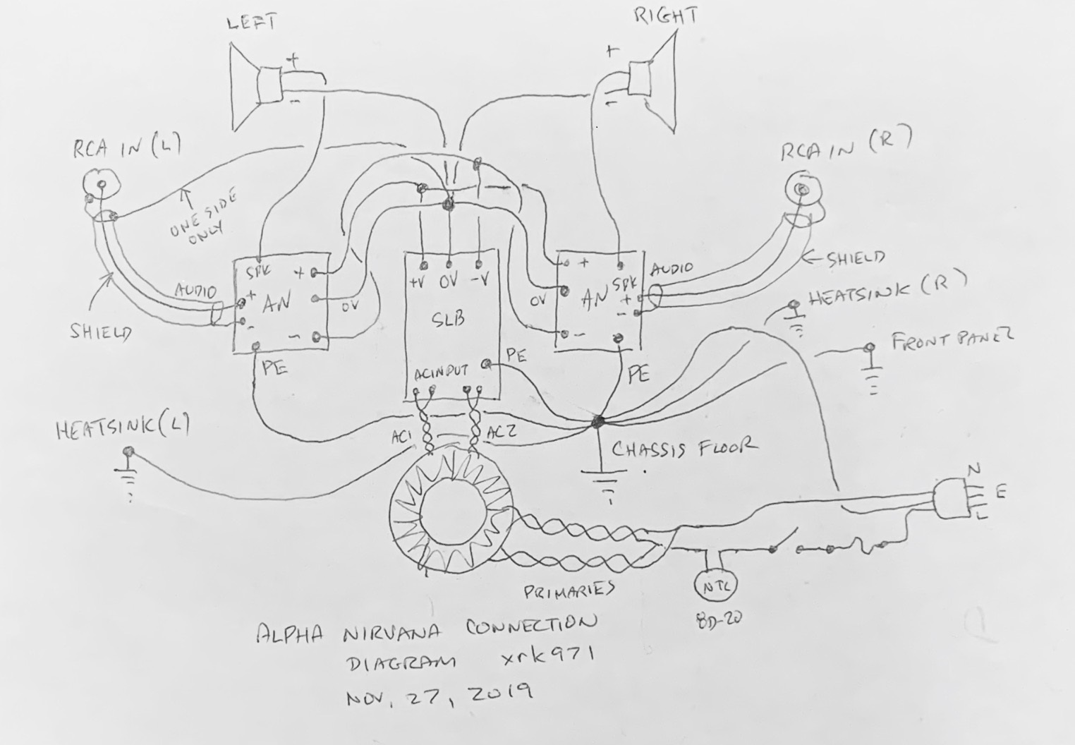

X, as I mentioned in a previous post, after you have finished your testing, I think it would be a good idea to do a chassis wiring diagram as you have built it, so that members have a head start when using your dual SLB, AN amp boards and SSR boards, especially as you had some hum and that is now sorted with different wiring connections.

Will get hookup diagram as soon as I have some time. I think we will probably be going with the individual smaller boards option to keep it fun - you can add/remove options as you see fit. Also, let’s you re-use your existing hardware like and SLB or SSR protection board.

Hi X, that all sounds like a good plan to me, a wiring (hook-up) diagram will help a lot of members who might be tempted to build this beauty.

Here is how I connected the Alpha Nirvana with the SLB and my chassis. The one wire from RCA (L) ground to the star GND hub is optional. It reduced the amount of hum ever so slightly. The RCA ground is electrically isolated from the chassis panel via the shoulder washers that come with it.

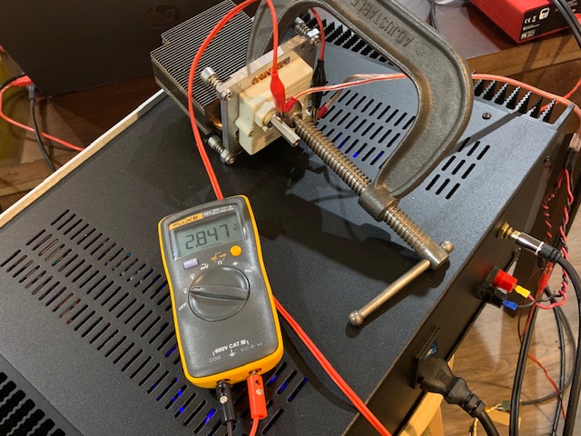

Here is the 300w 10ohm load resistor connected to a CPU cooler heatsink:

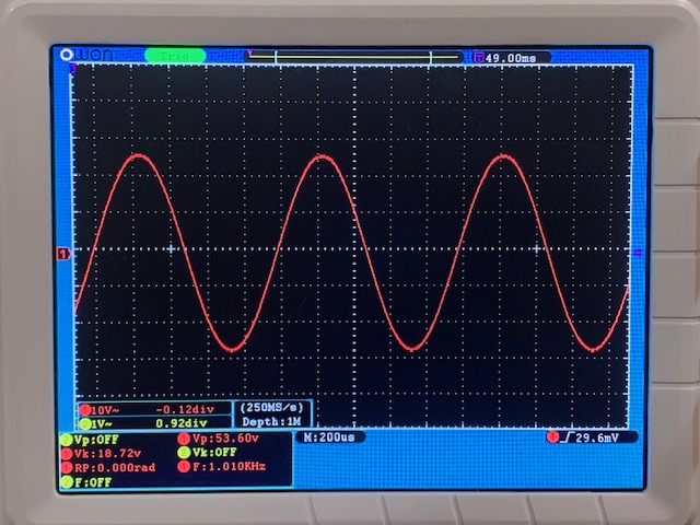

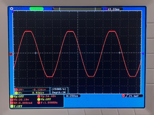

Here is clipping performance of this amp with a 300w 10ohm ultra-low inductance resistor. A nice symmetric and clean clip at 54.6vpp:

Here is the output just before the onset of clipping (53.4vpp) which would be about 46.5w into an 8ohm load:

46w from 94w thermal dissipation is 49% efficiency - very good for a SEPP amp.

BTW, you may not need a single wire of ONE channel from the RCA ground to SLB ground; the braid RCA COAX on each channel should pass to the signal earth of each amp module. Put another way, if you disconnect your one wire from ONE RCA ground to SLB ground, it may actually reduce hum. With it there, the 10R float resistor is bypassed. However, earthing is a black art, and hell, I may be quite wrong........

You are right Hugh, this singular wire from star ground to RCA ground was added via pure trial and error. It was quiet without it but “sounded” even quieter when I added it - I may be wrong as it was late and I was using just my ear pressed to the speaker cone.
