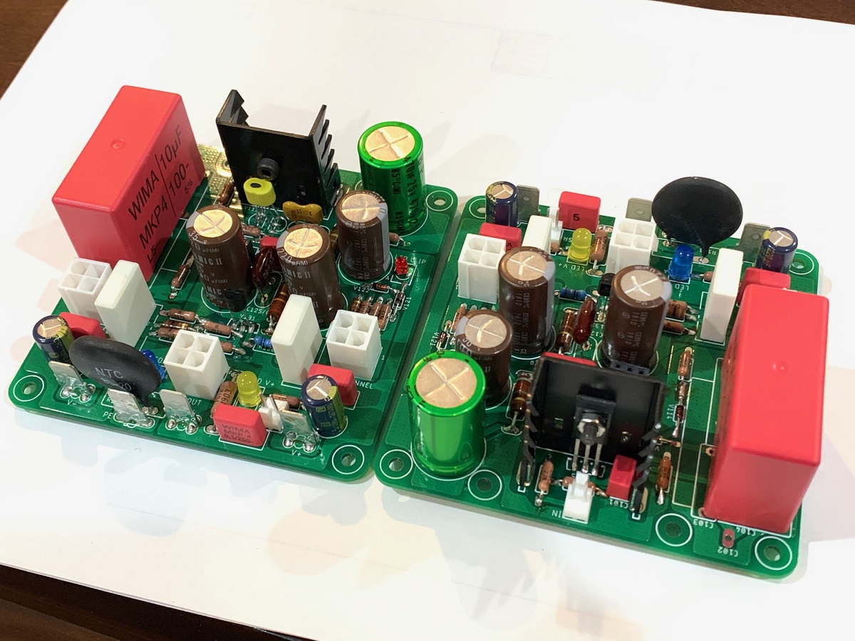

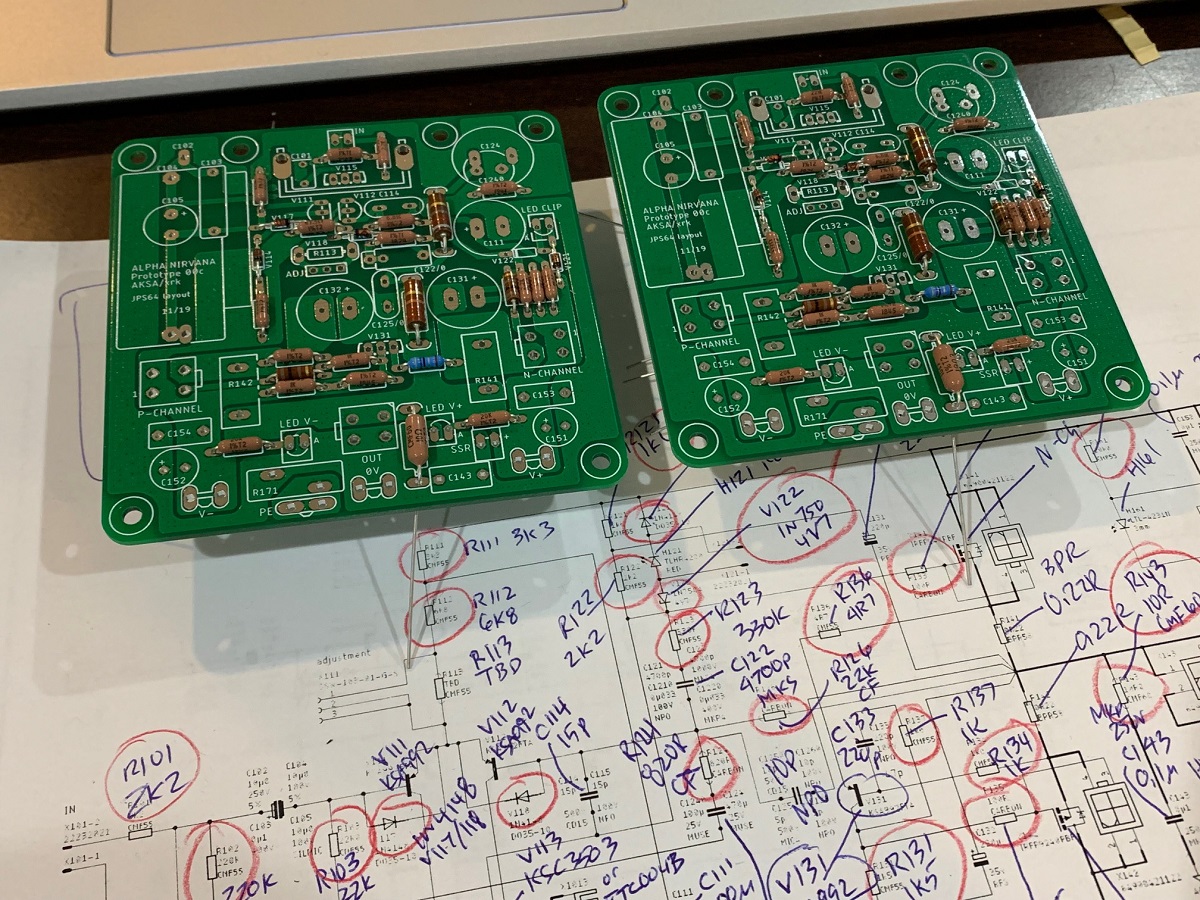

A little progress tonight: all small resistors and diodes stuffed. Realized that I have the wrong zener (2.7v vs 4.7v). I might just add a yellow LED for an extra 2v drop to the 2.7v to get 4.7v drop.
attachment.php
The Alpha Nirvana main board assembly is now complete. I have the snubber boards with their MOSFETs that still need to be assembled, then install in heatsink. I also have to connect my new 600VA AN-6222 trafo to the SLB to get the power out. Connectors for the MOSFETs and speaker outputs also need to be made. These are quite colorful amps!
attachment.php
attachment.php

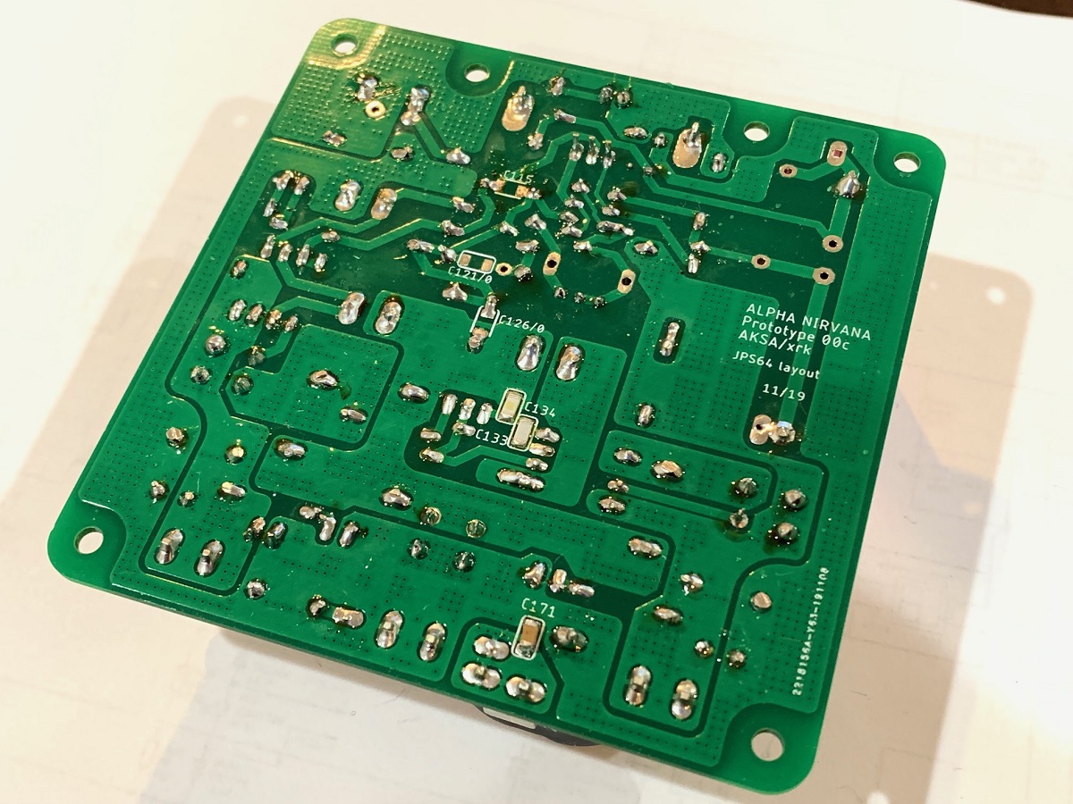

Backside requires installation of 3 SMT caps. There are open spots for more in case one does not want to use silver mica through hole ones on the other side:
attachment.php

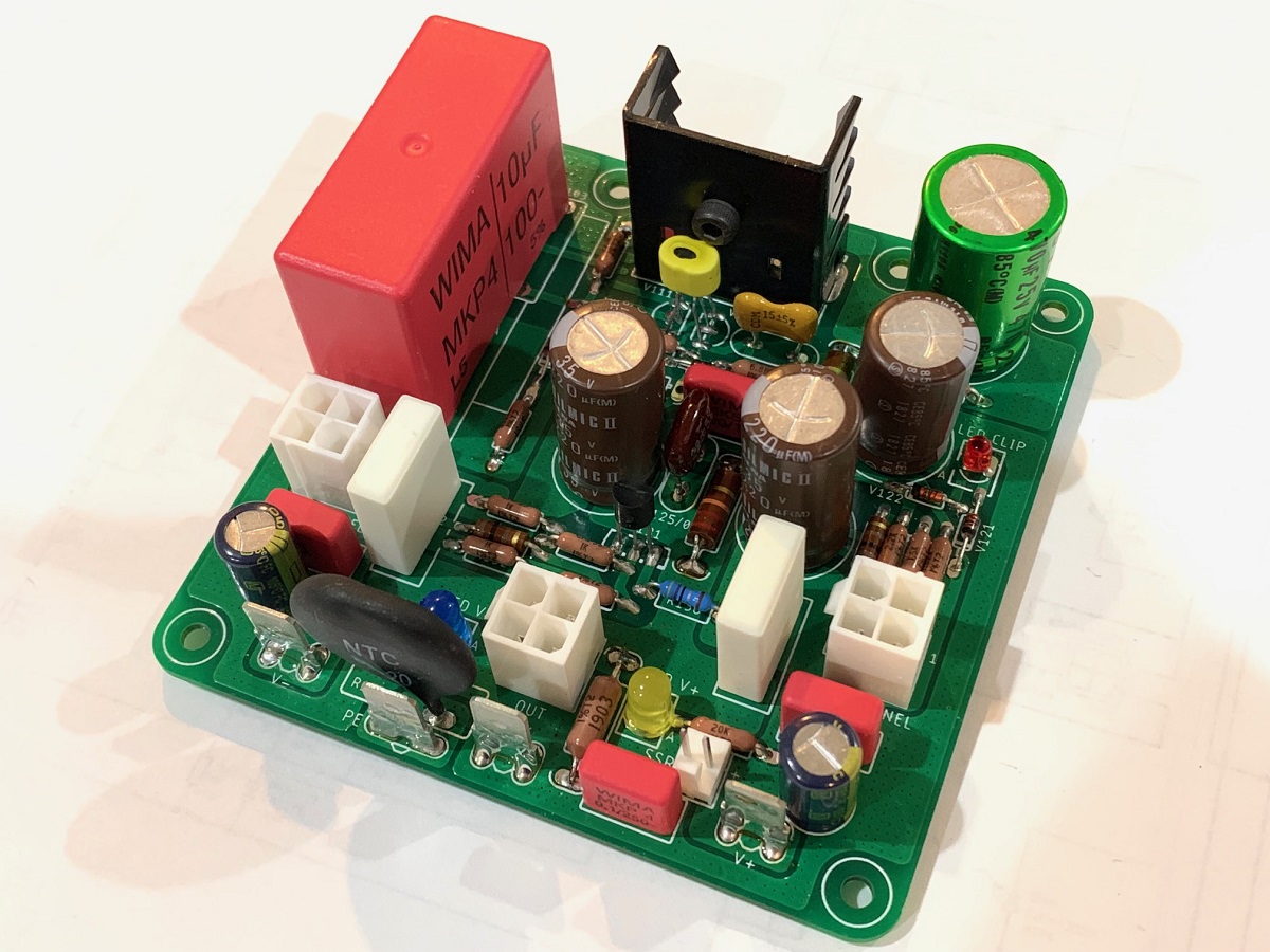

Stopping here for the night...

Indeed , they are colourful pcb's X, for once the green solder mask highlights the component colours well, three different coloured LED's, and again no adjustment trimmer pots - even better.
Let's hope the sound quality will match🙂

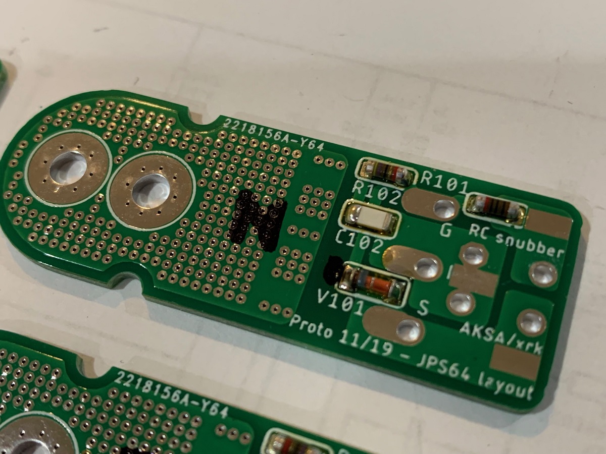

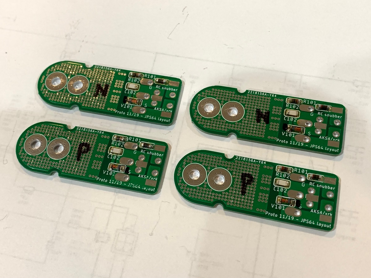

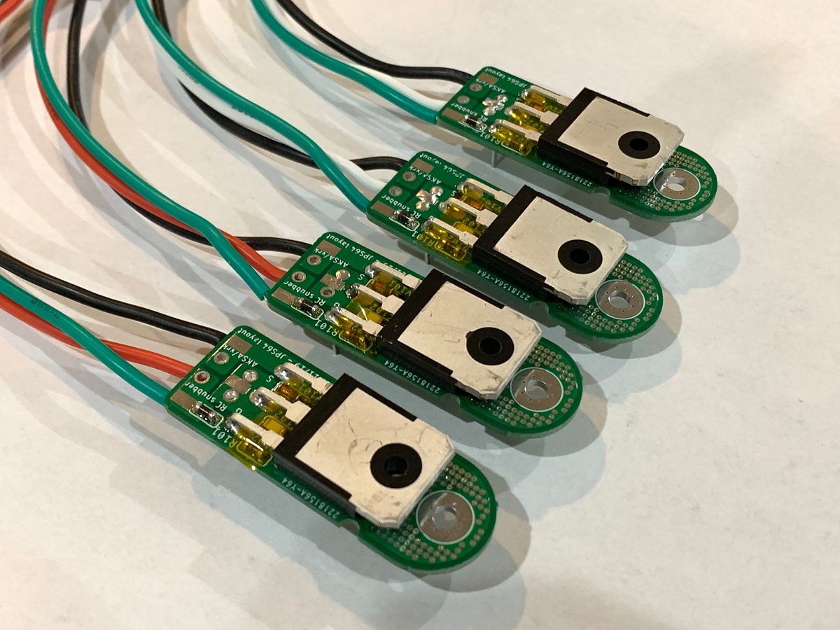

I was going to call it a night but decided to populate the snubber boards with MELF carbon resistors, a zener diode, and a 220pF NP0 cap. These were done with solder paste and a hot air pencil. Note the orientation of the diode for N channel (point to the bolt holes) vs P channel (point to the pins).
Nice X! Can't wait for you to fire up the PS, and get some initial measurements. Was your main board done with hand soldering or was it solder paste + oven?
Get some sleep!
Best,
Anand.
Thanks, guys. Feeling much better now with some sleep under my belt.
Main board SMT was soldering iron on one (brown X7R). But paste and hot air pencil on the two NP0 caps. It’s much easier.

Here are the snubber board with the Fairchild MOSFETs mounted:

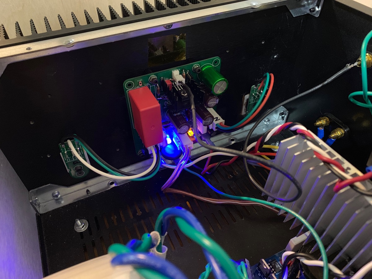

Here is the amp board mounted in a DIYA Store/Modushop 4Ux300mm Dissipante case with UMS heatsinks. The PCB mounts perfectly to the 4 standoffs. I mounted the MOSFETs pretty far away near the edges.
attachment.php

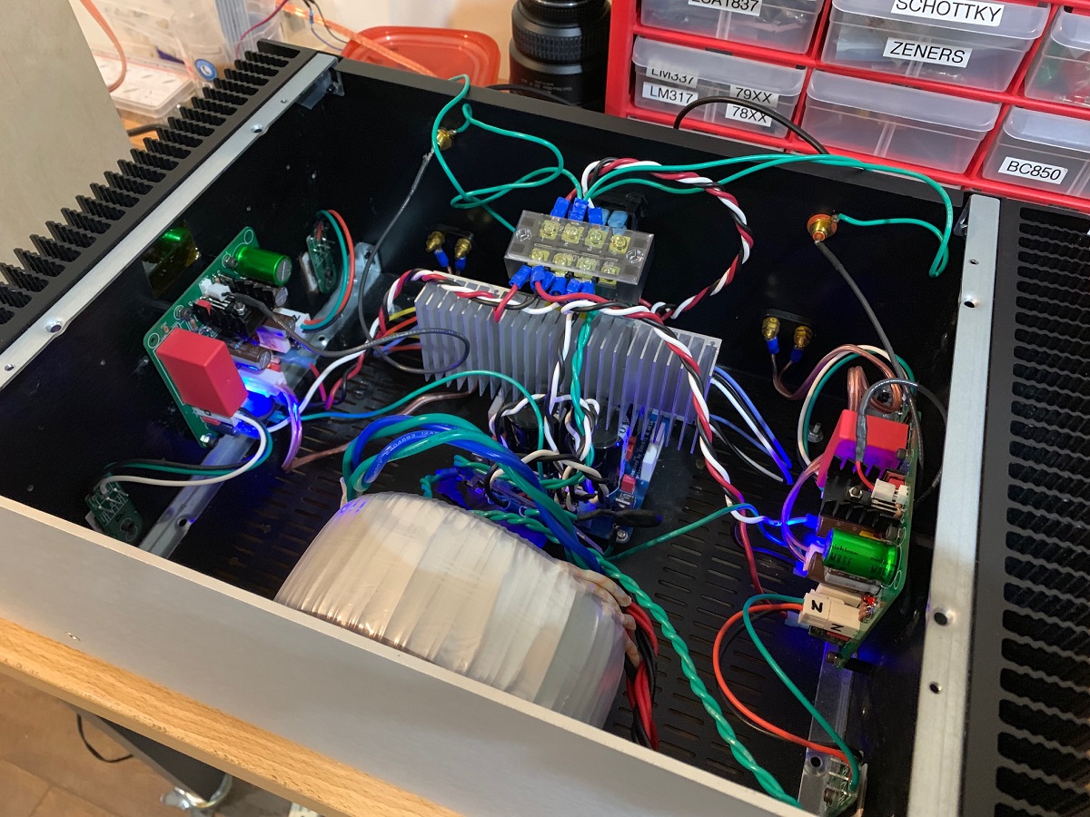

Another view showing the SLB and SLB heatsink. The trafo is mounted towards the front and standing on edge to have enough room.
attachment.php

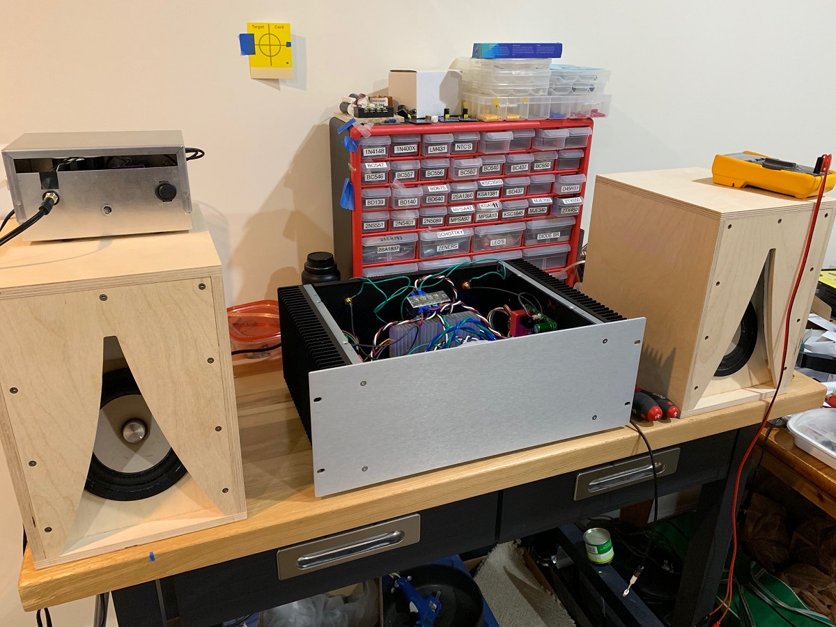

I have listened to about 3 songs so far on my W5-2143 XKi full range speakers. Very nice sound - deep powerful bass. Will debug the ground loop some more but about time to stop anyhow as it is past 4AM here. Here is a shot of the amp with the speakers on my test bench:
attachment.php
Great news is that the design and layout are all good. Never have I fired up such a big amp (600VA trafo and 40+w in SE Class A) so uneventfully. Although precautions were taken such as having multiple DVM's connected to test probe leads across the source resistors to monitor current, and also let it burn in for 10 minutes while standing far away to make sure none of the electrolytics blow, should I have made a mistake in installing them.
So the amp is pretty much at steady state temperature and suprisingly, the 4U x 300mm heatsink can work here: I am getting 58C (just a tad over the usual 'allowable' 55C) at the hottest points near the ends of the heatsink. 52C at the middle of theatsink and 72C at the top of the snubber boards where the MOSFETs are. This means that a 4U x 400mm will run very comfortably.
I am running +28.3v and -28.6v at 1.65A for 94w of dissipation per channel. This is with the top lid off.
Alison Kraus & Union Station sounds great. 😀

Well done X, I know you were probably in a hurry to get the build done and congratulations on having it play without any problems.
Now just imagine how good the amp would look when you get around to tidying up the internal wiring (not criticising , but that is just me, I like a tidy chassis)

Great work X. I agree, a 4U/400 will be better all around especially if someone wants to use dual SLB's, single large donut and optimum cooling all around. I was/am a still little nervous about the MOSFETs with flying leads (due to a propensity for oscillation), but it looks like there are safety features built in for that. More testing will show for sure, thanks for all your efforts!
