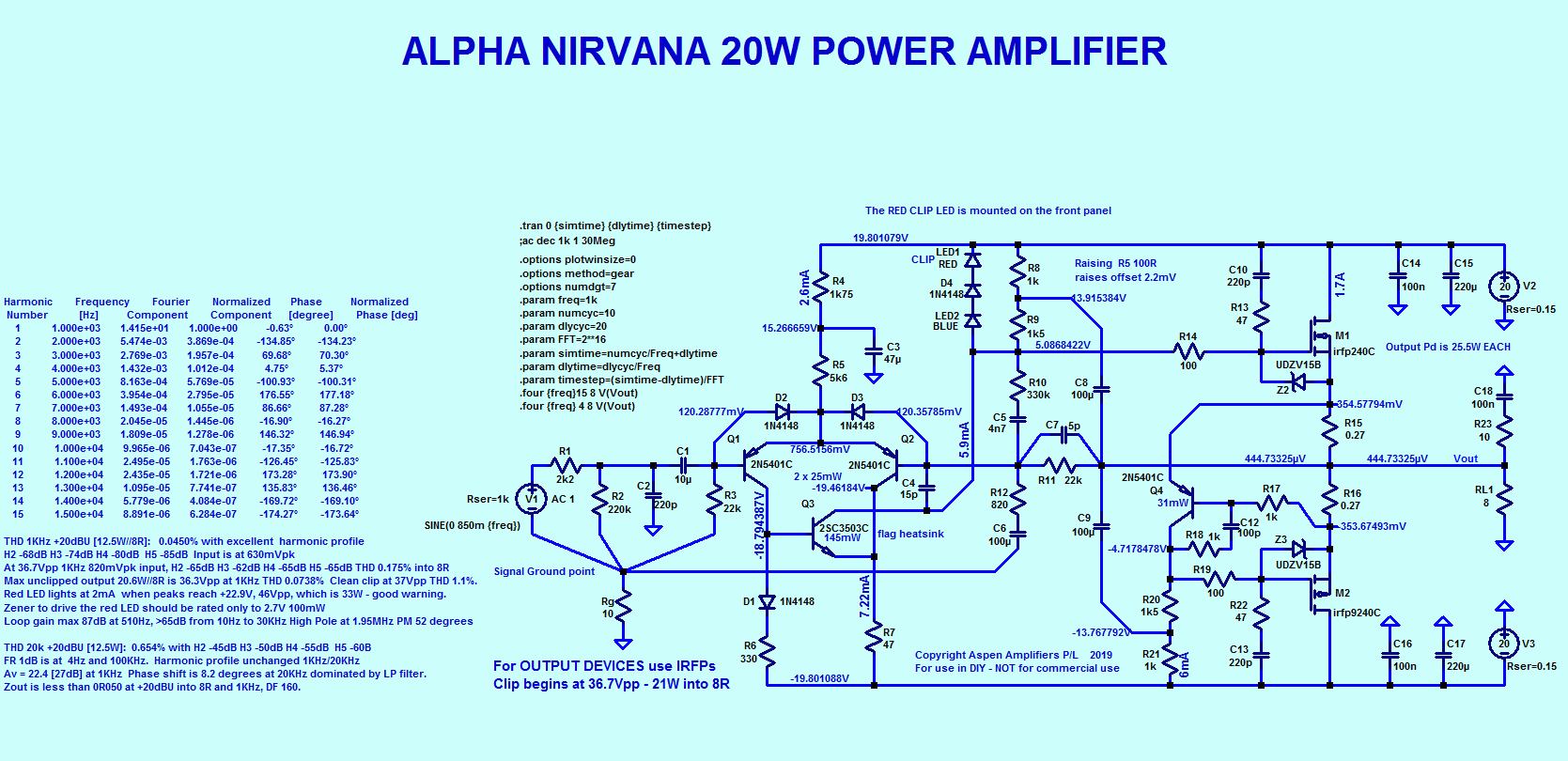

Here is the redesign of the ALPHA Nirvana for 20W//8R.
This amp uses 20V rails, and performance is not as good as the 27V rails and about half the power. But it's essentially the same amplifier with very similar harmonic profile. Interestingly at 20KHz and 12.5W//8R the H2 is at -45dB, which is almost identical to a tube like 6SL7 operating at B+ of 340V and 1.6mA plate current. It clips at just under 21W, and quiescent is 1.32A. Front end is slightly changed; R4 could be a 2k pot to set offset. Quiescent is set by the two 0.27R resistors in the sources of the outputs, which each dissipate an easy 25.5W. This output stage is ideal for passive cooling, and total power for a stereo is 105W. With >94dB/metre/watt speakers this would be a killer amp. Max loop gain is 87dB at 510Hz.

Hugh, did you mean to say “NOT” in “performance is not as good as the 27V rails”. If so, could you comment on how it is not as good, other than output power?

Thanks for the update Hugh and X. For the 2 circuits as shown, one by Hugh and the other by X, there are some transistor differences. Hugh shows type 2N5401 for Q1, Q2 and Q4, whereas on X's schematic he has these as KSA992. Also Hugh shows 2SC3503 for Q3 and on X's it is a TTC004.
The question is - what are the preferred types for this amp design. Maybe both Hugh and X can give us their views? I think it would be fair to say that Hugh's types are older and the ones X shows are more modern and would be more easy to source (but I have all of them - so what to choose?)
Gary..
Francois G,
Good question. I found after many sims that the loop gain of the 27V rail was 101dB, peaking at 250Hz. For the 20V rail it was 87dB, at 510Hz. In fb amps, any reduction of the intrinsic distortion (the distortion inherent in the topology before any fb), is largely driven by the loop gain, so with a reduction of 14dB for the smaller amp (0.0450% at +20dB) you could reasonably expect distortion around five times more than the larger amp (0.0170% at +20dB).
This is not prescriptive, because other issues intervene, such as component choices, how they behave at lower voltages and to what extent the parasitics influence the dynamic conditions. In this case, we have an improvement of almost 0.03% with the higher power amp, and it is significant that +20dB output for a 20W amp is closer to the rails than for a 39W amp. The best linearity is generally at an output around a third the peak power.
Gary S,
My original schematic is the base document, on which I have done all the careful LTSpice measurements. JPS, the layout designer, and X, the coord/production manager, have readjusted it a little for the production schematic which is identically topologically. All the LTP and VAS devices used, 5401 v. A992 and C1845 v. C3503 and outputs FQA40N25/FQA36P15 v. IRFP240/IRFP9240, will all work just fine. I like to use the 5401 because it is a very tough transistor (600mA/160V v. 50mA/120V) and its 630mW max dissipation makes it difficult to blow up, and it's a bit faster than the A992 (min 100MHz v. min 50MHz). The 5401 does have a lower beta, but it's much more linear than the very high beta A992, being flat as a billiard table from at 0.1mA to 10mA, and it's very quiet with low Cob (6pF). The problem is that the pinouts are different between 5401 and A992, and since X and JP prefer the A992 the layout is revised. The KSC3503 is an outstanding transistor for higher power amps, but the A992 is ideal for the VAS of a low power Class A. I have no difficulty with using any of these devices, but as for every component in any build, you MUST TAKE CARE WITH PINOUTS.
Thanks for this great explanation of the differences in expected performance. It will be instructive to see how they behave in physical builds. Thanks again.
