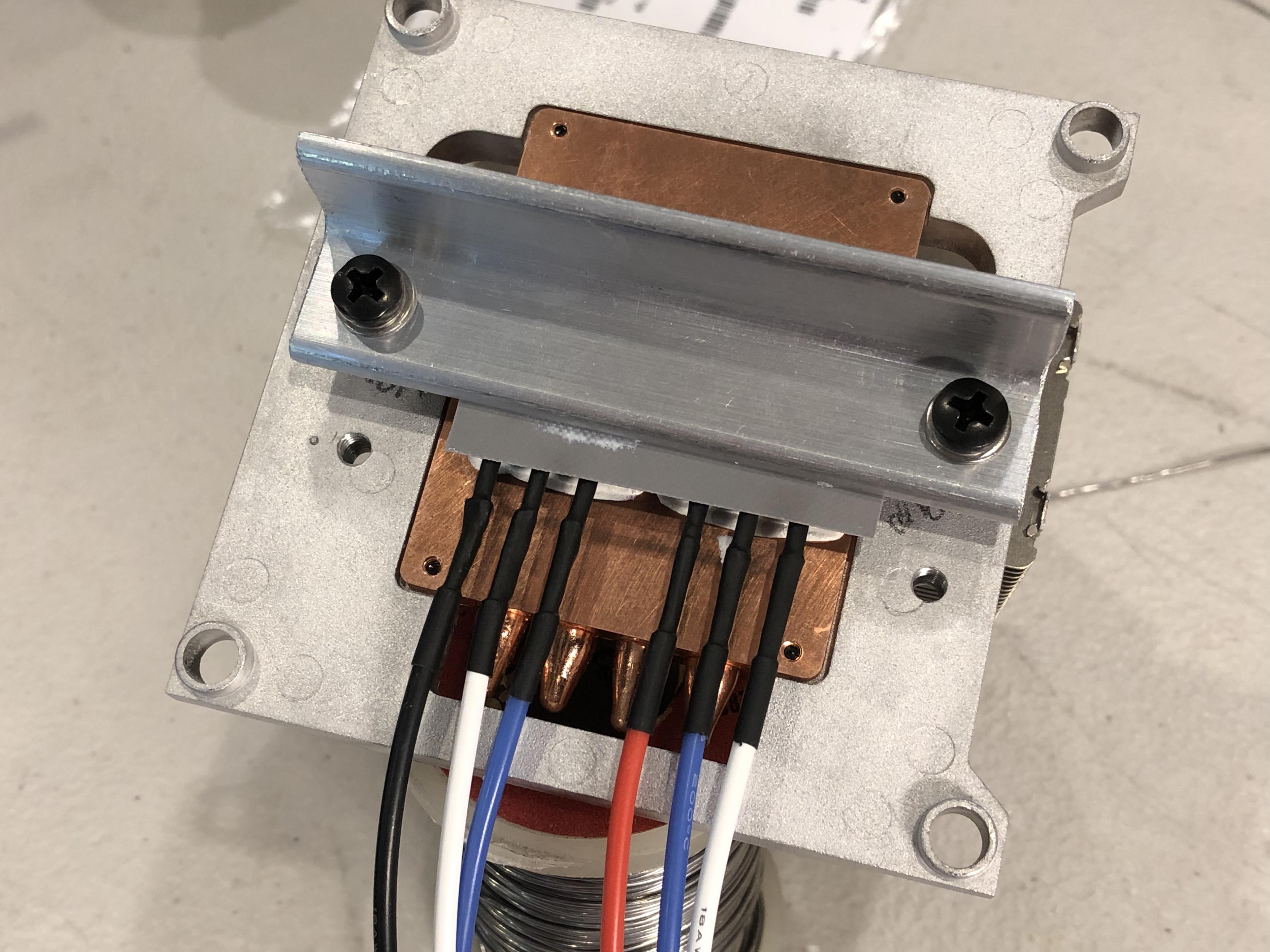

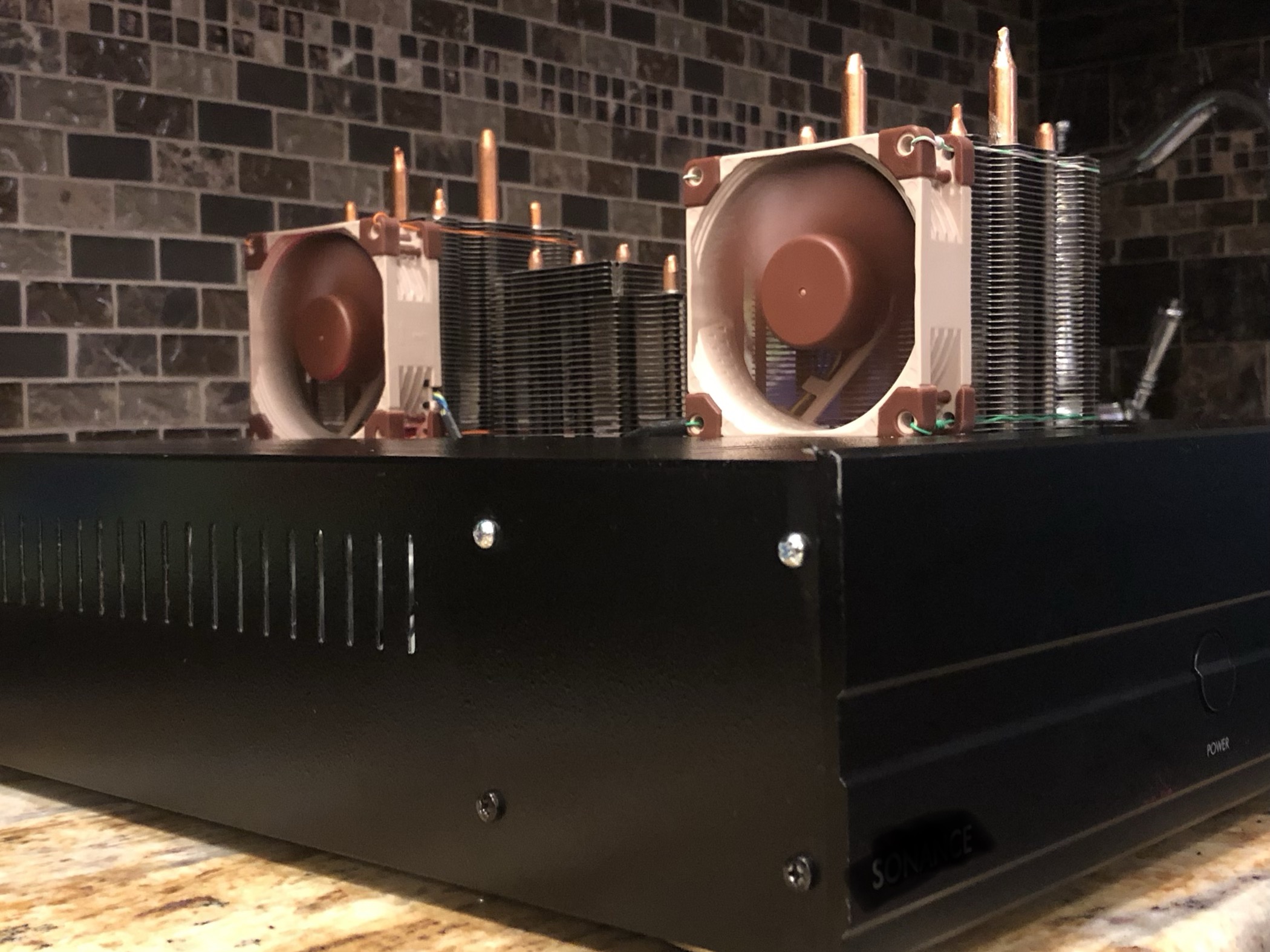

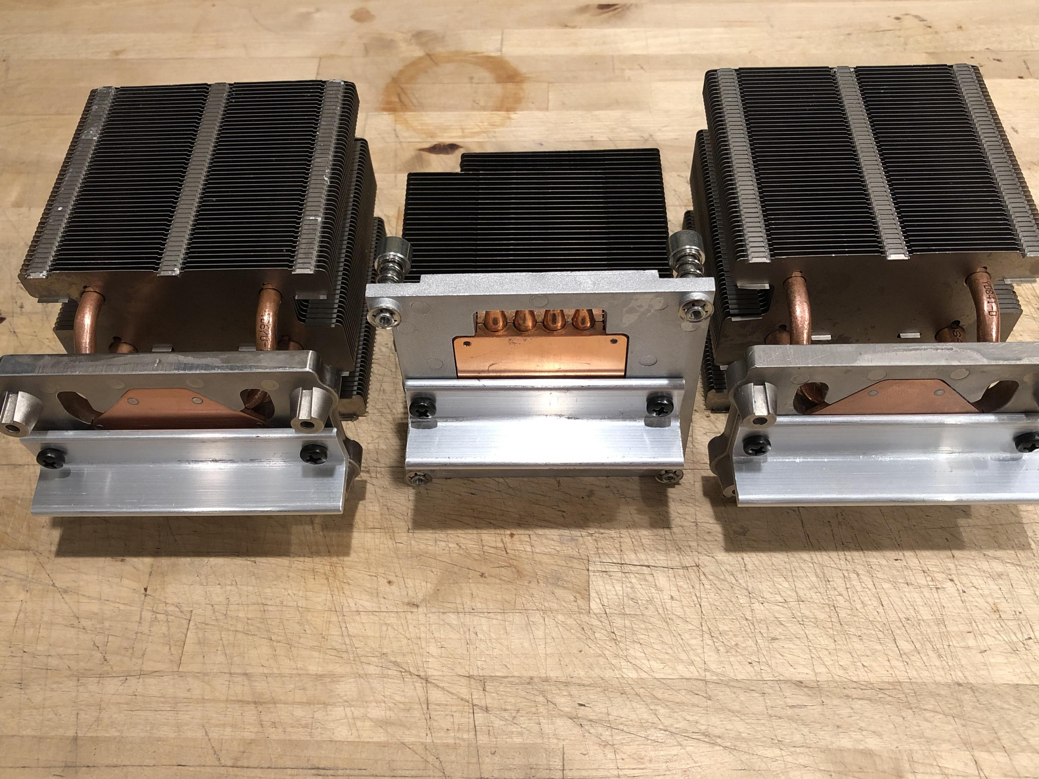

If you keep case below 50C on an IRFP at 45W you could expect them to last about ten years used two hours a day. I should know; I have quite a few at this temp and all work fine after 25 years. Each increase by 11C starting at 25C will half the MTBF, so 4-5 times less life at these ratings IF YOU CAN KEEP TEMPS BELOW 55C.
Otherwise, for wonderful life, use a CPU cooling tower with fan. Cheap and effective!
HD
HD
Something like these 😀
