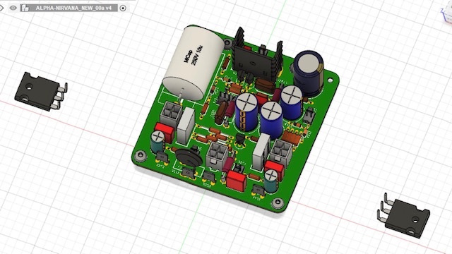

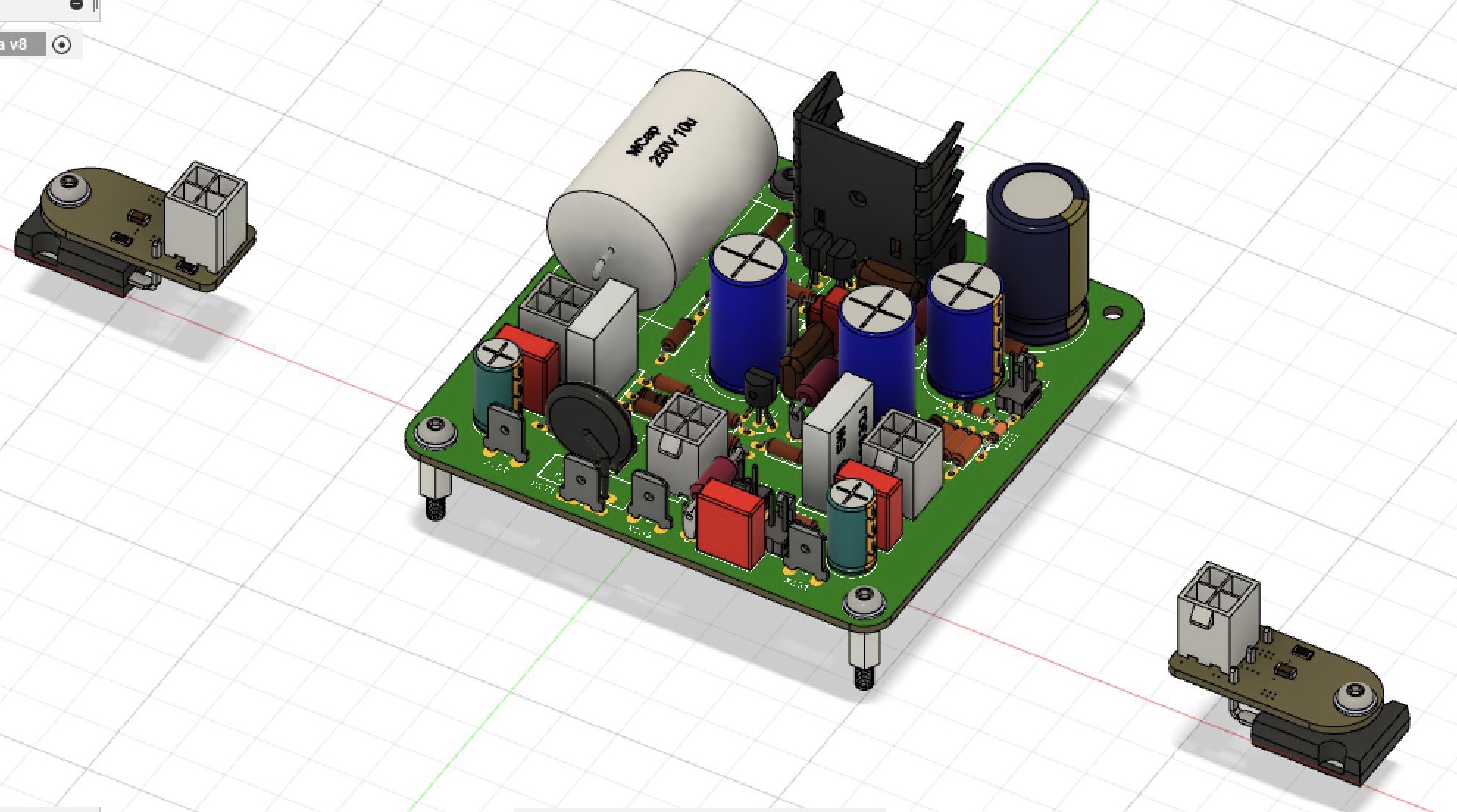

Yes, we will try - let me see if something like this can work - but necessitates a 5U Deluxe 400mm deep chassis. The existing UMS holes are too close to the bottom and lack two key locations for an idead dual high output MOSFET configuration - so maybe the standoffs fit UMS for the PCB proper, but we are probably going with Molex minifit Jr and flying leads for the MOSFETs to be located in ideal thermal locations. PCB is only 90mm x 90mm.
UMS compatible PCB standoffs:
Flying leads for MOSFETs:

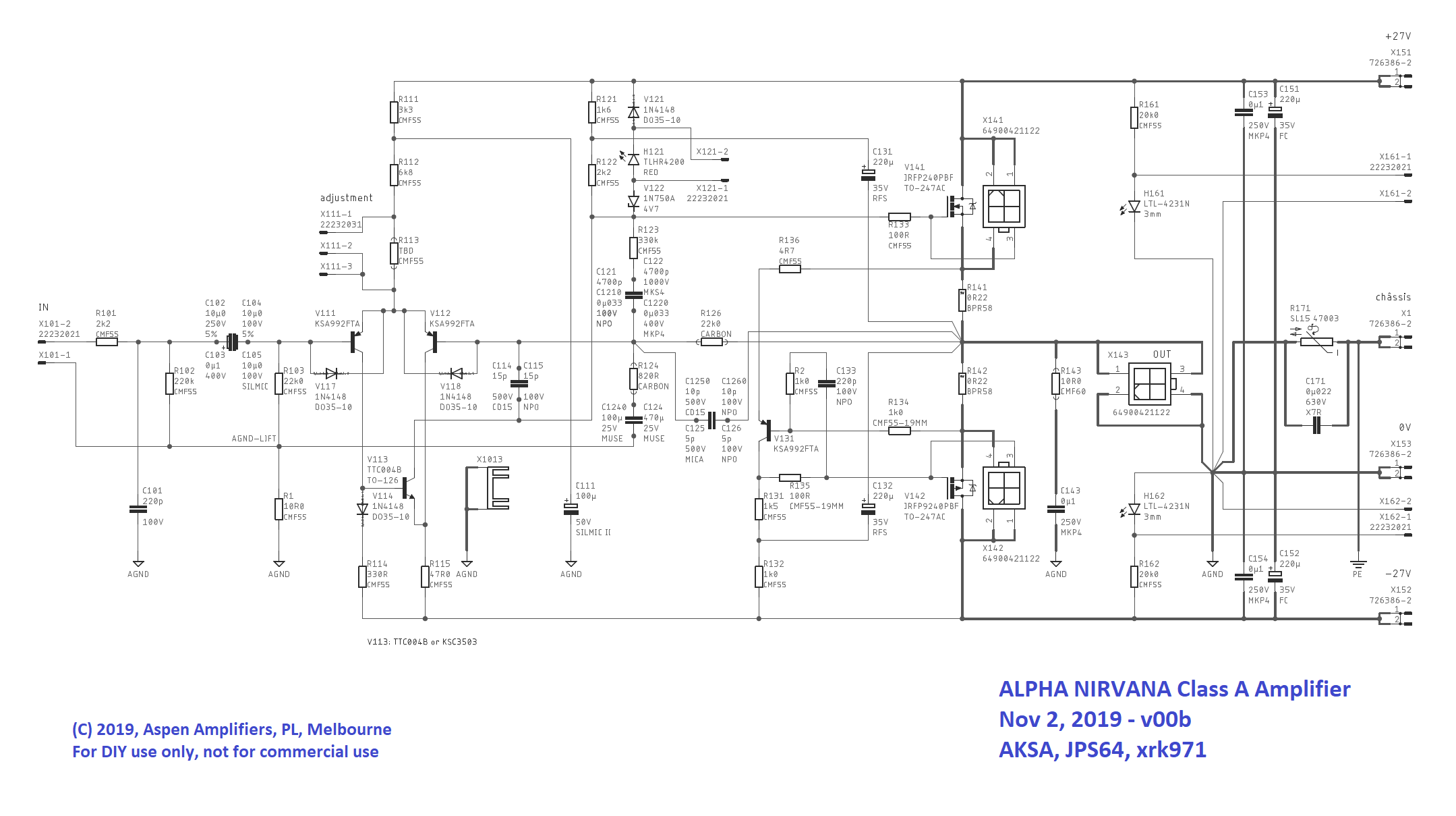

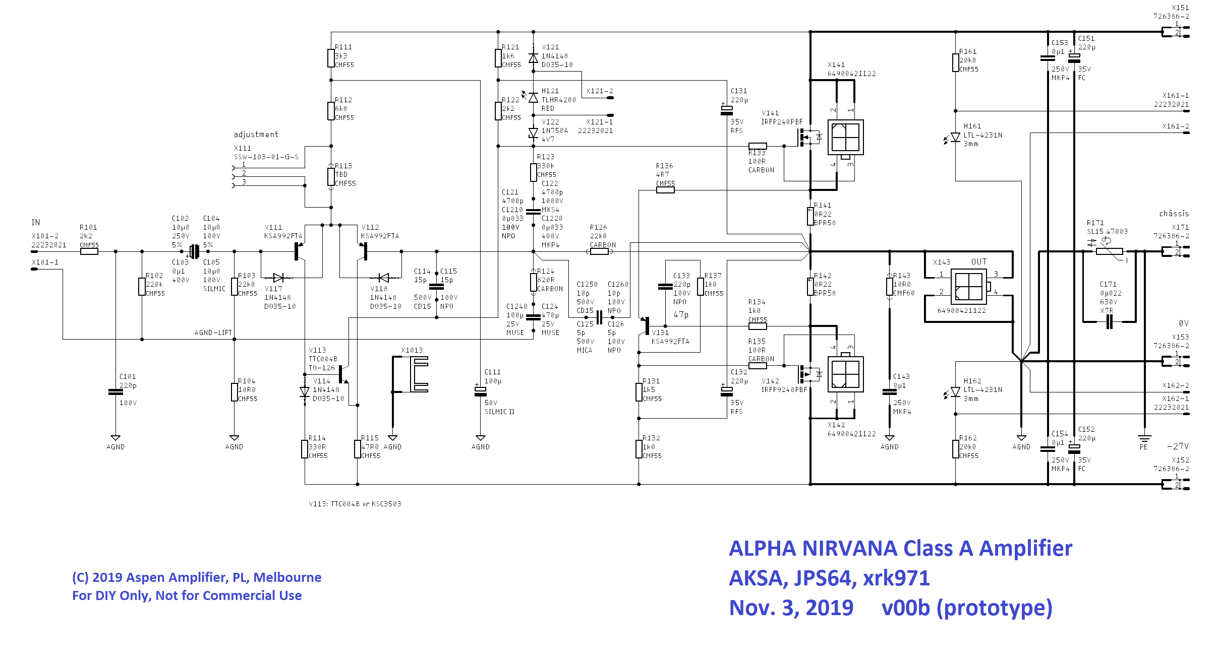

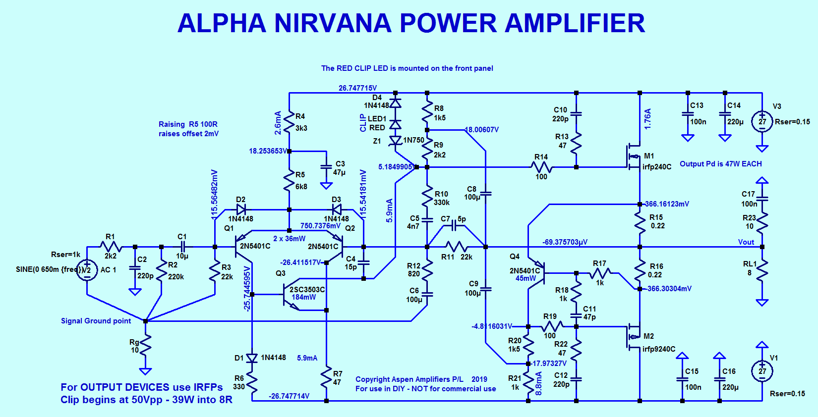

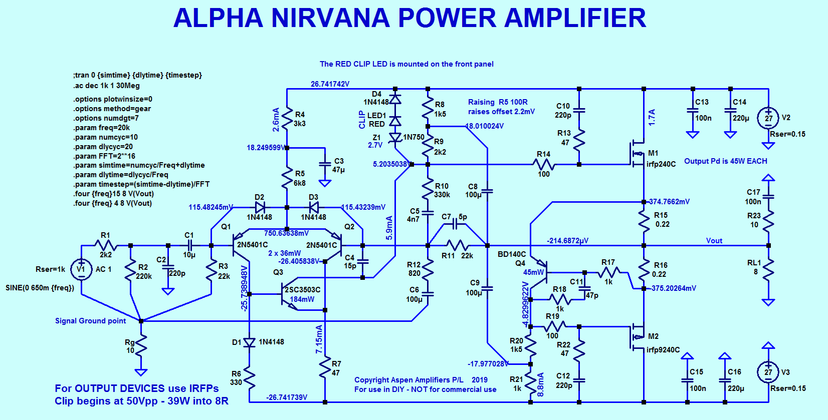

This looks great, Hugh. Looks like belts and suspenders are in place to handle any oscillation that may come along. The 2N5401 will be replaced by KSA992. There are some Fairchild output options (FQA40N25/FQA36P15) with higher thermal ratings that may require the drain to gate snubbers, but the option is therein any case. Nice to have clip indicator - a Class A amp meant to be used well above the First Watt!

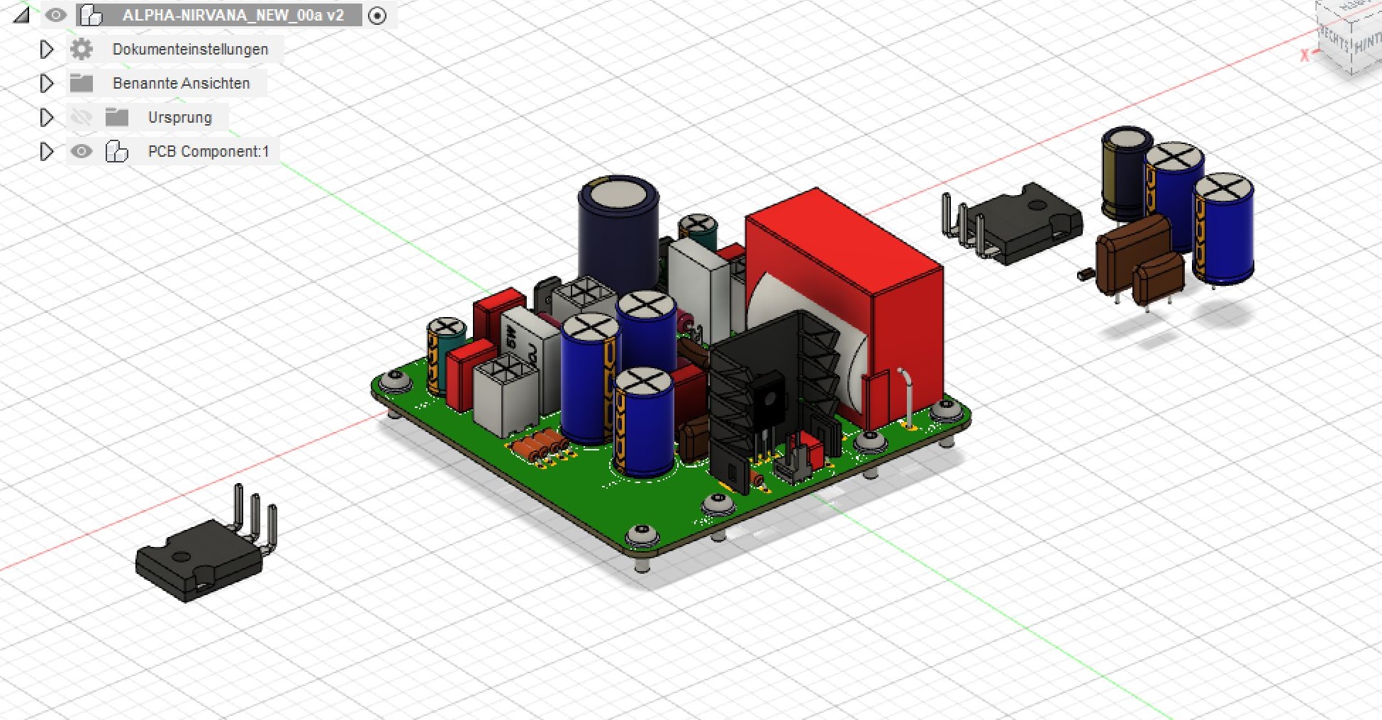

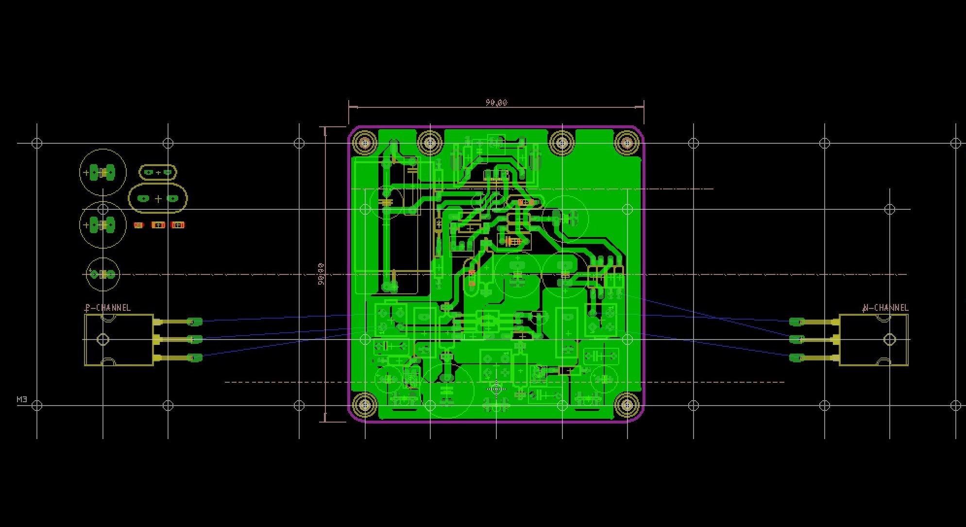

More progress on the Alpha Nirvana layout by JPS64. Looking really good.
ALPHA 39W Class A Nirvana version
Latest corrections to the pcb, hopefully final.
With 90W total dissipation and 39W output at 50Vpp just under clip, this is a 43% highly efficient Class A with all the beauty of Class A sound. There are many protective diodes and caps around this circuit so it should be extremely robust and reliable. With a larger cooling pad on a CPU tower, you can fit two TO3-P devices alongside and so only two of these towers are needed for stereo. This makes this minimalist, cheap and easy to make and very compact.

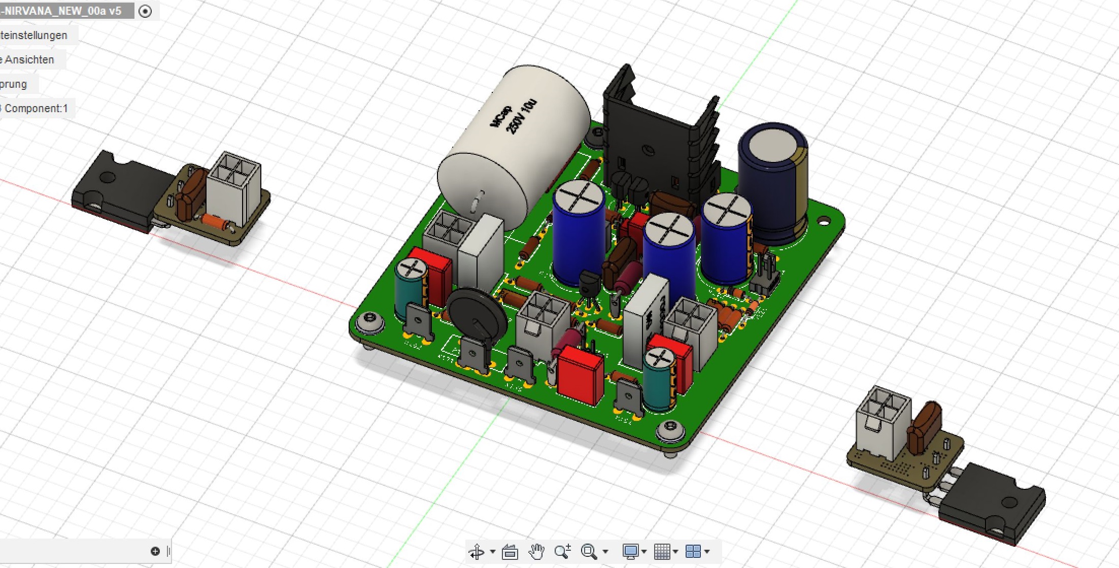

More progress. JPS64 is making some new helper PCBs for the MOSFETs with built in snubbers and the gate stopper resistor. Shown are SMT chip resistors but we are changing to carbon film MELF for their superior high pulse current absorption. The helper PCB also doubles as the large washer to clamp the MOSFET to a heatsink. Although this would not be needed if using a CPU cooler.
In which case, one could use an alternate format with no tab or a longer tab to clear the interference with the top mounted SMTs.
We have never used gate protection diodes on the other Alpha amps and have not run into any issues. Having the snubbers and gate stoppers near the MOSFET legs is important though.
