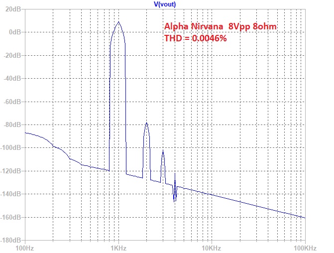

Some predictions of the harmonic distortion profile in LTSpice at various power levels.
Code:
Here is 8Vpp or 1W into 8ohms:

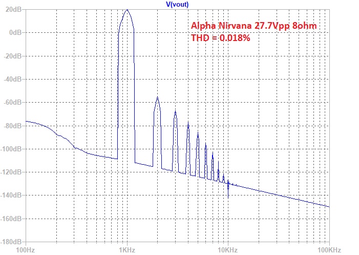

Here is 27.2Vpp or 12W into 8ohms:

I have added an RFI filter to the input and this dropped the gain a bit to 27.0dB. I am using models for the KSA992, and also replaced Q4 with a KSA1381 (or TTA004) to provide room for a heatsink in case it gets too hot.
The FFT for 8Vpp into 8ohms looks like this:

And at 27.2Vpp into 8ohms (12W), the FFT looks like this:

I think Hugh may be making some last minute tweaks to the circuit, so I won't post any updated schematics until then.

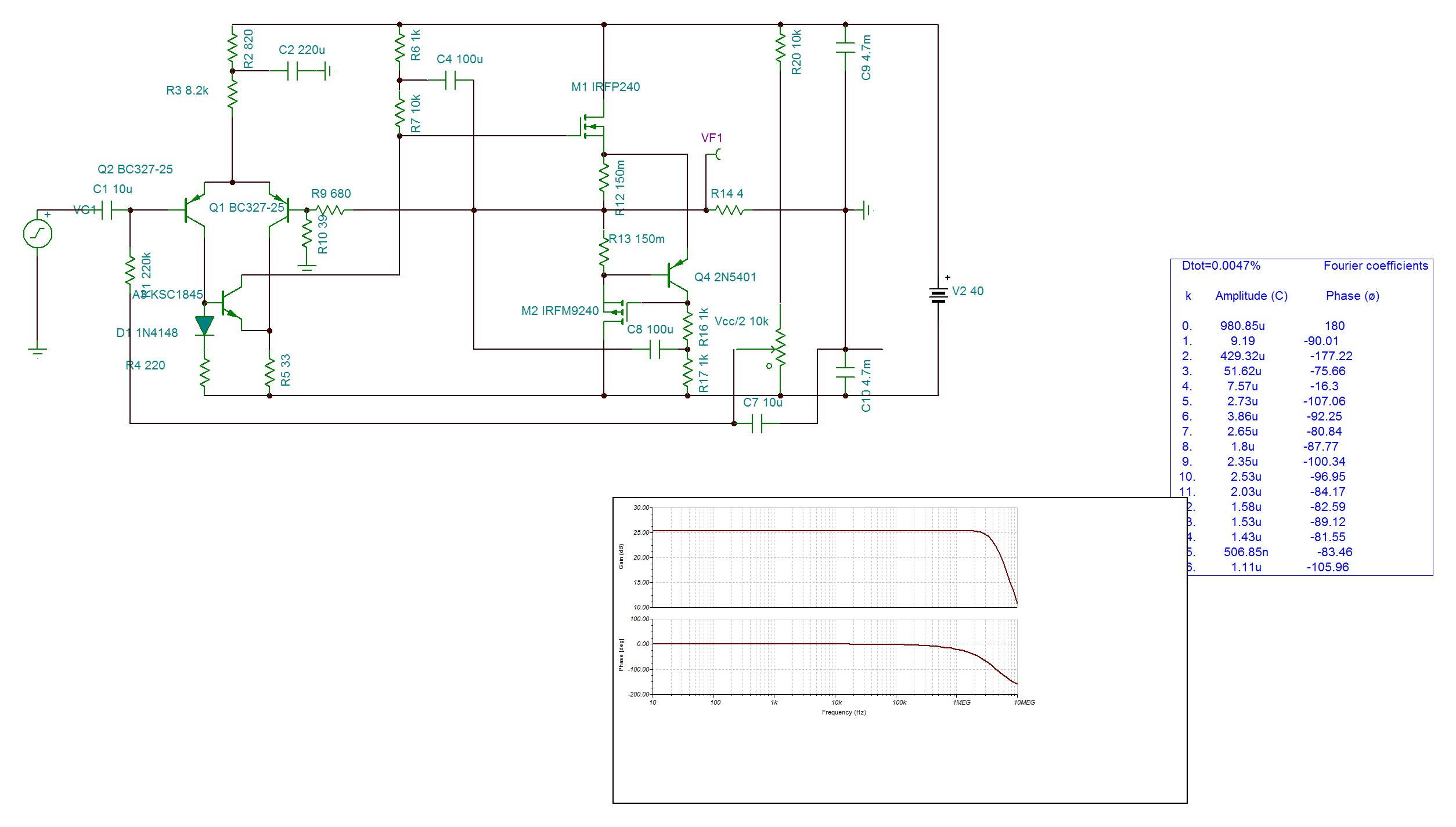

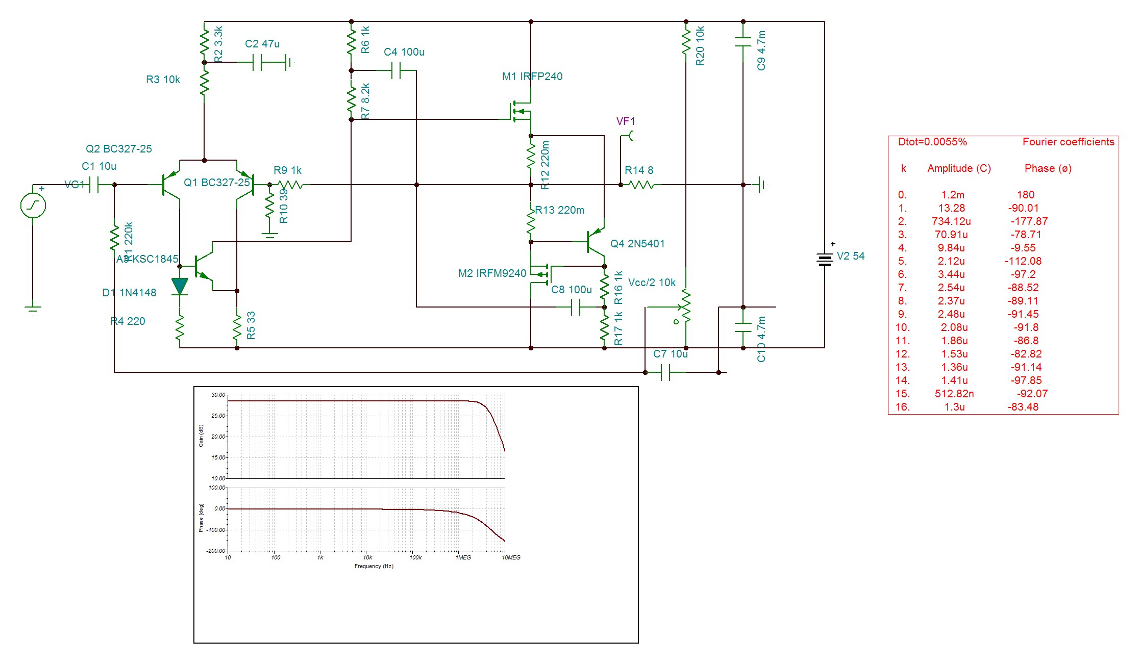

With Tina , it is possible to start the distortion measurement after an adjusted delay because the beginning of the burst there is the transient function . To know the measurement is the steady state distortion the phase shifts should be 180° for the pair harmonics and on phase for odd ones . Your measurements are wrong , at 13Vp or 10W , Tina after 10ms delay measures 0.012% lower than yours , look at post 16.
R7 plays important roll in trade off ,speed vs distortion . I adjust it for optimum speed to get 0.0055% Dtot. There is still margin in NFB as the sensitivity is high, but I will leave it to the spec of the designer. Tina doesn't have the bc327/40 model , with, it will still be better.

One thing; the active CCS is concertina, the voltage across the two sources resistors will remain constant at 0.65V, but the two resistors will pass conjugate currents which will always sum to 3.4A. The two resistors are identical so that the see-saw action is completely symmetrical.
