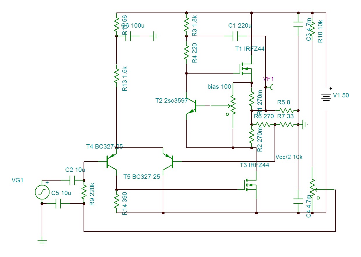

You have applied 100 ohms resistors on the gates , I suppose by tradition . R12 is strictly to decorate* the PCB , whereas R16 decreases the pole created by R15 and reverse capacitance of Q4 . Eliminating both you just get the effect of R15 by increasing the parasite pole higher . See the graphs and distortion ,measured in open loop without compensation capacitors.

If the circuit is oscillating and have poor bass , you know now where to look at. Think a little bit why electrolytic, ceramic ,high quality capacitors have magnetic leads . Non inductive resistors for audio are not axial .I think make numcycle=100 and that should do it but it’s aggravating to wait that long.

KK, you have given us useful information..... there is a clear danger the see-saw CCS here may oscillate at 10MHz and we need to be careful with component, wire and layout. Thank you for this; more than this we do not need to accept your presumptive tone and believe that we are building 'your circuit'. Ridiculous and insulting. We hear your points, we thank you for them, and we will act with care, and since there is no money transferred, please leave it at that.

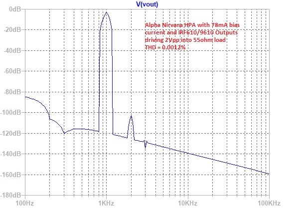

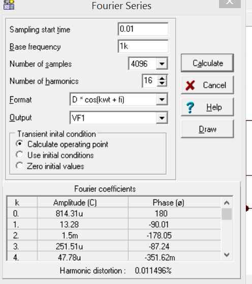

Just replace the outputs with IRF610 and IRF9610 and source resistors with 4.7ohm ea. This gives 78mA bias current.
Here is FFT for 2Vpp into 55ohms, THD is 0.0012%:

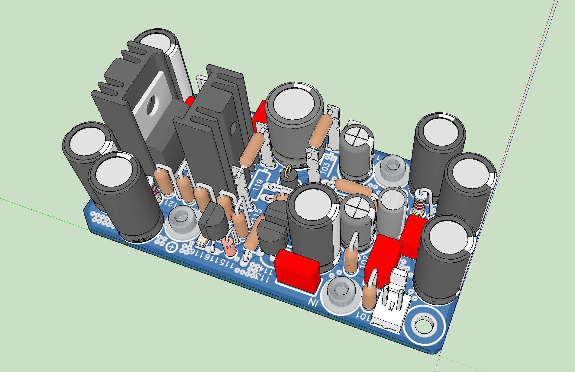

This could all be stuffed onto the usual Yarra daughterboard format. Sort of looks like the Melbourne actually:

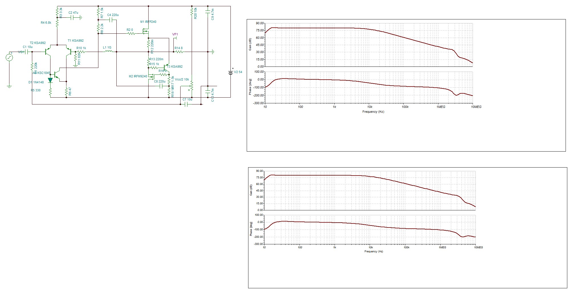

Aksa ,If you read again , I said the principal of this circuit is same described in CCPP . My nearest circuit resemble yours is shown bellow . As Begun said it is a variant of SRPP . If I show you this because it rich with experience. First the bias is not as your sim can show . The sense resistors are 5% each , this gives +/- 10% variation on 1.8A . If you look on Telefunken datasheets for IC/Vbe variations by manufacturing for BD139 or BC327, the unlucky DIY can end up with 2.1A or 1.5A bias . In the circuit if I use BD139 (Ft=55Mhz) instead of 2SC3597 (Ft=800Mhz) which was the initial choice , the sound of the amplifier becomes ultra comfortable to listen . The higher I was pulling the volume the more was requesting my unquenchable ears , until the neighborhood alerting me to be excessive. Yes , I don't feel the sense of loudness as the transients are blunted but it is great sounding to cover a noisy environment with more agreeable . The upper circuit can also be realized by DN2540 in compound Darlington with 2SA1943. It doesn't require bootstrap the base emitter resistor 10 ohms and two sense resistors 0.5 ohm each resulting superior quality . If I only posted the CCPP because in all other configurations I was lacking in bass performance , when I got the perfection I was expecting with CCPP , all others went forgotten. I have great impression your amp will also suffer of lack of bass , unless 3 stage configuration that I never tried makes miracles.
Now that I have superior sound character with class AA that generates odd order harmonics of opposite phase to subtract with that of the speaker's and higher the dynamics , SRPP circuits , as class A ,belongs to the my past .

Many thanks, KK, it appears a slow control CCS transistor is better rather than a fast one; a good example would be an A992 which is around 50MHz min, similar to the BD140 you used. I will also use a 100pF from base CCS to gate pmos, and I have noticed considerable oscillation around 3MHz coming off negative peak without it.
We hear you, and offer thanks for your good advice. There is another variant of this active CCS I am considering too.

It looks like Alpha Nirvana won’t be a 1:1 drop in footprint with Alpha 20. The thermal requirements dictate more spacing between the MOSFETs. We tried but doesn’t work.
Probably not the end of the world X. Can it still fit UMS format? I think that's the more important part.
