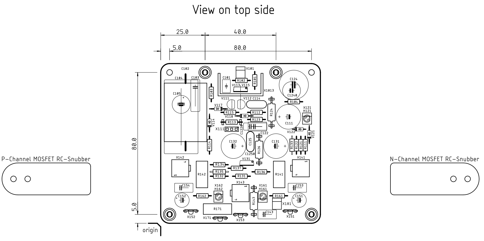

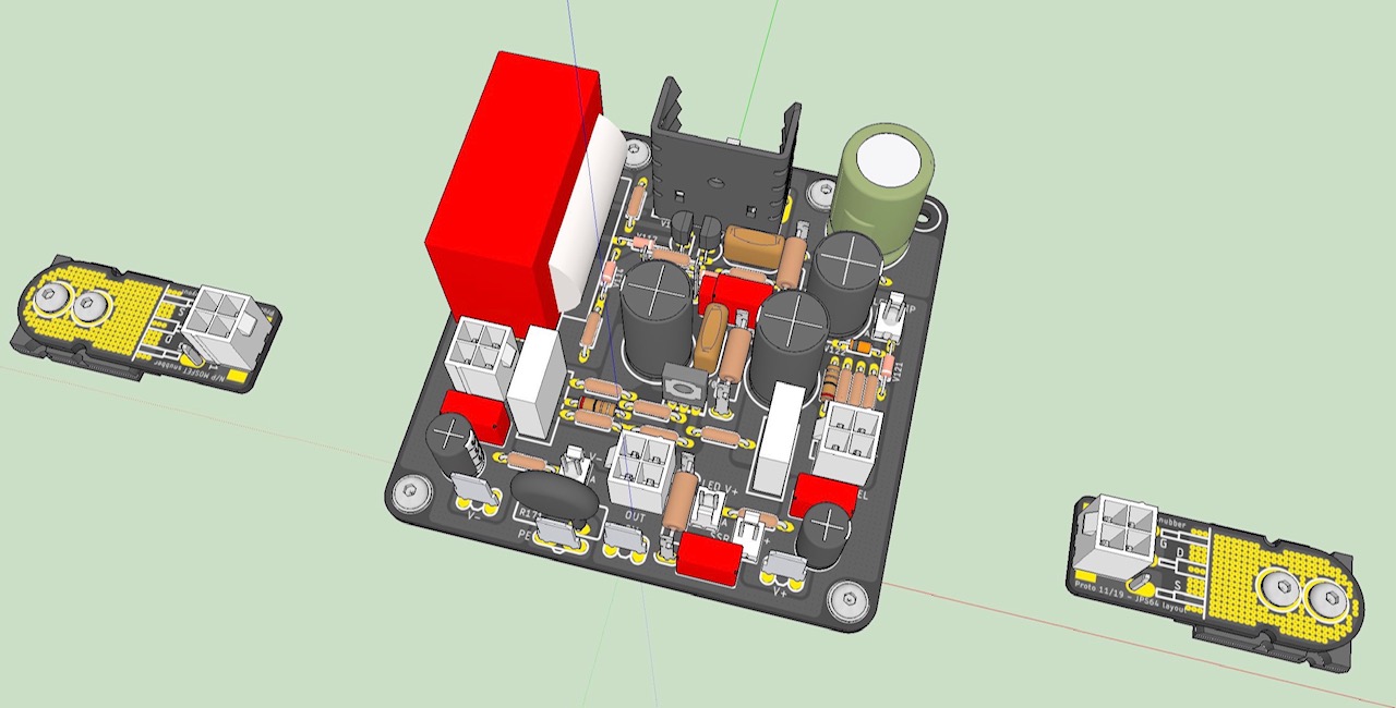

Ready for making PCBs, finally
I want to thank JPS64 for another amazing layout and for his patience in working with me and Hugh, we kept coming up with changes every day. But JPS64 never complains - instead, he says he likes challenges!
Thank you, JPS64! :cheers:

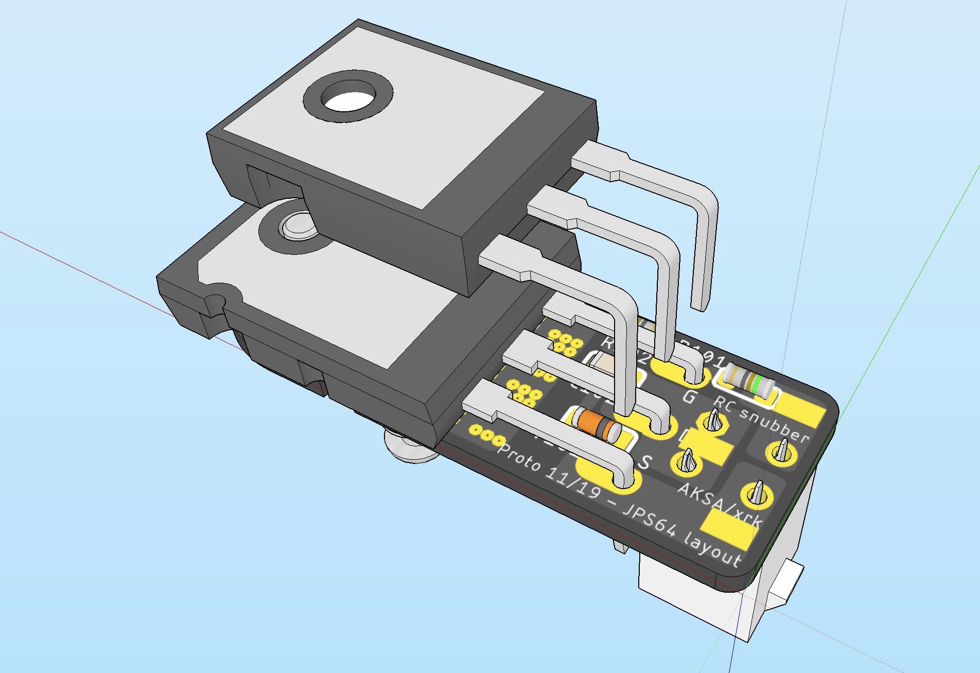

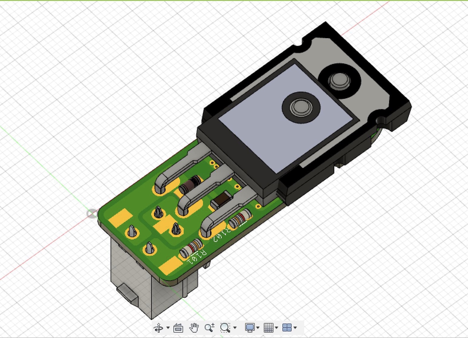

Here are the fine details of the little helper PCBs that connect the MOSFETs to the main board and provide the important job of snubbing, gate stopping, and Zener protection. Because of all of these functions packed into a small space, and the desire to get them as close to the pins as possible, we had to go with SMT here. So just a few easy to solder SMT parts. The helper PCBs also serve as a clamp washer for the MOSFETs (choice of either TO-247 or TO-264) if using with a conventional heatsink - or a clamp bar spacer of using with CPU cooler. Hence they have lots of thermally conductive vias. Use of Molex Minifit Jr connectors are optional - straight flying lead soldered joints are also possible.

Thanks, Vunce. JP did all the work here - and he came up with a very elegant solution, and what I believe is a very handy tool for other amps, should anyone wish to free themselves of the need to connect an output MOSFET to the main PCB. By having the snubber, gate stopper, and protection diode all on the little local helper PCB, I think it really opens up a lot of opportunity for anyone wishing to move their MOSFETs off the main board and onto a non-conventional heatsink. I can think of a lot of options.
@Vrystaat: thanks for your suggestions - we aim to make a bullet-proof amp, ready to take on any potential oscillation. Will have to wait for JPS64 to send out the updated schematics with the new layout and post processed CAM files.

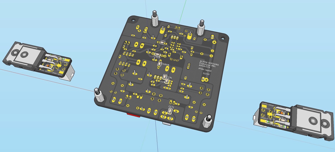

Verification PCBs just ordered
I double checked the Gerber files with a magnifying glass and all looks good. This is the first project that JPS64 is making on Fusion360 CAM processor so we are making extra sure things all look good. Also will only get a few boards to test in case they are duds. I am sure it wil work though! :xfingers:
Here is the stuffing guide:
attachment.php
Placing the order makes it just that more real. Only 1.6mm HASL finish but 2oz copper in green solder mask to distinguish from production boards which will be blue.
