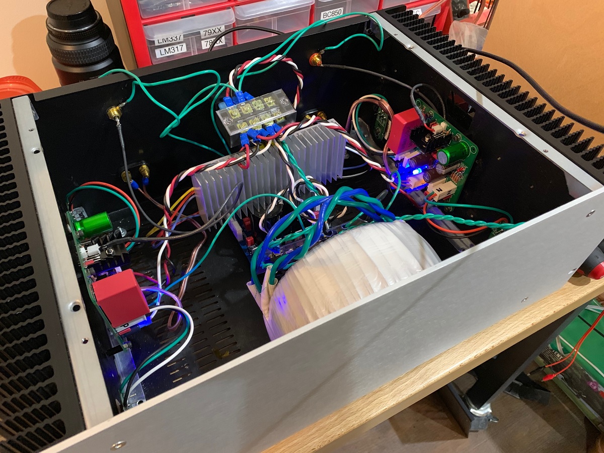

If I decide to keep this amp in this case I will tidy up the wires. This is a development and testing chassis so no point in making wires neat. It’s all about convenience and speed of build.

Yes, will do some more listening with my main speakers this week to really give a good review. Also, some measurements too later. I really like the whole concept of externally mounted MOSFETs with snubber boards and flying leads. The ease of chassis installation on this build vs one with MOSFETs mounted rigidly to the PCB cannot be overstated - it will change the way you think about amp building-chassis integration (always the least favorite/most tedious aspect).
Just want to note that I am using ceramic (alumina) thermal insulator pads with paste heatsink compound (for CPU's) for the best thermal contact. 47w passing through a TO-247 pad is a lot of heat flux. It seems to work because my max temps on the MOSFET snubber board (full of copper vias) was only 72C.

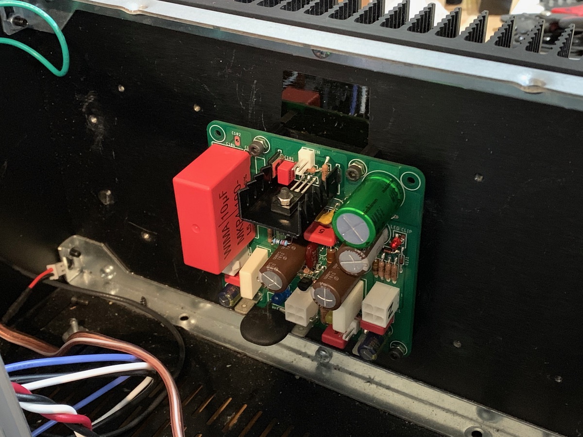

Here is view to the right channel:
attachment.php
Closeup before connecting MOSFETs:
attachment.php
I will also build a v2 SLB with all the ground pins on one large STAR hub. Right now I have GND going from SLB to a screw terminal block - not the same asa true star. Vunce tells me that doing this with one trafo will make amp dead quiet as he is doing this with Alpha 20's.

I managed to get rid of the ground loop/hum issue by connecting the RCA ground to the amp input ground (as intended). Also running speaker return straight to the SLB star GND. Absolutely quiet now - no hum/hiss at all. Very good result for using only a single 600VA trafo.
