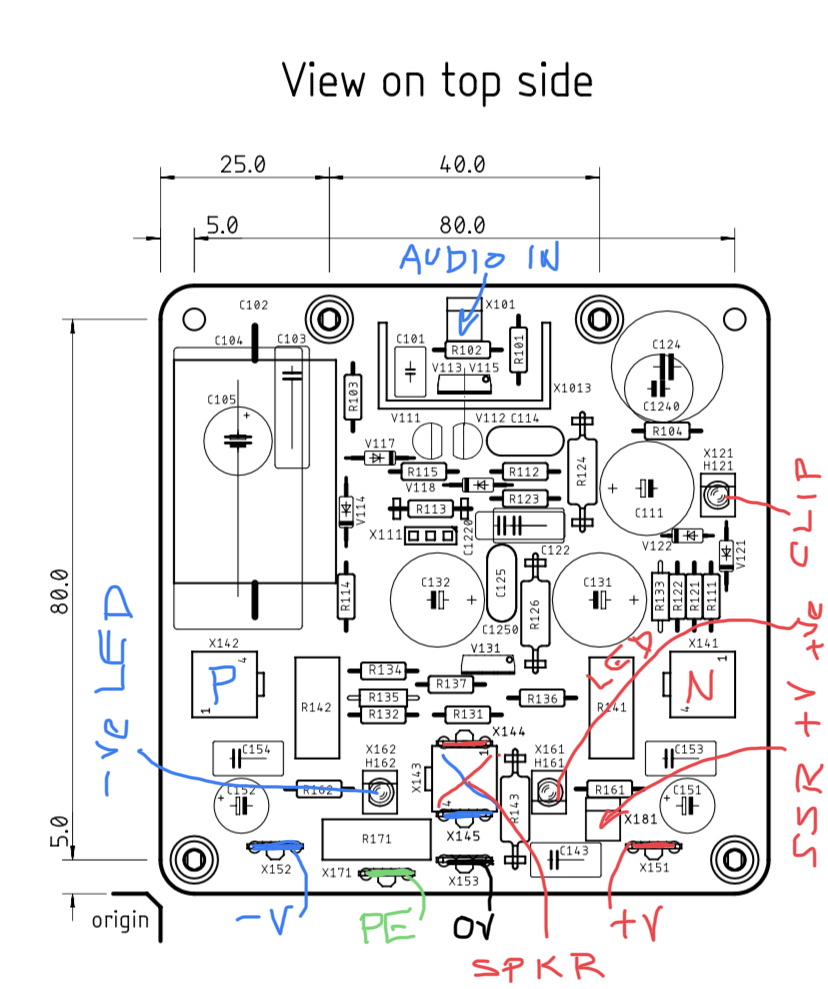

Hi X, just a quick question for you, is the power supply connection available on the AN pcb, the same as on the SSR protection pcb so that I can connect the DC power from the AN board directly to the 2 way Molex connector you supply with the SSR protection pcb?
I can't really see for sure in the photo's you have posted so far for the loaded AN pcb.

Power supply into the amp and earth ground are Faston spades. Audio output is your choice Faston spades or 4pin Molex minifit same as on SSR unit (redundant wires).
Here is the stuffing diagram from production board marked up with where things go.

.... is the power supply connection available on the AN pcb, the same as on the SSR protection pcb so that I can connect the DC power from the AN board directly to the 2 way Molex connector you supply with the SSR protection pcb?
Hi Gary,
Yes, the AN uses the same Molex kk male 2-pin header as the SSR board for dc power. You will make a cable with the matching female connectors on both ends.

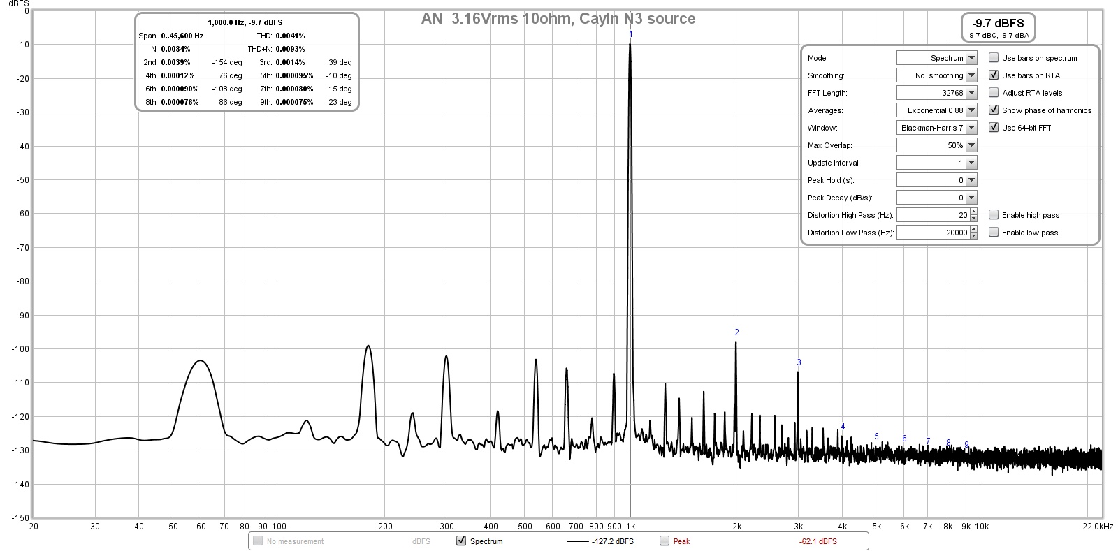

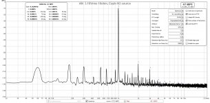

I reinstalled the KOA BPR resistors and changed my 1kHz oscillator from the built in DAC on the Focusrite to using my Cayin N3 DAP playing a high res flac file of a 1kHz tone. The Cayin has a nice AKM4490 DAC and OPA1622 output driver. The distortion went down as well as the harmonic profile looks better with just h2 and h3 and very little of anything else. I need to be more careful to use a good external reference osc next time. I also have an Akitika 2ppm osc but that seemed to pick up a lot of EMI noise as it is in a plastic box. Here is the new FFT with the Cayin N3. The THD is now 0.0041% for 3.16Vrms into 10ohm (1W).

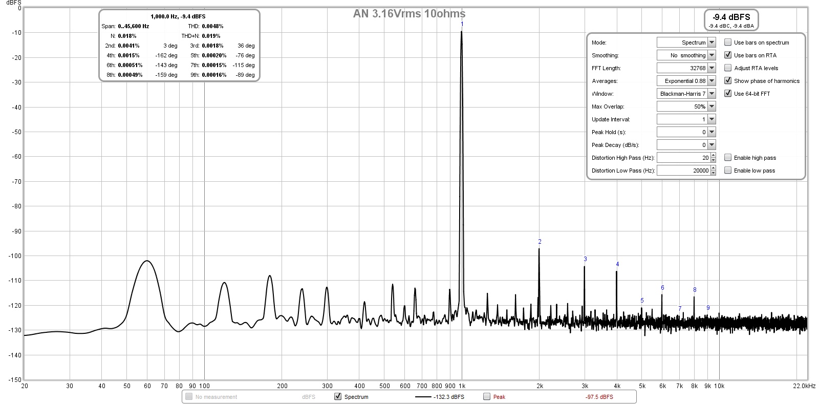

For comparison, here was previous result with internal DAC on Focusrite:
798454d1575031380-alpha-nirvana-39w-8ohm-class-amp-3-16vrms-10ohms-fft-jpg

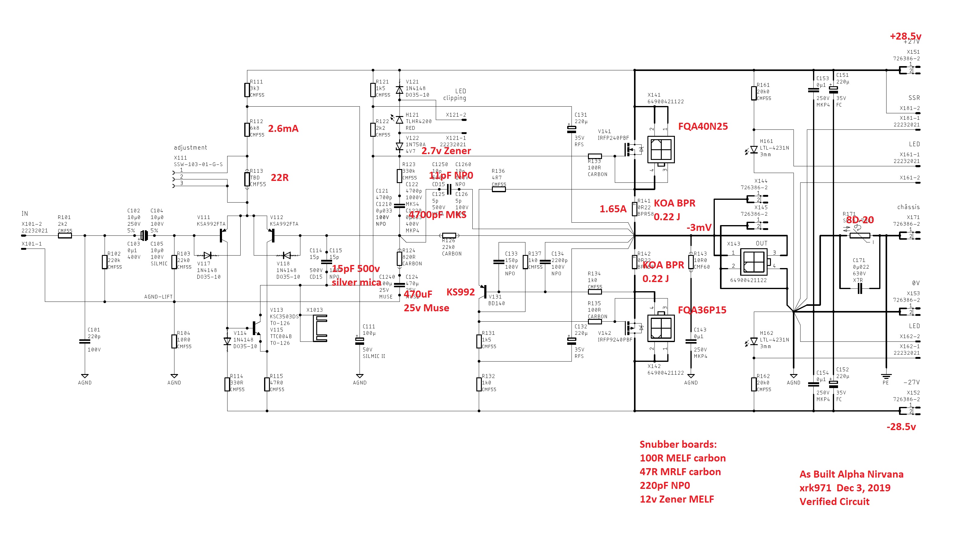

Here is the schematic marked up with my components and measurements "AS-BUILT". The circuit is verified and sounds great. Vunce will share his thoughts soon but sounds like his first channel fired up uneventfully and has rock stable bias current and 0mV DC offset.
attachment.php
I previously had C1250 as 22pF silver mica, because that was all I had on hand. I recently pulled boards out and replaced with two 22pF NPO in series on the back of the board to get 11pF (closer to the 10pF spec'd by Hugh). It makes a discernable difference in the sound stage width and stereo imaging accuracy. I am listening to Ahmad Jamal's "Ahmad's Blues" album and the stereo imaging and sound stage are superb. Great engagement and dynamics. Pure listening pleasure. This amp is really a keeper. I will have to builld a proper 2mm thick, 2oz Cu, ENIG SLB power supply board for it with a nice built in star ground hub. (I am currently using the gen 1 prototype SLB with 1.6mm FRP, 1oz Cu, HASL, and only 2 GND pins). The wiring will get tidied up. Even get the expanding braided nylon sleeving with shrink tubing - the works. It will mean that my workhorse development chassis will be tied up. I will probably have to get another development chassis. Maybe a bigger 5U x 400mm this time? That will handle just about anything.
Yes X, that expandable nylon sleeving with heat shrink each end to tidy it up always looks a treat in the amp chassis. Comes in many sizes and is quite cheap on ebay as well.
I will use 10pF Silver Mica in the C1250 position as I will have to buy that in anyway. One of my jobs over Christmas is to sort out a "final to buy" Mouser list for these boards.
