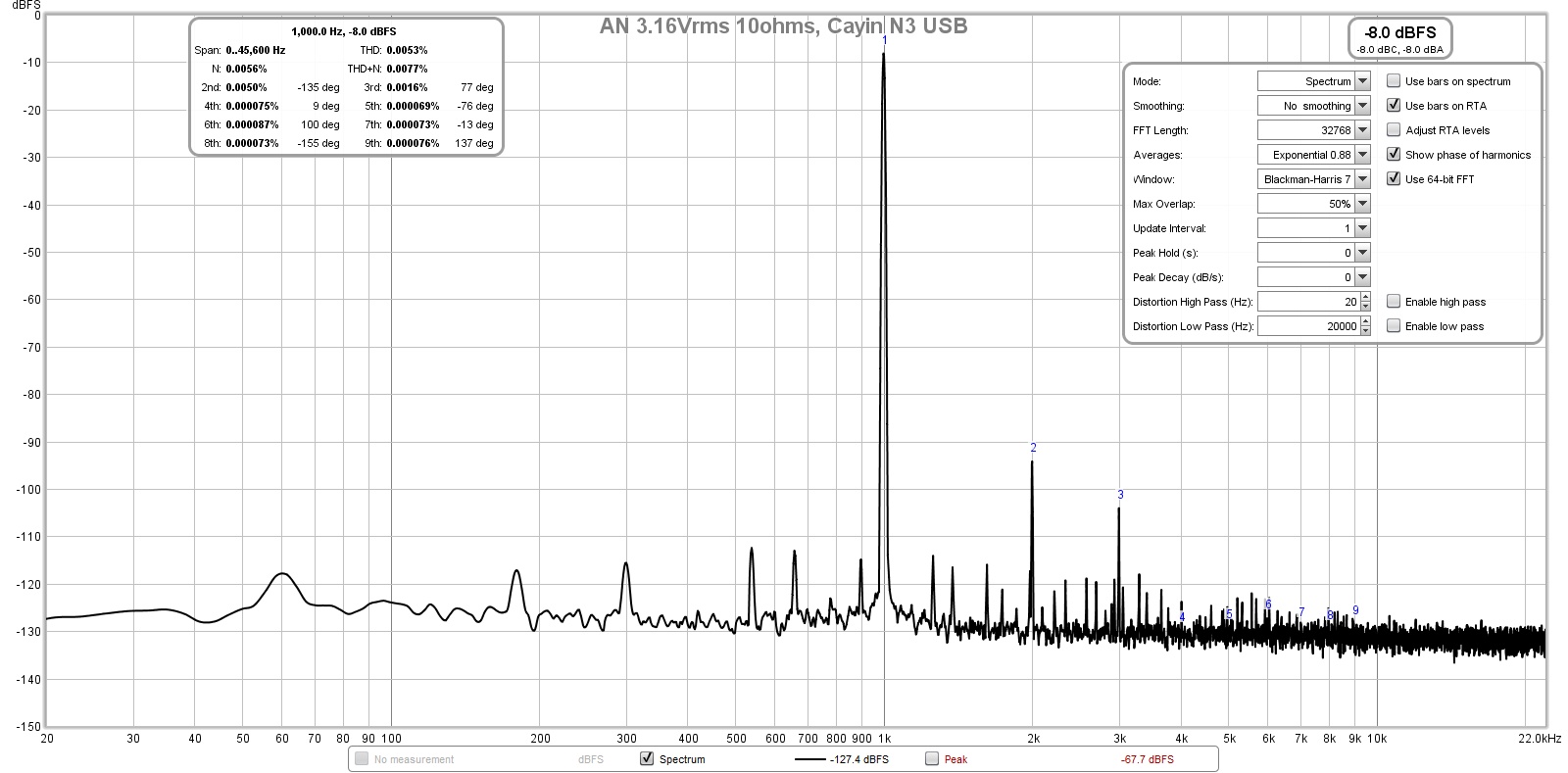

That plot is for 3.16Vrms into 10ohms or 1w rms. Not 39w.
That's why the F5 sounds bright and sharp. Some people like this sound though.
Alpha Nirvana 39 watts 8 Ohms, latest measurements, at 10 Ohms.
Figure 8, spectrum distribution of the distortion at 1 watt, and you can see the dominant 3 rd harmonic, as well as 2 nd, 4 th and 5 th.

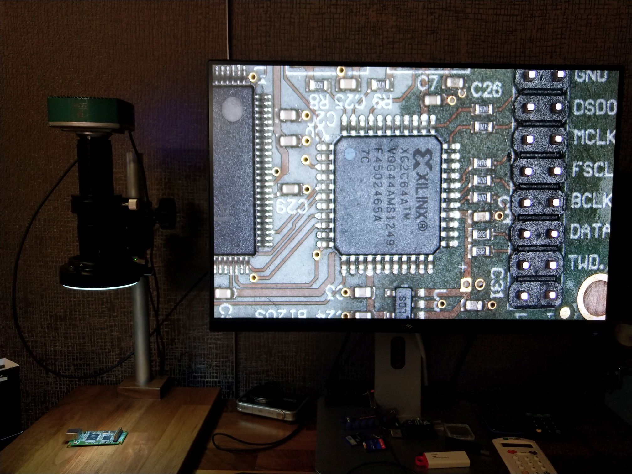

For SMD soldering to become very easy get a 60fps hdmi microscope.
The 60fps hdmi makes it real-time without lag.
Take a 180x zoom lens and a 0.5x barrow lens to double the working distance.
Tada, SMD soldering has become easy 🙂

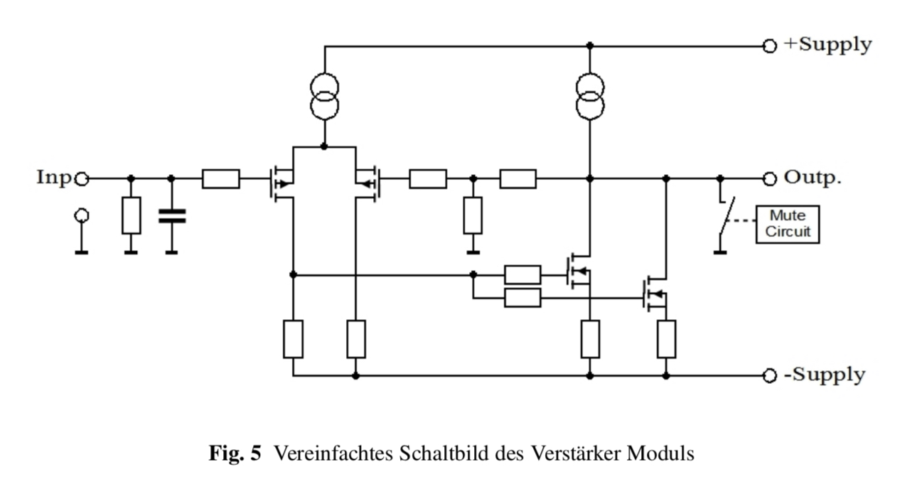

The topology is very close to those from this SE modules - go toInteresting topology. I think I will have to give this a solid look. I'm always on the lookout for class A MOSFET amps. This one has some 'trick' aspects to it!
Produkte - Andre Buscher Audiotechnik - Puristische Eintaktverstarker
Main difference is the use of MOSFET's in the LTP input stage of Buscher's modules

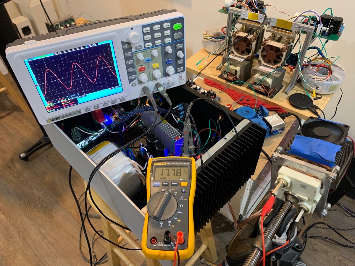

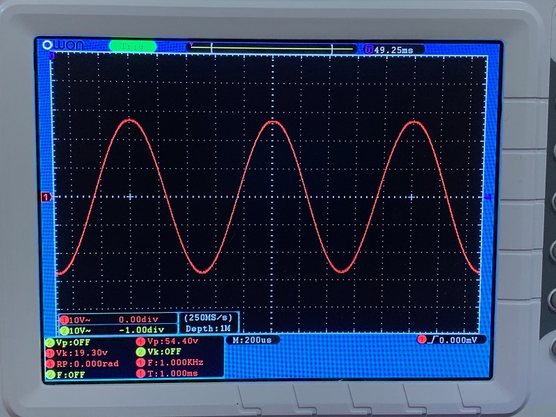

Test Setup with fan-cooled EBC 300w 10ohm non-inductive dummy load:

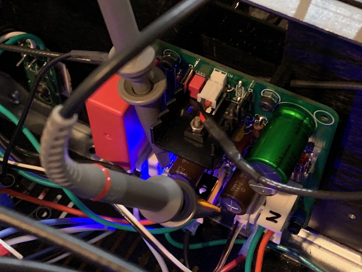

Closeup of Right ch amp under test with O-scope probe leads:
Here O-scope shot at 54.4Vpp, 19.3Vrms into 10ohms (35W):

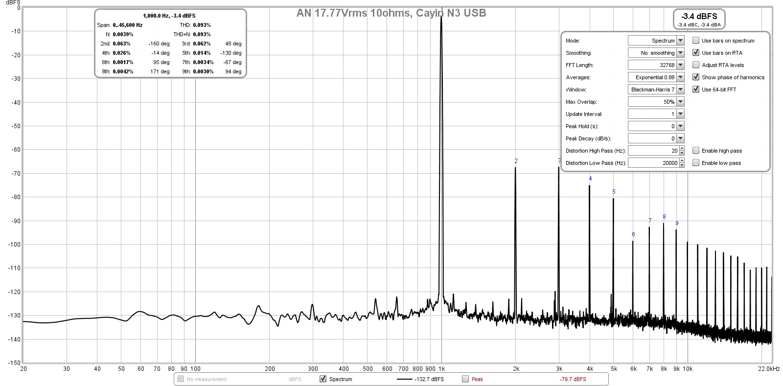

Here is the FFT for 17.77Vrms into 10ohms (31.5W):

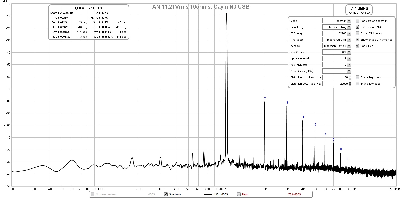

Here is what the FFT looks like for 11.21Vrms into 10ohms (12.5W):
Here is the FFT for 3.16Vrms (1W) into 10ohms:
The amp is now running with a BD140 for Q4 (V131) just to make sure it works so folks have a choice. This may have lead to a slightly higher THD level than left channel which used a KSA992.
Interesting but not the same from several aspects:
- Missing a BJT between the two legs of the LTP for the VAS,
- Missing a reactive CCS that allows the high efficiency of a push pull amp while still being a SE amp.
- Missing bootstraps to allow higher headroom
- Missing tricks to shape DF vs frequency

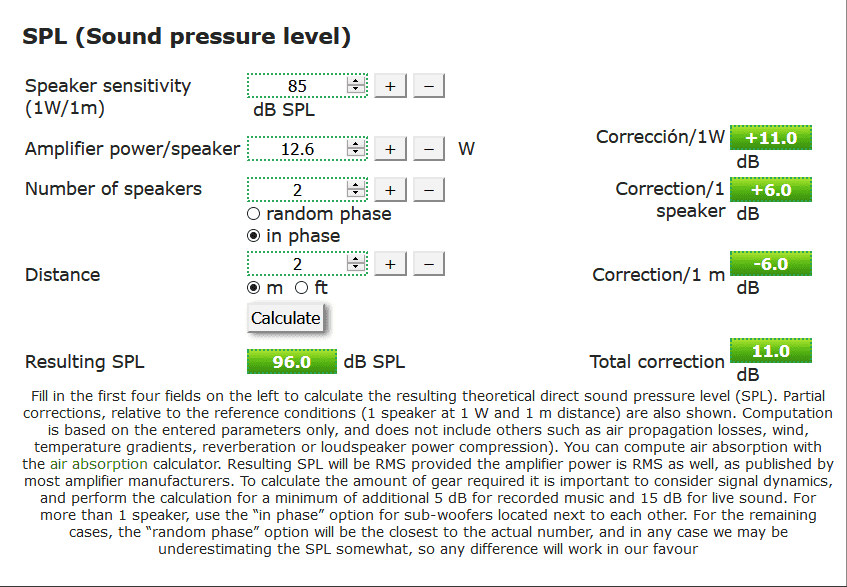

Pro-Audio and Lighting Calculators : dBs, time, Hz, DMX ...
