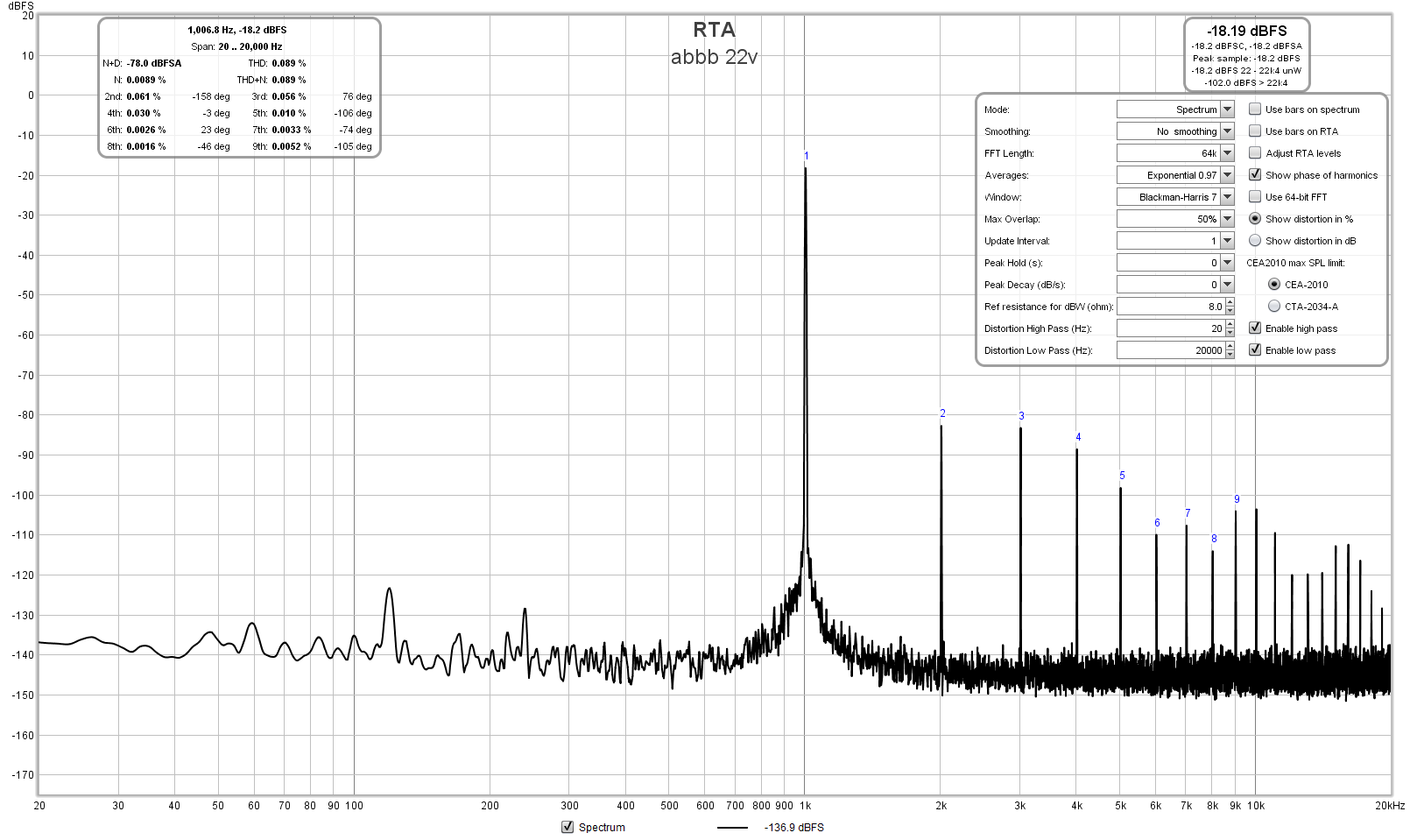

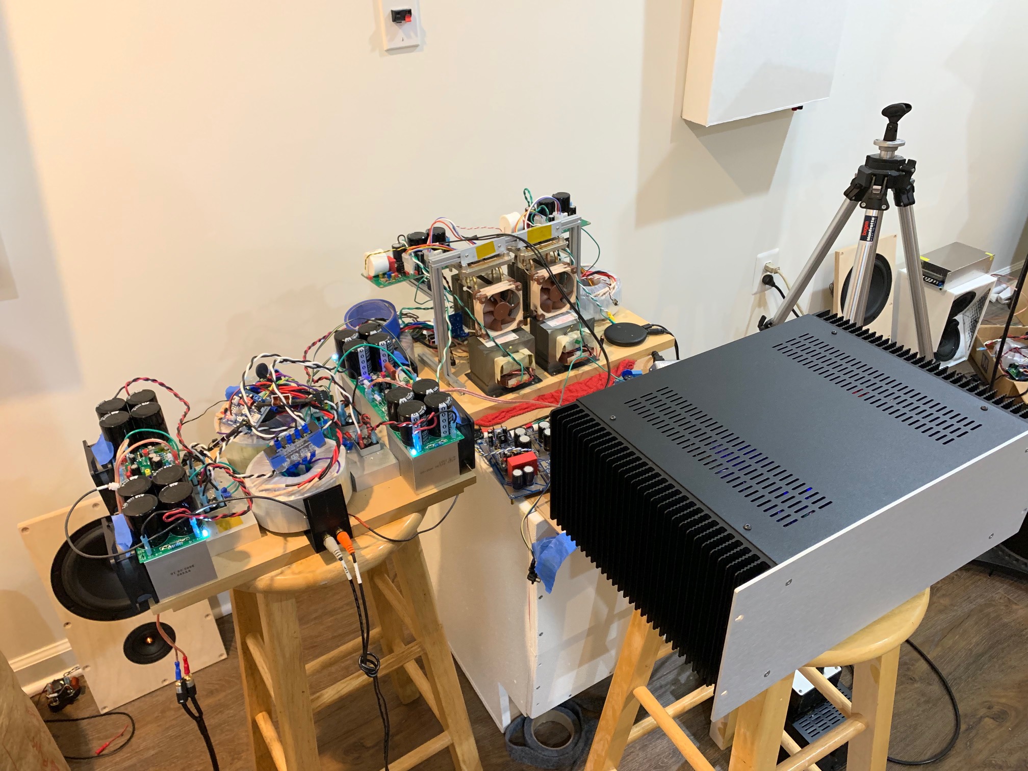

Great news, Gtose has completed his ABBB amp (and it is water cooled!). He is running some big +/-39.4v rails at 3A bias current and getting 60Wrms into 8ohms with only 0.089% THD before clipping. As ABBB is SE Class A with Aleph active CCS, these are 60W of pure Class A power.
