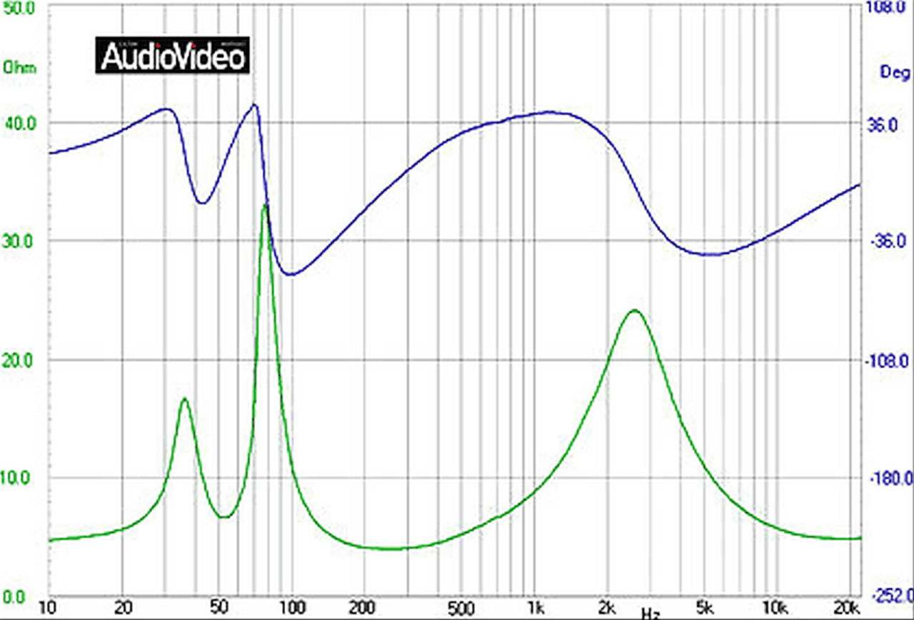

Near field (in phase), less than 2m but 3.9 Ohms of minimum impedance. My modded KEF Q100 5.25" coaxial loudspeakers is like 5 Ohms. Better 4 Ohms to estimate the max power.

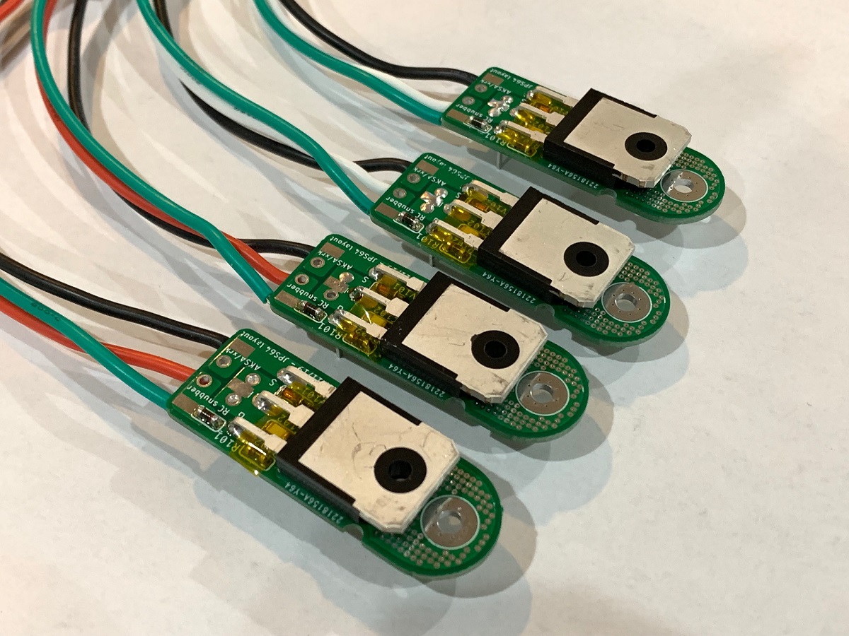

Hugh just completed a sim for 25W I to 4ohms. Unfortunately, it will dissipate more heat than the 8ohm version and not be as efficient. Hugh designed it to be able to handle 3ohm loads in case speaker dips down. It will be about 3A bias current at +/-20v rails. 58W dissipation per MOSFET. Are you still interested?

Hummm... 2 MOSFET by channel
