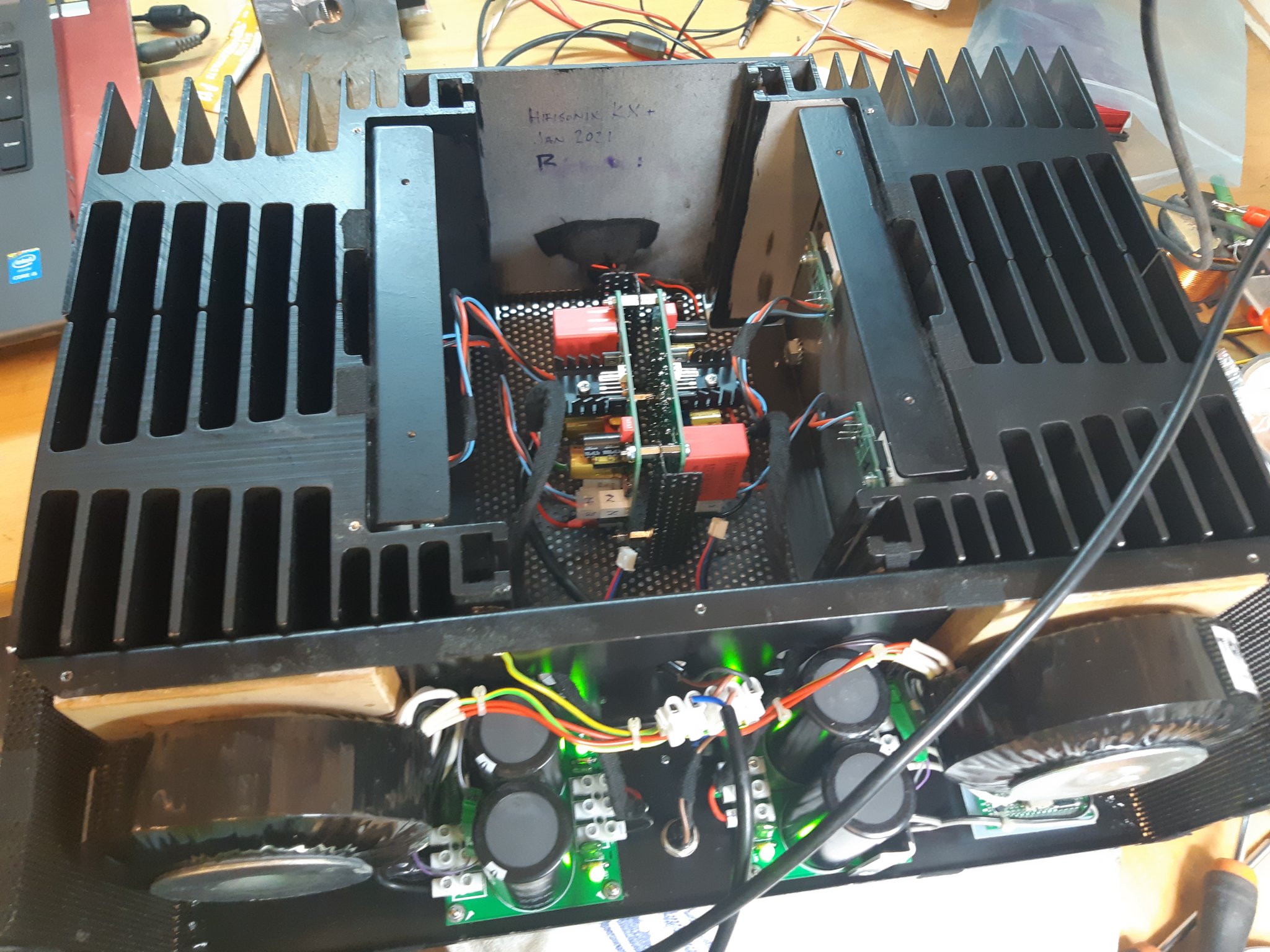

I fired up my amp(s) first time today! I'm running dual mono in a re-purposed enclosure. Have not measured Iq except when I was first powered the modules from 20V bench supply, and it was abt 1,7A (a little low?), but I guess that should stay the same even with the higher voltages.
I'm running simple rectifiers and caps (33mF/rail/channel), transformers are 250VA Toroidy's with 22VAC secondaries, makes 29,5VDC rails loaded. Simple as that at the moment.
There is a little bit of hum, but nothing I can hear from listening position. Thinking of cutting some traces on the PCB's to be able to feed the front end from cap MX previously installed in the enclosure. If there ever will be an update to this PCB, maybe add cap MX for the front to the list? A lot neater than doing it on the main rails I think.
DC offset is a couple of mV with the trimmers in end position, have not kept track of offset with temperature yet, but input pairs are thermally connected.
No HF filtering caps mounted yet (want to do some square wave testing first).
I want to avoid speaker relays if possible, but there is a pretty solid thump at turn on, similar to some old single rail amps with output caps.. Maybe I can live with that, since it seems to be a 'soft' thump.
I have been running the amp in the garage a couple of hours earlier to see that it seemed ok thermally, and heat sinks seem ok, but I think I need to improve cooling for the rectifiers. I could not resist bringing the amp home to give it a listen, and it's playing as I write.
First impression is that it's pumping more bass, almost like I added BR ports on the speakers, same impression on the garage speakers. It also seems I turn it up louder with this amp.. Will give it some time before I comment more on the sound.
Thank you guys for your work on this one!
Picture from assembly earlier today. Needs a lot of finishing up still, but I was eager to test 🙂

Very nice RF, compact, good layout. Rectifiers always get very hot on Class A; you'd be doing more than 1.35W constant dissipation on each leg with 1.7A+ and usually around Vak of 0.8V.
Try the earth loop, ten ohm resistor from input/coax/fb shunt signal ground to power ground, perhaps one on each module.

Thank you! Something I put together from some old heatsinks and sheet metal, a true DIY case 🙂 Maybe it reflects the owner, I might be a bit different myself 😉 It actually has ok WAF when it's assembled,
I have cheated, secondary side of the transformer is not grounded 🙂 Both channels are floating, only the input ground is connecting them, minimizing risk of ground loops (transformers and case are grounded though).
I think the small hum is simply from the ripple from my simple supplies. From memory the amp PCB's have HBR's.
@Hugh: I only have some small caps between signal grounds to case at the input connectors. I still have a lot to fix before it's finished..
Very nice work RF! Those are unique looking heatsinks. I like the low profile case with toroidal trafos on the outside. Interesting design. Your PSU has no CRC, just C’s and that might be the hum you are hearing. The front end doesn’t need a cap Mx, it’s the output stage really. Try adding even a 15,000uF cap after the trafo and 0.22ohm resistor between that and the current cap you have. That should quiet it down substantially. Or if you want, try the SLB power supply and the amp will be silent and hum free. I would ground PSU through a 10ohm NTC to chassis. That might also reduce the hum.
Thank you! I think the heat sinks are from some RF-equipment, I got them from a EMC-engineer at work.
I think the hum is caused by the simple PSU as you say, however, from simulation it looked like hum could be improved by abt 30dB by smoothing only the supply to the the front end, actually only negative rail would do it. we discussed it with Hugh a few pages earlier.
Since I already have a small cap-mx in the case, that's what I would like to try first, Everything else takes up more space, and there is not so much, especially in the 'power box' at the back.
I think I could even live with it as is, since I can only hear the hum with my ear next to the woofer.

Ok, I'll leave it as is. (Sorry, RF is the correct term, I was thinking High Frequencies)
I did a quick startup after connecting the cap-mx to the front end, but just based on my hearing as measurement, it did nothing to the hum.
