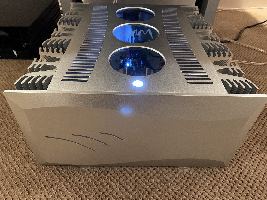

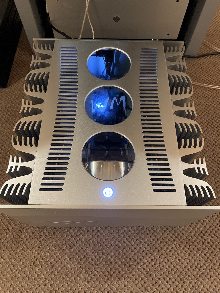

Finally all done!
Here's the final pictures
Thanks all for the nice comments!
On the inside I have cleaned up the cabling, redone the power harnesses for the amp modules using 12 gauge all black. As you saw, the power switch is working, it is a capacitive touch button and it is the first time I use one of these in my builds. It's quite fun to press... touch... :)
Also reworked the ground wiring and added the thermostat cutoff on both heatsinks.
Now to music listening time! I'll have plenty of time next week since I'm starting my holidays vacation for two weeks. Musical impressions will follow.
All the best!
Do
