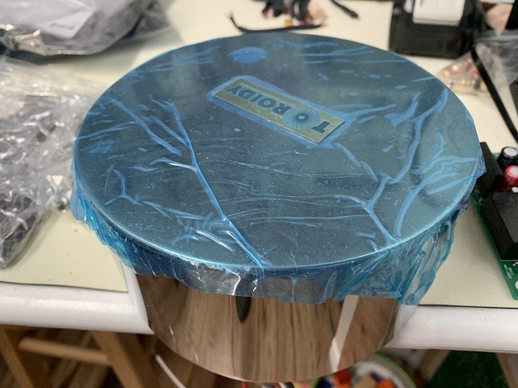

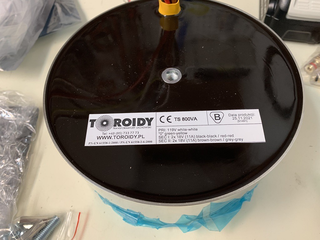

Yeah! Once you have this thing in front of you, it is quite impressive transformer! LOL

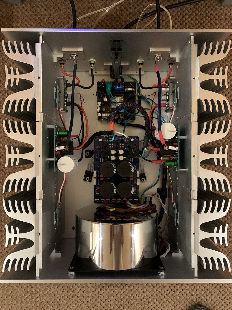

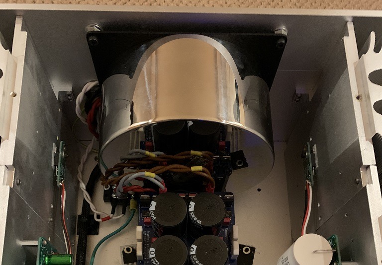

Here's some pictures with it installed. Enfin! Le son du silence! (At last, the sound of silence). This thing is totally quiet!!!
I need to cleanup the cable mess, some were just temporary. It will be done shortly.
