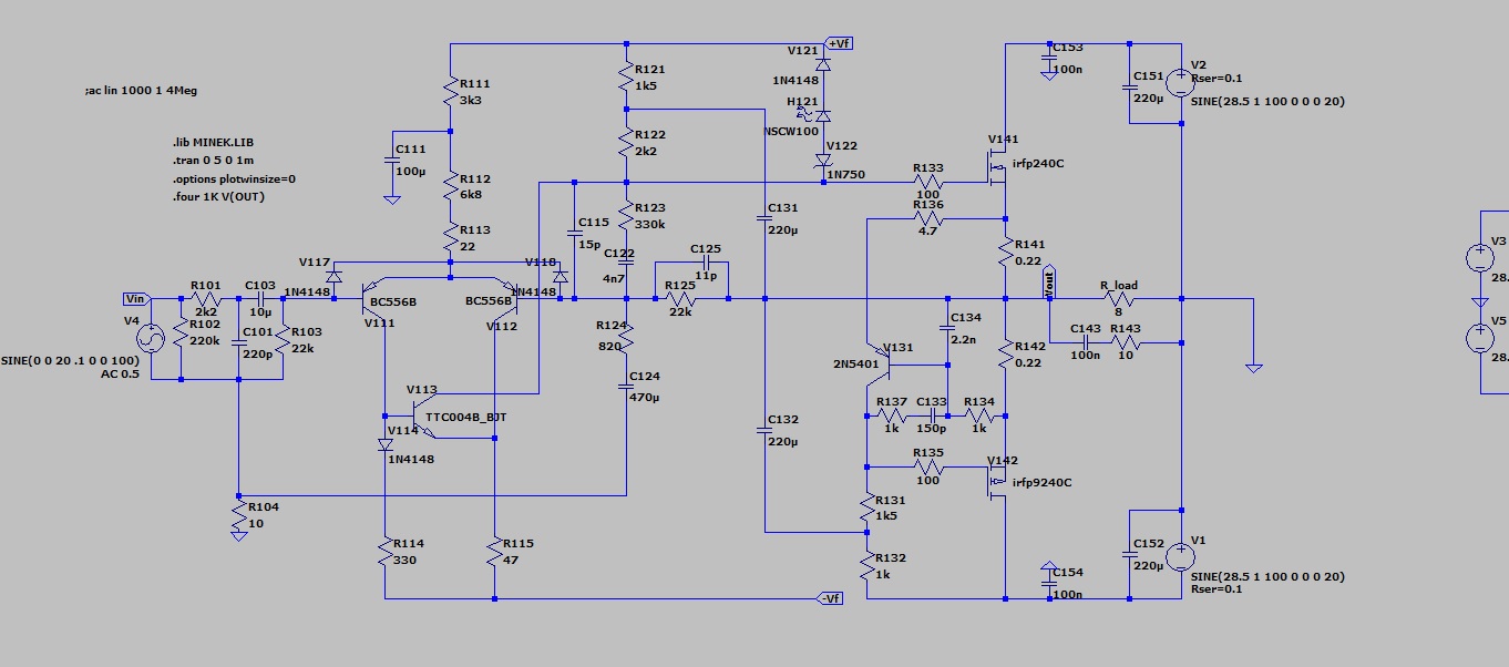

A question to the guru's:
What is the 'weakest link' for PSRR of the AN amp? Would a separate supply to the front and do much for hum? (I have a separate front end supply with Cap-multiplier in the chassis I'm thinking of using)

To answer my own PSRR-question:
I tried adding 1V 100Hz ripple to the supplies in the sim, and had 4mV(p-p) on Vout, then I fed the front end separately (according to the attached schematic), and ripple dropped to 0,2mV(p-p). It seems like it could a cost effective way to reduce hum, instead of going with CRC, cap multipliers etc on the main supply.
I will see what I end up doing, but just posting to share my findings.
Running the complete audio band indicates more than 30dB improvement through most of it, but a bit less at HF. Connecting R132 to the front end supply too only gives improvement below 10Hz it seems.

Good improvement running separate supplies for the front end, thanks for the suggestion. But because of the way the output stage is driven at the gate of the nmos (high drive, rather than low drive), you could throw away 2V from each rail and thus supply the front end from a simple RC.
In truth, the LTP is well regulated already, but the negative rail is wide open and a regulated supply at R114 and R115 would be very beneficial.

Interesting Hugh - but how does one modify the PCB to be able to provide a regulated DC supply at R114 & R115?
Pesumably this regulated supply must come from a separate PS to the SLB?

The brute way could be just lifting the low end of the resistors, tie them together and solder a wire to them.. Since I don't have the PCB's I can't make other suggestions like cutting traces etc. Maybe even an onboard cap multiplier would be doable?
My separate front end supply runs on the same (main) transformer windings, but has its own rectifier, smoothing caps, and simple cap multipliers for each rail.
What I have not looked at is what happens at power up/down, short power cuts in the grid etc. There can be strange (and destructible) transients or DC out in some cases when the rails are not 'syncronized'.
@AKSA : I always try to find the cheapest way, beefy regulated and filtered supplies are usually complex and expensive 🙂 I just did a sim with only R114 and R115, and it's does most of the PSRR improvement. From 100Hz down, it's a little bit worse than the one I did, but I think most of the noise is from 100Hz up anyway. Only a few dB at 50Hz.
I tend to worry what happens if there is a short power out, it sometimes happens here during storms etc.
I did a short sim on what happens if the front end has voltage when the main supply is turned on. This is what I think the situation would be if power is gone 1-2sec. The caps on the front end supply drains slowly, while the caps for the outputs drain quickly because of Iq.
Short power outage:
1. both front end rails on a separate supply, and that seemed fine.
2. only R114 and R115, and that was a bit nasty with a -12V dip on Vout.
Also turn on sim:
3. std front end supply at turn on indicates a -14V thump (around 20ms) at turn on. Does this correlate with reality for those of you who built the amp if you tried it without output relays?
4. 'filtered' (I simmed 1000u/100ohm RC) front end supply (both rails) indicates a -20V thump at turn on
5. filtered negative only indicates a -14V thump at turn on
