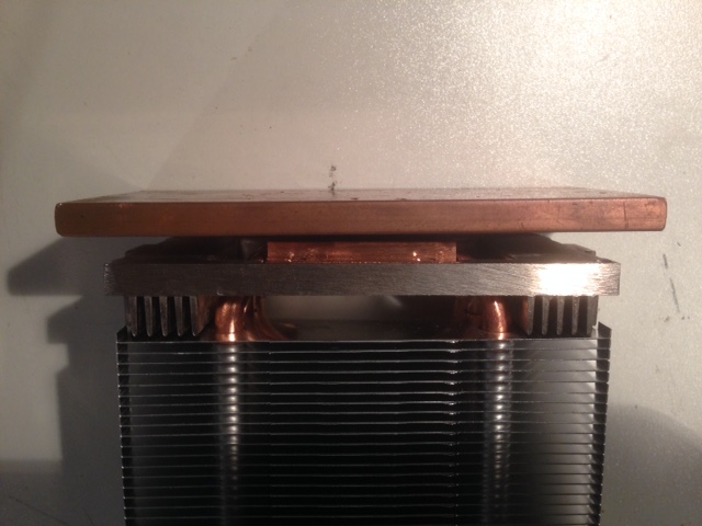

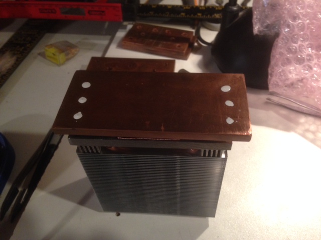

A couple of questions to builders that have used cpu cooling techniques. I have some copper pieces that are 1/4" thick and fit nicely on the cooler. I have attached a couple of pics for illustrative purposes.
My plan is to drill / tap 2 or 3 x 1/4" holes on each end of the top of the cooler and attach the copper plate. The white dots represent the holes. Washers will be used for distribution of force applied to hold the Mfets in place.
Question: Do you think that there will be enough hold down force applied to the Mfets with what I am planning?

Hi Myles,
I think this will do it nicely.
Transfer of heat to the CPU heat pad depends on the flatness of the metals, heat paste used between them, and force holding them together. Since your Cu block appears to have been drawn very flat in manufacturing, the CPU heat pad is almost optically flat, and you do not need to use non-conductive paste (use some with silver if you can find it) the transfer will be excellent.
Cu is great for this job. Look at some of the watt per metre-Kelvin conductivity from Wikipedia:
Aluminium 237
Alumina 30
Beryllia 209-330
Boron arsenide 1300
Copper (pure) 401
Diamond 1000
Fiberglass or foam-glass 0.045
Polyurethane foam 0.03
Expanded polystyrene 0.033–0.046
Manganese 7.810 Lowest thermal conductivity of any pure metal.
Water 0.5918
NOTE: Don't overtighten the six bolts, they could easily bend the Cu plate, destroying heat transfer.
Hugh

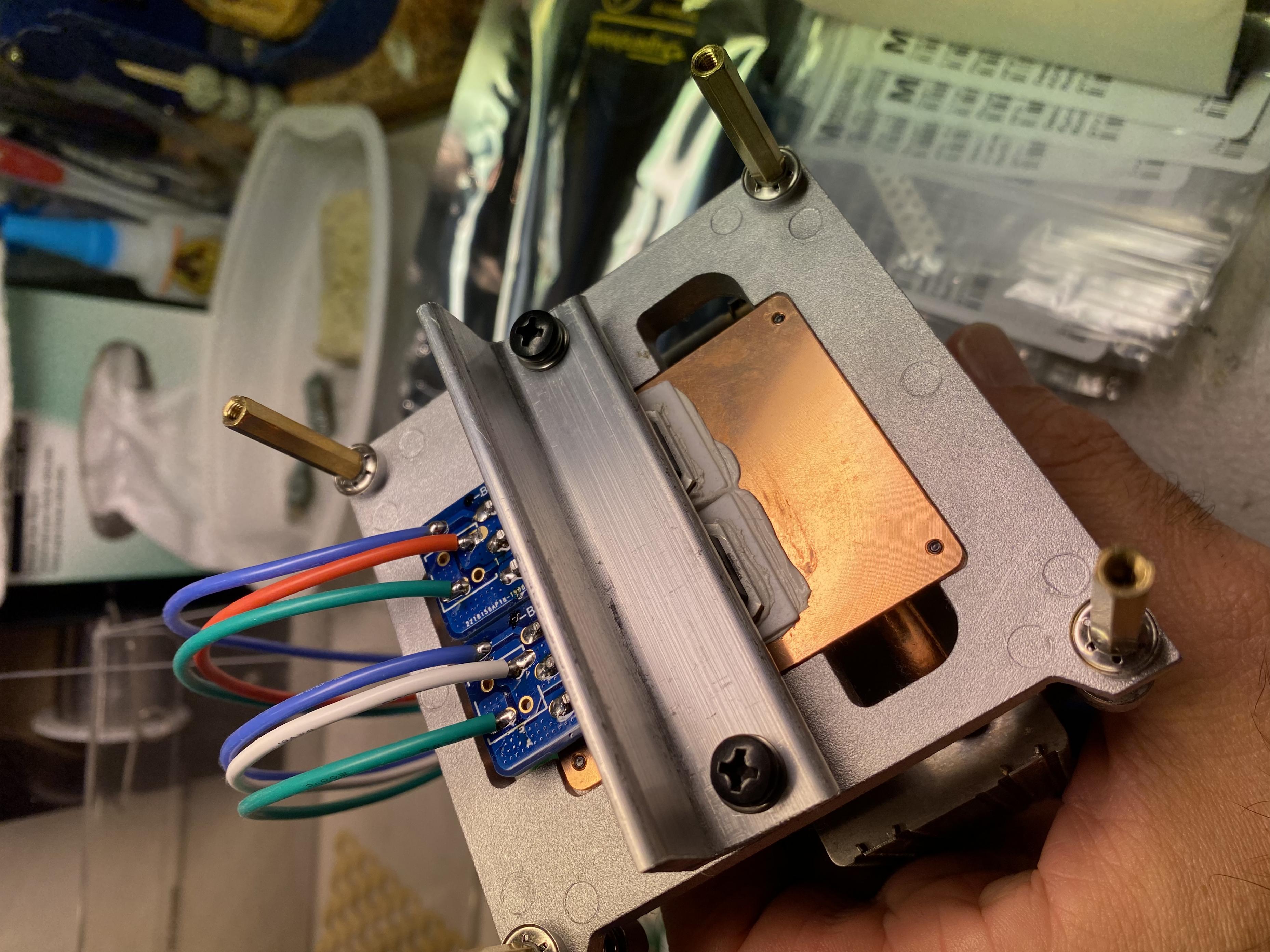

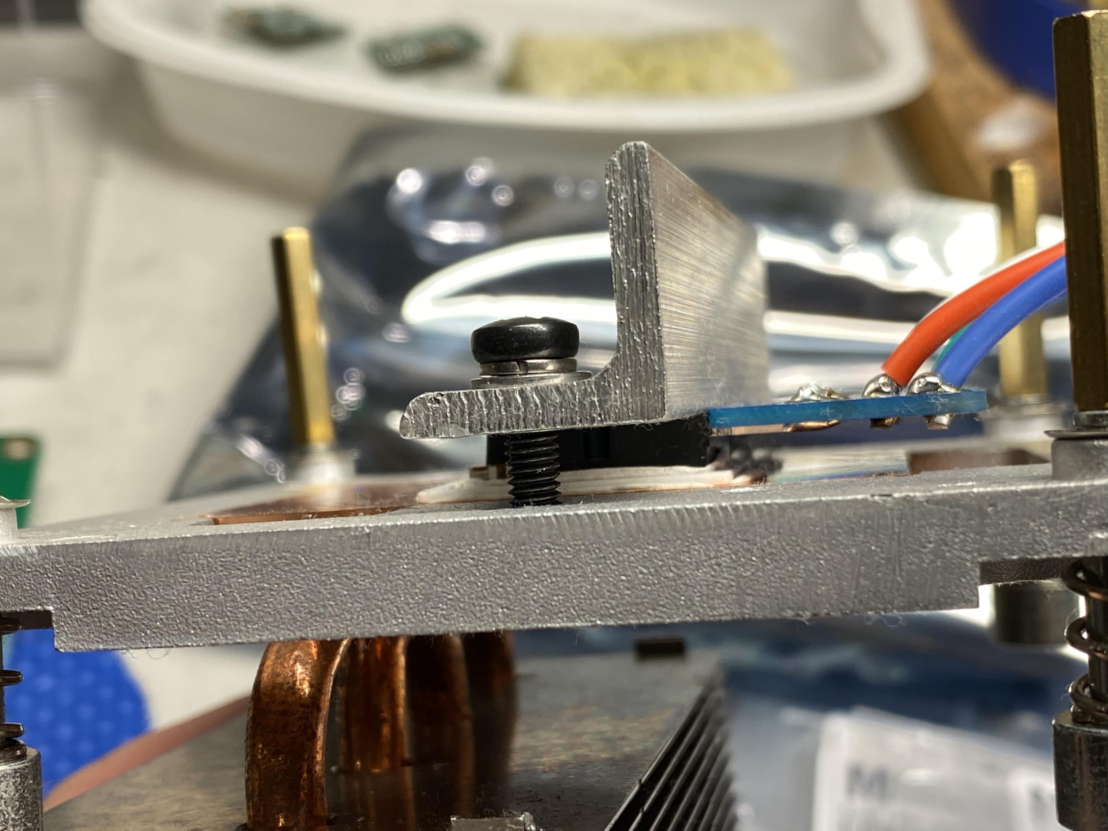

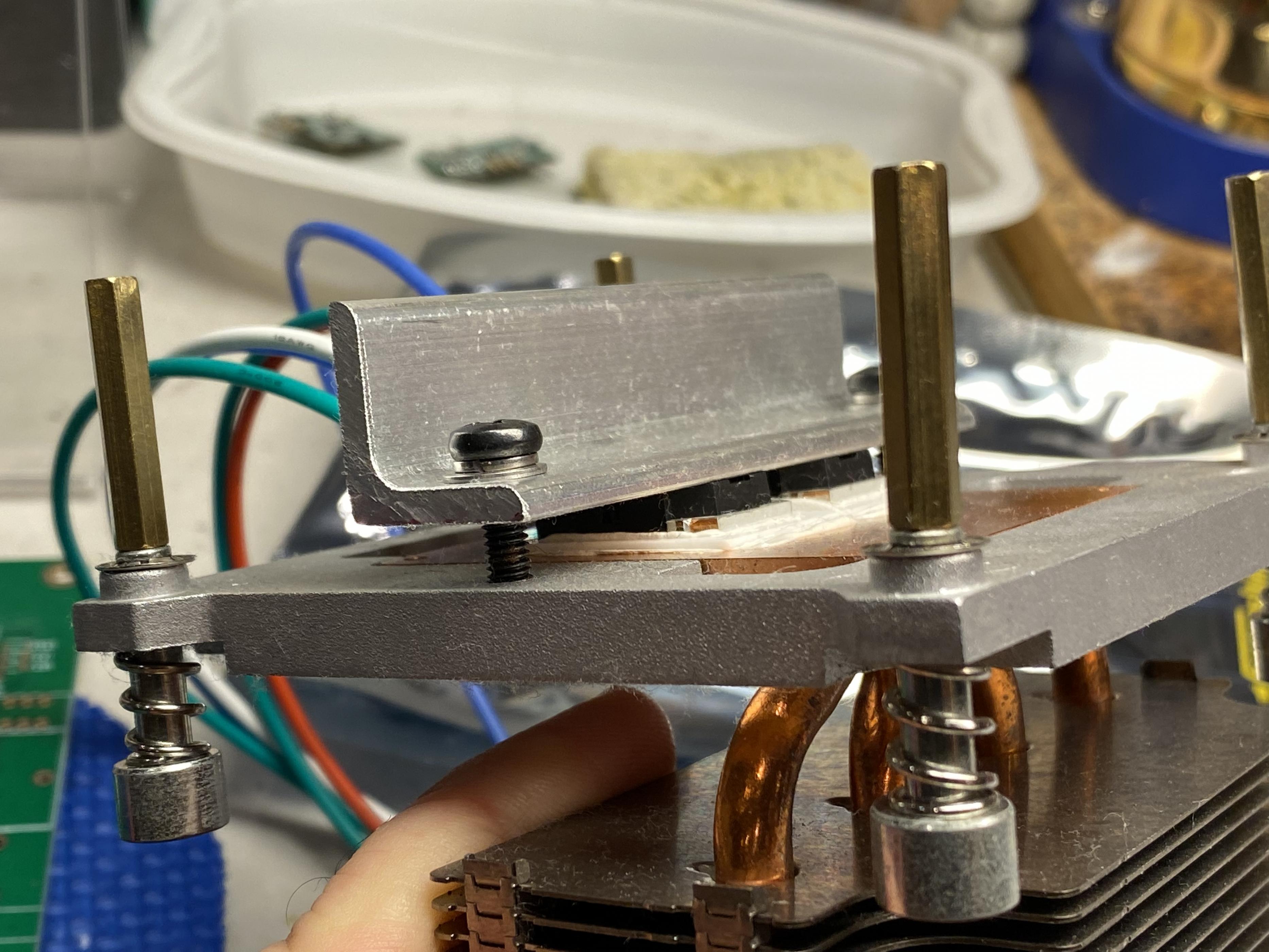

Copper is not easy to drill and tap. Aluminum is much easier to work with and the “clamp” is not the important part dissipating the heat. This is the method I use. Aluminum angle will not bend or flex when clamping the mosfets to the CPU copper pad. There is also no chance of shorting mosfet legs being trapped under the clamp 😉

Thanks Hugh and Vunce,
We are thinking along the same lines here. I would only tap the aluminum, as you have Vunce. These pieces of copper are heavy, and will not need much force to be an effective clamp.
Vunce, I see your point about shorting out the Mfet legs. I can cut the copper along the length, and make 2 clamps out of one piece of copper. Then, clamp as you have covering the Mfet body, reducing chance of short. Also only 2 bolts as you show. I have all this copper and would like to use it.
Vunce you got me stumped, "It looks like you have 3 layers of some sort of thermal paste / pads between the transistor and the heatsink?.
Can I use normal thermal heatsink paste, I just bought a large tube of Noctua thermal paste.
