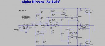

I have read through this tread (and already forgot half of it), and I'm a bit confused by the different iterations and component designations, so I figured I wanted to have a reference schematic for debugging/fault tracing the 8ohm version when I finally get to building it.
I found Minek's sim earlier in the thread, and I modified some values and the component designations to match the 'as built' schematic posted in the first post of the thread. I hope these are the same designations as used on the boards.
It still has the components and associated models Minek put in there, so I guess I will change those later, depending on what I end up using. Maybe I will run some stability sim too etc.

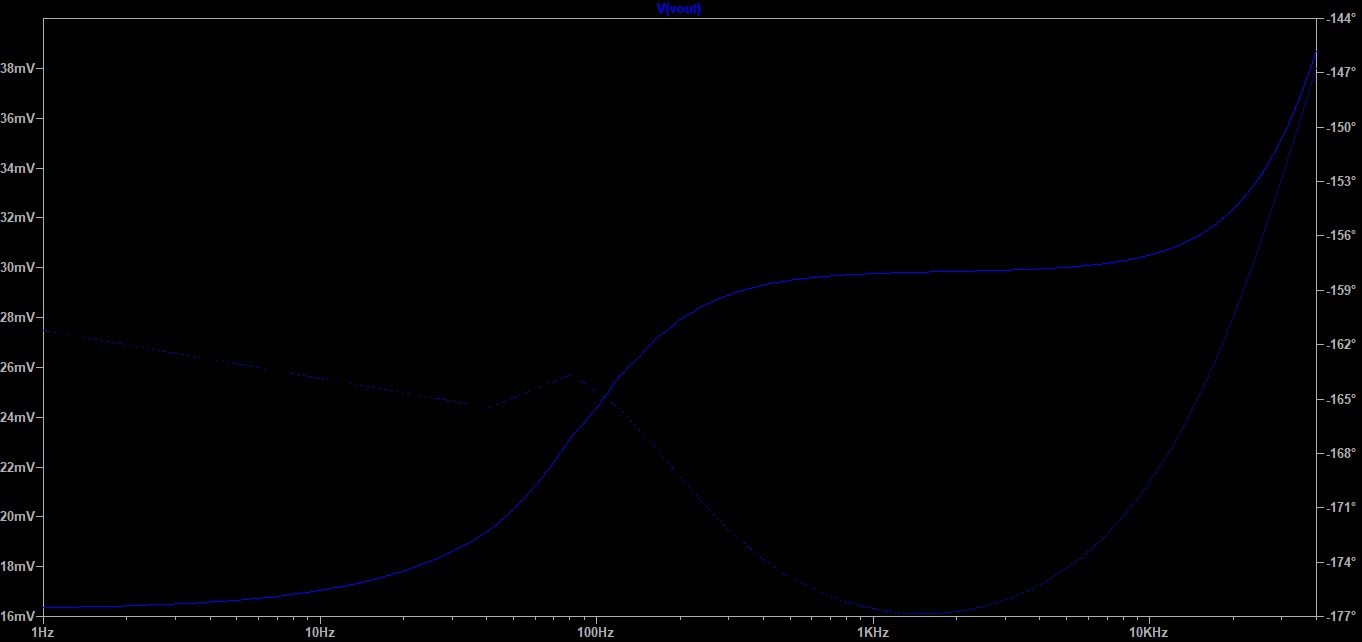

For now I have only had a look at some currents vs frequency, and I did a basic plot of the output impedance by feeding 1Vac via a 1ohm resistance to the output, and plotting the Vout (as seen in the sim). Basically the Vout should then correspond to output impedance mV=mOhm.
It seems nice and low in the bass, and climbs a bit with frequency. Not sure what impact the phase of the output impedance could have on sound, but I don't think it's anything to worry about.
I saw general comments about output impedance (damping), but don't remember seeing a plot in the thread, so here it is.

Do you see some issues with the sim/schematic, or comments in general?

Thanks for taking an interest in this amp. If you bought the boards from my shop, they ship from the USA. (I see your order now, they will ship out today). I’ll let Aksa answer your question on output impedance. I think the way to test it is to monitor the voltage drop at the output load. You don’t want to stick a 1ohm series resistor between the amp and the load because that’s like making the amp have at best, a 1ohm output impedance. It’s a much lower value.
