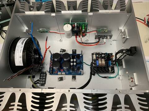

Wow, it’s like a spacecraft being assembled! Super work, Do. Very impressive.

Thanks! the amplifier is actually mostly completed and is playing music now. Only problem is the transformer humming very loudly, so I cannot concentrate on the music... The replacement transformer was supposed to be delivered today, but FedEx reported "operational delays", so it should be delivered next Tuesday... I will post newer pictures shortly. With this amplifier 4 ohms version biased @ 3A, the heatsink get to ~55 Celcius... A little hot, but still good.

For the chassis, a friend of mine (Vitalie on this forum), got them for me about 2-3 years ago... It was a special order. There are some similar chassis (heatsinks) on AliExpress, but not exactly like these though.

Oh yes, this is very special Do!
Beautifully laid out too, so very important with lots of hot parts on a Class A.
Lovely metal work, you are an artisan!

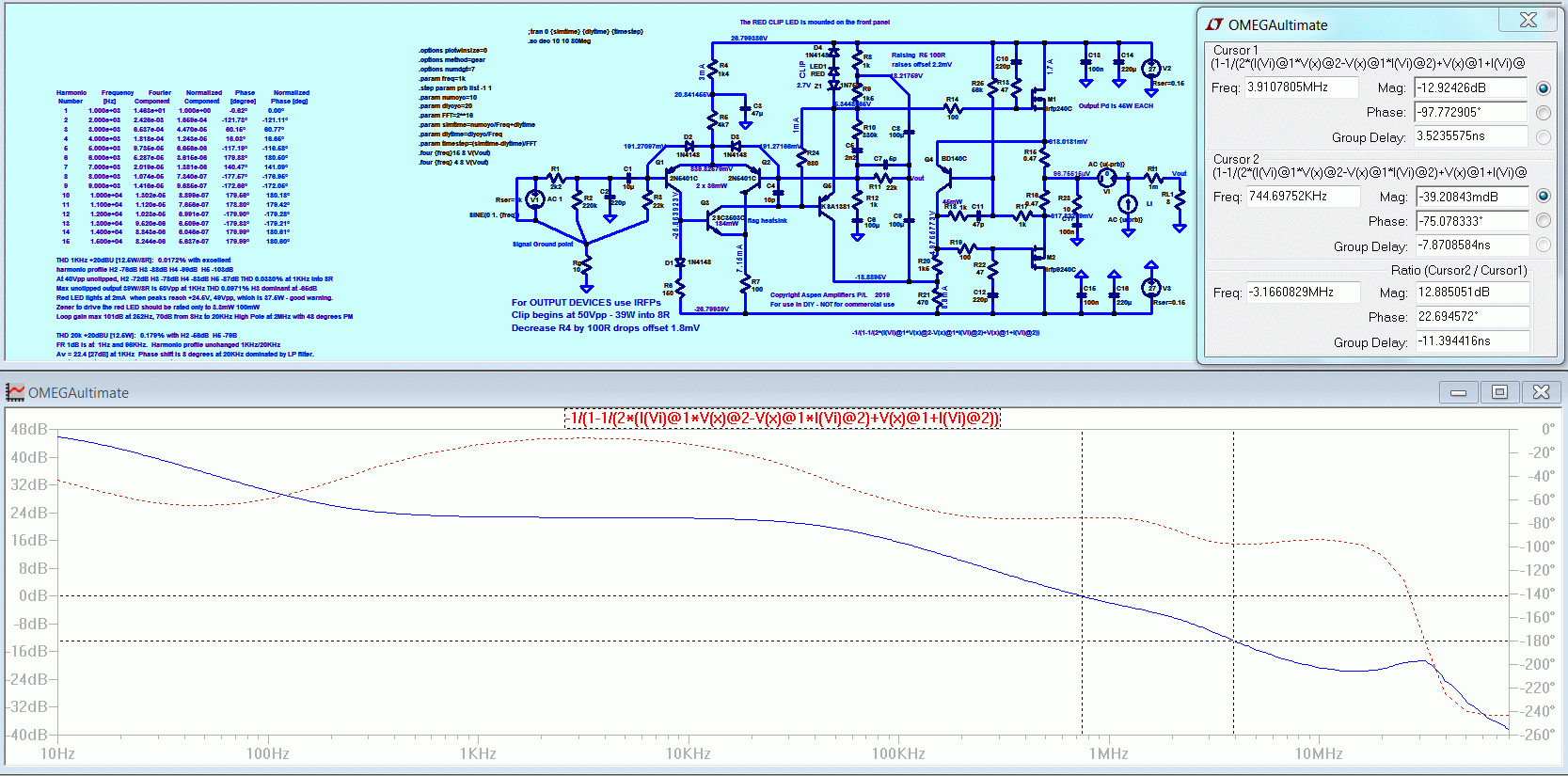

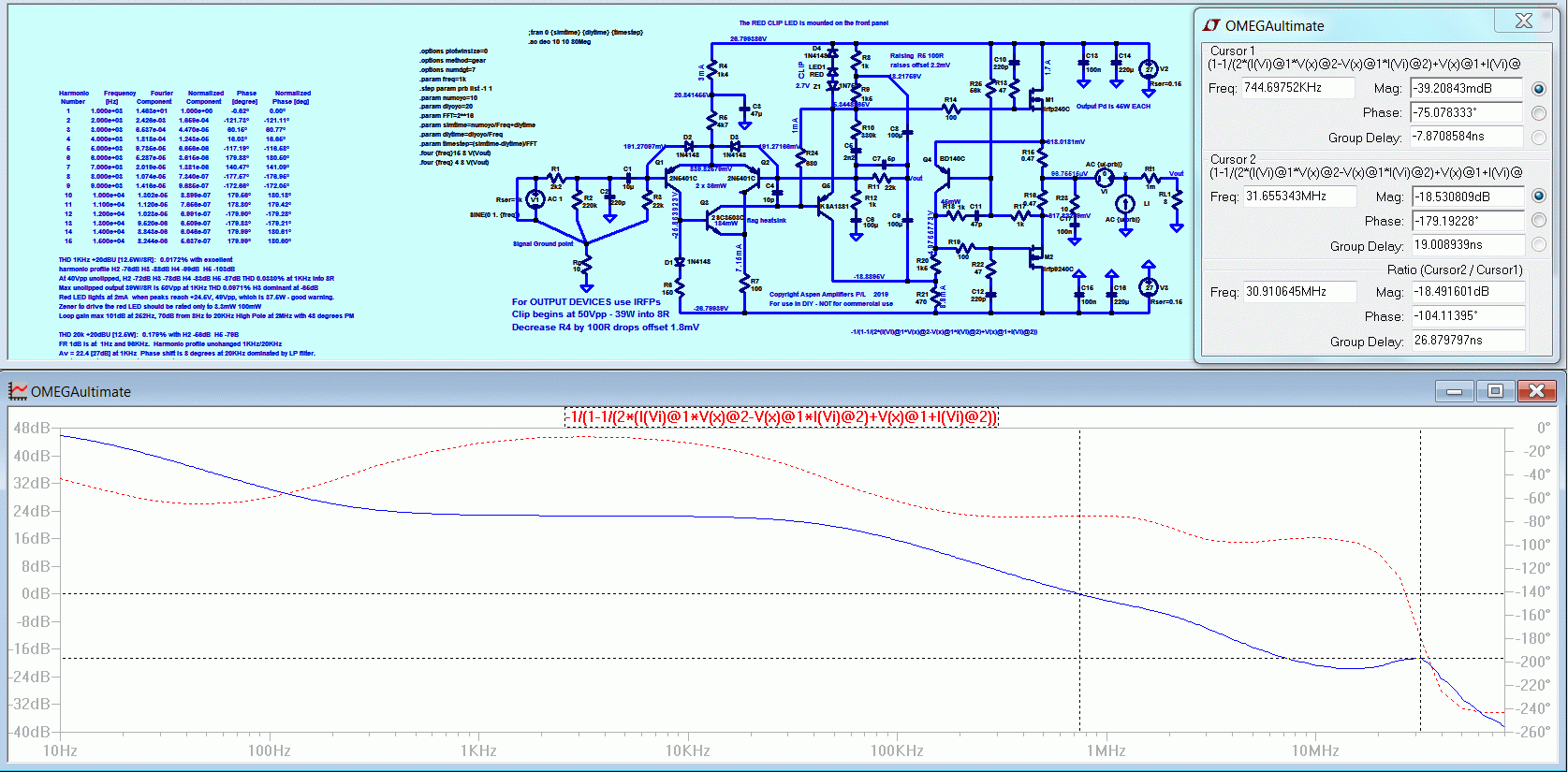

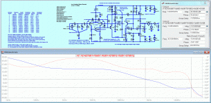

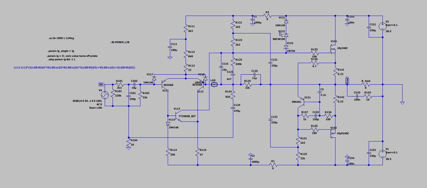

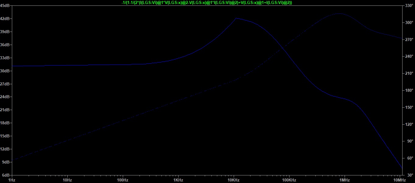

I have been trying to run some tian sims on the AN, but I must be doing something wrong. I have done this on a number of amps, but this one I can't get to work.
Pics of the sim and plot attached, and I also attached the sim with models etc in the zip.
Could somebody take a look?
