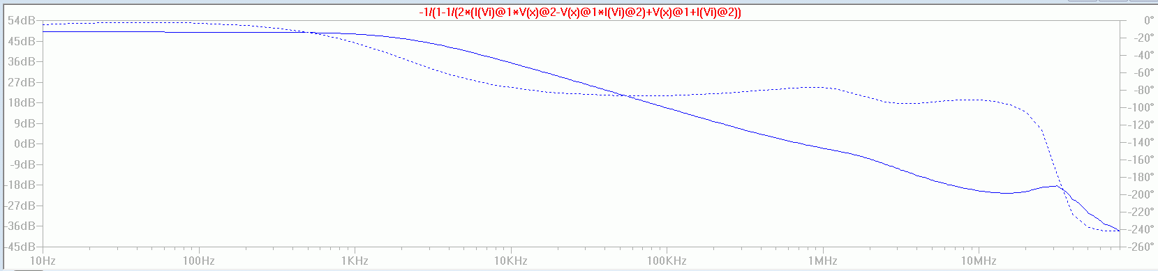

R123/C121 flatten the loop gain of the amplifier from 500Hz to 18KHz, and increases it from 22.8db to 45.8dB (see the graph) at very low frequencies. This gives the AN very strong bass performance. Lower loop gain increases distortion, but not as much as you would expect from the 45.8db drop to 22.8dB. The reason is that it is nested fb, and it improves the linearity of the amp for all stages BEFORE the output stage. This ameliorates the resulting loss of lower loop gain, and it does increase THD by about three or four times, but slightly reduces higher orders, bringing up H2, H3 and H4, which are moderately musical. Over 99% of the THD of this amp is H2, H3 and H4.
You can disconnect either the R123, OR C121 to remove this feature. If you do this, you will notice a difference in sound quality. Most people prefer nested fb but it is controversial because THD is higher. Try it, have a listen, try to figure out WHAT it changes! NFB has been described over the decades, including by Cherry, but it has not been examined from the subjective POV for audio amplifiers. Objective results are BAD, but subjective results are very good. This opens a can of worms and has attracted trenchant criticism. I do not claim that the THD figures are good, but then, audio is entertainment and my builders love my amps regardless of the figures.
Below is the Tian probe loop gain WITHOUT nested fb.

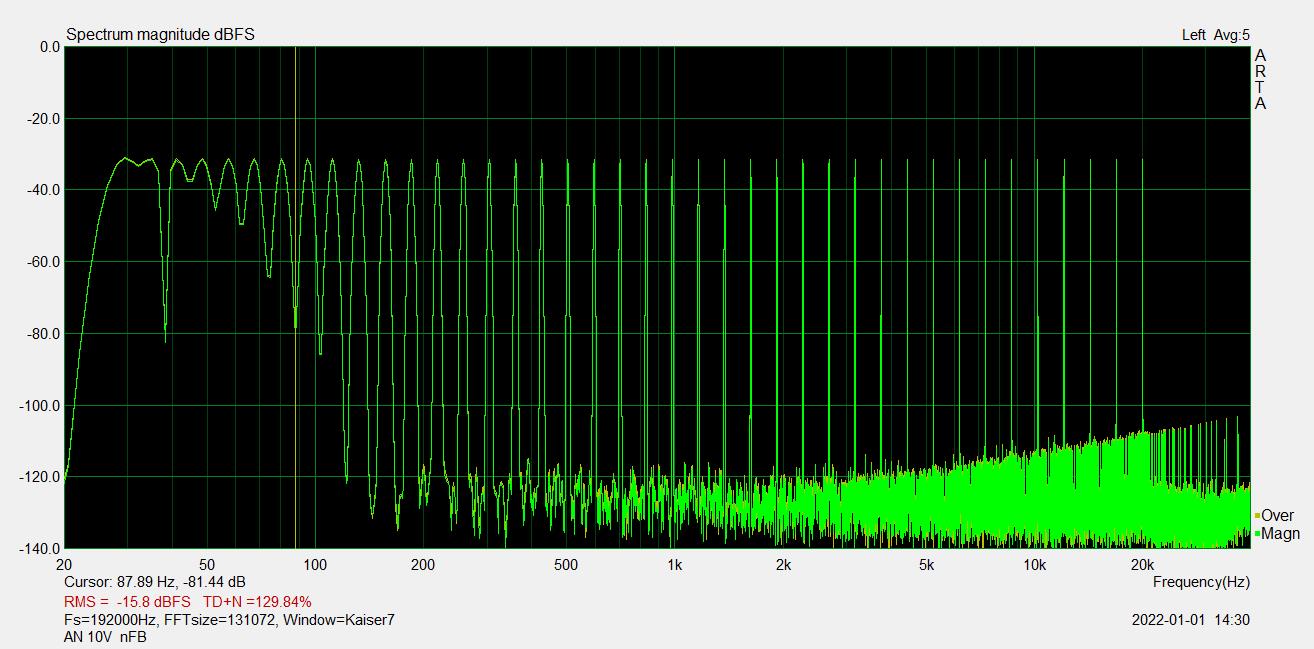

I did some measurements of the amp today, tried to compare it with and without the nested feedback, but the diff was within a few dB (with distortion in the -80dB range depending on power level and frequency), and distortion character stayed the same. No significant changes in that respect.
Distortion is just as advertised, dominant H2 and falling. I noticed that distortion rises with frequency, as seen in the multi-tone test. I did not expect that since loop gain is pretty flat in the audio spectrum, and there is no crossover distortion either. I also noted that distortion went up significantly with 4ohm's load, even at low output levels (not current limited), luckily my speakers are an easy load.
This is the multitone with nested feedback (L & R channel overlaid). Same setting as 10V sine, a bit hard to define power or voltage, I think peaks are the same level as peaks on a 10V sine, so fairly high power output. At lower output, the rise in the high frequencies disappeared into the 'distortion floor' so I guess the conclusion is that distortion rises more in the top end with more power output/current modulation.

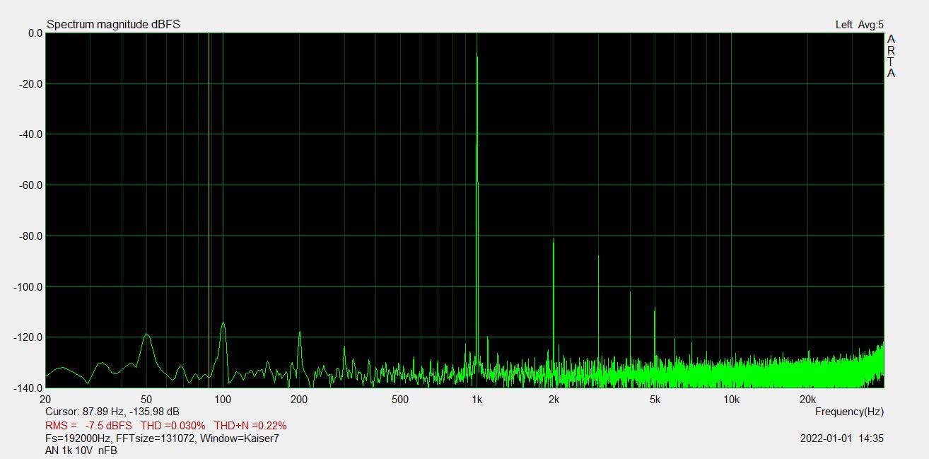

Here is the distortion at 10V sine output, nicely falling harmonics.

All with 8ohm load, Focusrite Scarlett sound card.
My hum can be seen, but not too bad. Actually lower level than 1k H2 at 2,8V output 🙂

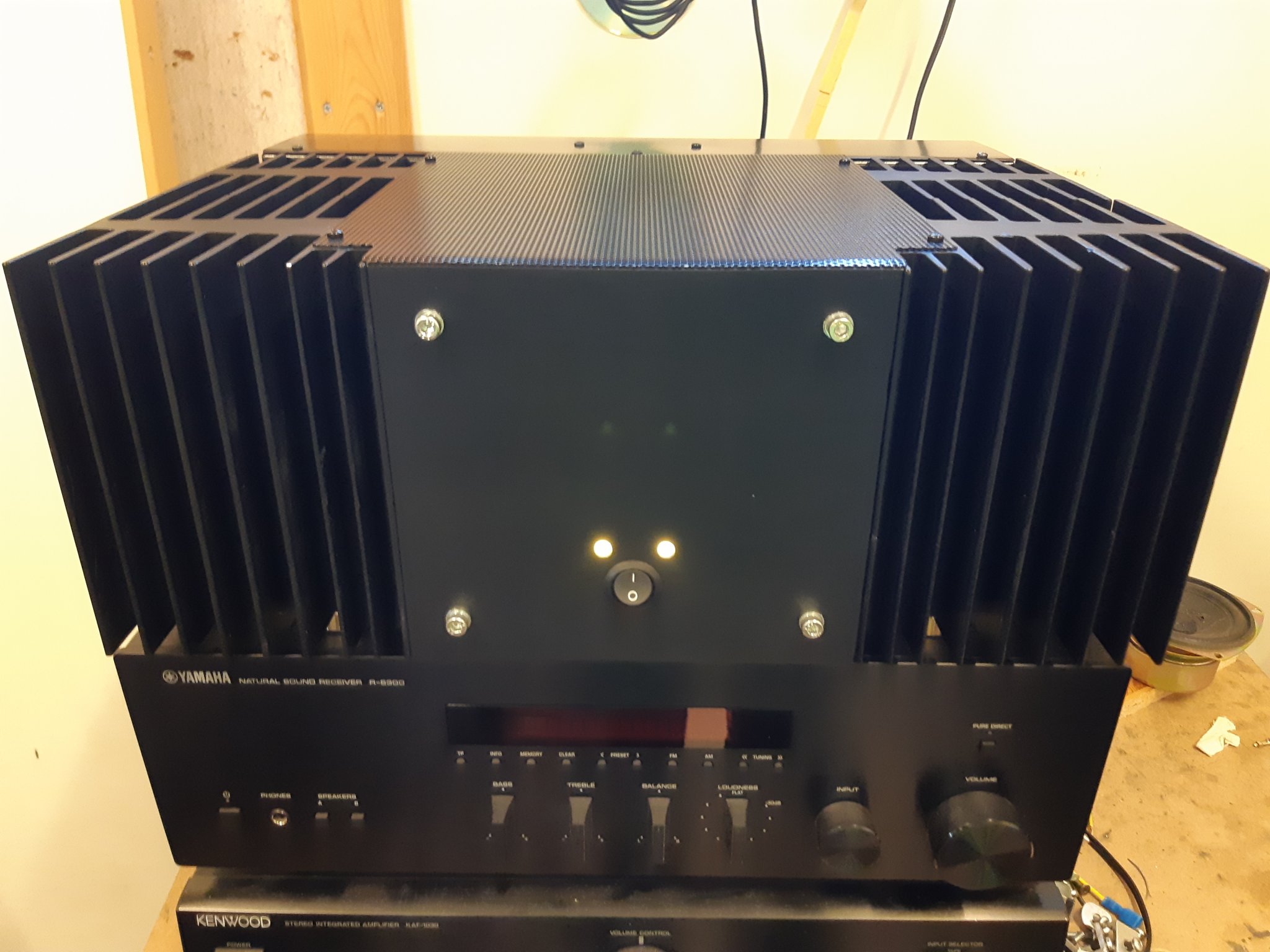

I have been doing a lot of listening the last couple of days and a little bit of tweaking too, and I have not missed my JLH yet!

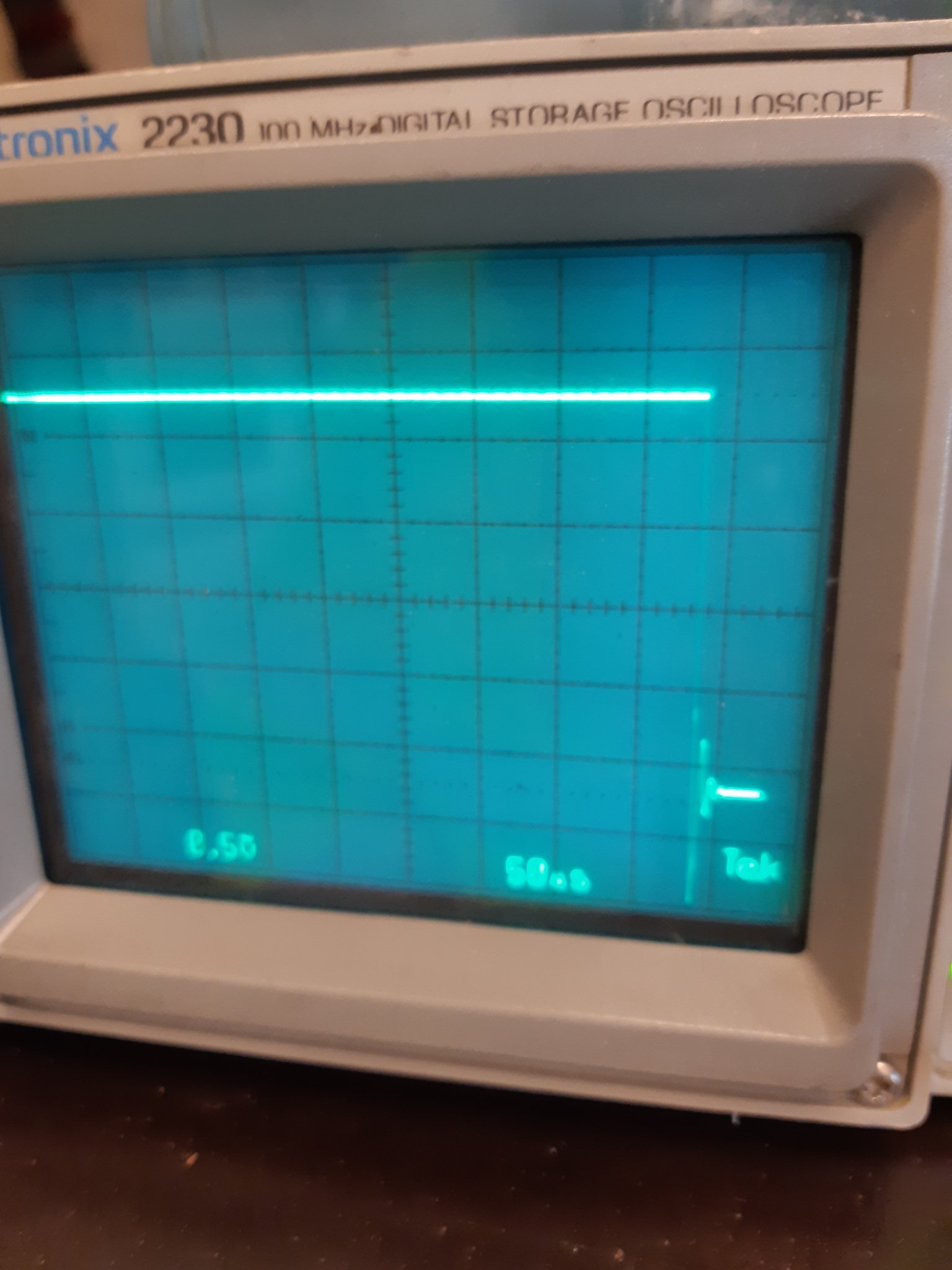

I did some 1kHz square wave testing on the amp today, and it looked good as long as the load was 8ohm, some (damped) oscillations on the negative flank when it got current limited. I also put a 0,33uF cap in parallel with the load, and there were small oscillations on both flanks, and that is what I would consider good stability. Most amps I have done it on were worse with capacitive load. Open load, 8 and 4Ohm resistive loads were perfectly clean. Slight overshoot when approaching clipping with 8ohm if I remember correctly.
Everything tested without C101 and C143. I have now soldered those in, connected the power LED's at the front of the case, and mounted everything together. Will see how long it takes before I have some reason to get in there again to play around with something, it usually doesn't take long 🙂
After some experimentation/sims I have also added another 4,7uF(what I had at the moment) in parallel with the input cap, C111=470uF, 220u in parallel with C124, R123=470k. I'm a fan of a lot of capacitance. Anywhere I see phase diverging from 0deg before 20Hz in the sim, I try to add capacitance, just a thing 🙂
Pictures are of the 'current limit oscillation' into 4ohm load (5V/div), and the amp connected up for a test in the garage.
