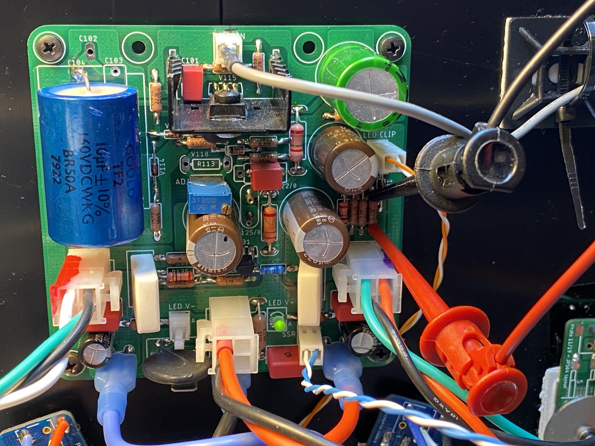

Need some advice on the input stage/LTP bias current. I am using KSA 992 BJT's. Is 2.6mA the absolute goal or is anything around 2-3 mA just fine (Hugh's schematic shows 1.9mA but with different BJT's)? I can dial in the offset to be close to 0mV at ~ 2.3mA but at 2.6mA it is more like (-)11 mV. No big deal either way I bet since the dc offset is quite low.

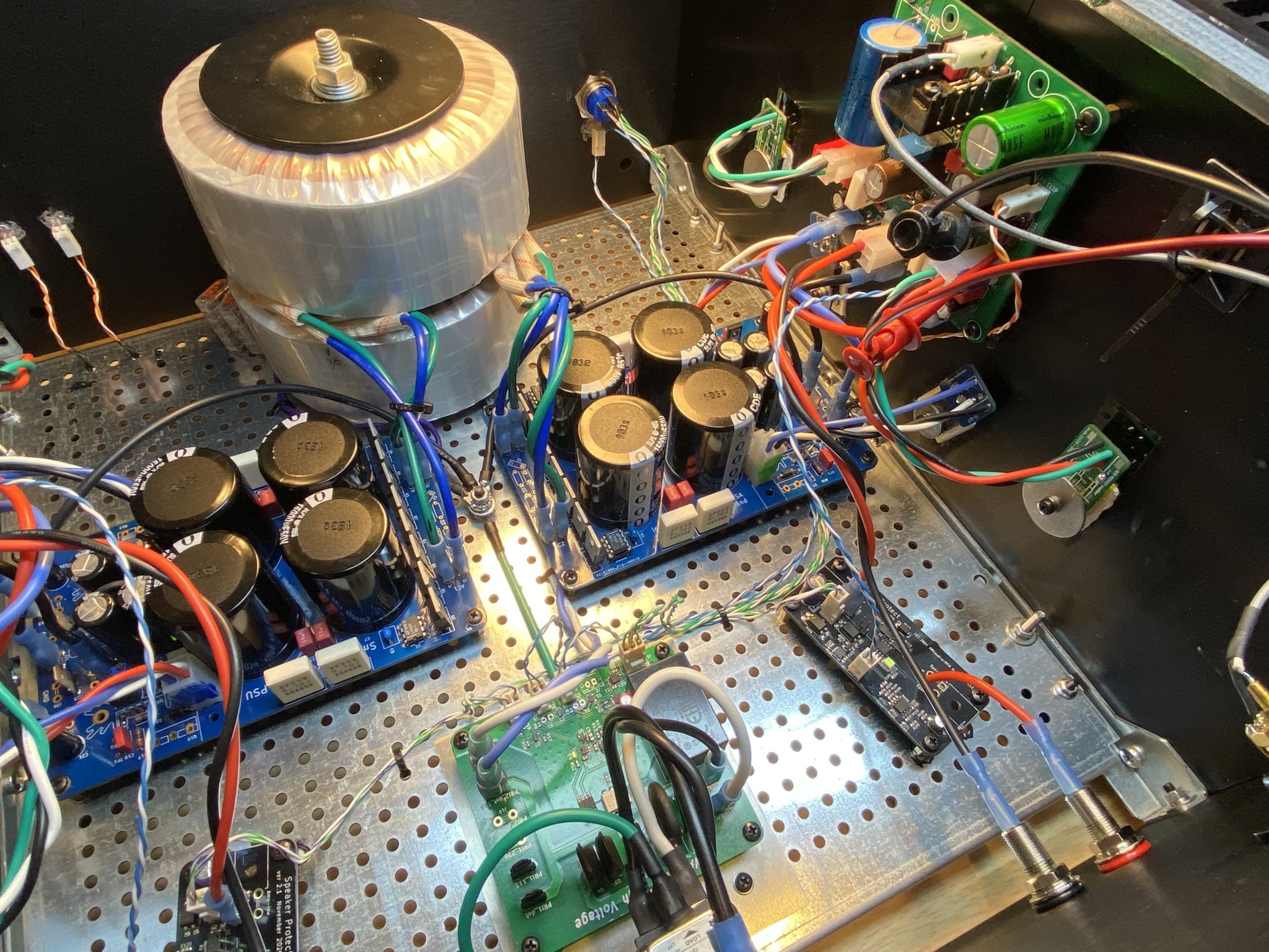

Just so happens I am setting the LTP bias current also. I prioritized the 2.6mA number over output DC offset. Using the R113 trimpot I adjusted voltage across R111 to 8.75v.
8.75/3300 = 2.65mA
Both channels adjusted the same way yields less than <10mV offset Right and <4mV offset Left. Definitely nothing to loose sleep over 🙂

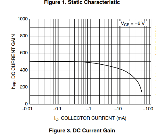

Well the actual question comes down to what really should be the input LTP bias current range for best linearity? Is 2.3mA (which gives me 0mV offset) a compromise compared to 2.6mA?

2N5401 is shows better characteristics in 2mA...3mA range.
Hugh's original schematic was using 2N5401, not KSA992.
On the other hand, I guess running LTP in 1mA range shouldn't hurt anything.... Most of amps stick to 1mA rule.
Perhaps Hugh can give us more details about this...
In my build, I used BC556C, at 1.2mA.
