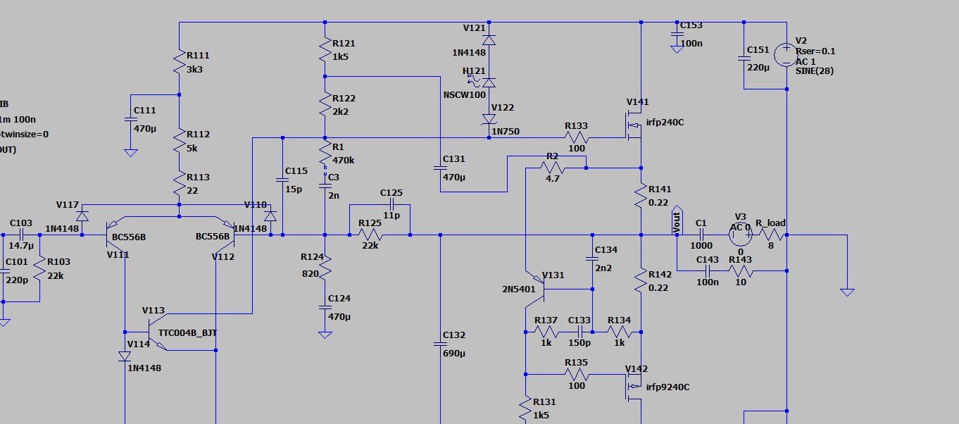

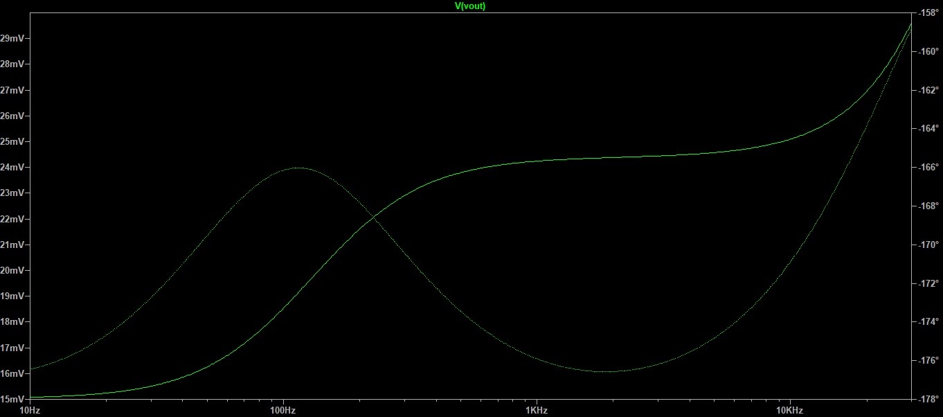

I thought I would share some findings from my experiments with the AN.
Playing around with the sim, I tried moving the bootstrap caps a bit, and found that moving the upper bootstrap cap (C131) to the source instead of the output (other side of the source resistor) just about halves the output impedance of the amp. I could not believe it would make such an impact, but that seems to be the case. I also ran a sim with the tian probe and distortion sims, and nothing seems to change there. So, a couple of days ago I did the modification. It was pretty easy, I only had to drill a new hole, turn the cap 90deg and solder in one leg in the new hole. The source resistor limits the diameter of the cap, so I had to take what I had, and that ended up to be 1000uF that were smaller in diameter, but higher. The value should not matter much, I went from 470u that I built the amp with.
After the mod I did some quick distortion measurements just to check, and they seemed to be the same as before.
The first listening impression was that bass had more 'transient attack' and more control, and that impression has lasted while I have been listening to the amp. More of the so called PRAT I would say, more foot-tapping when I listen now than before..
I think there is less of the smoothness and (single ended?)character the amp had in the original configuration. So I think in summary, if you are keen on experimenting, and listen to music with dynamic bass (drums, bass etc) I would recommend trying this out, but if you only listen to classical and acoustic music and like it sweet and smooth, I think the original setup is probably better.

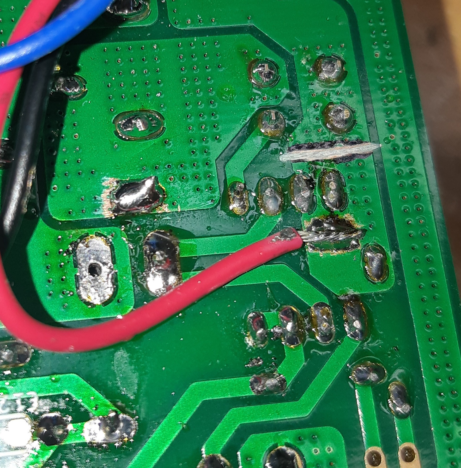

I attach a schematic and picture of the moved bootstrap, here you can also see the values I used in the nested feedback, and I'm pretty happy with that. I still plan to try 1n on the cap instead of 2.2n.
Don't mind the cut traces and cables on the picture, those are for my separate front end supply.

Rf
Thanks for the report back! If you have the ability to measure the output impedance at say a test frequency of less than 500Hz (perhaps 100Hz), that would be useful info as well.
I believe the original design has a damping factor of 160 into 8 ohms, or about 0.05 ohms. Did you get an output impedance of 0.025 ohms, i.e. a damping factor of 320 into 8 ohms? Either number imho opinion is very adequate.

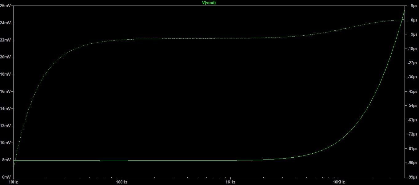

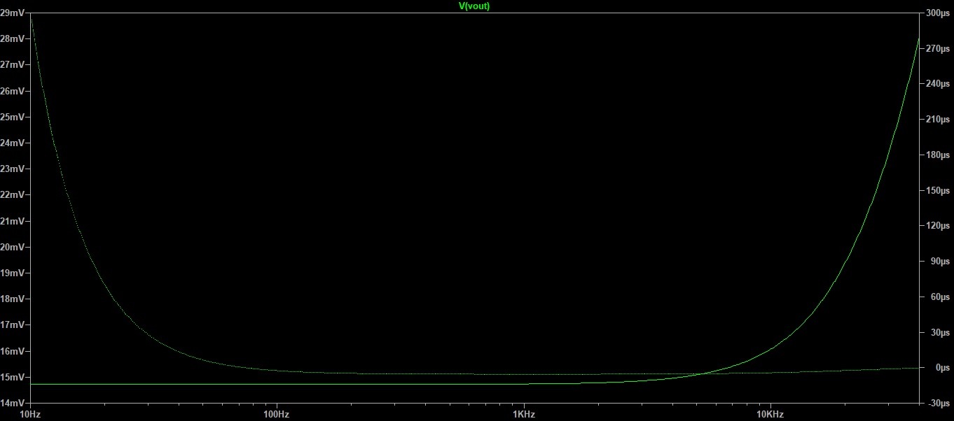

Depending on the nested feedback config, the output impedance will vary with frequency, so I only used the theoretical minimum which was just under 15mOhm in standard config, and just under 8mOhm with the bootstrap moved. I have not measured it, and I think I would mostly be measuring wiring resistance etc if I attempted to measure, and I would also have to move the capacitor back to the original position to compare the measurements.
I'm happy with the sim results, and the subjective test.
I post the sim bode plots with and without nested feedback (using my values, not the original ones), comparing the bootstrap cap position. Keep in mind that the impedance minimum will be at even lower frequency using the 4.7n in the nested feedback. Simulation is done with 1VAC fed though 1Ohm resistor to the output of the amp, and voltage on the amp output is plotted.

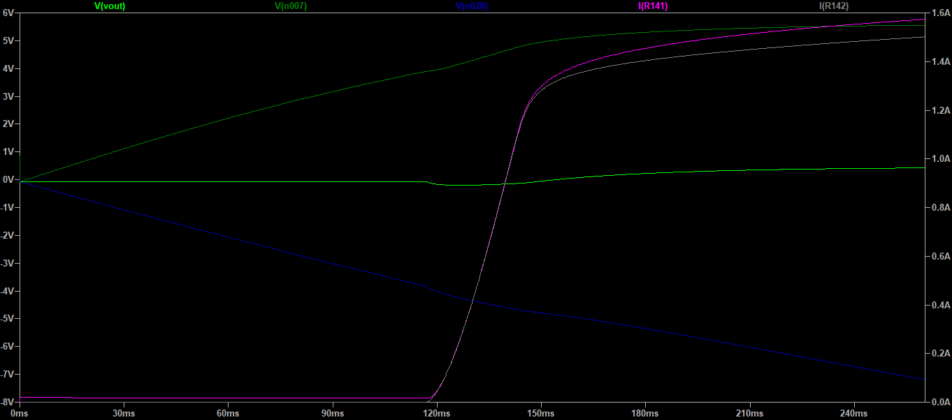

I just found another thing in simulation. My turn on thump got worse (really only a temporary offset though, because it's slow and inaudible) when I put in the 1000u for C131 in the mod above, so I simulated different cap values. I have now ordered 1500u that I will use for C132 keeping C131 1000u as is. According to sim that will give me a slow 2V negative thump. That will do, because that is what I could get locally.
The best combination I have found in simulation is C131=470u and C132=820, this is almost flat in simulation, only a slow 0.2V variation on the output at startup. Should be totally inaudible and not visible on the woofers when no output relays are used. Well, maybe I'm the only one running without output relays? Bigger caps also delay the time before current starts flowing through the output stage, in this case abt 120ms from power on. This would give the PS some time to settle before current starts flowing. See graph below.
I could not come up with a smooth startup using smaller caps.
