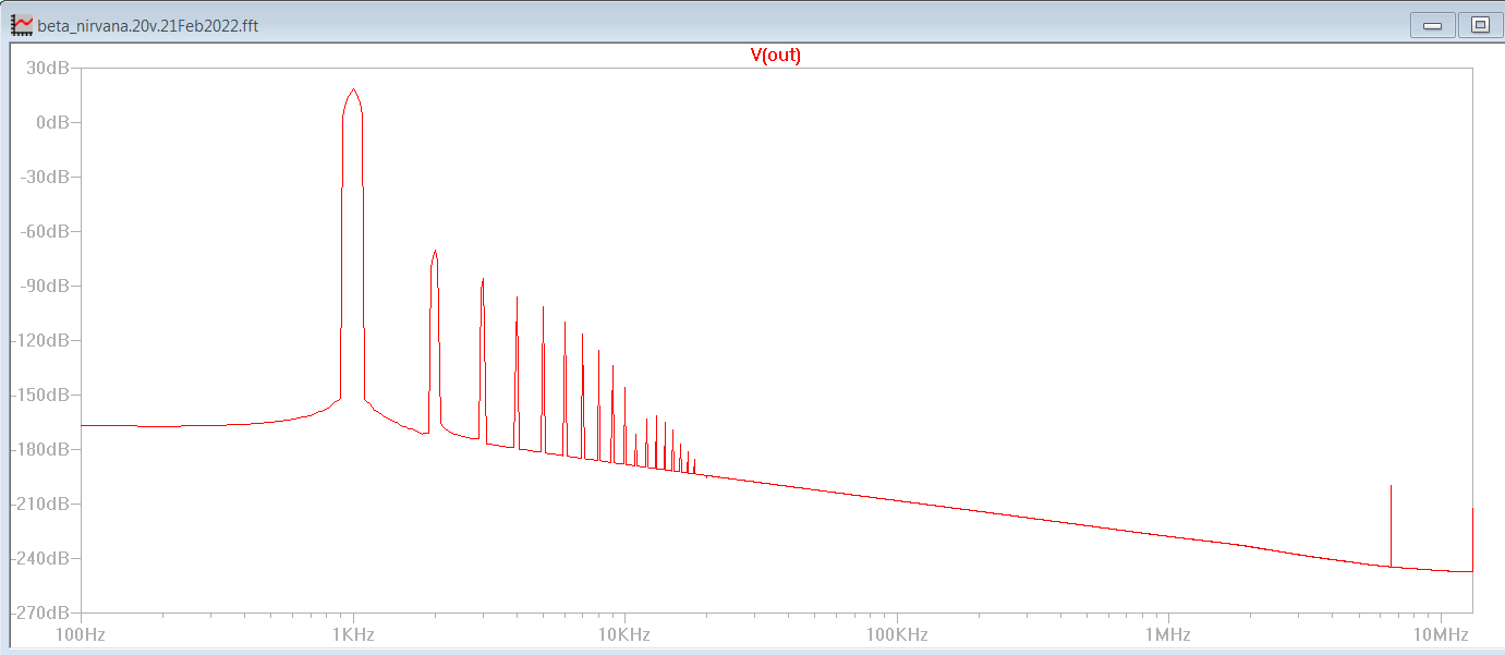

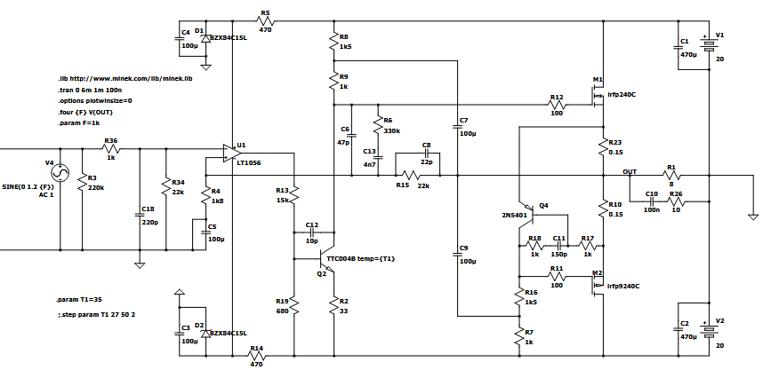

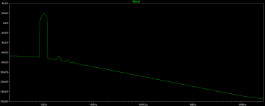

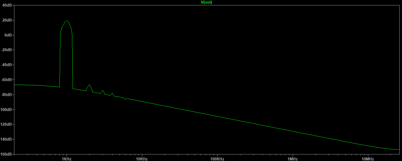

Here a slightly updated version that handles square waves much better,
and ALSO has some FFT shaping RC network added (optional), so the profile is the similar levels like original AN.
Perhaps this effort went little bit too far 🙂
Feel free to play with values of R6/C13 to adjust the harmonics levels.
This fft plot with current value sof R6/C13 is included only as an educational exercise, I wouldn't keep it "as is".
Even with this straight-line profile, Thd level stays at 0.005% level at full power, which is very interesting behavior.
It didn't get much worse, as I expected.
Slew rate also seems to be slightly (20%) improved over original AN.

What you mean by "zero feedback"? Just by adding bootstrap, you are creating strong feedback loop.
Even emitter (or source) resistors create feedback loops too.
Regardless of that, the Lufo profile looks as good as it gets....
Yes you are correct - the cascode above the JFET is a local feedback. I meant zero feedback from output stage back to input stage.

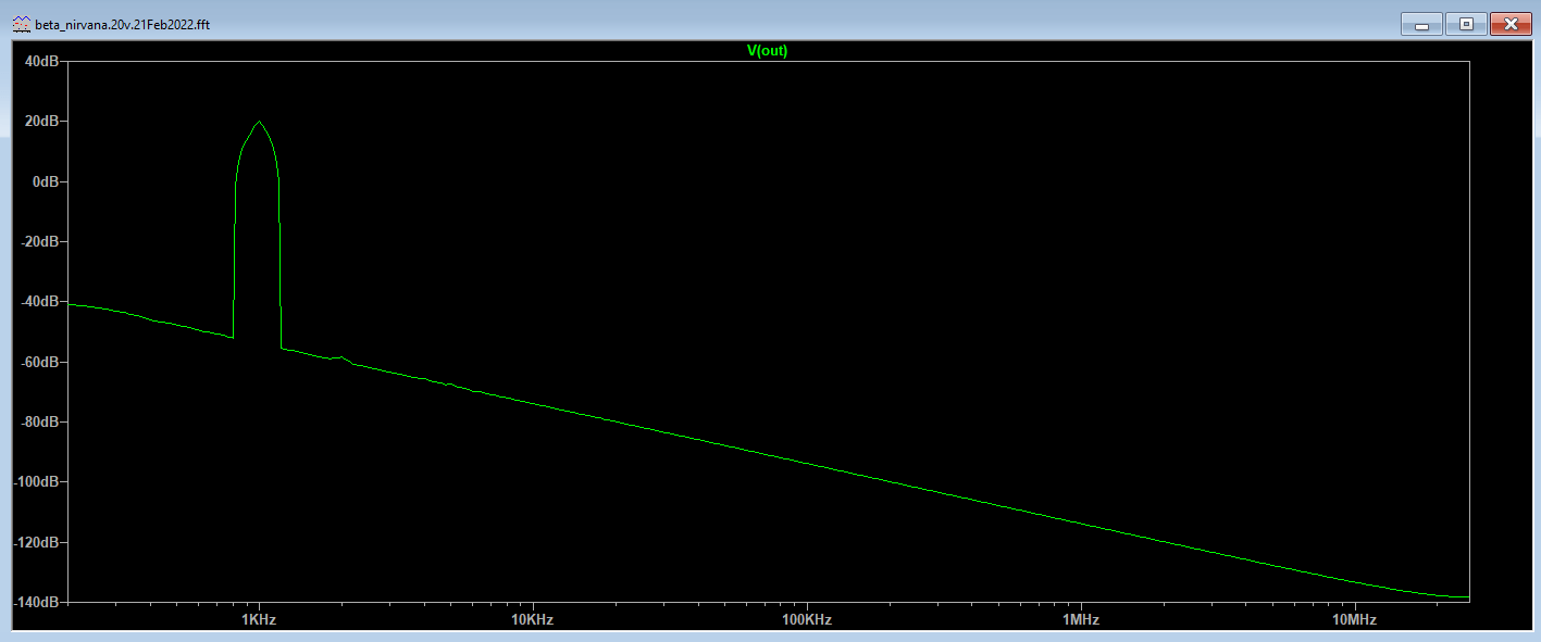

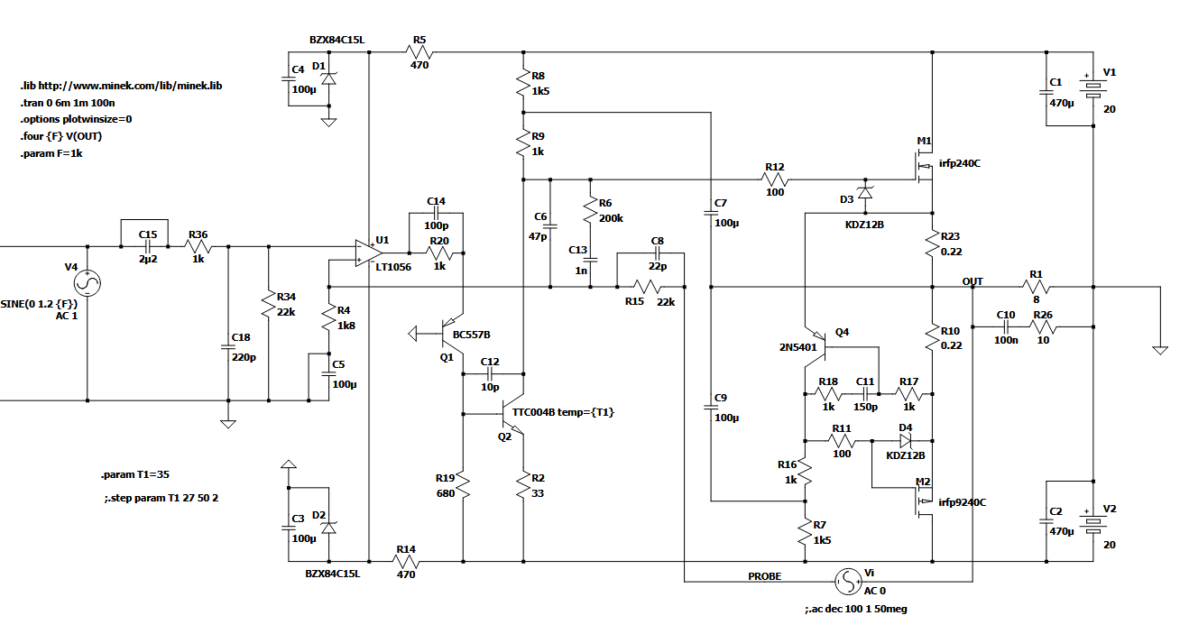

And here is new and improved version with a buffer (Q1 after the op-amp) mentioned in previous post.
Thd is down, R6/C13 adjusted for a more reasonable FFT profile.
Gain can be set by R4 (higher value = less gain). Rails can be increased to, say 27V, without changing anything.
C5 is most likely not needed - prototype build will tell us if output DC offset is close to 0V. If not, C5 will be needed.

I make your FFT at +20dBU (12.5W//8R) very good and with H2 -90dB and H5 -120dB it couldn't get any better! Good circuit, congratulations!
Looks great! Hugh, can you share what did you do?

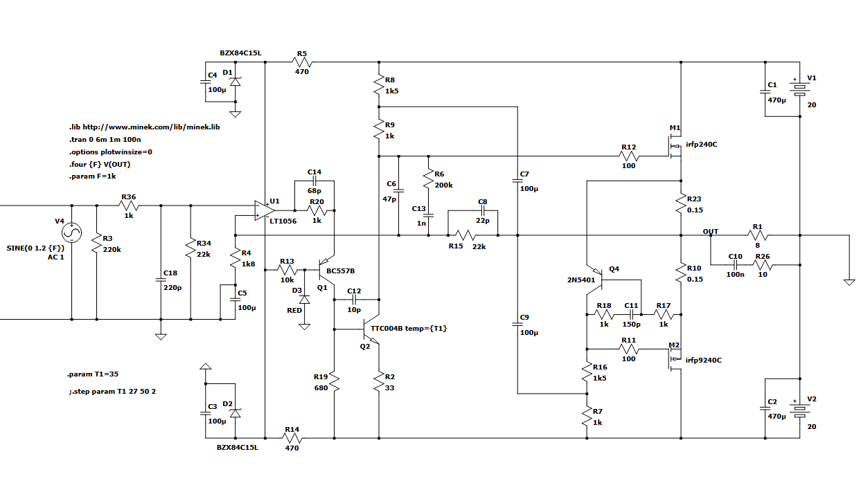

Here is latest schematic:
1) Q1 cascode simplified (base of Q1 can be connected directly to the ground, one resistor and LED eliminated)
Q1 could be pretty much any small PNP BJT
2) 12V Zener protection for FET gates added.
3) source resistors changed to 0.22 Ohm
One more thing left to test - clipping behavior, and capacitance loads.
