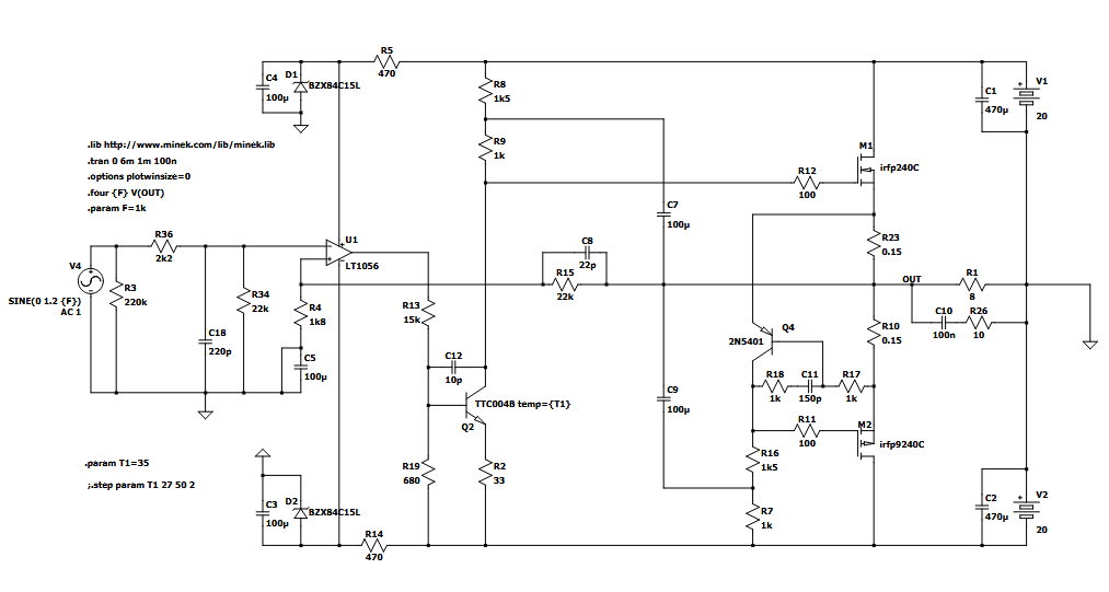

I was just playing with Alpha Nirvana schematic, and decided to try to use JFET op-amp as the input stage.
I actually have never seen class A amp driven by an op-amp, but here it is 🙂
Cheap TL071 op-amp can be used here. This versions seems to be doing fine at 1kHz and 20kHz, and shows
much better sim results than discrete amp.
This is just a proof of concept. Speed, and stability have not been tested, but quick testing in spice so far looks promising.
Hugh, do you think this may work? Besides the fact that some "purists" may be put off by the op-amp...
The VAS transistor seems to be much more stable temperature-wise, than our previous attempt..

I certainly looks like it would work well. Very good topology!
It adds a high loop gain in the opamp to the high loop gain from the VAS.
This gives huge levels of nfb, which should deliver very low THD but does it maintain the harmonic profile?

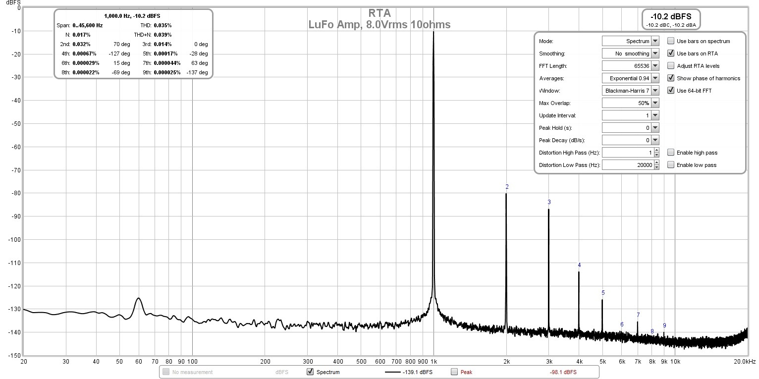

X, this profile here is the profile of the Output Stage only, right?Hi Minek,
I used an OPA454 to drive the LuFo (40w) and the SuSyLu (100w). It’s capable of 90Vpp. Sounds quite good and distortion profile is dominated by output stage, which was SE Class A here.
https://www.diyaudio.com/community/threads/lufo-amp-39w-se-class-a-from-28v-rail.372679/
In your Lufo setup, pre-amp and OS have separated feedback loops, and each of these 2 components have it's own "profile".

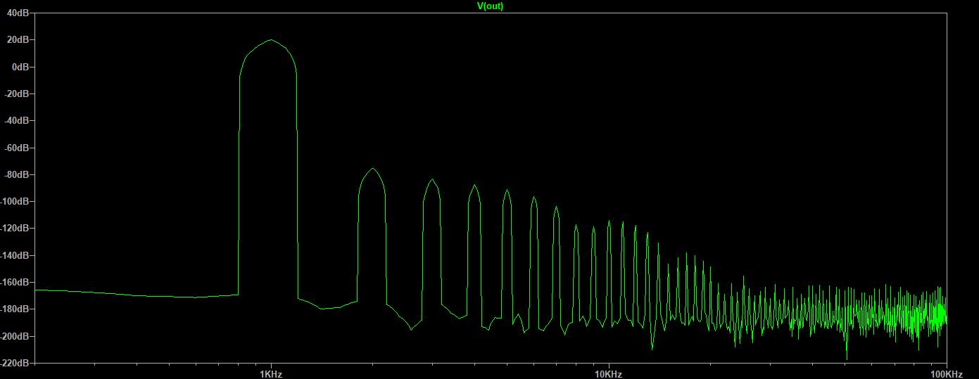

Of course not - it doesn't maintain the same profile, as I skipped all your magic profile-shaping RC tricks 🙂
Now we can play with the slope of harmonics.
I bet you can come up with something to shape the profile the way you like it.

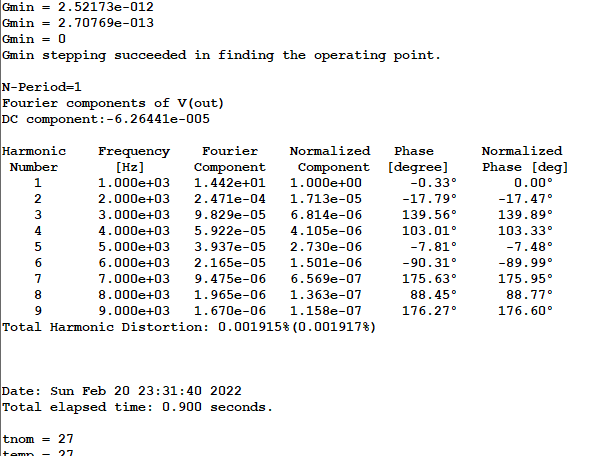

The "bottom" of the new profile is at -170dB, which is exactly where I like it. This level is below measuring capabilities of QA401
analyzer, so in real life we gonna see -120dB when measuring it.
In my sims of AN (at full power), bottom of the "profile" started at -50dB and reached -75dB at 20kHz.
Now it's below -170dB all the way to 100kHz (at all power levels). Peaks of harmonics are all below -80dB, and sloping downwards
from -80dB at 2kHz to -100dB at 10kHz, while Thd stays below 0.002%.
I'm happy with this "profile", but I understand some listeners will prefer higher levels.

What you mean by "zero feedback"? Just by adding bootstrap, you are creating strong feedback loop.The output stage is zero feedback on LuFo.
Even emitter (or source) resistors create feedback loops too.
Regardless of that, the Lufo profile looks as good as it gets....
Hi Minek,
What are the rail voltages on the opamp and is a HV opamp needed? The schematic is still very simple. I look forward to seeing your prototype build.
Op-amp is powered by 15V rails. It doesn't act a VAS, so it doesn't have to produce rail to rail swing. Q2 will do this.
Maybe this should have it's own thread?
If you have an op-amp that can do it, why not use it as VAS too? Not sure what the output impedance is, but maybe it might even provide better drive (lower impedance) to the mosfet gate? Reduced number of components, -maybe it would increase the OLBW too?
