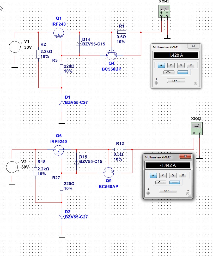

I will build the regulated current supply. Looks simple enough.

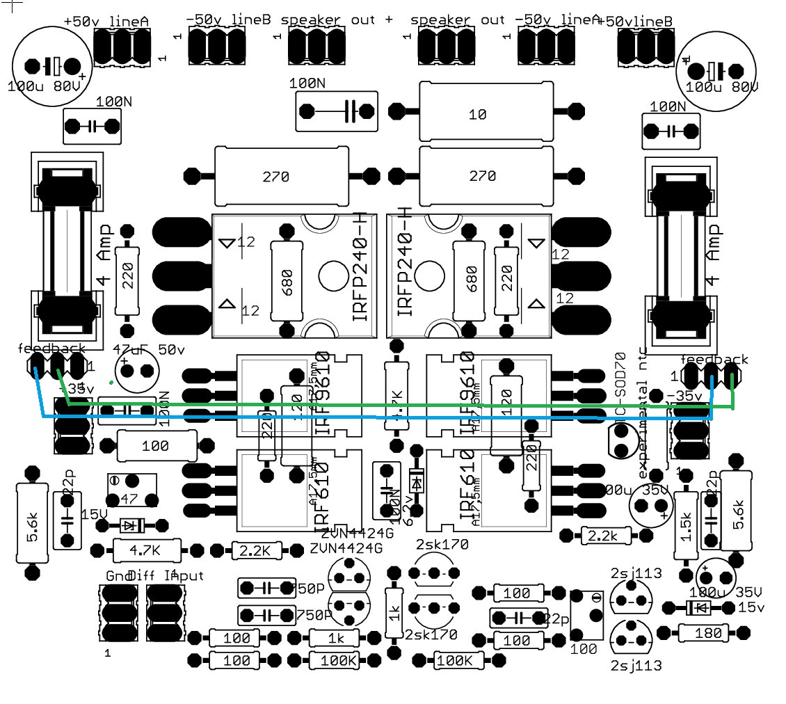

Btw, I also notice the sound is harsh like crossover distortion - even at 1.3A bias. Something strange going on. What does sine wave input vs output look like? It sounds a bit like a class AB amp with very low bias - like class B so hear switching distortion.

On current limit circuit - is the 0.5R used for current sensing? The 15v Zener is just gate protection, what is purpose of 27v Zener? Is there any voltage regulation or just whatever is applied at voltage source comes through? If I want variable current limit, do I replace 220R with 500R pot?
Hi x
It is stabilized through the 27 zeners giving 25 volts, the 0.5R is indeed a current protection, it is simple but works oke, I have used airfp240 mosfet but a smaller one with lower voltage 60 or 100 volts but 10 a 15 amps is also of use.
Variable current limit can not done with a pot because it is low ohmage, but a step switch can be used with for example, 0.1 ohm, 0,2 ohm 0.3 ohm 0.5 ohm 1 ohm etc where 0.1 ohm is the highest current.
You can not adjust voltage, this is due to zener in it, but it is a nice protection for working on the amp.

So which feedback pin should I use please show diagram.

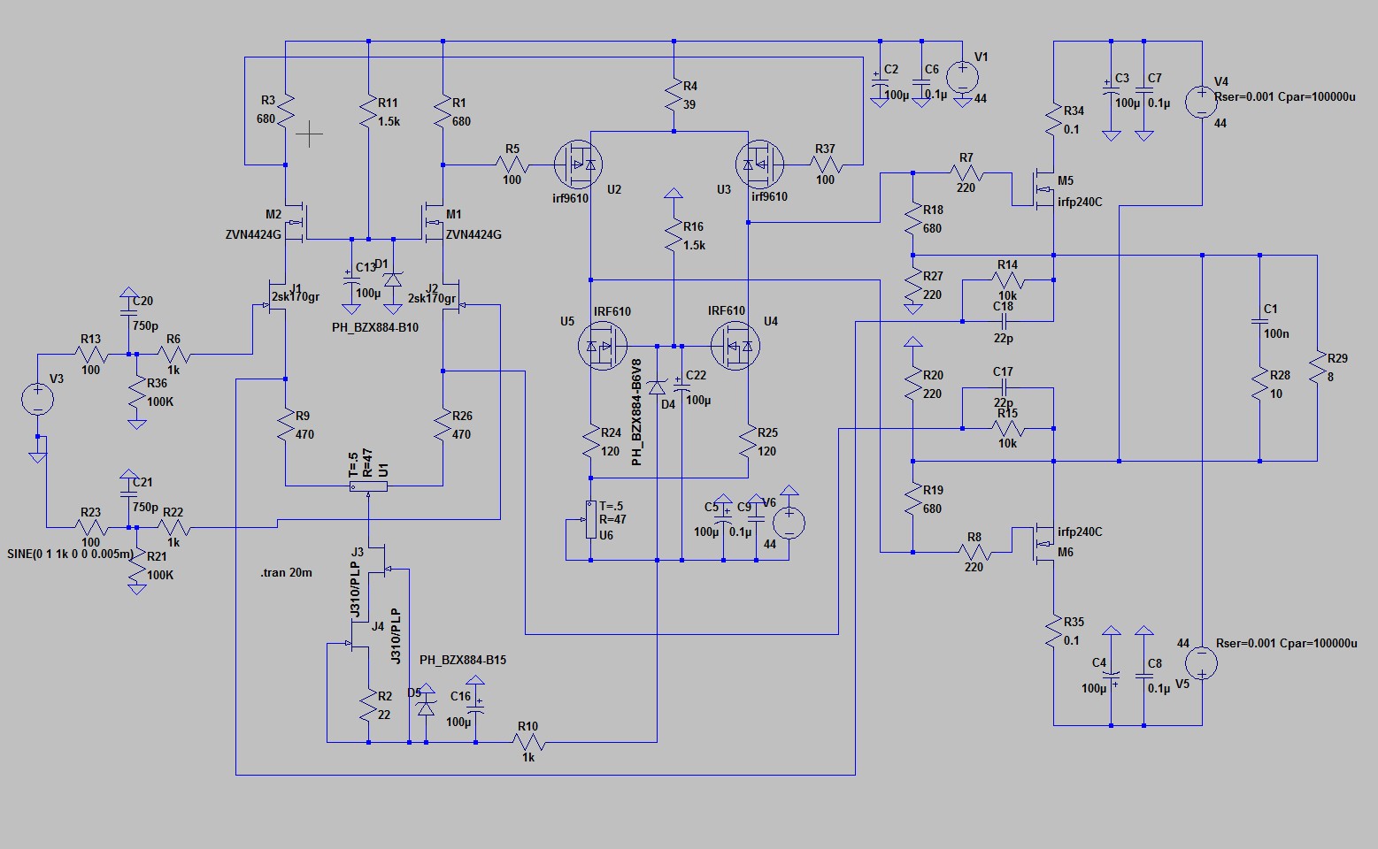

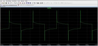

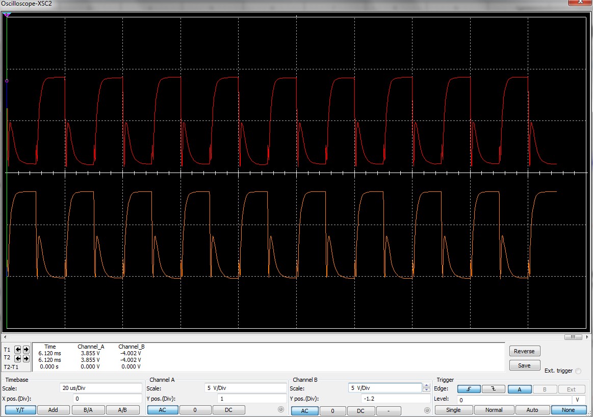

X I have look at what happens in the amp, my idea is that the high impedance of the differential input amp do make trouble when drive the mosfets irf9610 the capacitance of them do shut of this stage and go from 40 volts to 7.8 volts, (without feedback only input section) this drop is a cause of the grainy sound who look at crossover, but is in fact compression like distortion.
So we need a impedance converter there or something so we can drive the irf9610 driver section properly, it give not bad overshoots also.

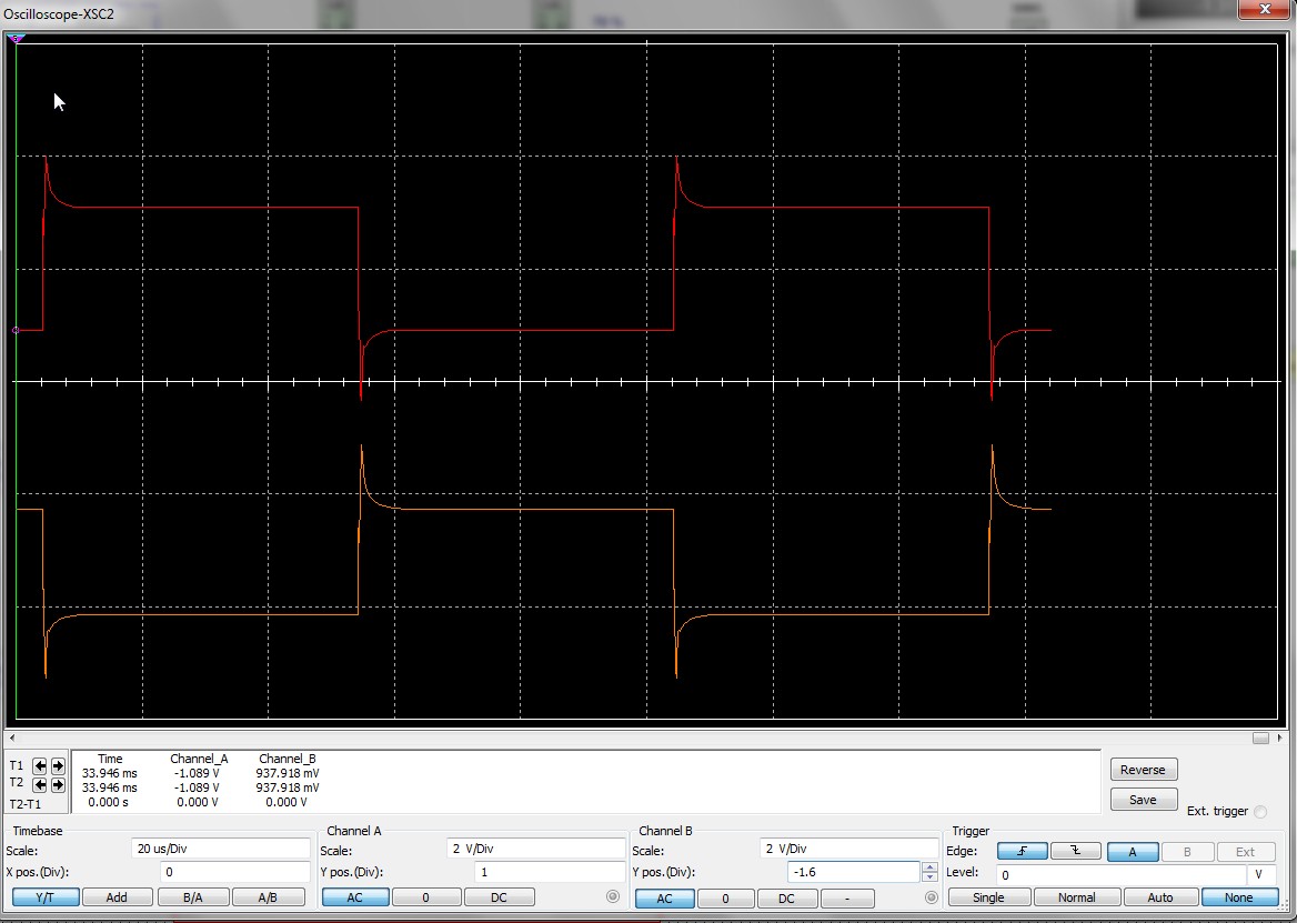

But for the feedback lines see pictures.
The scope pictures is first with no load on the source of zvn4424a and second is with gates connected to zvn4424a and results. (50Khz square)
regards
Kees, my F5 headamp uses 2SK170/2SJ74 to drive IRF610/9610 directly in pure class A very well. There is absolutely no distortion. Please look at resistors used here and see if there are changes to current layout values that may afford this. To be sure, 2SK170/J74 can driver IRF610/9610 perfectly well.

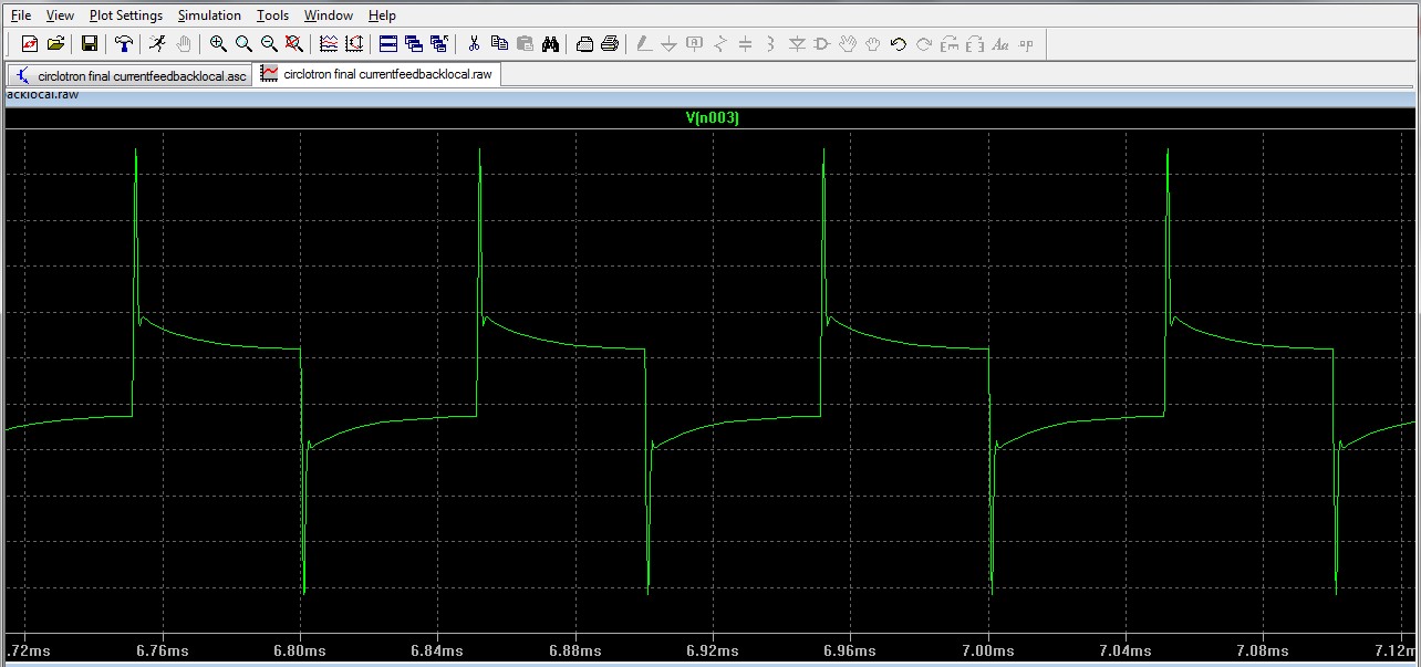

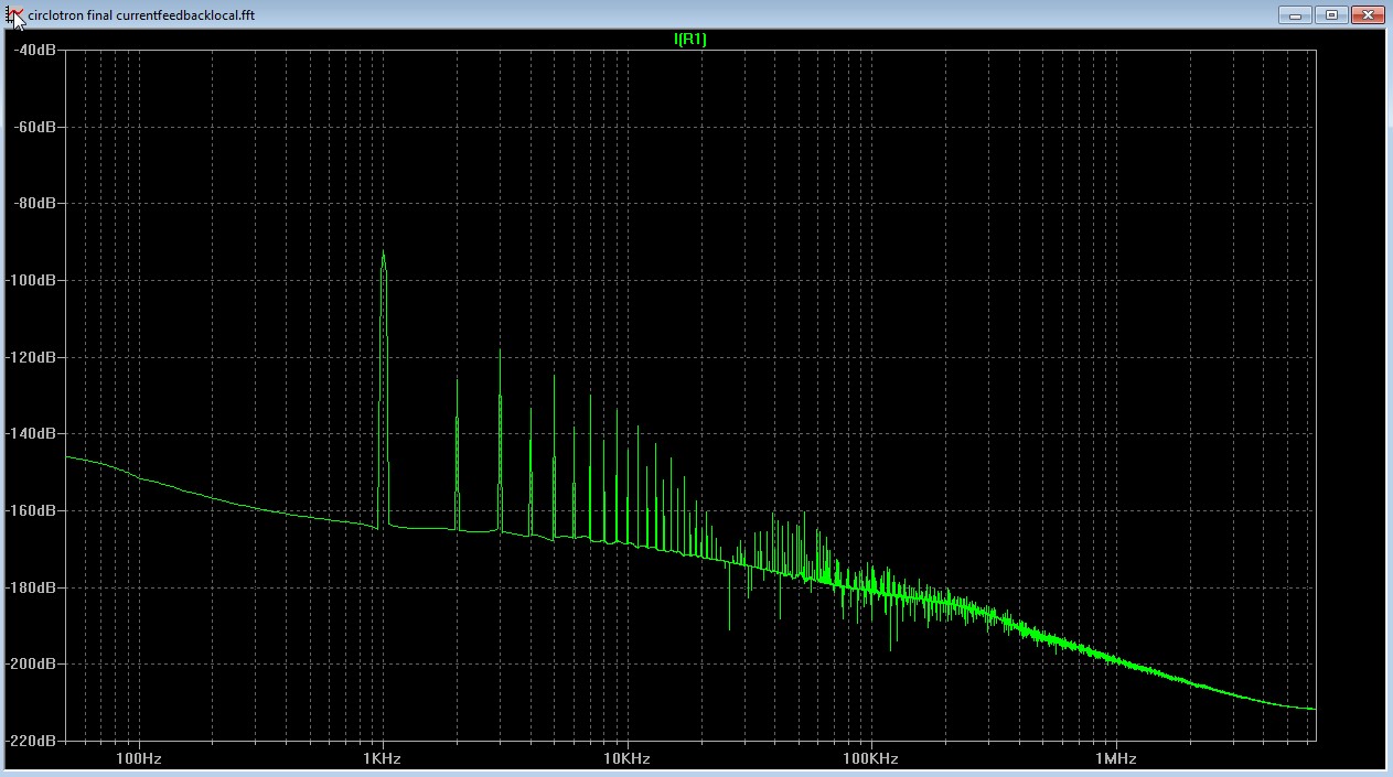

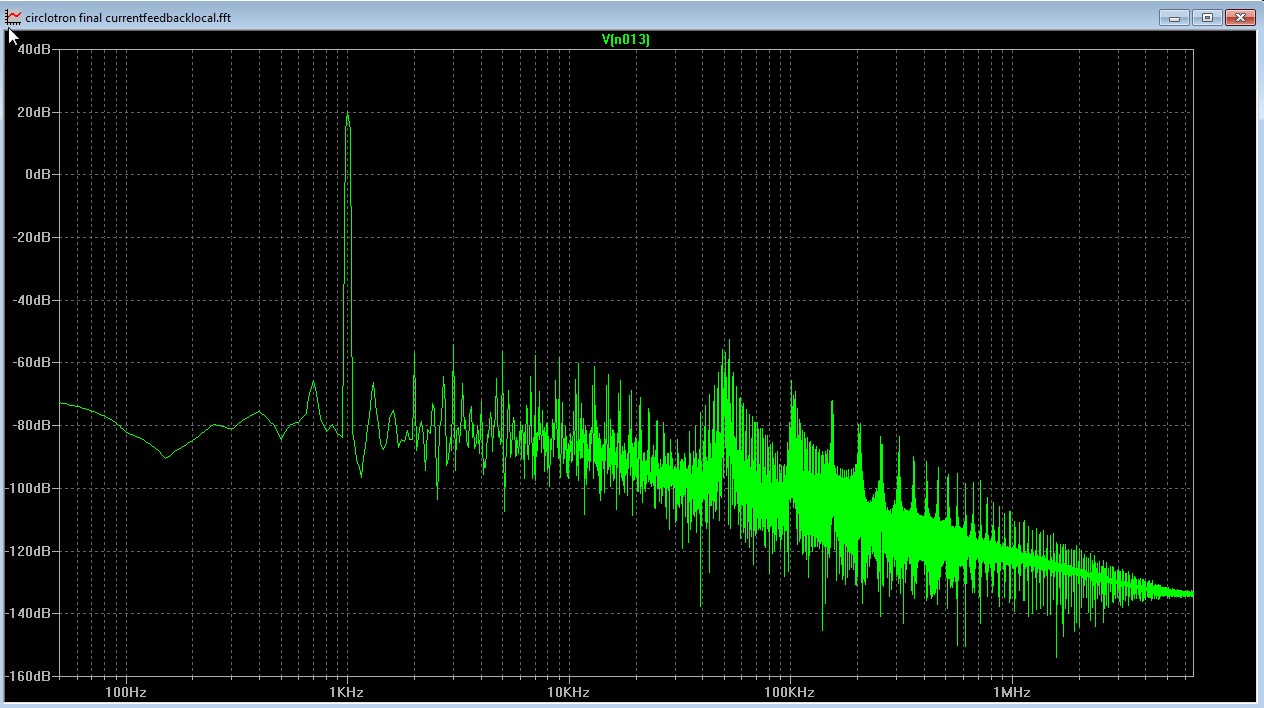

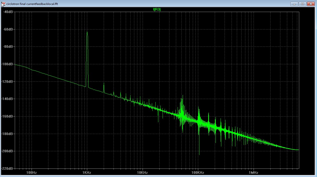

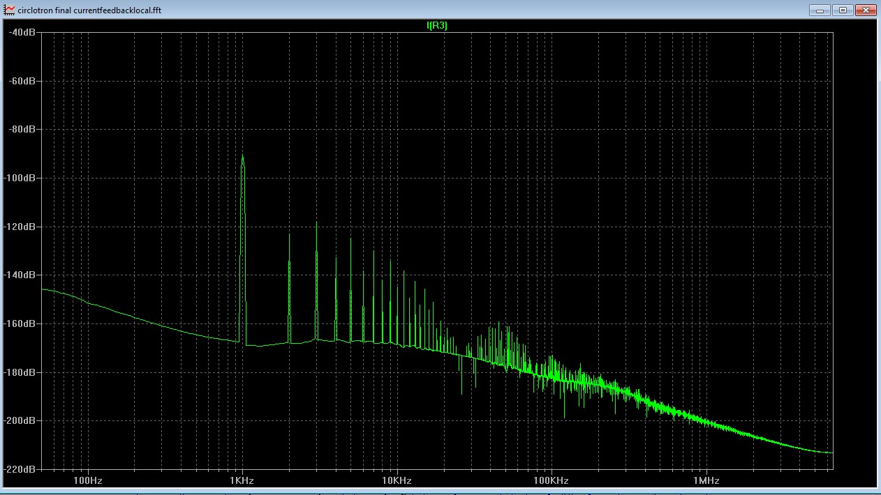

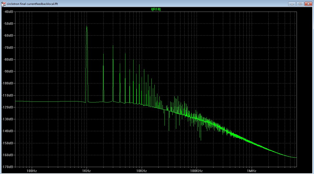

I have test on sim with ltspice, why there is so a nasty distortion, it is waht X say, the current in the long tail pair is to small,zvn mosfet just do dissipate 14 milliwatts.
see the FFT what the differences are. Picture one is wuth long tail pair has higher idle current of 9 mA, but when higher or lower it get trouble by make more distortion. The first picture is how circlotron is now, the 2.2k resistors have way to high impedance to drive irfp 9610 capacitance, because this fet do amplify the capacitance do also, (miller).
regards

You mean increase from 10mA to 18mA in LTP is what we need to do get lower distortion? Would changing 2.2k current limit resistors to 1k do the trick (plus adjust pot located at the end where the negative fail is)? Zvn4424 is a vertical MOSFET capable of 1.4amps in a TO92! Vertical MOSFETs require higher currents to stay away from crossover distortion. It would seem that 2SK170's (capable of 15mA) would have been a more linear choice. Not sure if pin compatible between two.
X
I have lower the LTP 2.2k to 680 ohms, and a current of 8 mA, the fact things distortion so much is because the LTP current feedback steal current and so crossover occur. It as you say in yours, it did sound well, and because your headphone amp has also a current feedback who looks at mine it make sense.
with this modifications we get better, however I think the CCS needs to be a PN4391 or a DN2540 mosfet.
I go today because it raining soon make the modifications here, now I have in ltspice harmonics -80dB down.

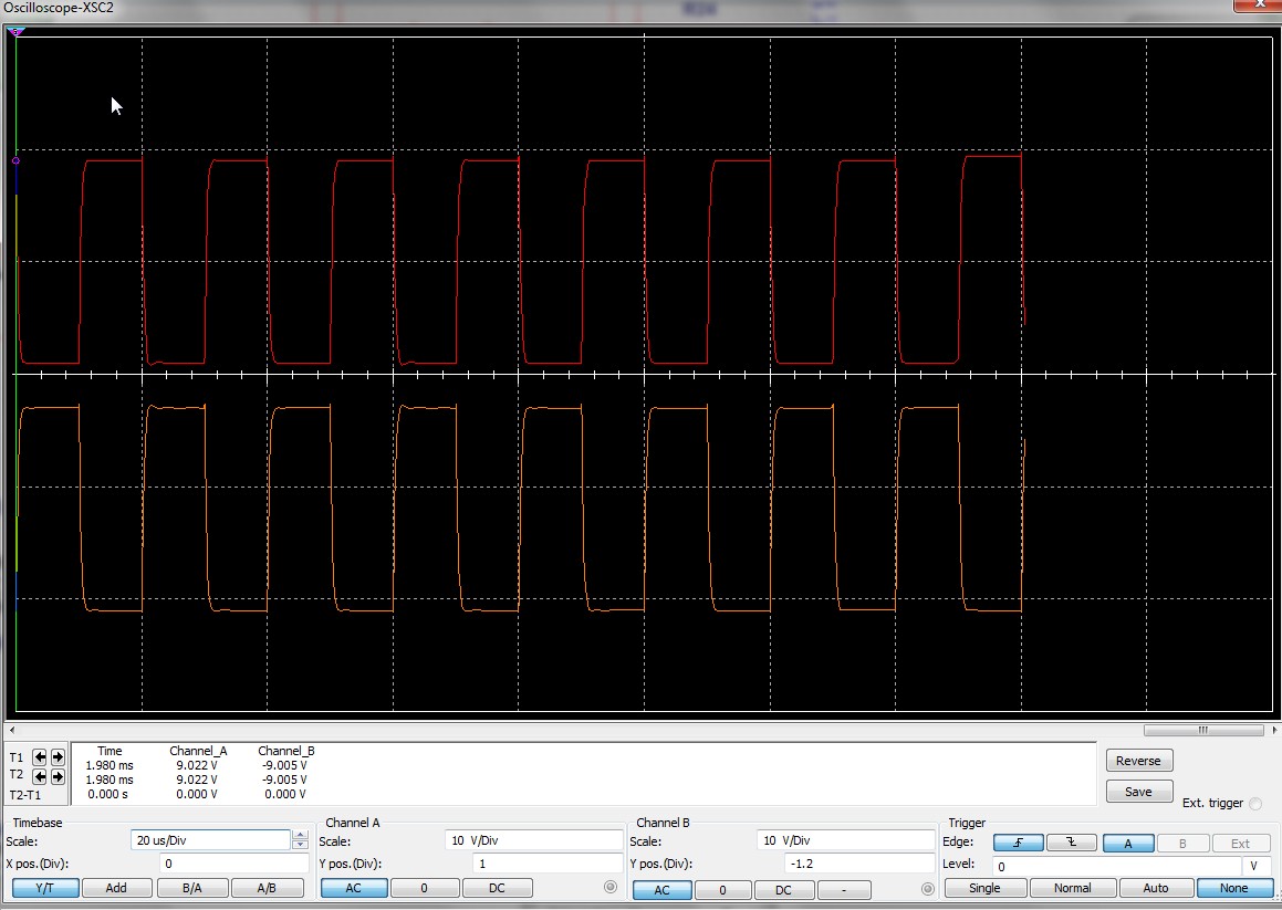

X I have look intensively to the ampplifier and we have a problem with the cascoded long tail input pair, the impedance is such high that the capacitance give the problems, LT spice see it better as multisim but it looks like.
Removing the gates and sim then give a nice square, what we need is a low impedance driver for the irfp 9610 between the gates and the long tail.
I have make the resistors smaller and now it is 680 ohm impedance still dispite the sim give -80 dB distortion figures do not mean it sounds well.
That your headamp do well is because it is not a long tail input, but just a drain follower driver who is not so high in impedance and so can drivce the irfp who also do just some volts .
Here the sim and real time, I get uge overshoots because of the high impedance of long tail pair seeing capacitance mosfet who is in fact need current.
regards
