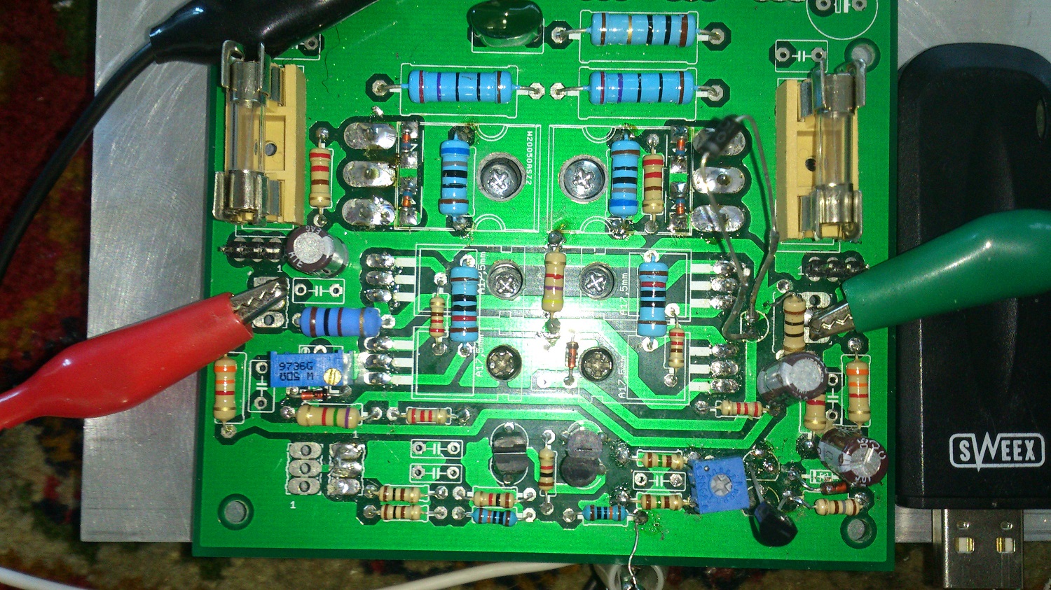

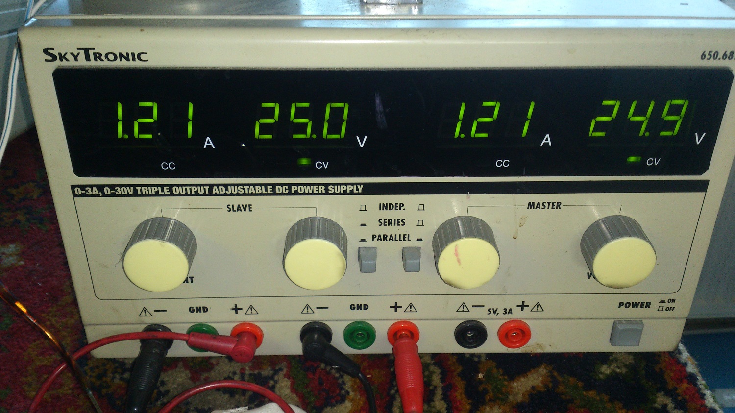

I did set after cool down set up the amp again, it did start with 720 mA and did run in just 50 seconds to 1.21 amps and did stay there happenly, yes with a coller because I have just a small heatsink of 9 x 15 cm.
I think just some small correction is needed, not more, will go have a happy end I think.
regards

I have put it onfor hours settings at 500 mA at last 4 hours later it wa climbed to 513 mA, not bad at all, without the fan it stays stable until I can not touch the heatsink anymore then it drops, maybe also because of the fet get very hot.

I replaced with genuine Vishay IRFP240's and am using BD139 temperature comp as you showed in diagram. I still have resistor current sink on input stage. The bias walks around a bit at first but after heatsink warms up seemed stable. With safety resistors in place and running 500mA still suffered thermal runaway as MOSFETs got cooked after longer period. This time 2 minutes then all of a sudden dead. Looking at dead MOSFET you can see it got so hot it oozed molten solder out of its joints onto silicone thermal pad. I did not change 15v Zener to 8.2v for D3 as I am using reisisfor for CCS so did not think it mattered. I think I need to wait for your final schematic and part stuffing guide.

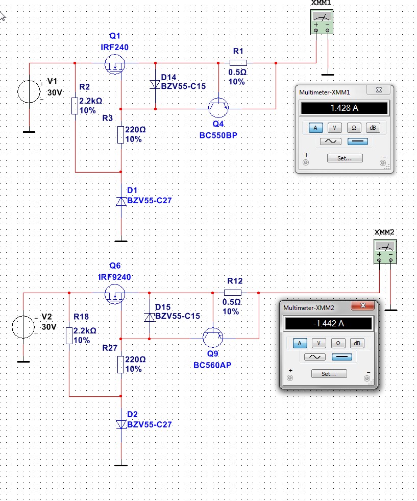

X here a very simple but effective current limitor supply.
with 0.5 ohm between base and emmittor give 1.4 amps max making the bigger in ohmage wll give lower current.. old and simple design block zener voltage if transistors go on.
never again blow up resistors.

I have tryed to loosen the bold of the irfp240 and his transistor sensor, welllll it go run as hell when I do that, so it is a hexfet for shure, the sensor do work as I did already saww.
The amp is on now for 1.5 hour, without problems and with sound.

Thanks for current limiting circuit. That will take a small vero board and need to be clamped on same heatsink. Maybe I need to make it as a lab bench variable current PSU?

Kees,
On current limit circuit - is the 0.5R used for current sensing? The 15v Zener is just gate protection, what is purpose of 27v Zener? Is there any voltage regulation or just whatever is applied at voltage source comes through? If I want variable current limit, do I replace 220R with 500R pot?
