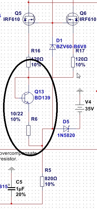

Can you draw a sketch of how to connect BD139 NPN? TO126 is small enough to fit in there on top of IRFP240.

The diagram shows what looks like a simple 2-wire connection from the BD139 strapped to the top of the IRFP240 (btw, the one on the left side seems to go first) with two flying leads. I think the thickness is just perfect fit for the gap that I have.

R6 are for degeneration of the emitter if it overcompensate, to big a resitor and we get trouble, need to get enough idle current in driver, it drives irfp,s..

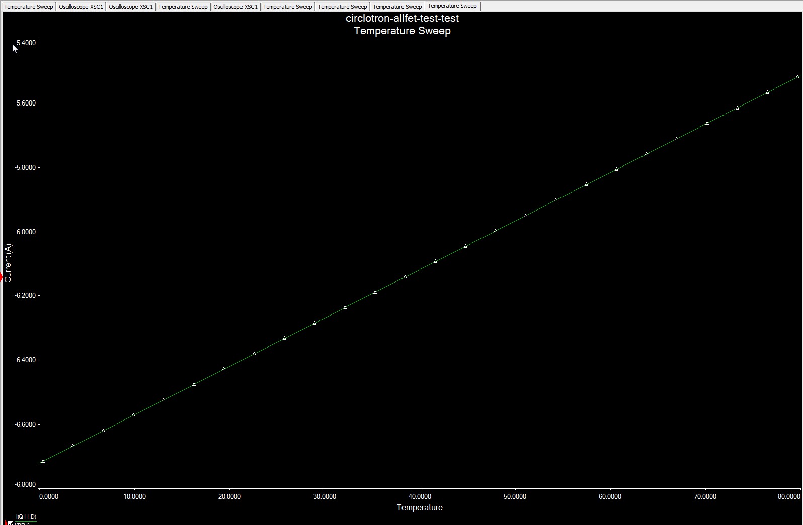

What I do not understand is why it act like that while the simulation says it is mucho overcompensated, even without Vbe multiplyer.
for what the design concerns, it is fun to play with it, but I advice a supply who can be regulated so a run away is not dangerous, in my case it just limit on 1.3 amp can never be higher.
idea over why the sim is otherwise? do we have bad mosfets because a temp runout only happens when the spot in the mosfet get hot whyle the surface is still cold.

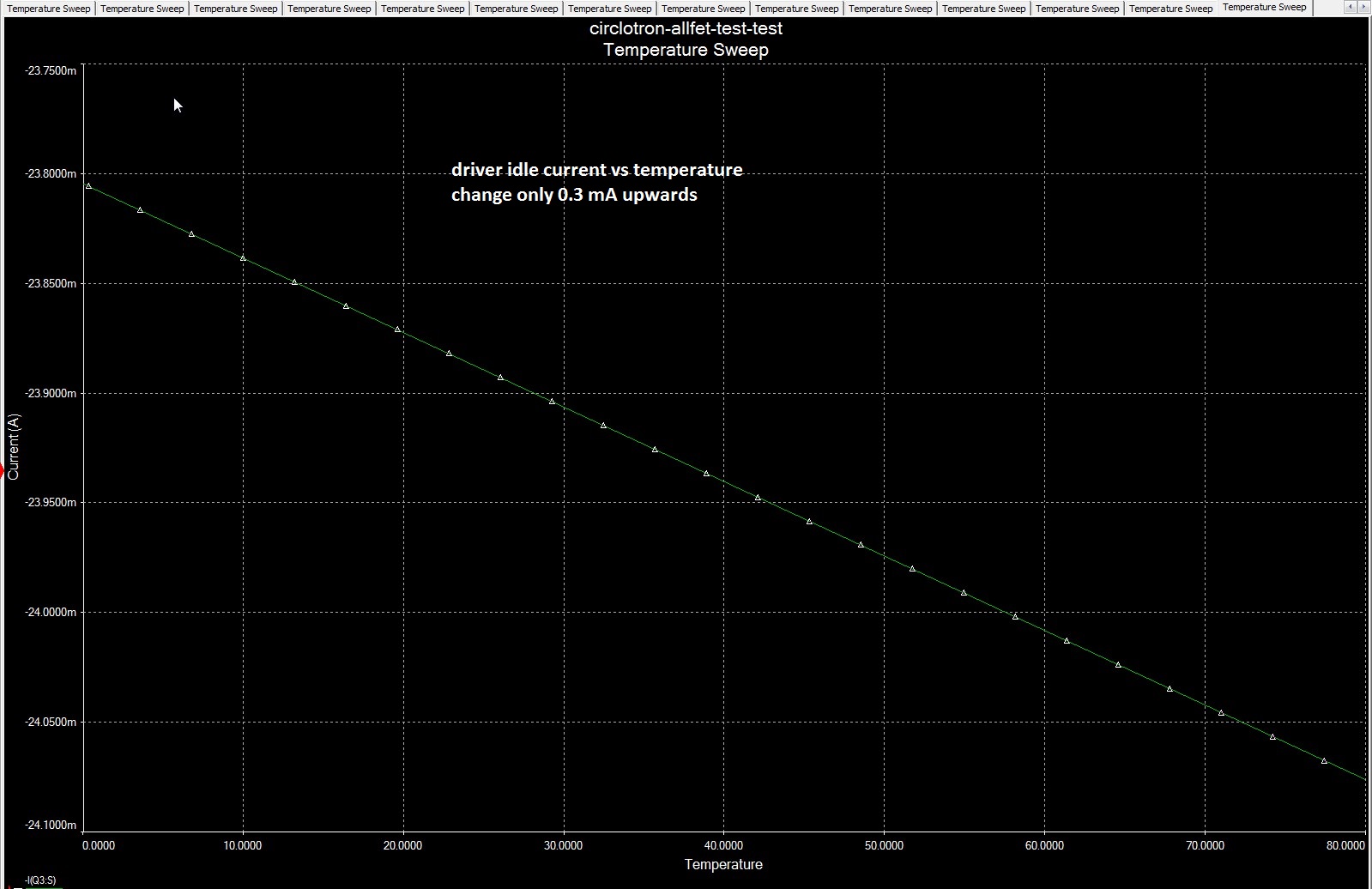

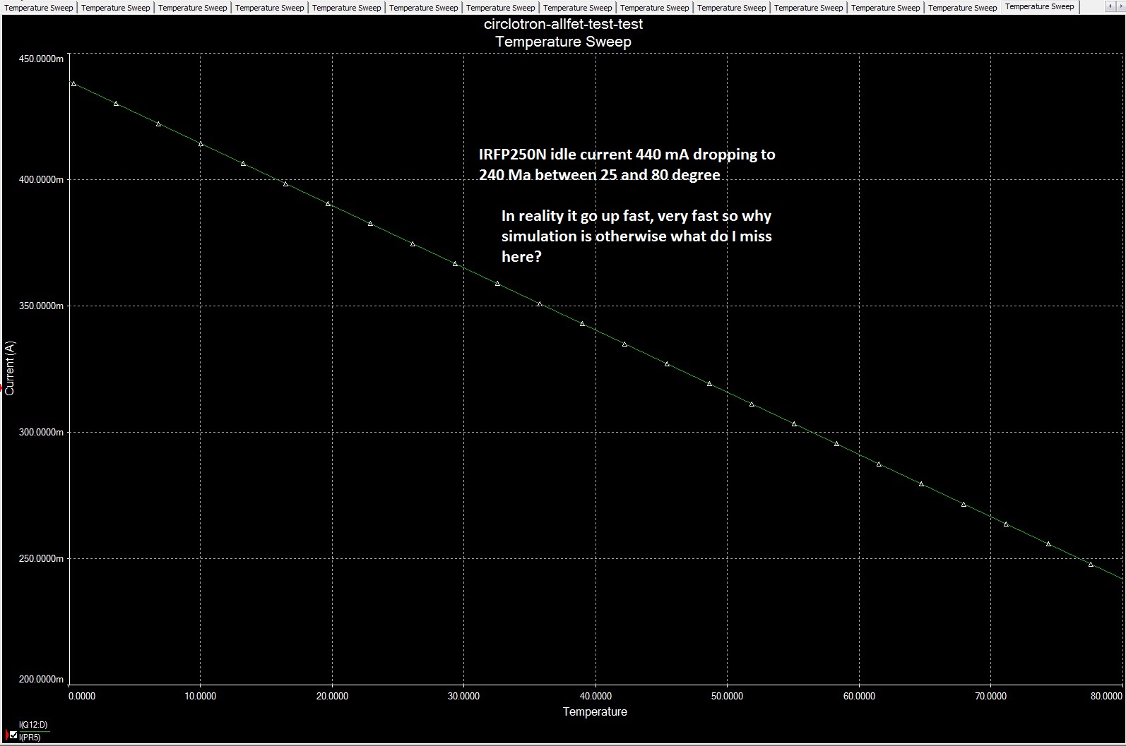

and when only sim the output simulation says it has negative bias respons like a 2sk1058 this do mean I have a wrong model there?. the IRFP250 when get warm lower the idle current, that is fault.

The models don't include finite heat transfer rates. Which in reality are finite and can cause localized overheat on the die core like you suggest.

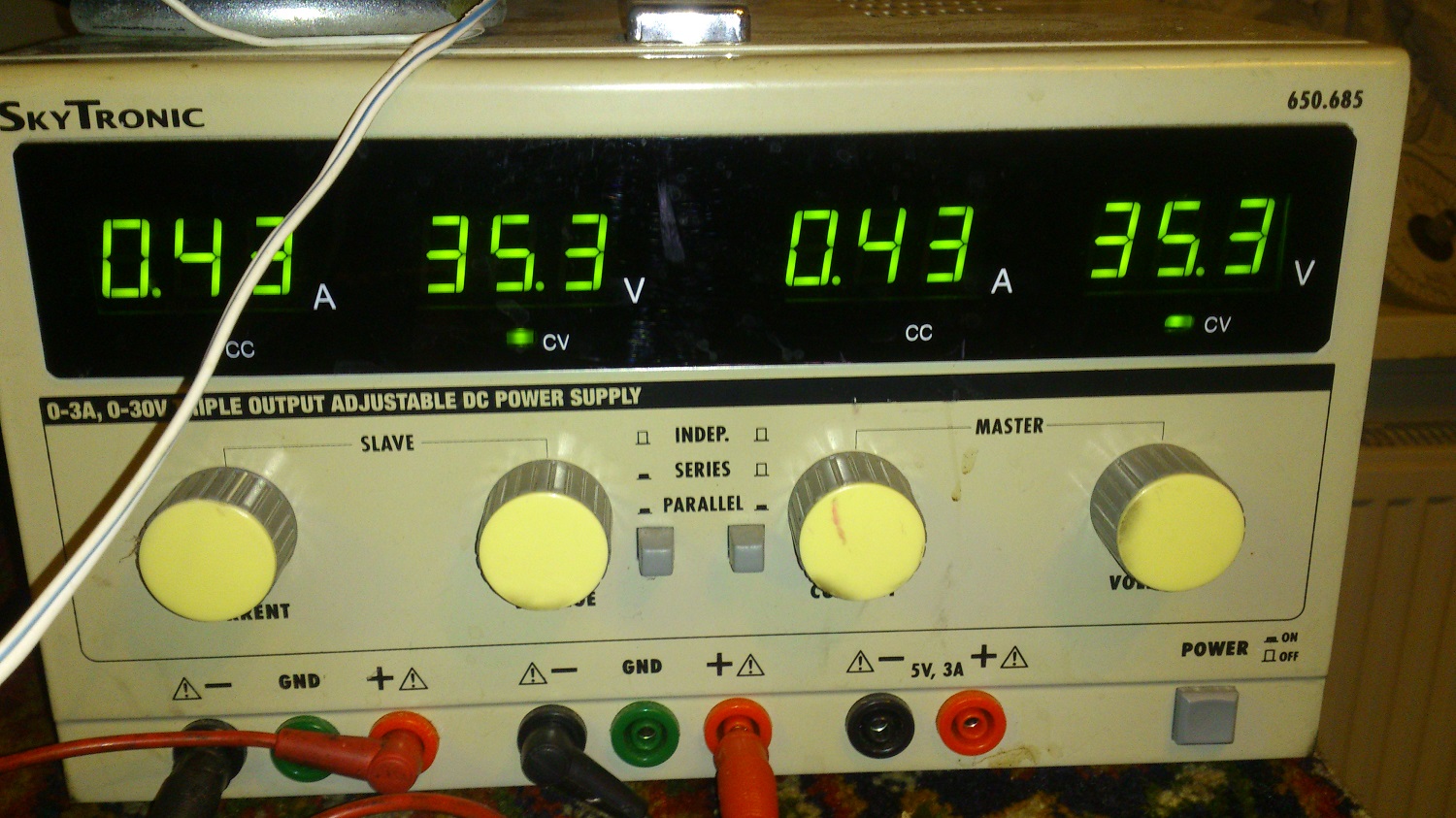

For me with a transistor it stays on 420 milliamps now, but only with a ventilator it get stable, however when reach 800 mA it go run as hell, when I remove the fan it dorps
to 120 mA again, when cool it it go up again..
I do not understand why, because it meanly the power mosfet who does this, it runs harder then the temeprature do rise and that is very strange because means that the silicon has temperature resistance?, we go try tomorrow the laterals, and the 240 because I have now 250n types. maybe because the mosfets has very low on resistance can play with it.

It is now stable on 470 mA, as I see it is way overcompensated and the reaction of temp sensor way so slow, IRFP250N silicon get already hot before survace do giving a runout.
