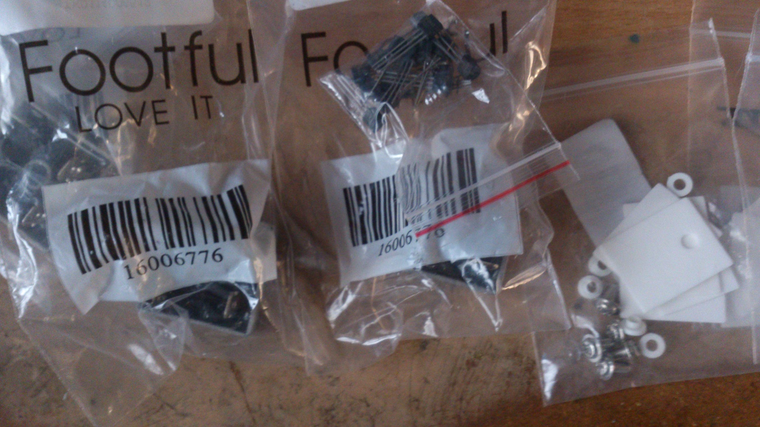

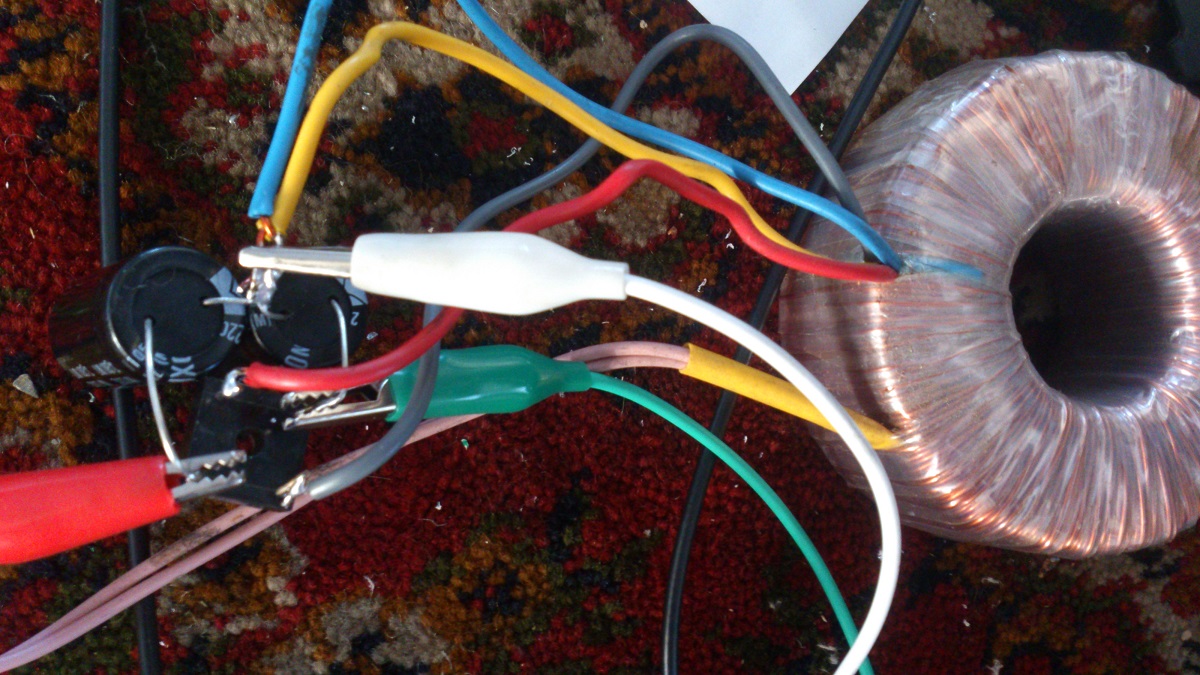

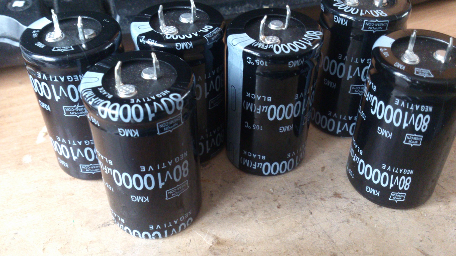

Have received the J310 mosfets, rectifiers (15amps) ceramic insolation pads for irfp450n, things coming in slowly.
I go use two for testing on a board to get the right current from the jfets before installing on the board itselfs.
regards
The J310 are fakes, have mail that to ebay, I have get on local store some J310,s and these are oke, get now 4,7mA with 180 ohm, but need some more otherwise the output transistors get not in on state.
If I look to the J310 she are the same like these from the store.
With the chinese J310 I get 20 Microamps, in stead of Milliamps. She are in plastic pack, so maybe damaged also.

I have nog the amp adjusted with the Jfets on place, put them on 10 mA for 5 mA x 2 for the diff amp. There is pretty much differences in the sim or real time, most of the time the model is cause, like mosfet on voltages are different in real time.

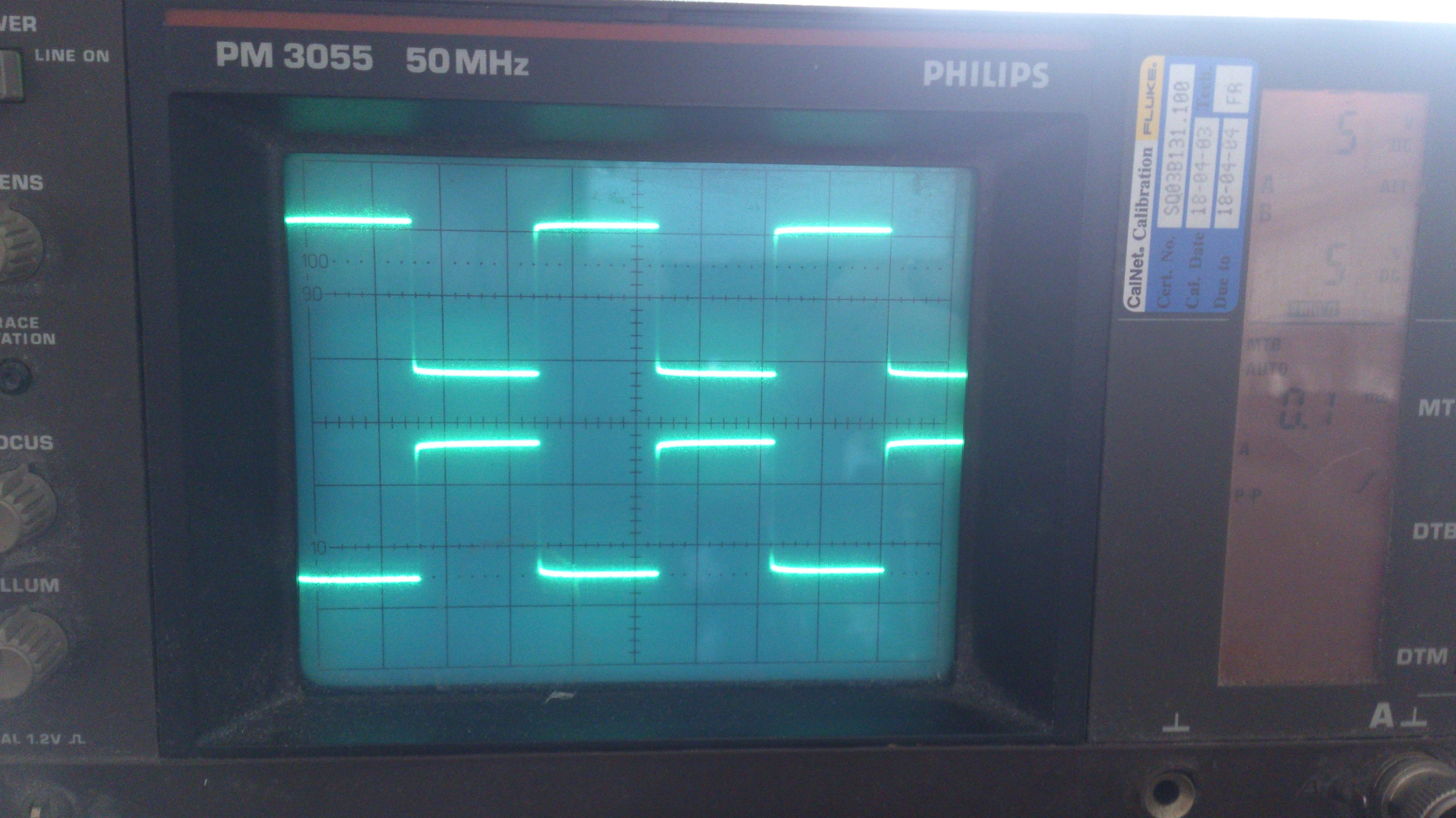

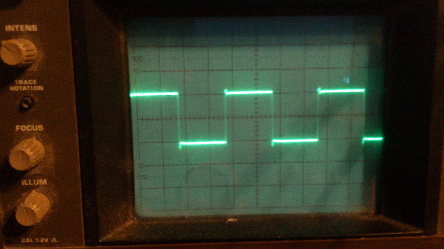

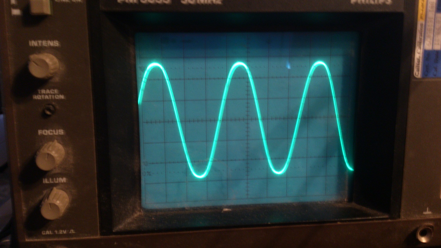

Have my supply adjusted so 2 x 35 volts are present, and I have test not the 10 Khz square, I need to repair the generator who go with sinus and square to 20 Khz. These square is from the cascoded differencial driver who go to the circlotron, it fase shift nicely and voltage is same as on simulation.
For the current feedback line we need for shure keeping lower then 10 mA in loop with full power otherwise the J-fet gets some sweat on his forehead.

Hi Kees,
Great progress as usual. Those are very nice clean squarewaves. When you get a chance, can you please post an updated "stuffing" guide showing what component values are now changed and where they go? Also, an updated schematic would be good as well as a picture showing new wiring jumpers to fix the PCB errors.

Hi X
The police here do nothing about RF abuse, we have PTT Telekom for that, but these people say when I ask that I get sick of that if everything is oke with me and hang up, while hospital allergy specialist say that I have electrostress symtoms, yes crazy country here.
For the pcb, just wait until I get things done, because it changes, as for current feedback met serbian friend is right, it has to be adjusted because it will modulate the CCS when the feedback loop eats to much milliamps, yes X it are just milliamps haha, I try to keep feedback around 5 mA max, and so the CCS needs to supply 15 mA.

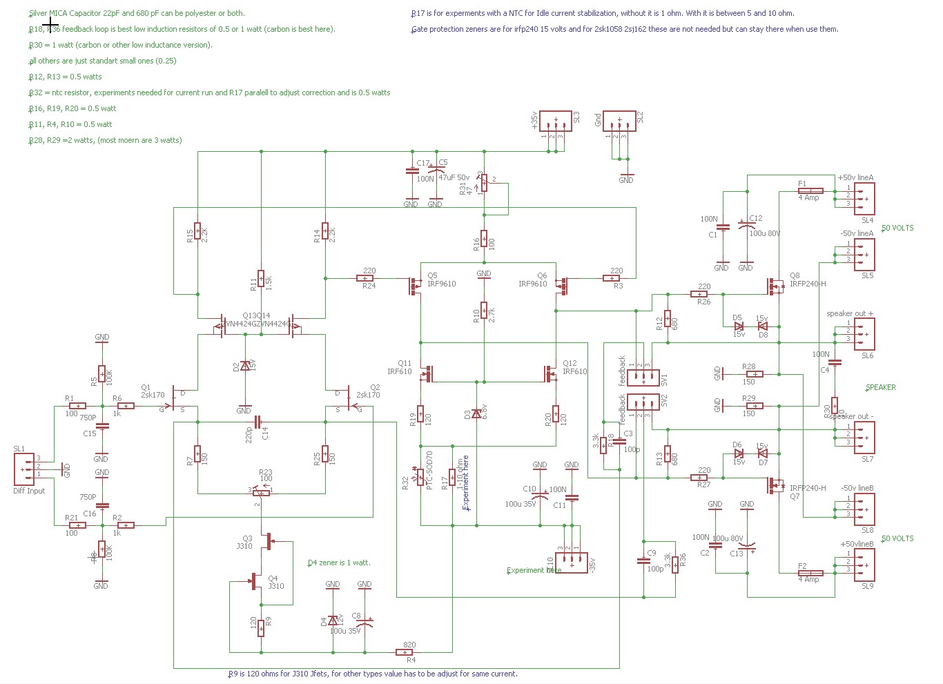

I have adjust the schematic as i use it now, the parts are adjusted and the CCS has a j310 for the PN4391 we need possible some other resistor, but when it just small different we have to do nothing.
X when build it this way it do work, I now go over to the last part, the power output, so when you see a picture 2 then I did fail.

Yes try a resistor, I did use 1.5k 1 watt. I go change the board, then you can change it also with some wires so feedback is oke.

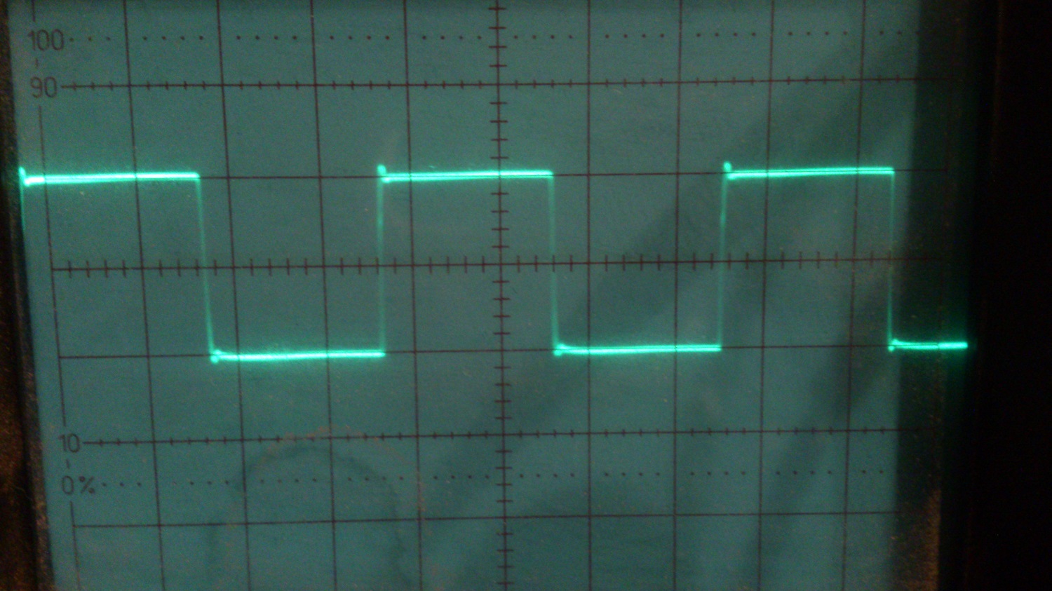

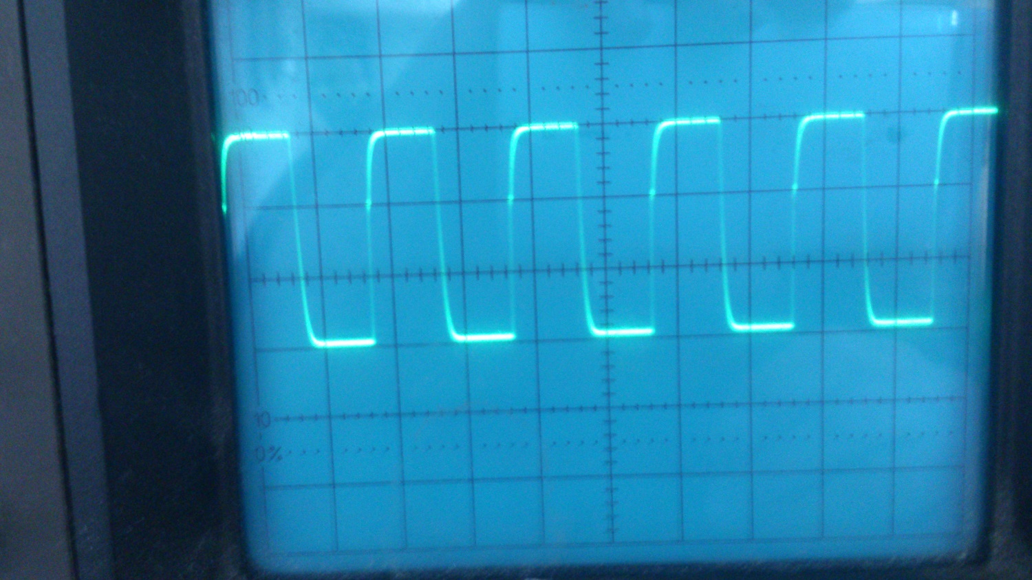

The amp has slewing, meaning that when put a 20 Khz square in risetime do slew, this is because the irf 610 is a amplying elelment so input capacity get,s involved, what is 140 pF.
I go look if it can faster by change the input amp on some way or even make a extra cascode on top of the irf 610.

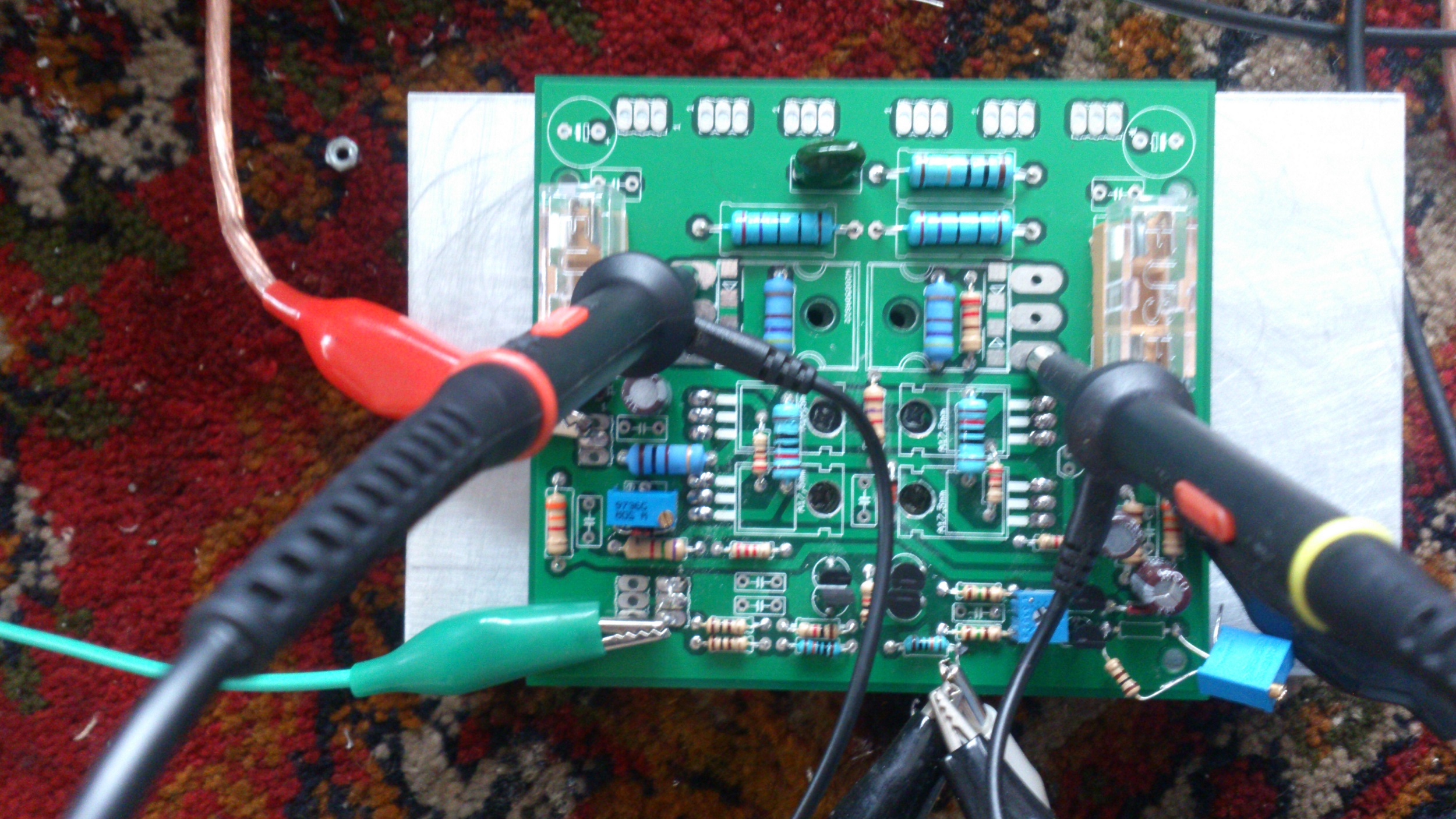

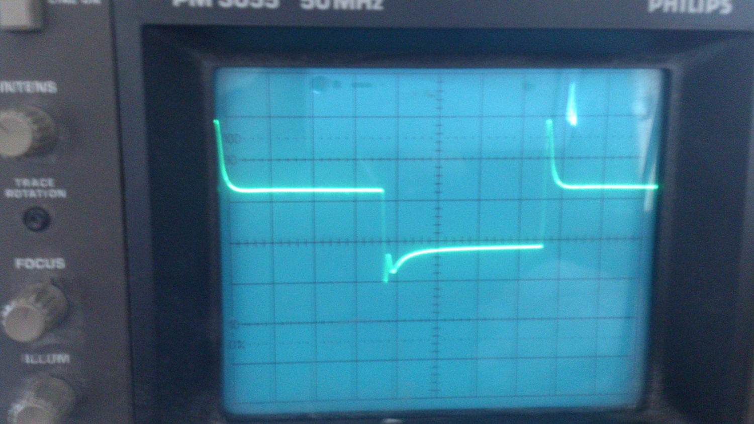

After some testing and measuring I get a nasty peak on the 2.2k R15 and R14 resistors (picture one) Or it is because of the scope probes or it is a issieu with the mosfet capacitances or the fact I do feed unbalanced with one input on ground, I do not now quite well why this happens, maybe also a impedance mismatch or whatso ever, the signal on the output drivers is oke again, so maybe probes do act bad on the resistors.
The square on 20 Khz is in a irfp250n mosfet who is not on supply, so driver see the full capacitance (2.1 nF) of it and it is a little visible in driver output who is not bad..
Recognise somebody this, any tips.

Hi X

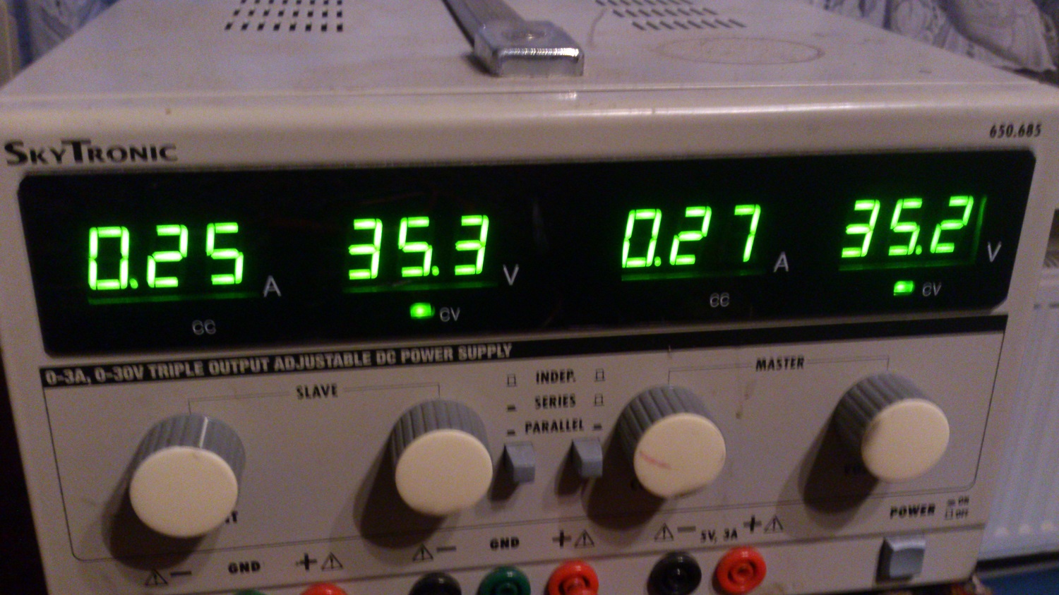

I have succesfully complete the amp, the thermal runaway is present, but I have ceramic insolation plates who do not work well, the mosfet irfp250 who has these get very hot very quickly, this is not oke, so I have to complain to the makers why this is, we need as little as possible thermal resistance, and this is huge.
I can adjust everything fine, it can now on a speaker if I want.
For the square, this is 20 Khz, and have some overshoots who however is not from the amp but from the frequenty generator, as i see now it is very fast.
The runaway however is present, maybe the ceramic plate is the cause but is seems more that it is because of the vertical mosfet, above 500 mA it go accelerate and supply do turn of automatically.
Adjusting the generator so it has little overshoot amp behave a lot better, it is so fast it let through that overshoot coming from the generator.
I have just one pot for adjust idle current for both mosfets, as you see there is a slightly different 250 mA versus 270 mA this is because of the mosfets are not machted, this is not
a problem whatso ever because it is just small.

Kees,
Congratulations. :cheers:
That is some wicked fast slew rate as evidenced by the vertical cliff on the square waves. Looks really good. The thermal runaway will probably be solved with a negative temp coefficient active somewhere in circuit - I guess the IRF610/9610's do not provide that functionality then? I wonder if a simple silicon diode in series with whatever is controlling the bias if placed in thermal contact with MOSFETs could work. You also have provision for the thermistor which at present is bypassed with 10R on my board. Maybe two or more 1N400x's in series here can do the trick?
