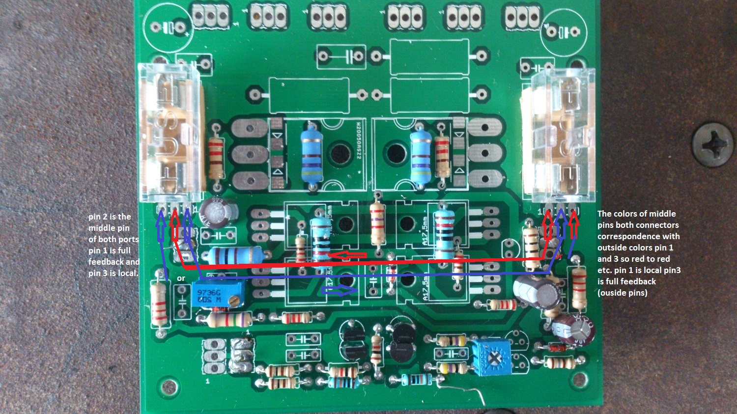

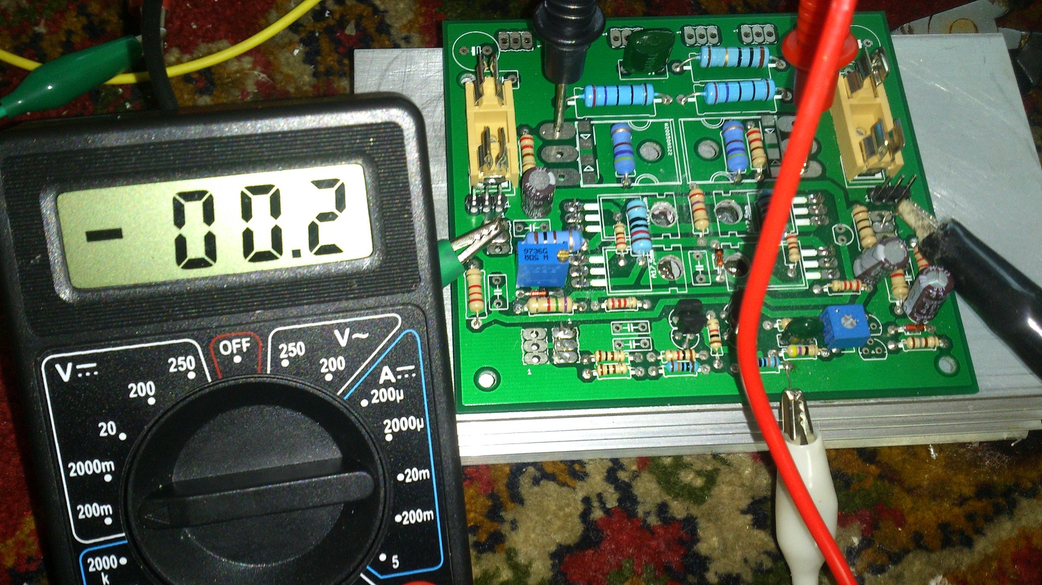

I have find out why you had half the voltage on the output, I have the same, and so I did going sim only the driver section and it seems that I have done wrong the feedback loops, need to be reversed because it has to be in opposite fase, now it is in fase making a dc amp, so the board do contain a fault.
you need feedback left to the right, so simpel a jumper do not work, except when make a new board, as you see how easy it is to oversee faults both did not see it, people here also not see it because in schema you see that it is fase fault connected.
regards

Did change the feedback to the proper fase, and yes now it works, I get the offset as low as 12 millivolts, it do run, but it runst between the adjusted value so it wlks up and down 12 millivolts, I see it cancels out automatically as mentioned.
Everything you change has effect, because of dc coupling devices, I see a current of 5 mA (tot 10 mA) for the input diff amps, do give the proper ilde adjustment reach for the power mosfets, th CCS stays, really needed for immunity of supply rippel voltages.

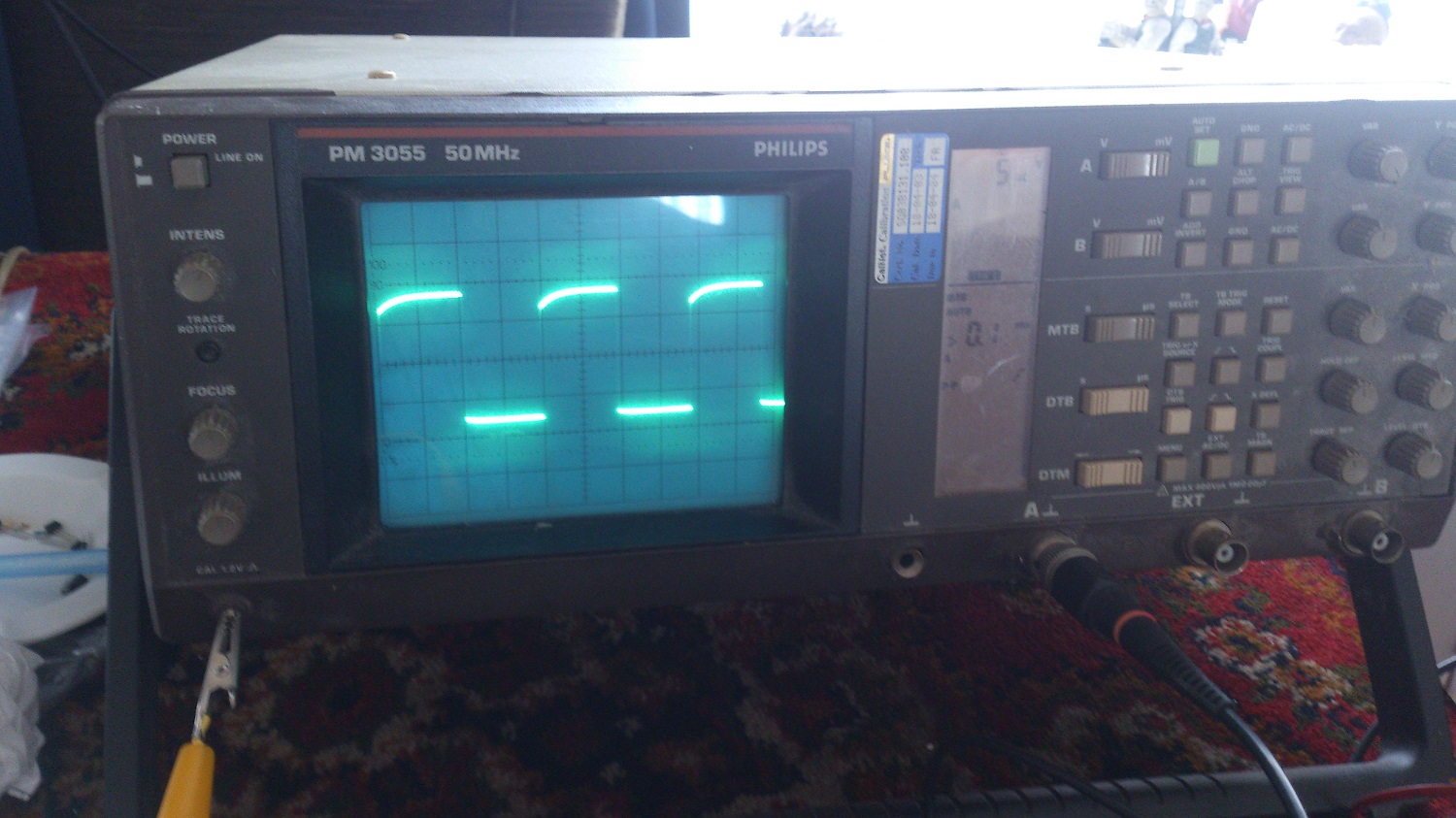

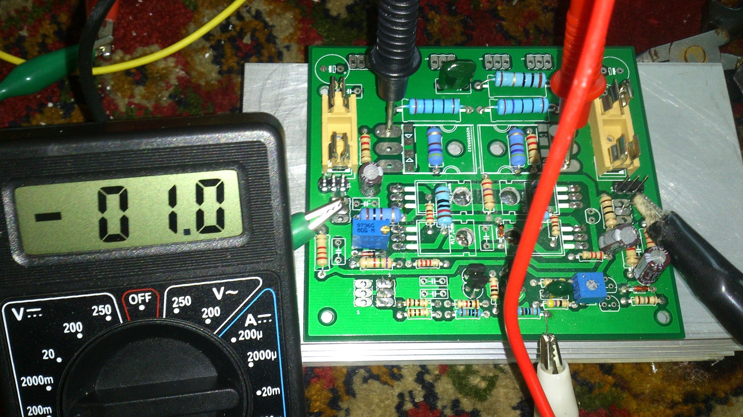

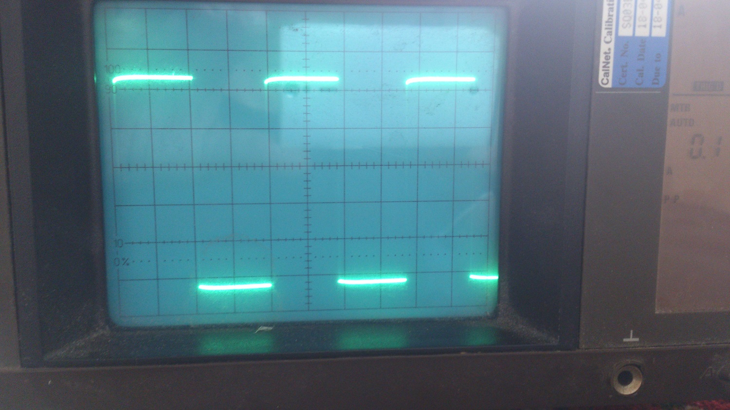

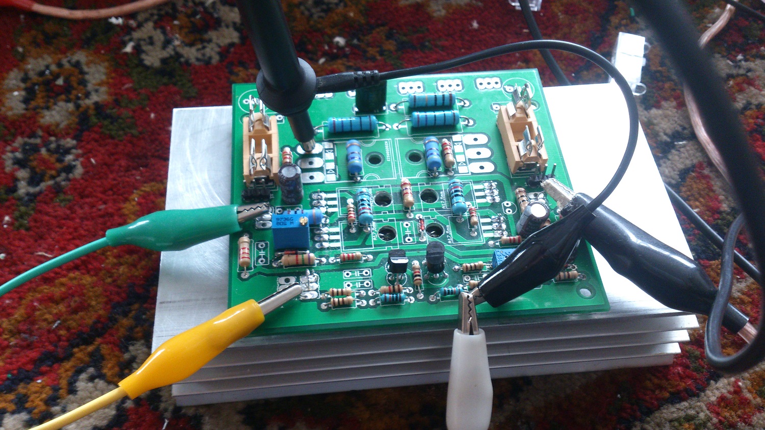

I have now a offset of 1/2.5 mv walking between this after 30 minutes of working, I have put a square wave in it, do also well. See pictures.
The feedback setting can indeed also be done with a connector, however, left go to right and vica versa. Have in eagle not corrected the board, as you see, small mistakes are easy made, but we are umans afcouse, the most strange animal on earth.
You have to couple the mosfets Q13 and Q14 plus Q1 and Q2 to each other, because I test with vinger, and then it go running with offset, nicely the zvn go opposite of 2sk170, so that is a very nice way to stabilize.

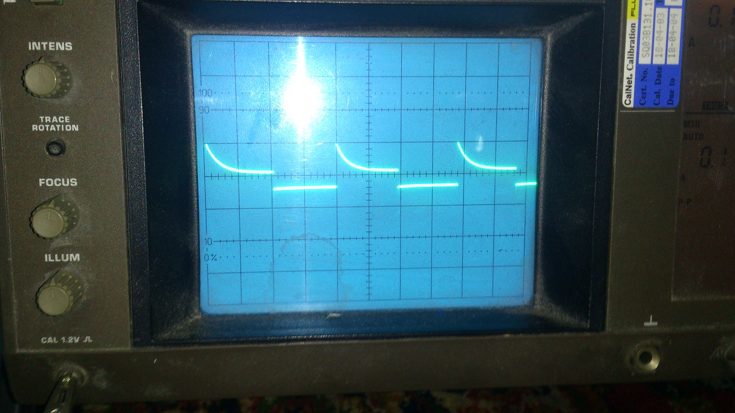

Square wave is 2 Khz from scope, giving 15 volts, this means 30 volts total with 1.2 V input, and this is as simulating did offer.

After some time now, the heatsink is nice warm from the driver transistors and the offset stays between plus and minus 10mV, tighten the transistors so she feel each other make things even more stable.
nice, we get somewhere, ooo yes the square in post 404 has on top some bend, this is because there is no ccs, and so earthed Q2 do have cause it.
See on scope when not use a ccs, the other grounded mosfet then do faseshift with low voltage and low impedance for unbalanced working giviing this strange square.. Other side is perfect and much higher voltage, ruining feedback.
Can you show a schematic diagram with new feedback connections (actually red lines to current would be helpful. Where to where connect?)
Do you mean thermally couple the ZVNs and SK170's?
The way you did couple them was oke with yellow scrink sockets.
X the colors on the pcb you need top follow so red to red and other color the same.

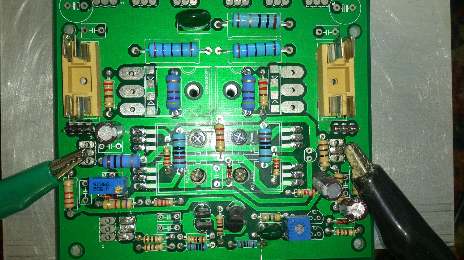

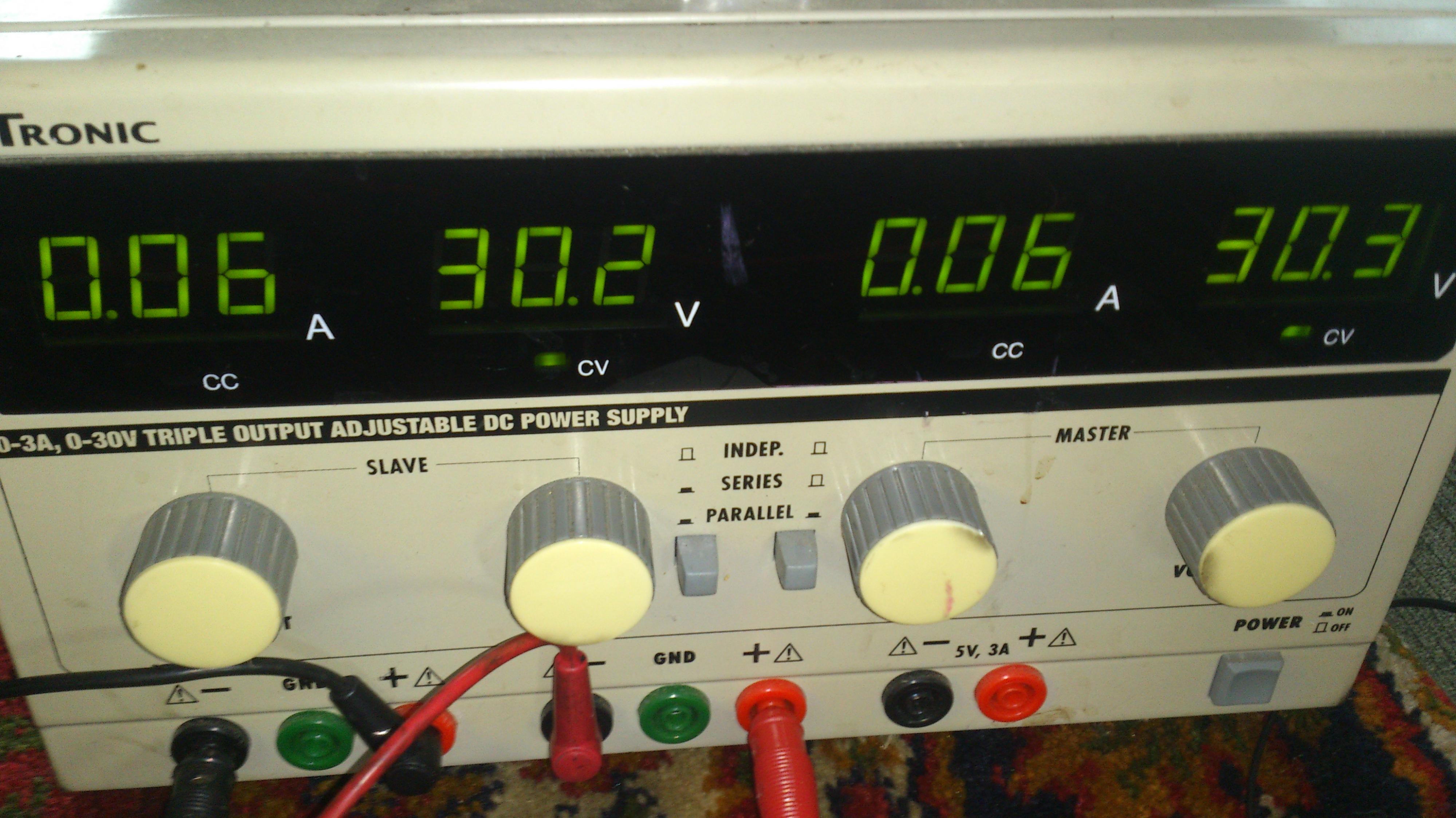

Have change R7 and R25 back to 100 ohms, maybe need even some higher to get good respons, change from 47 to 100 ohms did make sqaure a lot better (10Khz), has possible to do with resistor in stead of ccs, later when received them I test again, 100 ohms looks the best, also in sim, less modulation of the CCS under it.
And have not yet blow things, except two capacitors, one was landed in my nose because I did reverse the supply by mistake, no transistors damaged or broken
but maybe this because I have limit supply to 150 milliamps..
Voltage on scoop is 11 volts this means x 2 it is 22 volts output with 30 volt supply driver idel current total 60 mA is 30 mA each half of driver section.
I have measure these signals on gate input of both irfp250N mosfets, so menas when I put them in I have sound.

Great progress Kees. You are close to first sound. What supply voltage will you be using for output stage?
I have upstears a transformer with I think 2 x 35 volts, but driver stage need also higher voltages if you want use high voltages on circlotron itselfs voltages, I do still wait for parts, like rectifiers and capacitors 10.000 uf.
30 volts I do use now for driver, U can use also this voltage if you have that and 25 volts on circlotron, then the circlotron will clipp before driver stage does, and this is nice.
As you see on scope post 409 it is quite fast, and no overshoots, I dod not yet using capacitors in it, so completely capacitorless except supply lines.
regards
Yes, that squarewave looks exceptionally clean. Will adding caps make it more rounded? Why have you left laps off to now?

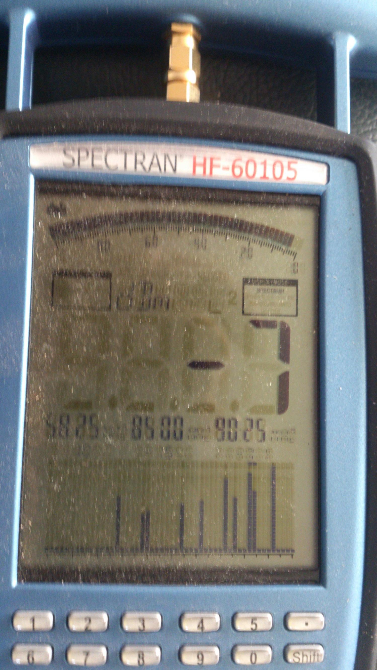

I have last week trouble sleeping and so I did measure again the big wifi mast above my head, has quite stroung signals, vakanty is over so it is active again and I feel that right away in the form of burning sensations and neelde feeling on skin, ear noise very loud.

What does -7dBm reading mean? What are safe levels of RF? Is it the 2.4GHz frequency for WiFi? 2.4GHz is close to the water microwave bands for a reason - no one wants to use that for long haul comm because water can absorb it. If frequency is off or it tunes or autoscans, the inadvertent leakage onto absorption bands can be bad as that can be felt as warm tingling sensations of being in a microwave oven.
-7 is 200 mWs sometimes it jumps to +3 dBM and that is 1.5 watts or around. it is the 5.8 gigahertz band I measure, I did measuring from 4 gig to 9.5 gig

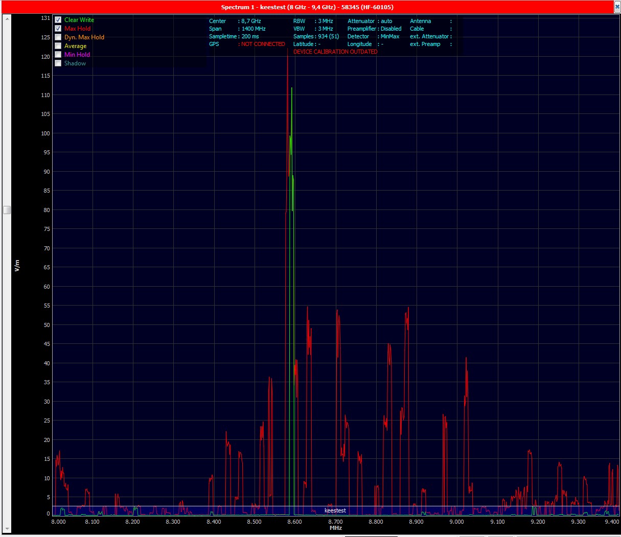

This is the magnetron when on with door close, on 4 meter distance, going to 92 Volts per meter and that is 22.9 watts on 8.6 gigahertz, this is quite high and a harmonic of the mircowave or even a radar transmitter pointed on me do not look healthy, possible nabure did open door block switch and turn microwave with opening to wall, and on the other side is my kitchen who is also nabure kitchen, these people need to be put away. Nabure woman has already a brain bloodclot in head, and very lucky, but this can happen when do such things, and she are young people. However the big transmitter signals are now dissapairs for 7 months now, but there is still enough radiation to disturb my sleep..
