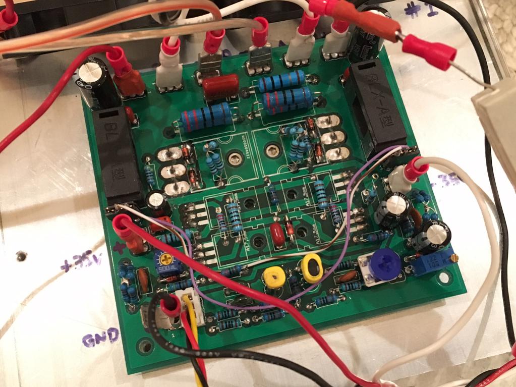

I went in stages as you suggested. Using resistor as current source. I tested the output and saw that I could adjust first get 5mA in each leg of the LTP. Then I installed the drivers and saw that I could adjust the amplitude (bias) and offset on the outputs of the IRF610/9610 via the trimpots from nice range. The I added the IRFP240's and proceeded to operate with 10R safety resistors. Bias current adjustable from zero to huge several amps, and offset was tricky (single turn pot) but stable within 10mV. I set bias for solid pure class A region of 1.3amps similar to Pass amps. Connected the speaker, DAC on input and it's now singing.
I liked what I heard and proceeded to remove the safety resistors and upon power up, the 3A fuses blew. Thinking it was inrush transient I changed to 6A fuses and it still blew. At which point I replaced safety resistors and see that circuit is sorted as it was drawing 20V across the 10R. I probed the IRFP240's and they are blown - reading of 10R to 0R - shorted. These are the first IRFP240's I have ever killed. It's got to be thermal runaway.
I replaced the MOSFETs and am running with safety resistors as current limiters. Playing music at least. I guess we need to find a way to put a current limiter - maybe the Pass opto-coupler and resistor network for current sensing? I don't think thermal feedback will work, it needs to sense the current and limit that because the thermal runaway happened in maybe 2 seconds before the fuse blew.

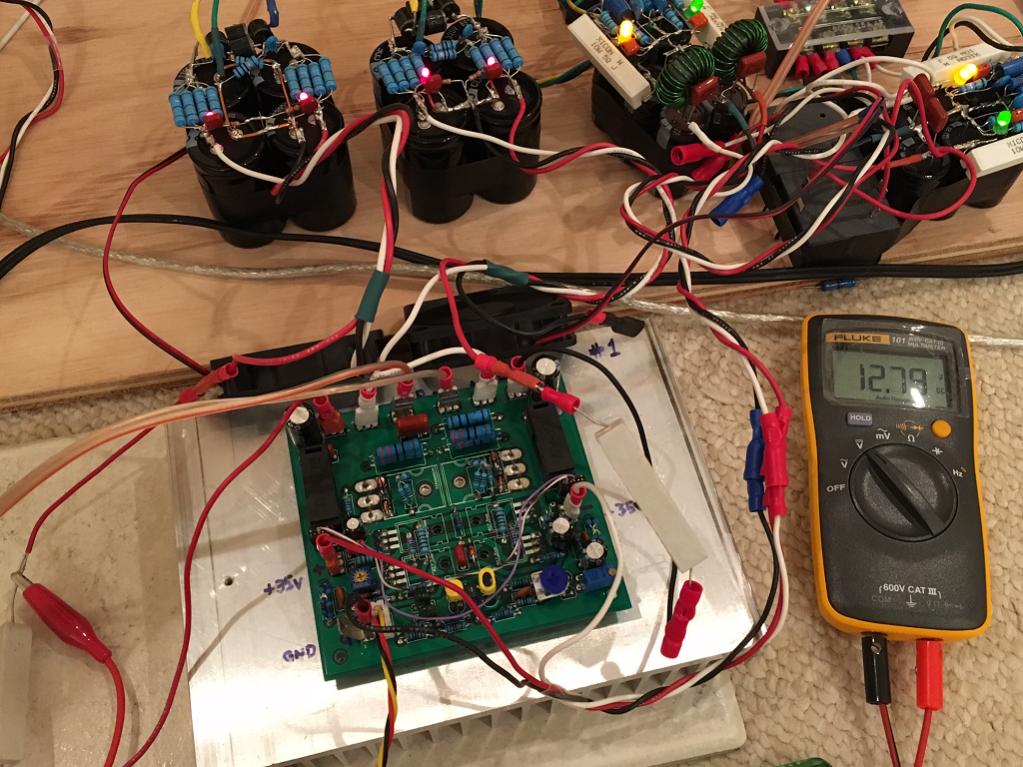

Here is the setup showing 1.3 amps across the 10R resistor:
Closeup:

Nice to see your creation up and running.
Under what load conditions did you test the amp?
I did test the amp with 4.7 ohm resistor.
The square overshoots you see it from the generator, this has a little amp who does that. It is very fast if the amp let it through unharmed doe you think not.
I have no caps in the amp for stability, it is just stable, no oscillations whatso ever, even with input open it do not give trouble.
I go test with the diodes, I did see I need when warming up have to use lower resistance, if you make the 10 ohm smaller the idle current drops, therefore a NTC cab be used, on top of driver things are reversed, when smaller resistance the idle current get higher, so need the PTC, this for clearance.
The bottom is so a nice place however does a diode get lower when warmed? if not it can not be used.
regards
That is sad, you did blew the mosfets, yes thermal runaway is very bad, special because you did put it on 3 amps, do you have good thermal kontact heatsink with mosfets?

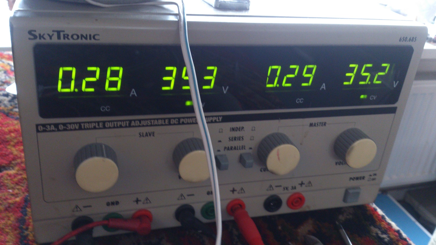

I have a supply who can be limited I have put it on 0.5 amps so it can never blow.
It is not bad the sim ehh, so close it was.

The MOSFETs are not expensive so not a big deal. More of a pain to replace them that's all. I have feedback connected with red and blue wire like the diagram you posted earlier. I don't know if that is called full feedback?

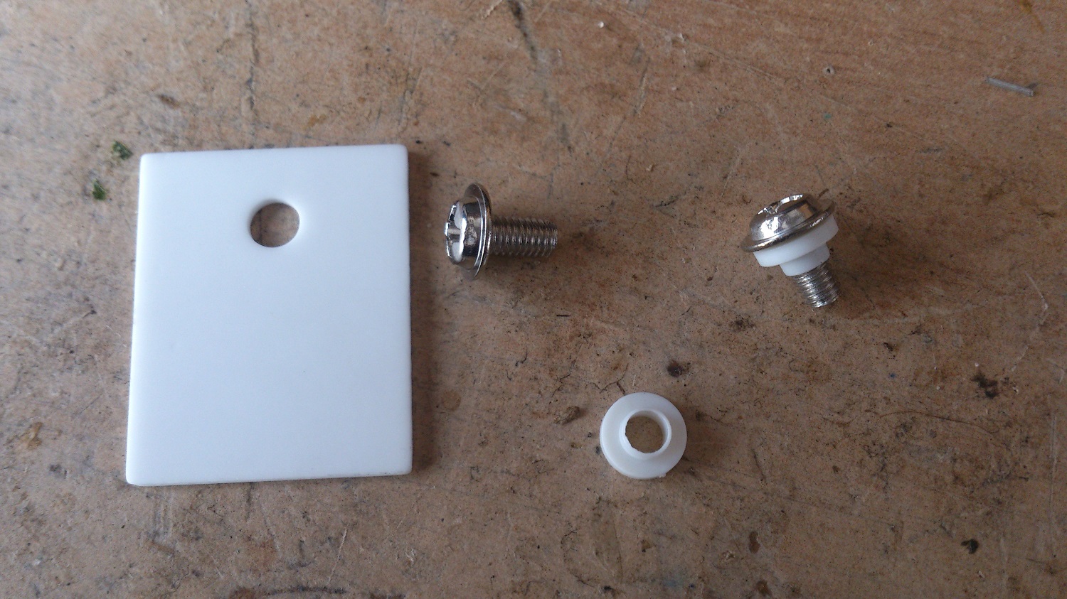

I have some bags of ceramic spacing pads from china, these are 1 mm thick and full ceramic, do work oke and are less prone to chorts. And she cool a lot better then silicone because I test them on my hybride amp and on one channel with silicone the mosfet is much hotter then with ceramic pads, here I can put vinger on and is little hot,, and the other is to hot to put vinger on longer then 3 seconds. heat is cutt in half between them, good result.

That is no surprise. You don't have any compensation. I have build a circlotron a few years ago and I use a current source for compensation:
http://www.diyaudio.com/forums/soli...-circlotron-power-mosfets-11.html#post3070645
Q10 is mounted at the heatsink. D3 is necessary against overcompensation, so there is air to play.
D3 is not the sensor, Q10 is it. The LED is only voltage reference like zenerdiode. It restricts the effect of Q10.

I have been using silicone pads all this time and seems to work well as the softness allows it to fill in small gaps and imperfections in metal interface for best thermal contact - like thermal grease without the mess.
I just saw this great deal. Never need to buy these pads ever again.
https://www.amazon.com/gp/aw/d/B01B4VC7ZO/

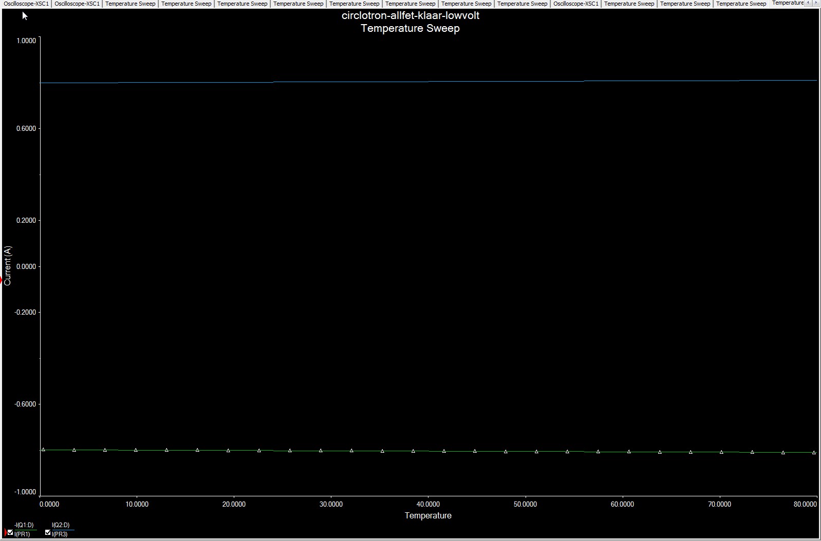

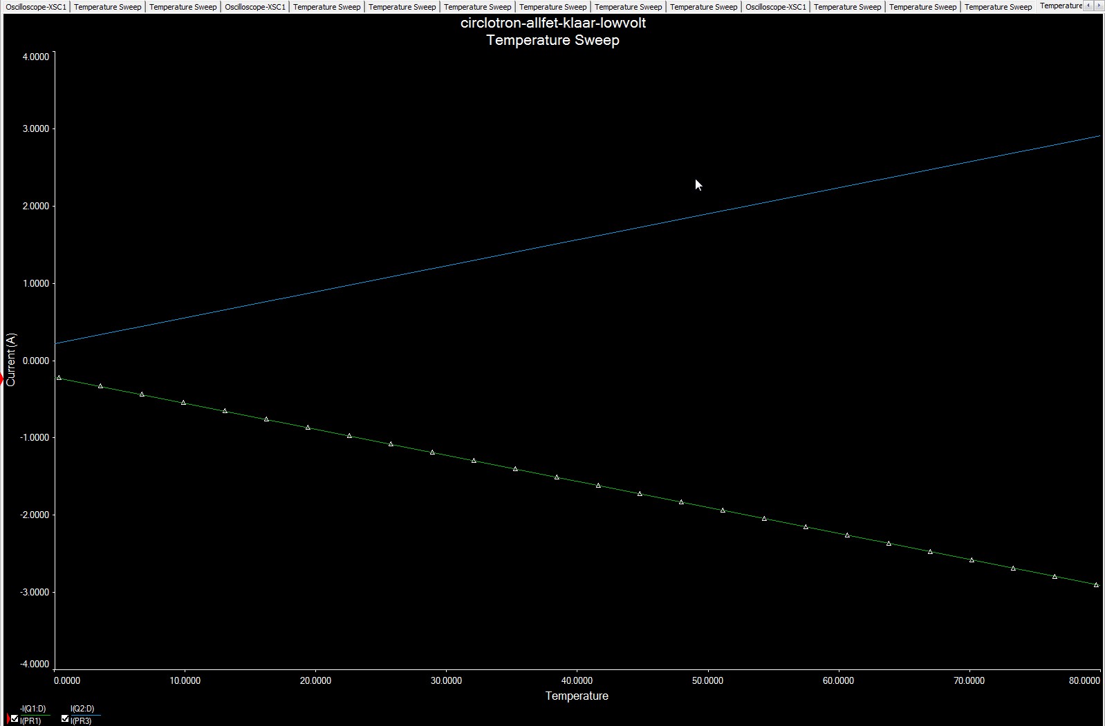

My idea was a NTC resistor with a parallell resistor for compensation, I have now try a darlington in diode mode and this overcompensate (not at sim
Using a fet as a sensor I can also try.
Last photo is without compensation and as you see a runaway, the other is with a darlington transistor who seems to sim oke, but it is not in real, Vbe multiplyer is just trial and error.

You can put it in class a if you want, is your choise, your free to do that, I try to get it right for both, but in class A the sensor needs very close to irfp mosfets because of sensing quickly otherwise it is defective before the heatsink is warmed up.
I have tryed the darlington, it overcompensates, I had already put it in diode mode because the bottom side of the driver do regulate quite oke.
The pass amp is not a circlotron, so this do not work, and need a other way to do it like double version, and it is in signal path, as a bipolair, we need other way.
It will be oke soon, I work on it, I did now the idle runout is a problem, however laterals in it will cure it also.
For the sound in class AB we need 350 milliamps, minimum because these mosfets are quite non liniair, that is why she are used in class a to cope with that,
I think I go use 500 milliamps, a good compromise.

A thermistor or NTC can be used, maybe even better then a transistor, we need a negative action thermistor so it has to be a NTC, in paralell with a extra resistor to adjust the compensation.
I have now use a BD380 in diode mode, and it overcompensates, when I however put the current to 700 mA it runs like hell to destruction when it was on a normal supply, mine is limited, do I put it to 500 mA it do be stable and steps back to lower current, lower, and lower, not stable.
So or I have mosfets who are not oke, running from 600 mA to destruction happens in just 10 a 15 seconds, lower then 600 mA and it steps back, strange behavior, bu I have not the transistor in the mosfet house, and I think this HAS to be done and is the cause.
putting things in serie with the transistor like a led do not work because there is to much current, but maybe a resistor in paralell with the transistor do work or a low value one in series.

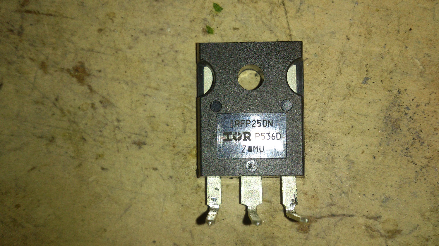

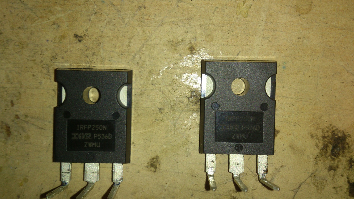

As on photo the irfp250N looks genuin.

Those are definitely genuine IRFP's. The high quality epoxy on the body and exquisite satin finished pins (and probably back tab) are good indicators.

I think the NTC need to be 50 ohms and a 10 ohm parallel, but a pot for the parallel resistor is a nice way to get in tune for the system, say 100 ohms.
Now I go test a mosfet in the lower section and see what it does.
I get stable now but when cold it has dan big idle current and a runout in some seconds but I have the sensor not on the irfp housing but some cm,s away, and I think this is very faulty. we have nice pcb but the under the pcb ppresent ifp have not much room above, maybe we need to do in future keep the power mosfets on side of board.

The runaway I have studied now, I thought the driver will be the cause but hee when I set idle on 600 mA it runs to amps in just some seconds
When I set the idle on 500 mA the opposide happens, it runs back to very low levels while the gate voltage stays with 200 mV or so, somebody an idea here? because I do find this a very strange behavior.
I can remove them and test the irp240 ones.
Have some time this problem with other amp with bjt and this has also runout thermally but that are going very slow, X how much time it did spend before your fets did blow? I gess not is some seconds as you have listen to it on 1.4 amp idle, if I put that on mine, I have just 2 seconds or less
