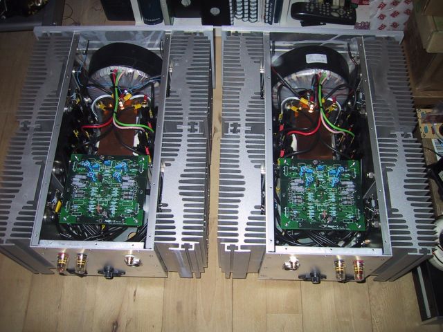

Ahhh.....where are those resistors??? what is going on??
R46 and R47 on HifiZens schematic and board rev 1.where are those resistors???
Steen🙂
4,7K is the proposed value from the start, but later it was suggested that a lower value might be better so I guess you are on track.I've got 2.95 K in there.
How is your AX's doing? Mine takes forever to finish, it has been a huge work on these amps for me but now I think I can safely say
that the A-X's are finally getting close to the finish🙂 All I need to do now is make the connections to the boards and adjust🙂 Hope it goes smoothly🙂 Well have a peek at the monoblocks. They are small powerplants😎
Steen🙂
😎 Powerplants indeed! Very nice work Steen, hope it stays that way when you fire up the converters 😎
Thanks Mads. I better get my hands on a Variac for firing them up. That would be the clever thing to do. But I will probably just do as usual: Turn it on and see what happens😀
Steen🙂

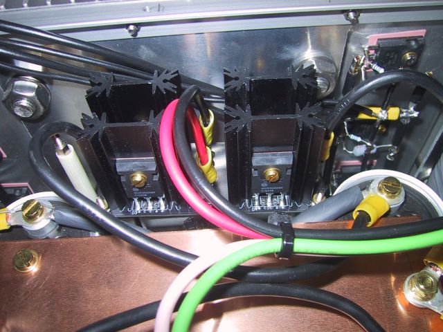

Hi Steen,
Yes, definitely get a variac for turn on. My first Aleph-X monoblock had the main rectifier diodes wired backwards. I had even checked all the wiring three times before initial turn on. I always first turn the variac on very very slowly with a multimeter on the first PS filter cap and never let the voltage get above a few tenths of a volt. This time it paid off. I remember not believing what I was seeing and checking the meter leads and all kinds of other things before forcing myself to go back to square one and start rechecking from the very beginning.
Use a variac.
Regarding the MacMillan resistors, 4.7K was the nominal vaue established in the Aleph-X thread. Several builders preferred 2K and 1K values but I don't recall anyone doing more than a cursory listening test. At the time NP said something like you could go as low 5K without things "going to hell". That's not a very promising statement. I intend to do some listening tests on this resistor value over the next few months. I think the optimum value is going to be larger - like 10K+.
Graeme
Use a variac.
Graeme
Thanks for advice, Graeme🙂 Well, I crossed my fingers and tested the psu's allready. Both worked as they should. They put out +/- 24,8V, only loaded with a bleeder resistor of 2,7k. So I guess they will end up around the +/-22V that was the target under load. The psu is a CLC filter. I used Bigparsnips rectifierboards as on the pic. I just noticed that he actually has some left, see the marketplace.
Steen🙂
Steen🙂
