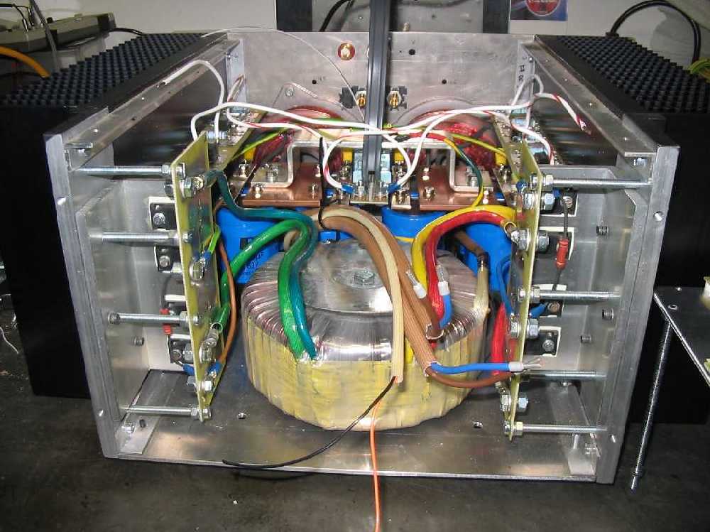

Hi Nixie,
Thank you for the idee's.
Option 1 is not easy to do for this moment. In fact you should use a potted transformer.
Option 2 is no option because i already build the amps. It's no point of discussion that a seperate (raw)power supply is better,
but practical ...
Option 3 is "easy" to do. I read the snubber article of Jim Hagerman with great interest and i will try it.
B.t.w. i use two full wave bridges with HFA25PB60(ultrafast soft recovery) rectifiers. Some guy's use a rc snubber of 100R+100N parallel.
Maybe that's a good start?

Nice and solid looking amp. You really paid much attention to the bridge. Where are the outputs? We need more pictures, for sure in the passdiy gallery. 🙂

Snubbers+pictures
Hi Hugo,
The pictures were already posted in a other thread. In fact this is a better place.
http://www.diyaudio.com/forums/showthread.php?s=&threadid=70074
The evox rifa caps shoud be excellent but this weekend i will try something from my "junk box". If there is any result i order rifa's.

Hi Gents,
Last saturday i tried snubber filters around the bridge rectifiers but it had NO influence on the small hum at the output of my ax's.
I'm afraid i must live with it.

joho, don't put the snubbers around the rectifiers. Read the actual link I posted on the previous page; an RC or RC+C snubber should be across the secondary. Also, it's best to use a scope to find the right part values, unless you know the actual values of transformer's parasitic reactances and can use the formulas to calculate them.
snubbering again
Hi Nixie,
I didn't interpret the positioning of the rc-snubber on this way.
I read the article again and i suppose with "secondary" you mean one rc or rc+c across the output of the bridge(between + and -)?
Johan.
Hi Nixie,
Johan.
No, it's an RC, or RC and a C across the secondary of the transformer, before the rectifiers.

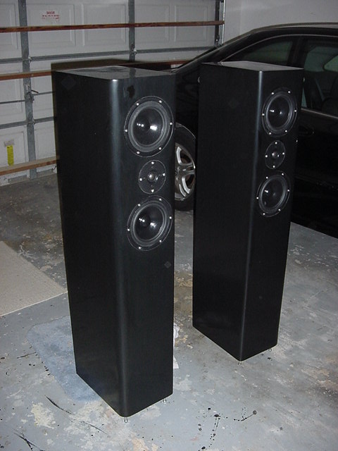

Haw haw, Well I started sliding after I finished these over christmas and they actually sound good ( see pic attached )
( these are the Eros MK 2's built from Speakerbuilder.net )
They sound so detailed that I know I am hearing my Amp now.

Very nice speakers, Luke. Good job🙂
Steen🙂
Edit, arent those 4 ohms? You better bias your A-X accordingly
