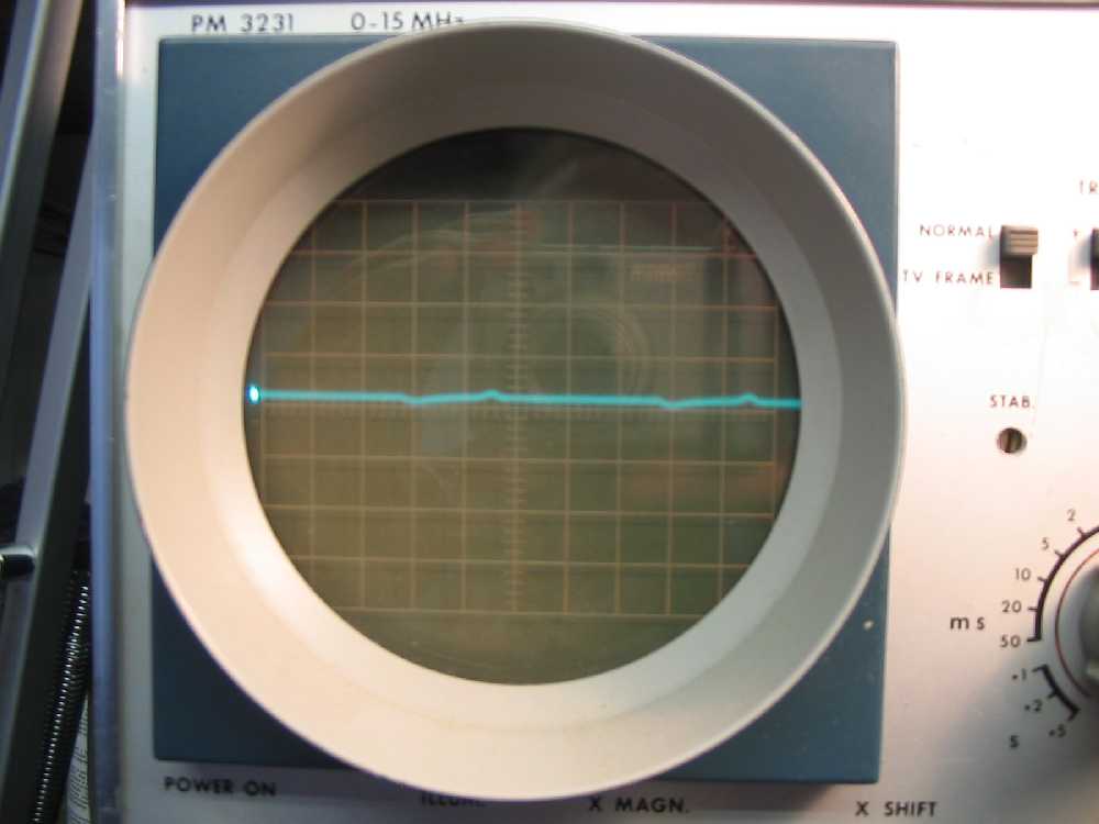

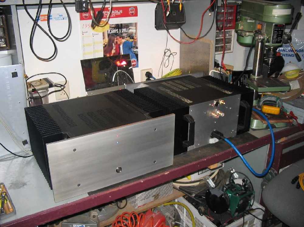

Output "hum" AlephX
Hi Gent's,
I'm one of the proud owners of a AX but when i put my ear in the bass speaker i hear some hum. It's not much and normally you don't hear it but i don't like it.
When i measure with a scope at the output i see a few millivolt 100 hz products(see picture; timebase 2ms/div and input 10mv/div).
When i measure the rail voltage i see 30mv tt ripple.
The ax's are monoblocks with CLC filtering(44.000uF-2,2mH-44.000uF per rail, so 176.000uF total per monoamp)
Rail voltage is around 19 volts and the idle current is 6,6A
I read something about turning the transformer and i try this a bit but it's almost impossible with 4x2,5mm secondary.
B.t.w. it's no input hum and in low power mode(2,2A idle current) i need a stethoscope to hear it.
Is it usual to have some hum under these conditions?
More capacitors? or inductive problems?
Gr.
Johan.

Johan,
Mine acts the same way but I don't bother since I can't hear it when the music plays. It seems to be a common problem with many AX's and I suspect that only meticulous design, component choice and layout as in the stock Aleph's can cure the problem. I still wonder how Nelson manages to get a hum level in the µV range.

hum in ax output
Hi Hugo,
I'm "happy" you have the same"problem". I wonder too how Nelson solve this item.
The strange thing is that i have a "remarkeble" difference between the two monoamps while their contruction is the same and the one with the lowest hum level has the highest ripple.
Strange isn't it ???
I played with the wiring but nothing is sensitive.
The ax-design has not much feedback so it's not amazing that there is some hum but that difference between the two monoamps is still playing around in my mind.
I also read reports of other ax-owners who say that their amp is as quiet as a mouse so what do we wrong??? Or they didn't put a ear in the bass speaker.
Gr.
Johan.

You could do a regulator if the filtering is insufficient. However, maybe it is hum being induced from the power supply. A couple of things to try:
1) Shield unshielded transformers with a high nickel content alloy.
2) Use a separate chassis for the power supply, or at least partition the amplifier.
3) Solid state rectifiers create ringing which is far above audio frequency, but it is modulated by the power line frequency, so you have a sort of high frequency carrier RF being induced into your audio circuits, and you hear the 60 Hz modulation in an analogy to AM radio. This is best solved with a snubber; see this article.
