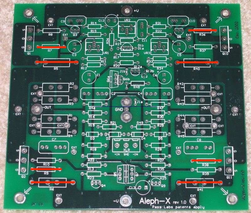

Okay, probably a dumb question but nevertheless here we go. Build two monoblocks as per Grey's lower power design (green boards from hifizen) 15V 4.5A. Next step is to parallel the output devices to up the power (yup increase rail and bias as well). However, I would really like to use the output connectors for Q1,2,10,11 as I've used screw terminals for the wires and I like the flexibility of changing stuff fast🙂.
The question is, should I jumper the source resistors on the PCB to be able to use the original output connectors or will this screw stuff up or anything else I'm missing that is not okay? I've attached a drawing as well just to be sure (I have the gate resistors already off board hence the red jumpers as well).
Any help is greatly appreciated!
