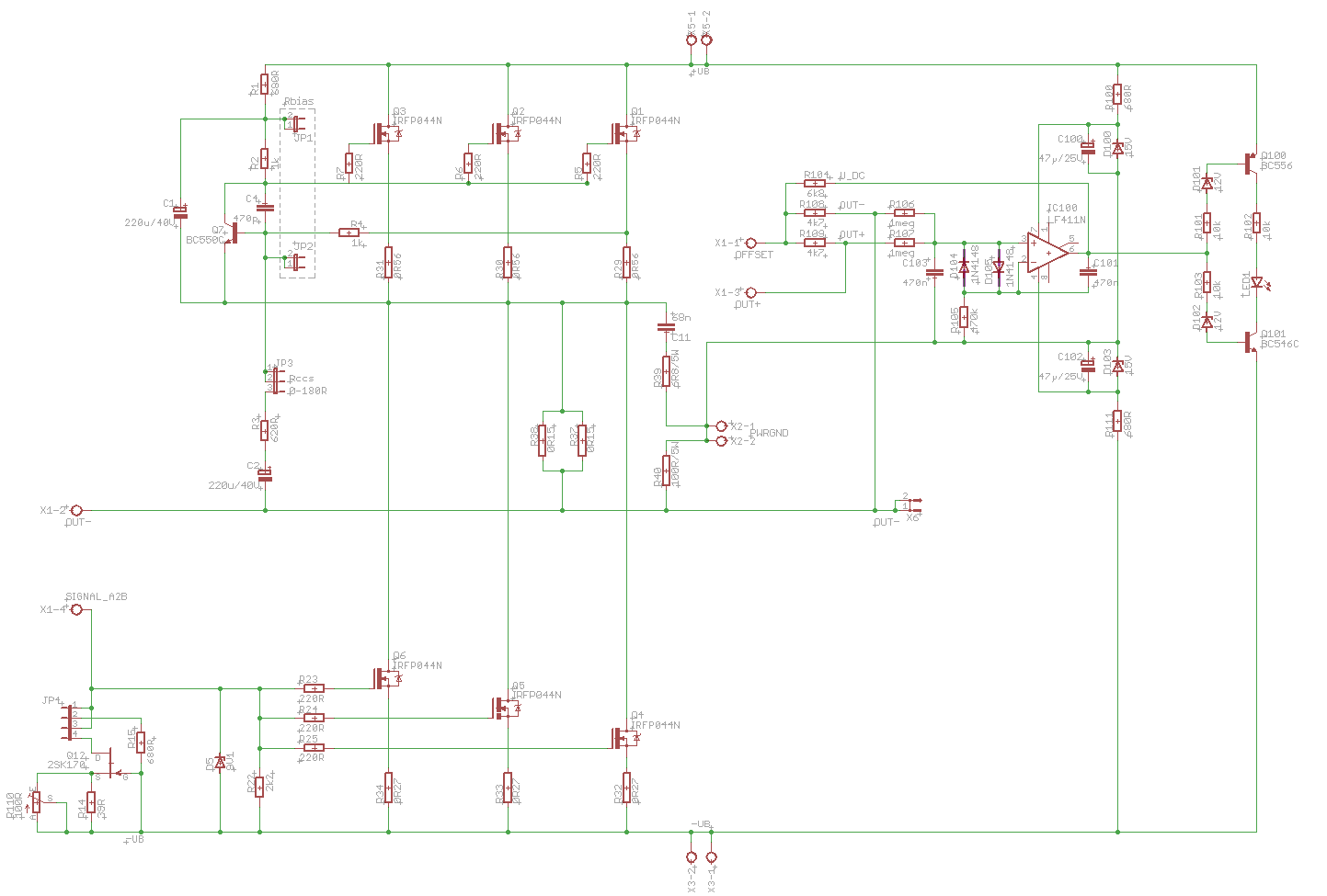

As promised, here the complete schematics (it might be that not every part has the latest value):

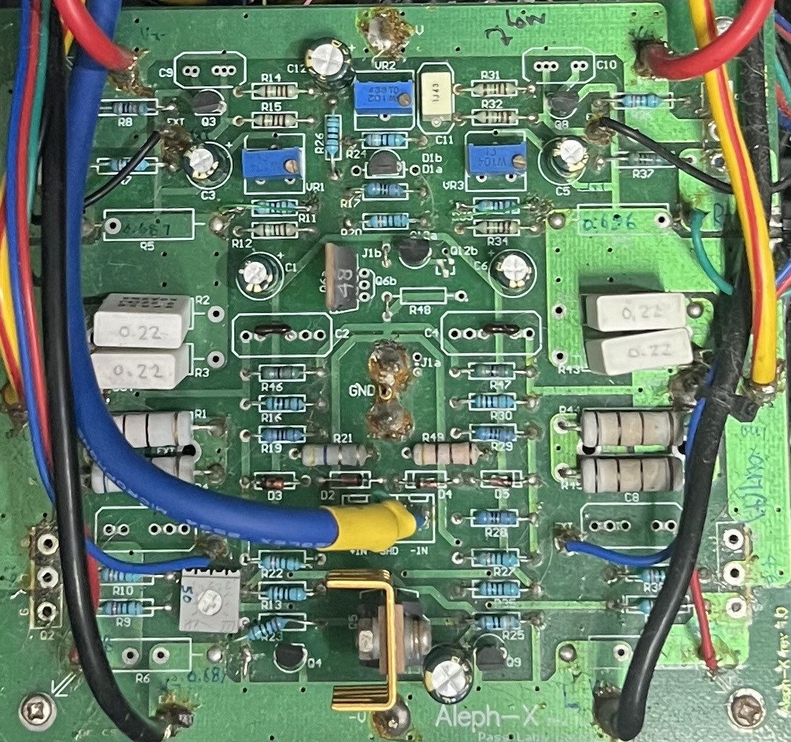

Dear All,
I am trying my luck to check if anybody still has the Aleph-X pcb boards to spare. I am planning to build a monoblock pair with more output mosfets.
The particular PCB board as in attached photo.
Appreciate if you can drop me a note if you have spare boards.
Thank you.

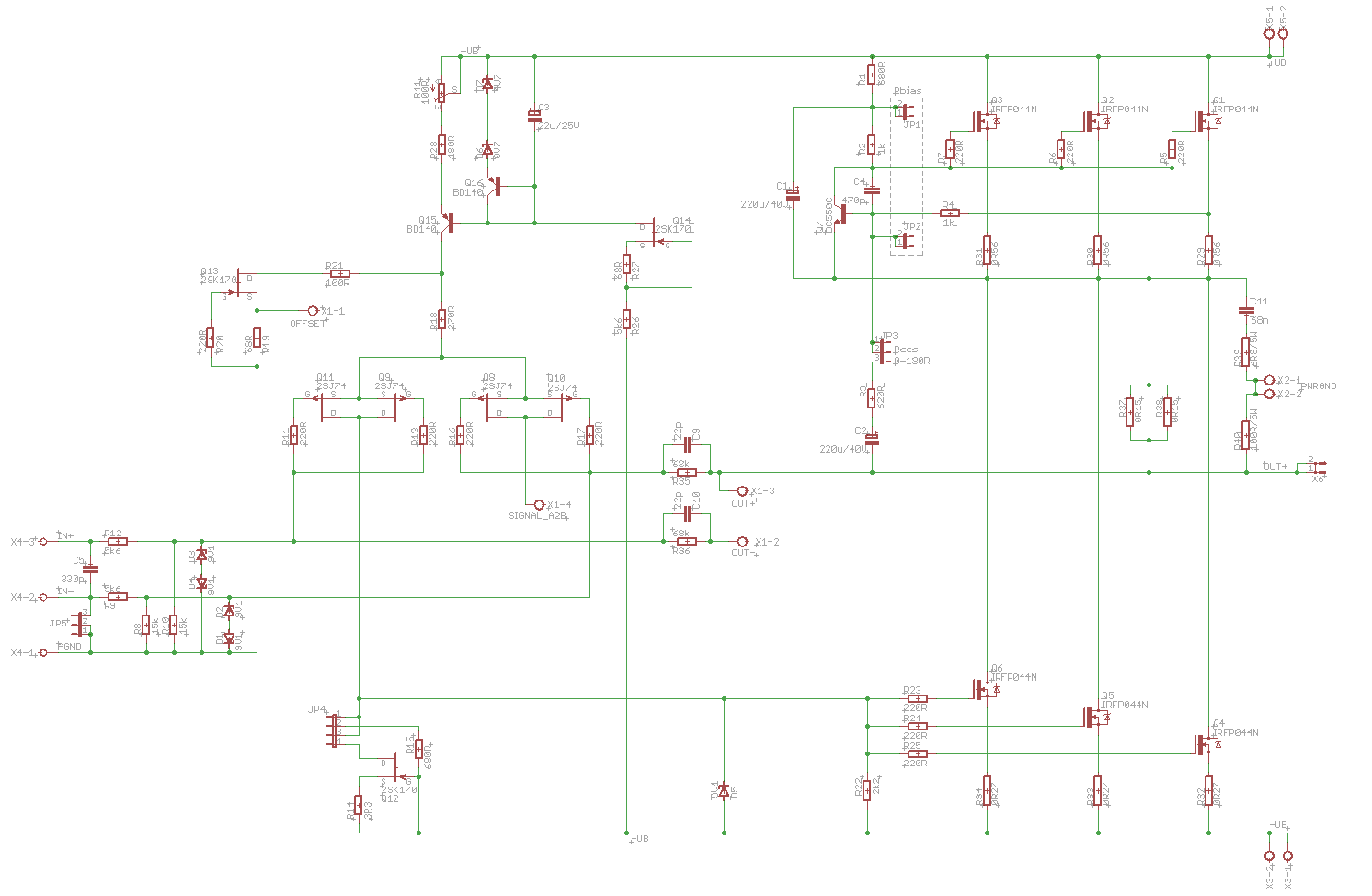

Hi guys,
Rediscovered the aleph-x and thought to redo my stereo amp and make two monoblocks.
  • used the rev1 board from hifizen (the green board)
  • lower power version from grey (15V rail, 4.5A bias, 1 IRF240 per quadrant)
  • used all the values given by hifizen with the only difference I changed r46/47 to 10k instead of 4.7k (see attached schematic)
  • as for the options: jumper across Q12a, jumper across J1a, installed D1a (zener), installed the optional C2 and C4.
  • PSU is a basic CRC 94mF/0.6/100mF with a 625VA 2x15V secondary, unloaded the PSU will give 18V loaded it gives 15V, ripple about 10mV (matches with PSUD simulation)
I have triple checked all my resistor values, diodes in right direction and working and matched Q5/7, Q1/10, Q2/Q11 and r6/41 and r23/25.
However, I keep getting an absolute DC which gets stuck at about 8.8V without dropping any further, relative DC is about 220mV with VR1,2 and 3 all at 0R.
  • Voltage across voltage reference zener d1 is 8.7V--> seems a bit lower than expected as it is a 9.1V zener
  • Voltage across R23/25 is 4.97/4.90V-->seems a bit high would expect more in the order of 4V not sure why this happens (zener?)
  • Voltages across R5/6 and R40/41 are around .485/.421V and .469/.406V
  • VR1 and VR3 give me a bit of freedom to finetune the voltage drop R5/6 andR40/41
  • Turning VR2 CCW (increase the resistance) will increase the absolute DC (as expected as it is still a positive absolute DC)
- voltages across the Qs
Q1Q10Q2Q11Q5Q7Q6a
G1515-10-101.71.76.5
D15159.79.75-10.4-10.45.5
S1010-15-155.35.410.4
Also checked the MPSA18s:
Q4/9 both the same Ve=-15, Vb=-15, Vc=-10, Q3/8 are roughly the same Ve=8.5, Vb=9.1, Vc=14
What am I missing here? Could this all be from a lower voltage across the zener? Or could it be that the MSPA18s are faulty? Measured all IRF240s and irf9610s and they seem to be ok.
Any help is greatly appreciated!
Jan
Attached the used schematic
Hi Jan,
did you change R23/25? Bias seems to be around 24mA through the input diff pair. I think this must be higher. You could lower R24 to get more bias through the diff pair or increase R23/25 to get a higher voltage at the gates of Q2/Q11. This will lower absolute DC offset.
There are probably a few more resistors that need to be changed because of the 40% drop in rail voltage.
Hope this helps,
William
Reactions: Vunce
Hi William,
Thanks for your response. R23/25 are the original values (392), but please correct me if I'm wrong. But with about 5V instead of 4V across R23/25 you get a total of 24mA bias, so 12mA bias per 9610 which is only 2mA off compared to the 10mA bias @ 4V. Or am I missing something here (again🙂)
I tried simulating the PSU with PSUD and saw the same when not loading the PSU (have omitted to mention I have a pretty large bleed resistor in the PSU at about 50 Ohms so I wouldn't shock myself working with an open case🙂, and with only that load I simulate about 19V on the rails).
