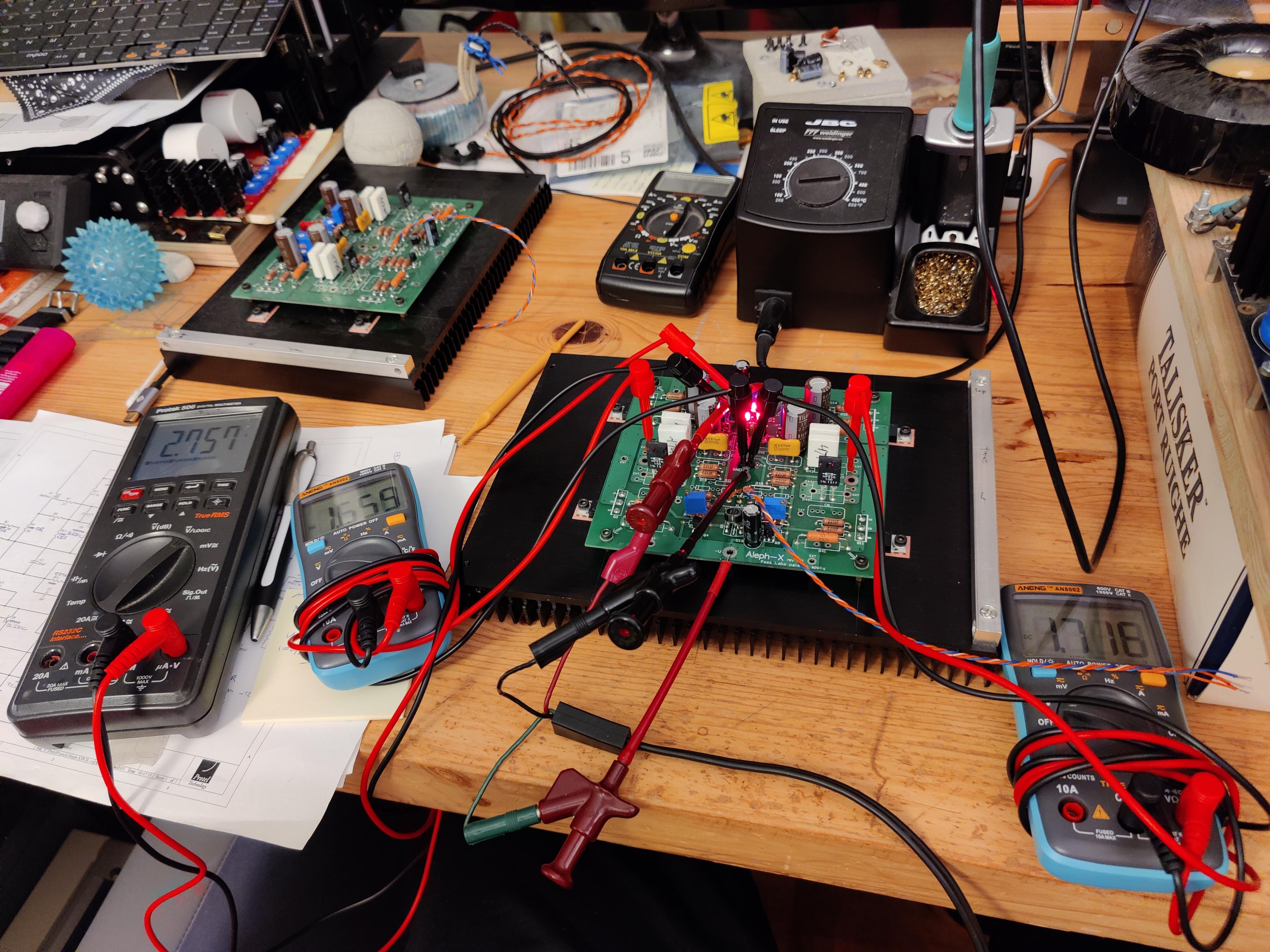

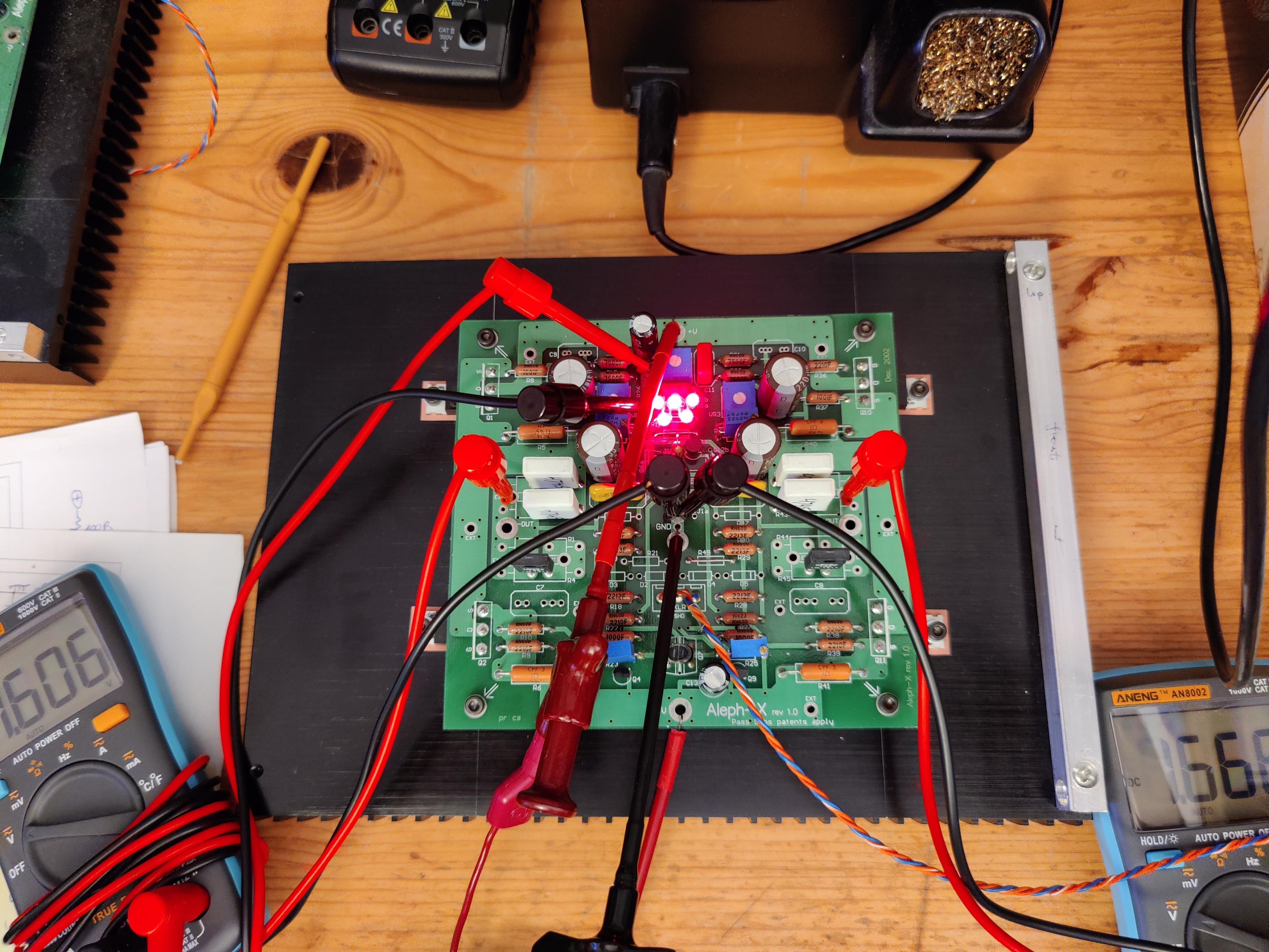

hello everyone
I need your lights, on the Aleph X of the pcb KKpcb
I sent 3 emails there but he does not answer
I have an absolute offset of 4v that I can't get down
despite the 33 ohm out to ground nothing helps with the VR2 fully
I put a trimmer in place of the 360ohm resistance which for Gray's pcb is R24 and even that I can not go down more.
but my main concern, i connected an xlr preamp and a cd player and i have no sounds.
does the absolute offset prevent me from this
knowing that I have 80mv between out + and -
I do not understand !!!!!!!!!!!!!!
thank you

thank you for telling me about the differential
in fact I put tulip plugs to change the pair of 9610 and I just noticed that the pair was badly inserted and suddenly
even the absolute offset is immediately adjusted
thank you for your help.
I took for the finalization to go well
leg 9610 in the two 3.7v
resistor 390 or 392 5v
thank you
Jean Claude
