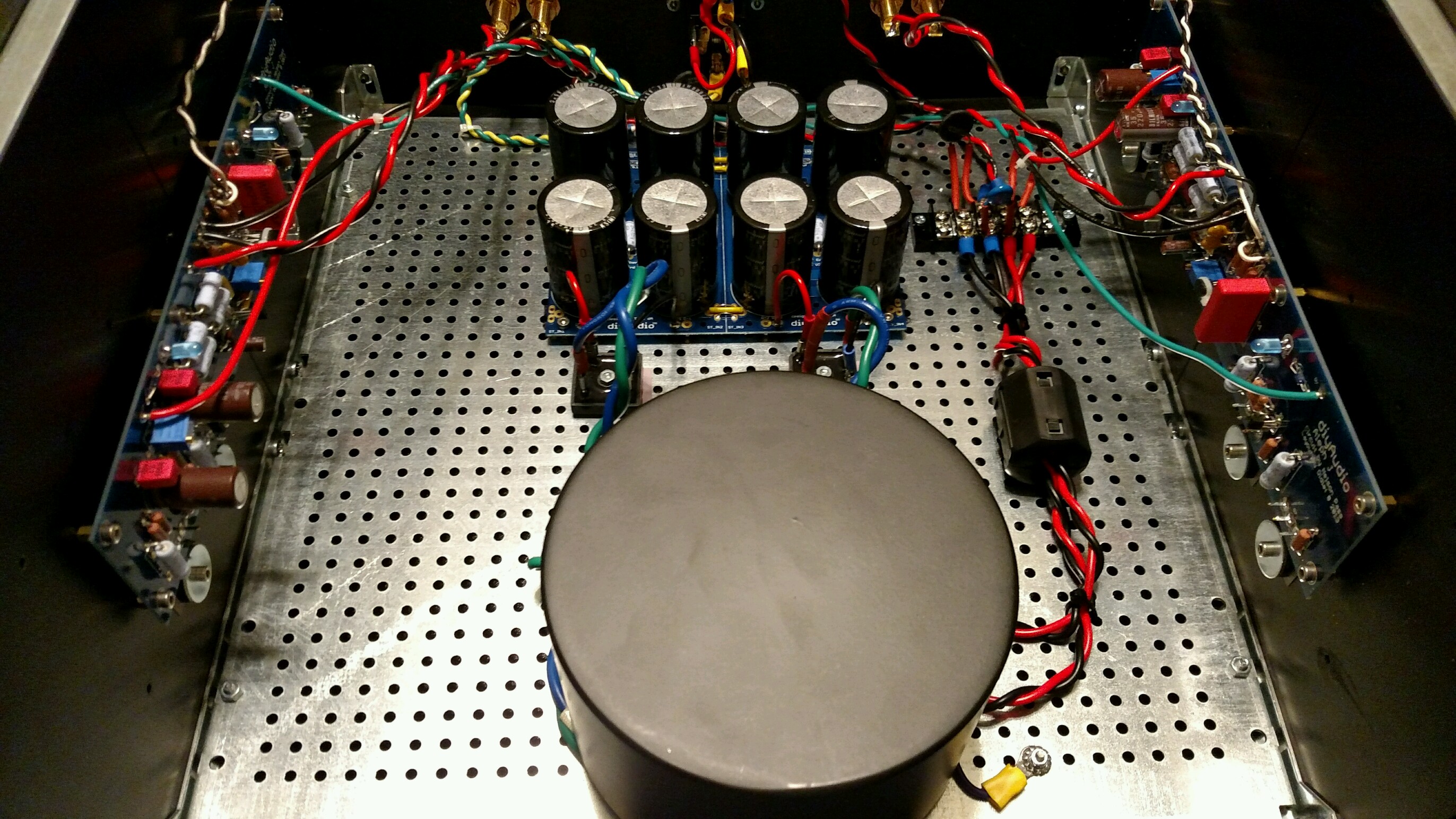

Another addition to the family. So far passed smoke, offset and biasing.
Thanks to 6L6, ZM, and all others who have posted/contributed here☺️

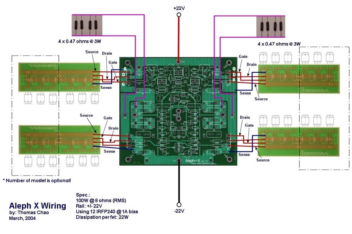

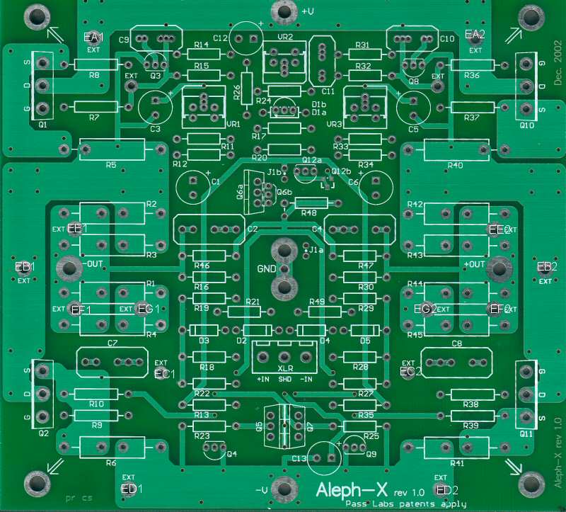

I made the Aleph-X back in 2004 based on the hifiZen version. After that, it was in my basement not long after I completed the project due to my workload and have to taken care of my sick family. Recently, I dig it out, but is seeing an issue. This Aleph-X is a 60W version with 4 output boards on each side. I found out after turning the power on, there are two output boards on the left hand side stay cool, while other 6 output bords are working OK and hot. I checked the source resisters on the output boards, the working one is about 300 mv, while on the other cool one is less than 90 mv. I tried to adjust the VR2, but cannot lift it any higher than 120 mv. I checked the DC power to both sides are all the same at around 20V. Anyone still having the Aleph-X can share your thought what might the problem be?

that's actually the board I designed, it's based on the original circuit whose author I forget (besides NP of course).
I still have quite a few of these boards. I have been away from here for almost 12 years.
I would actually like to build it again but with fets at the input since I just discovered I have several unobtanium fets 2sk170 2sj74. I gave my complete amp away for free to a lucky guy when I moved from Jersey my truck was full!
I don't remember having any issues with performance. It was actually the easiest amp I've ever built. At the moment I don't fully understand your issue, but I haven't looked at this stuff for over a decade. LOL
BTW my built was using 4 mosfets total off the main board w/o the daughter boards and using +/-13V supply. It was very toasty already maybe 50C on a case that was maybe 30 lb of Aluminum

tomchaoda1: for your "cold side" of the amp, I would suggest tweaking your bias pots a little while you have a meter on the source resistors for the mosfets. See what you are getting for bias. Fully biased up, you should be somewhere near the 0.4v range I think. Maybe one of your pots just corroded/oxidized a bit over time. Since the layout of the board is highly symmetric, it should be easy to compare voltages from one side of the amp to the other. Start with bias for the input differential, then bias on the output transistors. Then move on to other parts of the circuit. This should be pretty easy to track down, it will just be tedious.
