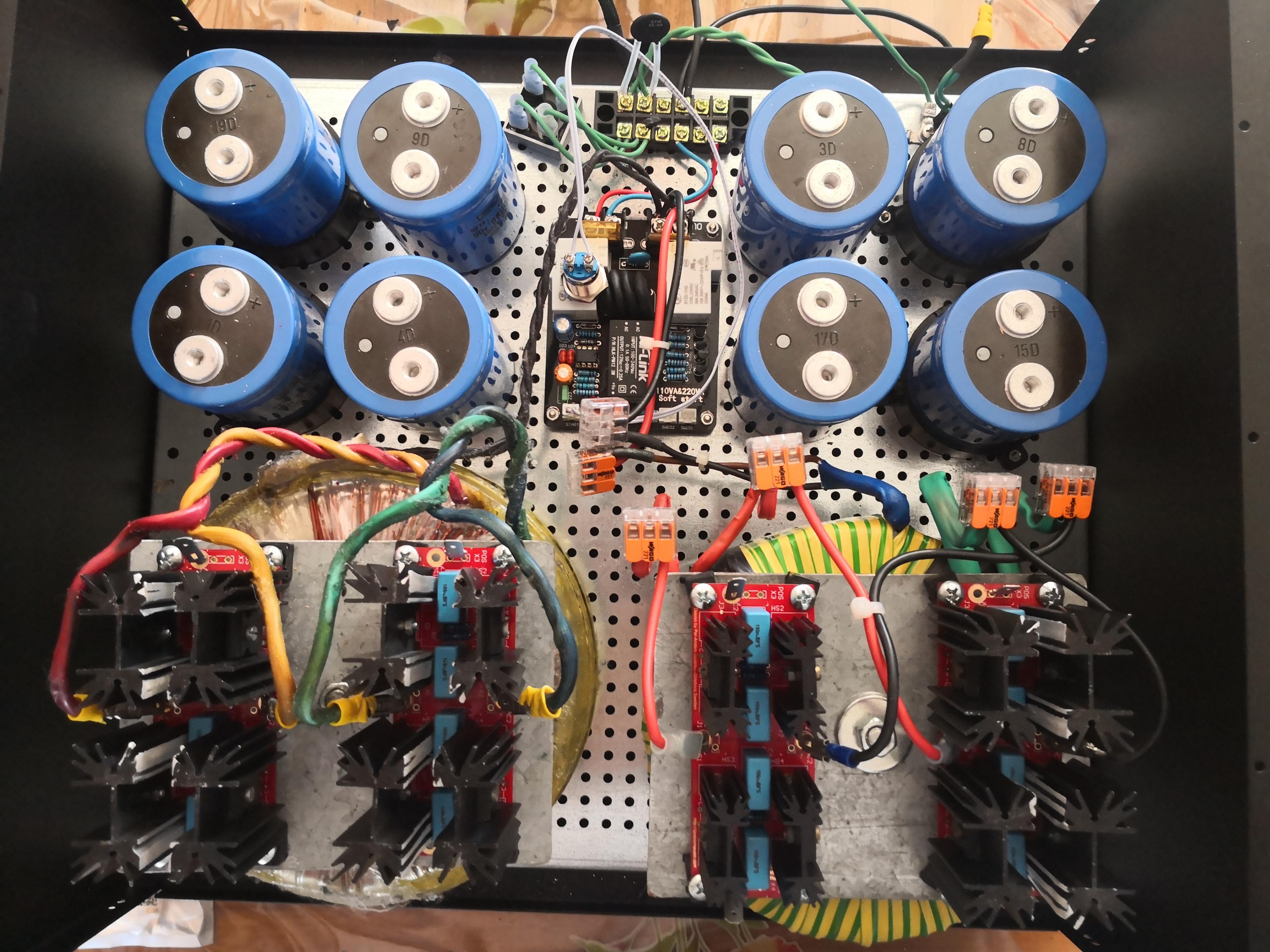

I hope I'm on the right post to ask my question about my diet of the Aleph X that I build.

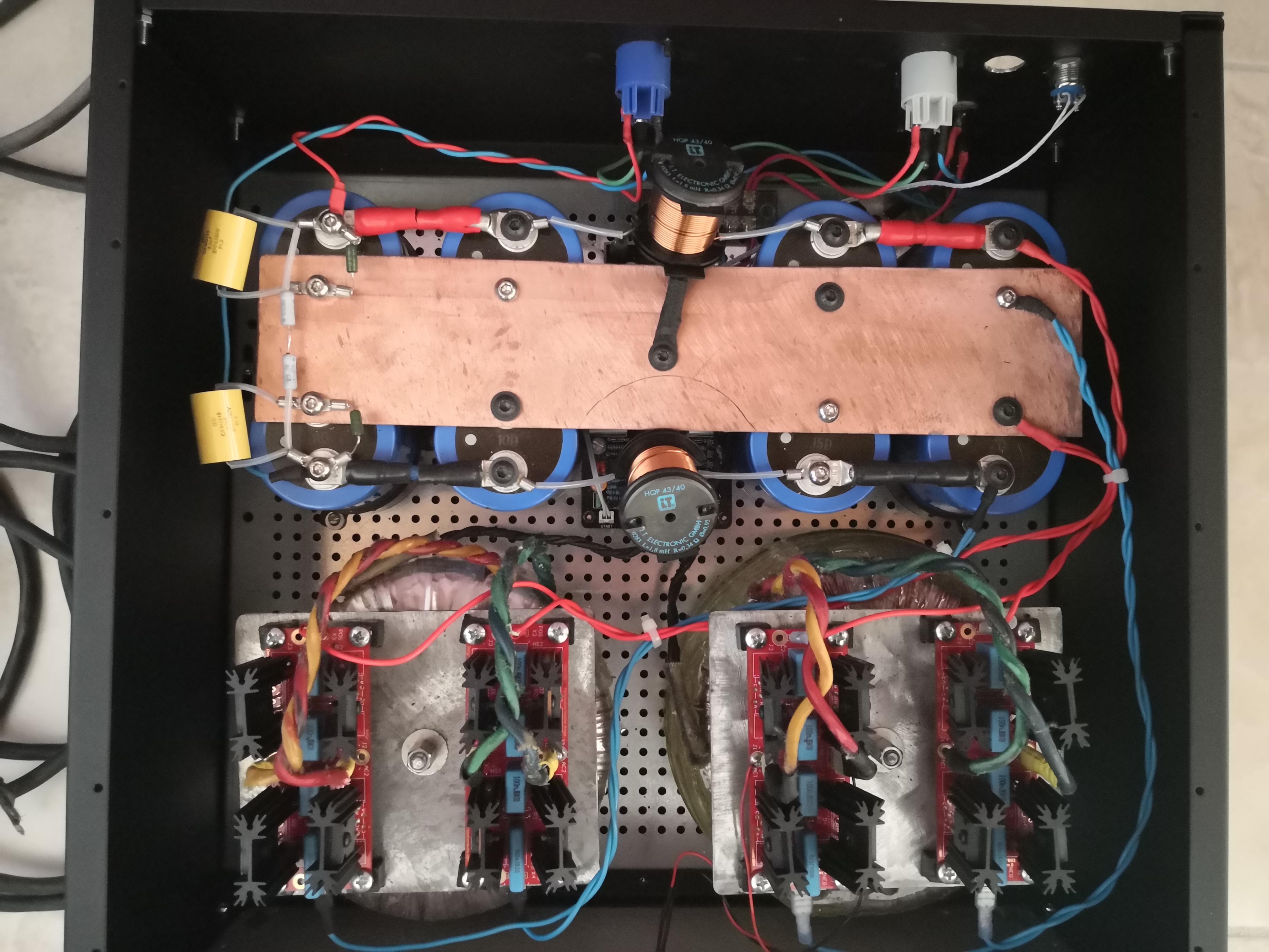

I make separate power supplies for each mono block
with 16 IRFP240 transistors per block.
2 toroidal transformers of 800va per block 2X30v in secondary
with 4 bridge rectifiers RFB 03 from Mister Per Anders.
8 capacitors of 50v 68000uf / CCLCC self of 1.8mh.
at the end of the bridge secondary I have: 42v.
I need 36 V on the connection of my pcb
(I know it will heat up but I have the necessary heatsinks)
my question:
since I'm doing a voltage test at the output of the bridges or the capacitors
once i have connected this 42v to my pcb and i need 36v, will the reduction from 42v to 36v be done once i have connected my pcb?
(because the measurement is taken empty?)
thank you for your answers and my question is clear

You could hook up an incandescent lightbulb (or several in parallel) across your power supply to see how it reacts under load. The incandescent lightbulbs are rated for 230V AC, so they can easily withstand the PSU voltages and don't need heatsinks. The cold resistance of a 100W 230V bulb should be 20 - 40 Ohm (easy to measure with a voltmeter), so you will not short the PSU.

Aiming for 22v rails is MUCH more reasonable and will result in a chassis that you can actually lift and carry around for maintenance in 10-15 years.
As for filtering, my PSU uses a 1000VA transformer with 19vAC secondaries. After rectification and CRC filtering, I get about 22vDC for the rails. The first C is about 50,000uF, R is a 0.07ohm 50w gold bodied aluminum sink attached to the floor of the chassis and the final C is 200,000uF. I get about 10-20 mV of ripple on an 8A current draw.
You want to keep any resistance in your power supply low, aiming for somewhere near 0.10ohms (especially with a high current draw). If heat dissipation of your resistors is too high (check spec sheet) you can take two larger resistors, say 0.15ohms and parallel them for 0.07ohms overall.

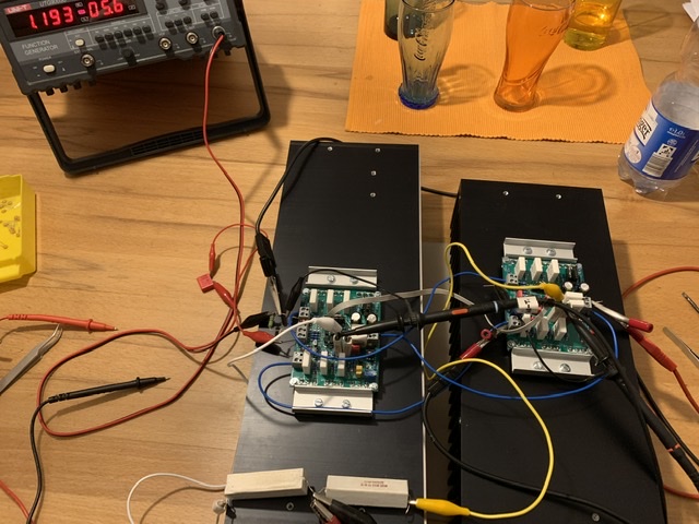

I am in the last test phase for the 18 Aleph-XJ for our small „amplifer anonymous“ group 🙂
Hopefully I can deliver some nice pictures the next months. Or is it preferred to open a new threat for that?
Regards, Jean-Claude
