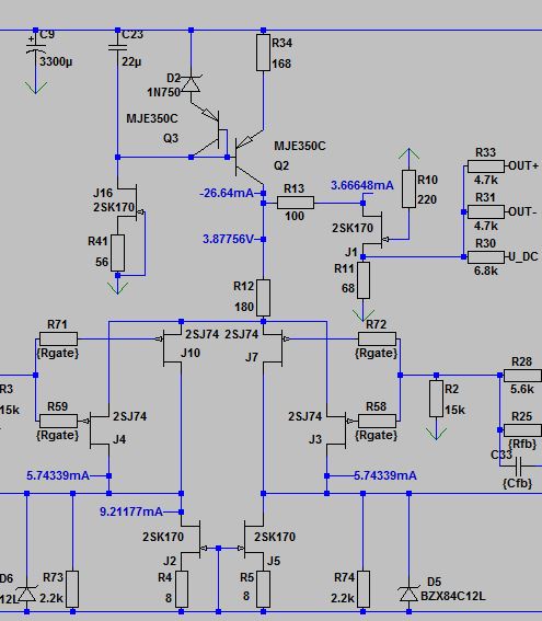

Attached I have the Input stage for discussion:
Background for the CCS J2/J5:
When designing the output stage there is a trade-off between low frequencies (transconductance=big devices) and high frequencies (capacitance=small devices). Loading the input stage with a CCS gives more OLG at low frequencies with no loss in performance at high frequencies, so why not? Additionally this brings back the OLG which was lost by JFETs instead of Mosfets and lowers the amplifiers output impedance at low frequencies.
Circuit: Load of the input stage is reduced from 390R to 2k2 (R73/R74). This retains a stable common-mode behavour. The rest of the needed current of the standard ~11mA is delivered by the CCS around J2/J5.
D5 / D6 are needed to avoid high voltage at the outputs gates when failure / startup.
Background for the circuit around J1: The performance of an differential amplifier depends strongly on the impedance of its current source. One reason why CCS are usually used and not resistors. The MacMillan Resistors disturb this - you can see it very well when using the amp unbalanced: The output voltage at OUT+ is significantly higher that those at OUT-, for me a reason why aleph-x responds so well on a balanced source. With the decoupled common-mode-feedback this problem is solved and even driven unbalanced the OUT+ and OUT- are (nearly) identical.
Circuit: The voltage caused by R12 is needed that the circuit will work. J1 is designed as ~4mA CCS by R11. The "MacMillan" Resistors (R31/R33) go to the source of J1, R30 is additional current from a servo. The JFET transfers the common-mode-signal into an high-impedance current.
For me its a nice way to get rid of the "problem" just by adding 1 Resistor and a small standard JFet 🙂
(R13 is only for measuring drain current, R10 only for safety).
Remark: The circuit shown can add +/- 4mA to the LTPs current which is enough with the 2*2k2+CCS load. In "standard" circuits with 2*390R load this current might be chosen somewhat higher.
Your thoughts are welcome 🙂
Regards, Jean-Claude

I think your math is off somewhere. 3.3A bias per side will give the 80W@4R, but 24V rails will give you ~130W@8R.
Also, your assumption that 23V rails are the min for best results is incorrect. My Aleph-X monoblocks run 15V rails and have put some pricey commercial amps to shame in comparison. If you look at Nelson Pass’ own commercial XA amps, he has models with rails as low as 12V.
For getting best linearity etc. from diving your output devices as hard as possible, you get greater benefit from increasing the bias current than increasing the rail voltage. You would be better served by lowering the rails and increasing the bias, while keeping the dissipation per device the same. This would also serve to give you better low end performance.
With regards to your arrangement of CCS’s surrounding the long-tail pair, I see what your intent is and the rationale behind your design choices, but I think you are using a sledgehammer to fix a “problem” that’s not really much of a problem. With the circuit you are proposing I’d be wary of relying only on simulations, and strongly recommend you prototype it to make sure it works as intended before you do any larger scale group building. I’d even more recommend looking at Zen Mod’s servo circuit as a more elegant solution that has been well proven. Also, the Aleph current source as-is already provides some serious low frequency grunt. I don’t think you’ll be disappointed.
Remember that one of the reasons Nelson Pass’ designs sound so good is that he uses very simple circuits where each part is optimized to get the best linearity out of the devices used. While he doesn’t avoid using feedback, he also seeks to use only as much as is required. The elegance and simple sophistication of his designs are a large part of why they sound great. Boosting the open loop gain so you can apply much higher levels of feedback may take away the Pass magic you want to achieve. But that is just my opinion.
On the other hand, this is DIY, and doing it your own way is half the fun, and if you share your experiences and results along the way then everybody gets to learn more about what works and what doesn’t. Just look at a couple of my development projects from waaaay back and see how many mistakes and iterations I made along my learning curve! It’s just plain fun to try stuff and see how it works.
Cheers
Terry
Hi!
Thank you for your input!
With 23V / 3.2A(6.4A total), the AXE-1 sheet (and LTSpice) gives me 110W@8R and 90W@4R with 53% AC current gain.
3A is a rounded figure, with 0R56 in the output CCS I expect ~3.3A. You are right, it eventually might be better to go to 0R47 in the current source which allows the option to bias up to (0,62V/0R47*3=) 4A in maximum. Its also a part of the project to add a bias-switch for either "high-end" or "casual" listening.
Regarding the front end: A collegue has already built up a "low power" Aleph-JX with 15V / 2A. Works well and sounds good, we think quite a bit nicer than my "stock" Aleph-X from 2006 (18V/2A). For the actual project I have a jumper on the layout to test both versions - CCS and the standard 390R.
You are 100% right - at least 50% of the fun is to bring in own ideas. And I never build up a identical component (loudspeaker, amplifier) a second time - its sooooo boring 😉
I like the pass concept of the simple circuits very much. But additionally I like to add my own taste: Use a simple circuit, and create an environment which allows this circuit to work best. I have no problem if it will get a little more complicated.
To my experience with different circuits I see benefits in low-loaded circuits. For me they are usually more dynamic and "airy" compared to heavy loads by resistors. The "problem" here is really not to produce too much open-loop-gain. In the Aleph-X I see no problem here since the open-loop-gain is only rised at low frequencies with the CCSs, from kHz upwards the open-loop-gain is limited by the output transistor capacity anyway.
With this in mind I developed the design modification in the input stage and chose the supply voltage: Higher voltages give significantly lower values of capacity in the output transistors and therefore a lighter load at high frequencies. Btw I would like to try out a cascoded output stage, but liked to keep it simple...🙄
I am aware of the fact that on the other hand a high current will improve the low end. But wasn that "Papa" Pass somewhere on the first pages of the threat which preferred higher supply voltages?
Personally, I find the input stage of ZenMod questionable. With the additional buffer its far away from the simple original circuit - much more that mine. And the buffer will increase open-loop-gain much more, therefore adds stability issues etc. If my version is "sledgehammer", what would you name this? As I see (and simulated) the Servo, it causes the same problems as the solution with the Macmillan resistors - poor common-mode-rejection and different output signal with unbalanced input (or are Im wrong ?) The "problem" here is that AC-common-mode-feedback (=not lowpass filtered) from the output also cancels out 2nd harmonic distortion.
