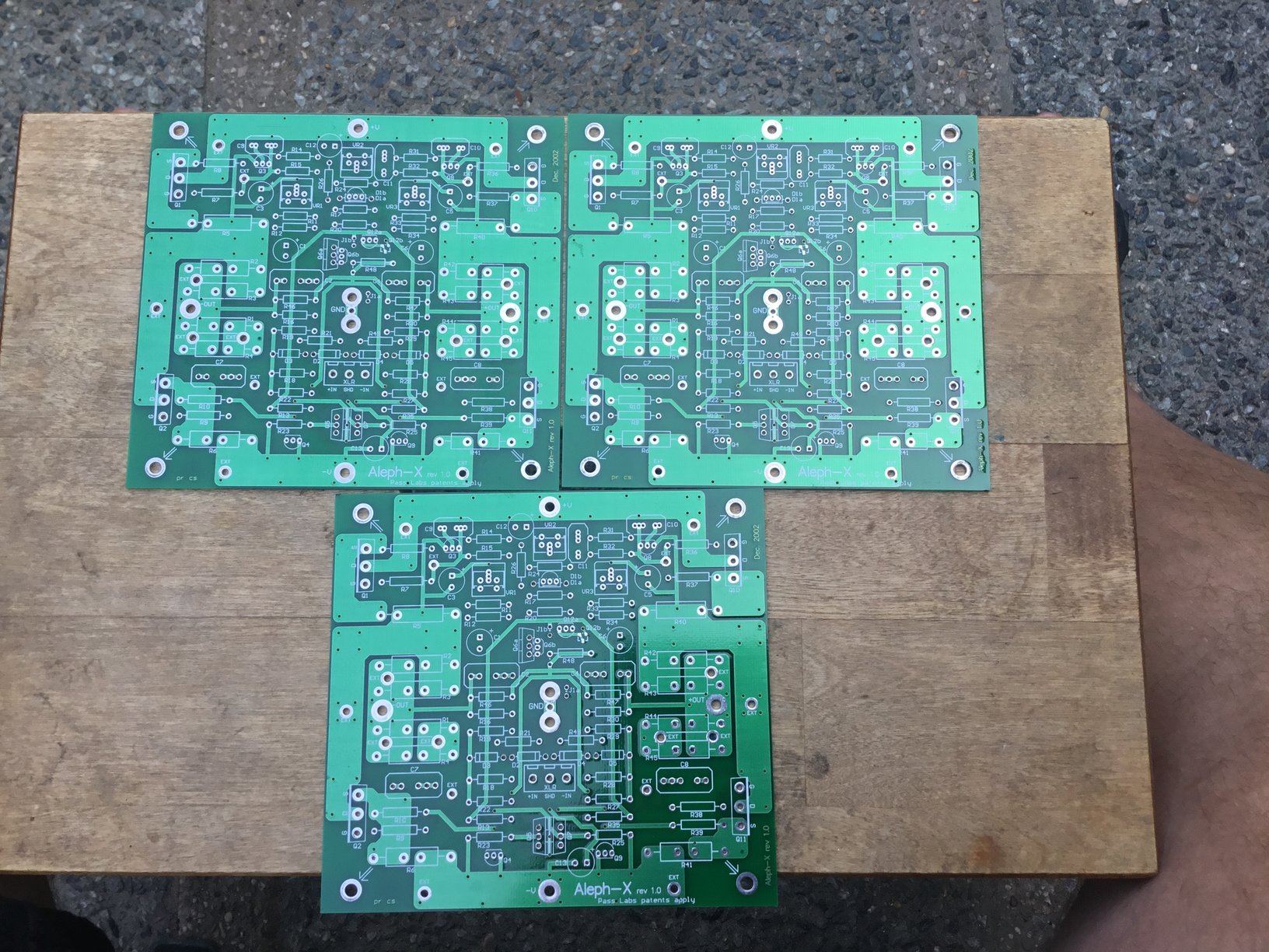

I reckon its safer to run the amps with the prescribed 22V rails. On reflection, my speakers are a nominal 4 ohms, so definitely better to go for higher current.
PS: do you see any issue with using the IRF 140 Fets, instead of the 240 as is commonly used?

Good one - i think this;
open your own thread , take care to shoot questions in order by importance
what power you need .... what's primary - 4R or 8R load , how big you intend to go with heatsinks etc.
for few important details , look here : Babelfish XJ , or JX …….. or whatever | Zen Mod Blog
you'll see how planning is important , and hopefully realize how erring on big side can be costly ...... or too costly
4 is for sissies :rofl:
either make it good , or do not make it at all
no less than 2 mosfets per quadrant , so 8 per channel
only in case that you use IRFP150 , practically 2pcs of IRFP240 in one case , you can go with 1 per quadrant
for 4R speakers , choose rails up to 18Vdc , no higher
lower than that , problems with varying mosfet's capacitances
