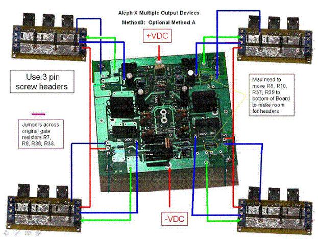

Aleph X High Power Connections
Hello everyone, I've been looking at the A-X high power connections to multiple MOSFETs. Seems like there is some talk about how to connect these but nothing definitive. So I have looked at all this and I think it goes as follows, let me know if this is wrong-
Aleph X Schematic (left side) Multiple Outputs
Here are some options for using this information to connect Grey's boards to multiple output devices (again please post if any of these are incorrect).

I think I'll use Option 3, which appears to be the best.

Re: Aleph X High Power Connections
I've edited the links- please don't wait 5 more days to tell me this does not work.

I think none of your drawings are correct. I took a long look and did a complete redraw. Feel free to comment and correct.
I wouldn't use the jumpers accross the gate resistors but wire directly to the Ext connections.

Hugo,
Your redraw looks the same as LGreen's option 1 to me.
What he didn't emphasize is that his other options make use of 2 or three terminal screw connectors in the holes for the ouput devices. That is why he jumpered the gate resistors. I don't see any issues with them, but it wouldn't be the first time I have been wrong ;)
