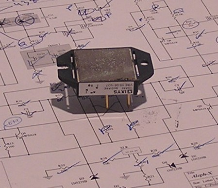

Does anyone know whether the case of the IXYS bridge module VBE 55-06N07 (data sheet here) is isolated or not isolated? Pic attached.
As you see in the pic, the bottom of the package is metal, I've mounted it to my case with thermal compound and it occurred to me that it may be live! I measured it with a DMM and found open circuits between all pins and the case (swapped DMM leads and results are also the same), did a diode test (again swapping leads, same result) and found no drop between any pin and the case.
Funny thing is that IXYS doesn't have any info on this and the data sheet indicates nothing.
Anyone know this package?
I hate to fire up the xformer without being sure.

my thoughts...
What with my being a newbie, take what I say with caution.
I'd disconnect the DC power leads from the rectifier and then fire it up. Then, measure the case against the two DC output leads with your multimeter. I don't recall using mica with any rectifier.
John
John
the datasheets speaks of a ceramic base plate. This would mean that it is electrically isolated (as usuall with bridge rectifiers).

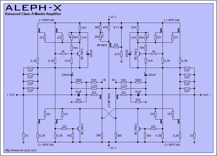

A question about aleph-x.
On Wiki, I found this paragraph.
"You may want to install everything except Q1, Q2, Q10 and Q11, then power it up to see that the diff pair and it's current source work properly."
How can I know the diff pair is working properly or not?

the only thing you can check is if the current source for the diff pair is working and if the fets are matched properly by looking at the voltages at the 392R resistors.

If they are working properly, what's the voltage drop across 392R?
Should I connect to any input when I check it?
Thanks.
Wing
at aprox. 10mA per input fet you should be able to calculate it😉
0,01 x 392 = 3,92V above the -rail.
input shorted to ground
William

The only thing you can check is if the current source for the diff pair is working and if the fets are matched properly by looking at the voltages at the 392R resistors
Hi Wuffwaff,
isnt it easier to use 392 ohm resistor on one leg, and a pot on the other to get the voltage across the resistors equal?
