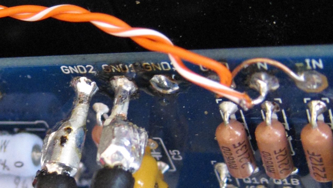

The RCA connect the center to +IN and the ring to GND at the PCB.
Take a short wire and connect -IN to GND on the PCB.
EDIT: as boky shows below.
Well, that earned me an offset correction and a ever so slight hum. I think the image is more solid, but I'm not so certain I prefer the difference. Perhaps I'll try balanced input. If I'm not mistaken that configuration would be as I had it with one of the balanced input connector pins grounded to the chassis.

Its not enough of a hum to bother. Since grounding IN-, I no longer need to ground my source chassis, it makes no difference.

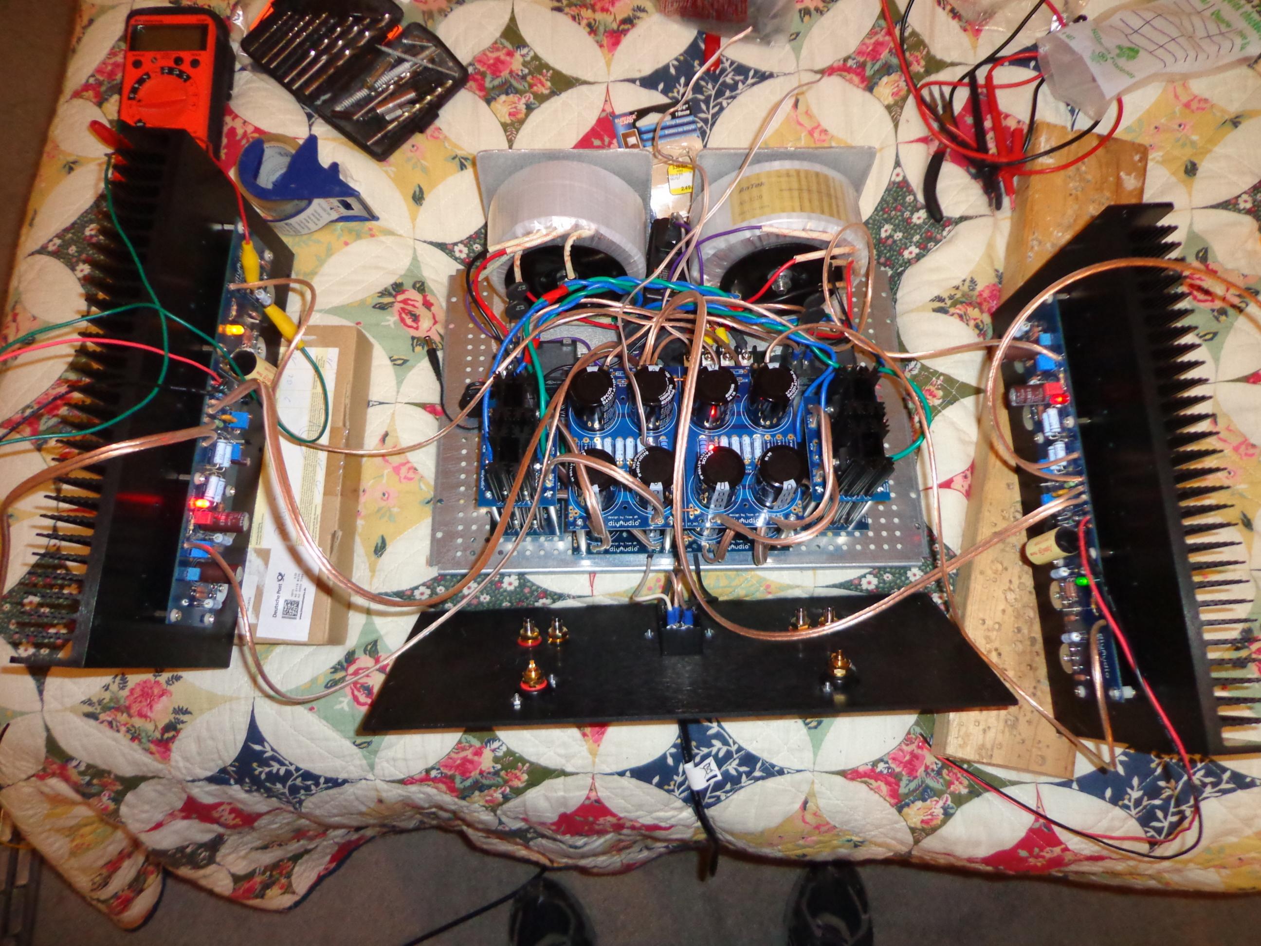

Google search results (diyaudio) indicate I could stack the power toroidals with the only concern being heat. I think there is room on the front plate for two PSU boards - that way I could keep my existing layout with minimal changes.
Attached is the my current layout. Mind the wire running across the top, that is just a hack for a couple 140mm case fans I have strapped to the sides. All heat issues are resolved, -15C to -20C drop everywhere.

So according to what I see in the Sissy layout, I could split the existing PSU board and just run one to each board? I saw CRCC used on the PS output. That's some nice looking caps on the last line of C for the PS.

Could you split one PSU board in half and then run each half of that PSU board to one channel of the amplifier? No.
You need a bipolar PSU on each amp channel.

The nice looking caps are Ducati 50uF decouplers, simply to create another reaonant frequency mostly iot improve highs. Papa’s supplies in some instances use 10uF. I don’t think a decoupler would put a new C in the CRC, simply because it’s function is not smoothing per se.
Maybe I am at a bit of a loss here, but may I ask what your issue with the PSU is as of now?
I have had PSU issues, and found myself doing a PSU «my own» way, making it more difficult to troubleshoot. 6L6’s in the guide is quiet unless he has stated otherwise, which he has not. ZM’s way differs, but is equally quiet, and follows the same good principle. If you can get hold of his PSU boards, you’ll get a theoretically better ground tracing than the store boards. That’s not to say the store boards aren’t quiet, but simply stating a small weakness partly made up by the fact they are made to be split up if needed and as such the gnd tracing cannot be perfect.
I notice some people put their smoothing banks at the front plate. This forces transformers to be placed more mid-chassis, bringing both them and graetz bridges/rectifiers closer to the circuit. Following the standard, examplified by 6L6 numerous times, is a wise choice as it brings the most noisy parts of the circuit away from gain stages and signal wiring, according to Papaland recipe.
A completely different way is doing P2P, which I am in the process of doing. I can say it is a bit time consuming. Having things on a PCB is a bit easier. But I swore some time ago I would make one, so there we are.
The world is full of bad ideas, many of them tried before. It is also full of people willing to try and prove the bad ideas good. Dunno what I am trying to do, but I enjoy every minute of it. So who cares.
PS: Follow 6L6’s advice always, and as a general rule don’t split the boards in a Pass power amp build - ever, for any reason. They need +/0V + 0V/- (bipolar). Nothing good can come of it, unless you know exactly what you are doing and why. If you split as suggested, you end up with two half PSU’s, and that doesn’t work. In short, you’ll be missing a wire with either pos or neg polarity. Cubicincher has had success with spltting, but he is - well - cubicincher, and of course still used both polarities. Example in BA-3 guide thread.
Though maybe if you really enjoy a good bass thump, you may attempt to connect two boards of the same polarity to your circuit. The thump would probably be a one-off though
Jokes aside, I wish you luck!

No real issue I don't think. There is a 60hz hum, but you have to ear the speaker to hear it. I previously had the amp boards wired incorrectly for SE input. I was not grounding the IN-, instead ran it to the floating GRD that is on the SE input connector - and I'm not using a shielded cable. Oddly my previous configuration was perfectly silent but going the proper route has created this slight hum. *shrug* It's likely a ground connectivity issue somewhere. I've not really troubleshot it deeply yet, I have been too busy enjoying the musics!

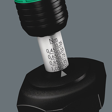

0.9
can't suggest a wrench, I was lucky - bought first one new for 1/4 of regular price, recalibrated it from 1.2 to 0.9
bought second one SH for 15E, recalibrated it from 1.5 to 1.2
now I have first for M3, second for M4
M4- handy to think less while dealing with pucks
Dear Zen Mod, if a tool can only be set to either 0.85 Nm or 0.95 Nm, what would be prefered?
I was reading datasheet of resistors in TO-247 housing, Powertron FPR2-T218 and Mundorf M-Resist Ultra.
Both datasheets specify Max. Torque - 1 Nm
Vishay IRFP240 datasheet for example specify Max. Torque - 1.1 Nm
