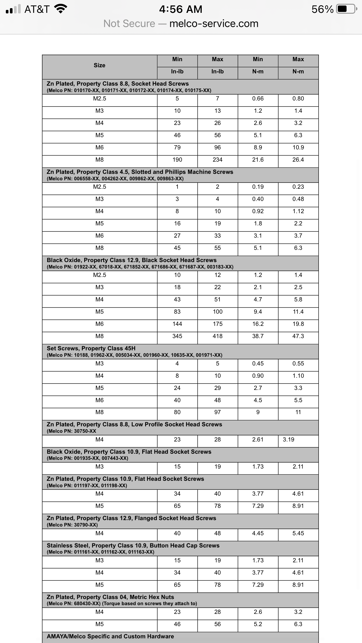

Only 0,9Nm, ZM? My torque wrench is quite imprecise under 2Nm (min value)
Here
Pa sez - M3 - 0.9Nm
Ok, he wrote in Yank measures, so I converted to adequate for my tool
Peppe - use that for Fiat and Moto Guzzi, not for mosfets
The mounting torque limit of many of our favourite parts (IRFP240, IRFP150, IRFP9240, etc)
is quoted as 1.1 N.m on the datasheets, so 0.9 seems like a good value to use.
I now see that on data sheets…thx Dennis

I’ve always taken into account the thermal expansion of metals when torquing dissimilar metals…aluminum generally speaking expands twice that of steel…so yes it makes perfect sense to use very slight pressure when sucking down transistors. The key is getting all the same pressure in any case.

I'm going to use mica+goop, so 1.?
0.9
can't suggest a wrench, I was lucky - bought first one new for 1/4 of regular price, recalibrated it from 1.2 to 0.9
bought second one SH for 15E, recalibrated it from 1.5 to 1.2
now I have first for M3, second for M4
M4- handy to think less while dealing with pucks
