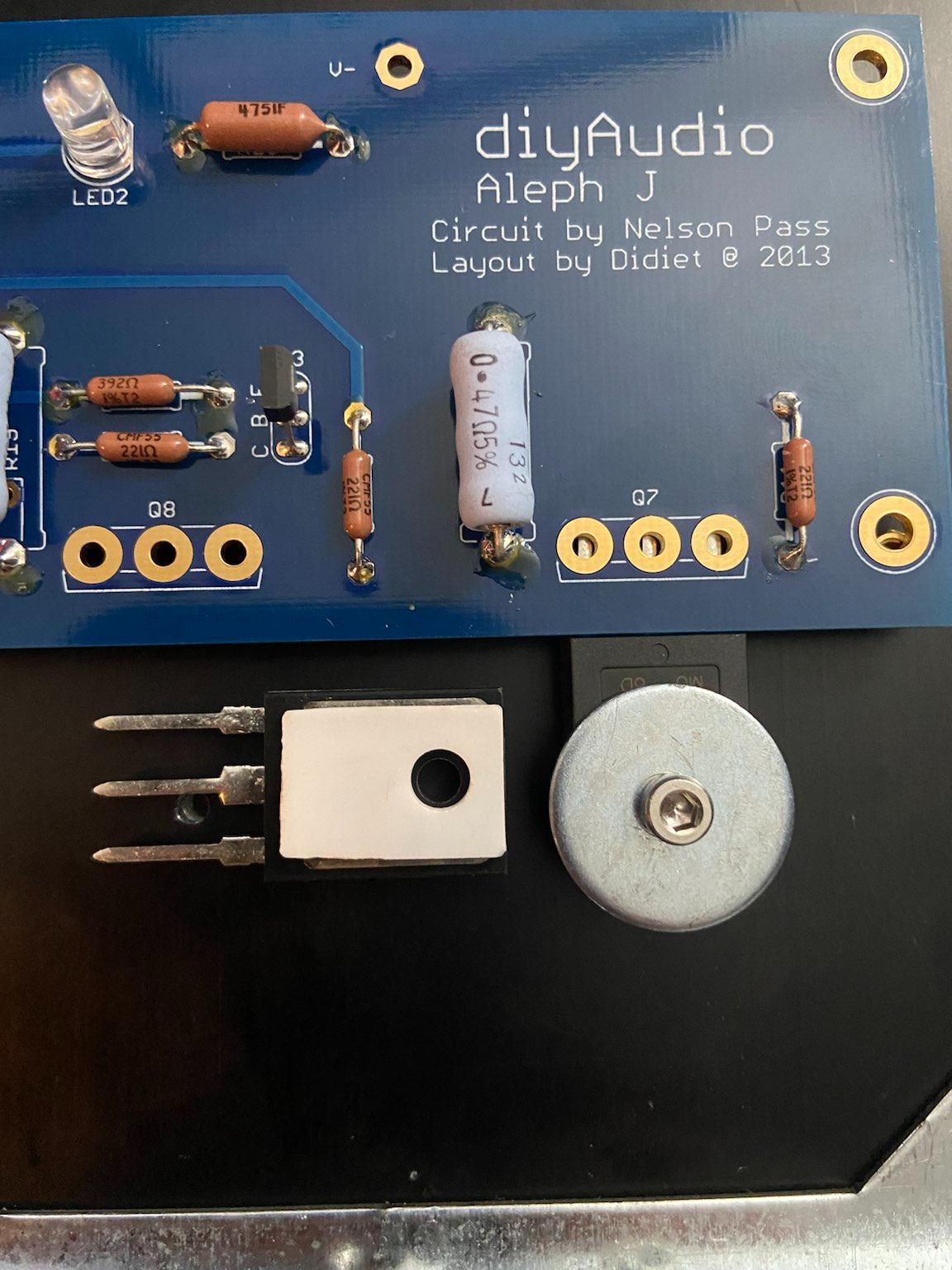

Those ceramic insulators are perfect! Just about any thermal paste will work well, both sides of the ceramic wafers need to be coated. This should produce more uniform temps when mounted to the sinks and, as you've noted, temps are directly related to resistance, so this should even things out. If you are still having trouble after replacing the insulators, we'll explore other options.
I have a bunch of these 2mm thick ceramics that were given to me by my dear big brother. But, they are slightly smaller than the FET package (pictured). Thoughts on if I could safely get away with these.
The other issue is that using them will require taller brass M3 standoffs. The 2mm rise causes the DIP package to collide with the Amp board (pictured). Anyone have a digikey link to taller ones? Also the socketed M3 machine screws would need to be taller if I use split washers to lock out temperature creep... or I just leave the amp on forever....
Also I only have arctic silver heatsink compound on hand and its conductive. Hey if we don't get it on our CPU's... should be able to pull it off here right?

I’m thinking you will be fine with the slightly smaller ceramic insulator. You do need to use thermal paste for sure, though I’d be a little reluctant to use electrically conductive paste. The extra thickness sometimes necessitates longer standoffs for your PCB, though you might be able to get away without changing them. Just bend your mosfet legs so they are a bit longer before they tip up into the holes in the board. This will allow you to move the mosfet out from under the PCB. You may need to drill a new hole in the sink for this. If you do drill a new hole, be sure to deburr before mounting the mosfet.
On ebay, you can find a ton of 1mm thick aluminum oxide pads pretty inexpensively. These might be easier to use than 2mm thick ones. A variety of sizes are available.

Re-drilling not an option without a drill press, or set of taps, being the reason I splurged on pre-tapped heatsinks in the first place too.
1mm ceramic pads might work.
pads are OK
goop necessary, proper one
longer bolts yeah, but you can add whatever to rise/lengthen standoffs - few washers, you can even cut some from plastic tube
