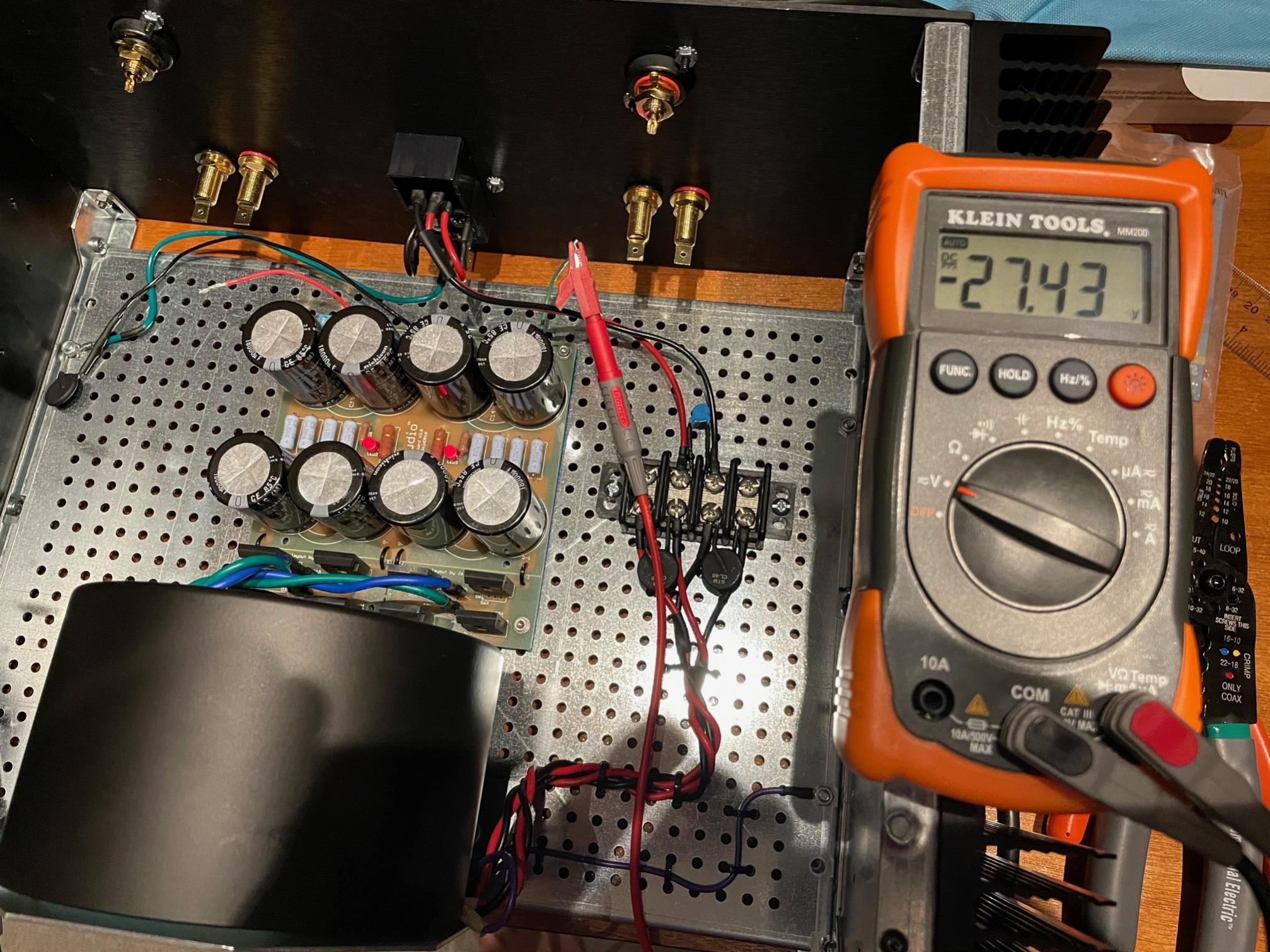

Need some advice, I'm almost ready to test the PSU without the boards. If I order a CL60 I think it would just go in series on the PSU chassis earth run, correct? I ordered a spare 4 terminal block and could use that, or would it melt in a fault? Did I see a a photo example of a PSU CL60 earth run just done on the chassis?
If I understand it correctly, thread searching CL60 I was able to garner the implementation is intended current limit faults, thus it's a component safety feature should first power up go sparktacular. Shouldn't the dim bulb tester effectively negate that need?
The CL60 is used for two different things:
1/ as an inrush current limiter, which is quite important (indispensable if your PSU is oversized), it avoids stressing the PSU on startup. This (or these) CL60 are placed right behind the power-connector/switch and before the transformer, and this is a part that gets warm/hot.
2/ as a ground-lift, to have the signal ground kind of floating as long as everything is good. If the amp is working, this CL60 is basically standing idle afaik. Not indispensable but very good to have.

Thanks everyone. I just opened my baggie and it looks like I did in fact order three CL60s. I can see how a ceramic block is just nice to have, and how you could just use the baseplate to run to earth from the PSU in series.
I see how some have earths across the baseplate. I see more folk pick a specific point, run a bolt and join everything there.
How hot does the CL60 get on the PSU earth side? Ok to use my spare 4 terminal block for earths? I would still connect it to the baseplate and back to the outlet.

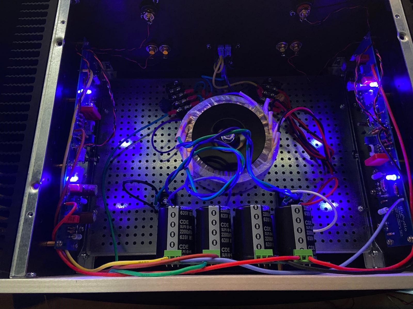

Success!
Well she's done. 0.00V DC offset and 0.400V bias on each side which has remained stable. Ambient is 27C in the house and heatsinks are sitting at < 60C. I tossed in some rando hookup wire I had laying round for old digital projects - twisted this 20g copper with the power drill for input and output runs. Everything is silent. Running without top and bottom plates. I think it might be too hot in here. Needs some cable cleanup. Maybe a complete redo of the crimp connectors - I used my vice grips which was dumb.
Initially stumped by source ground loop which did horrible things. Measured 3.5VACpp between the two chassis, but a ground wire fixed that. My DAC has an IEC plug, but no ground connector at all. WTH?
I'm floored with the amp perfomance. I gotta get to bed, its almost 4am and I have to work in the morning...😴

Concerning the blue LEDs, with those that I use extended on the wires to the front pannel, I use 100K resistors to tame them to the brigthness that is fine with me.
Also a note just in case if you also decide to extend some LEDs to the front pannel: when you switch it off, not all LEDs fades at the same time, some of them keep shining longer in this schematic. So, you cannot take the 2 that are closest to the front pannel 🙂
